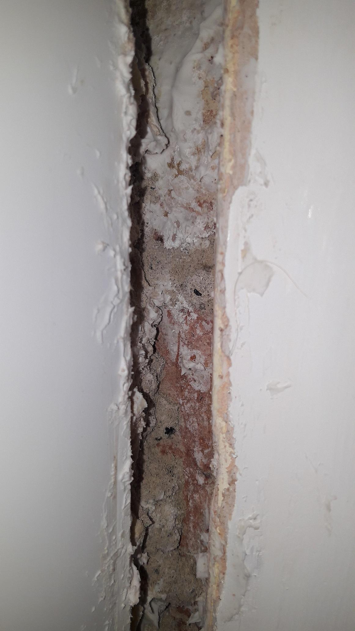

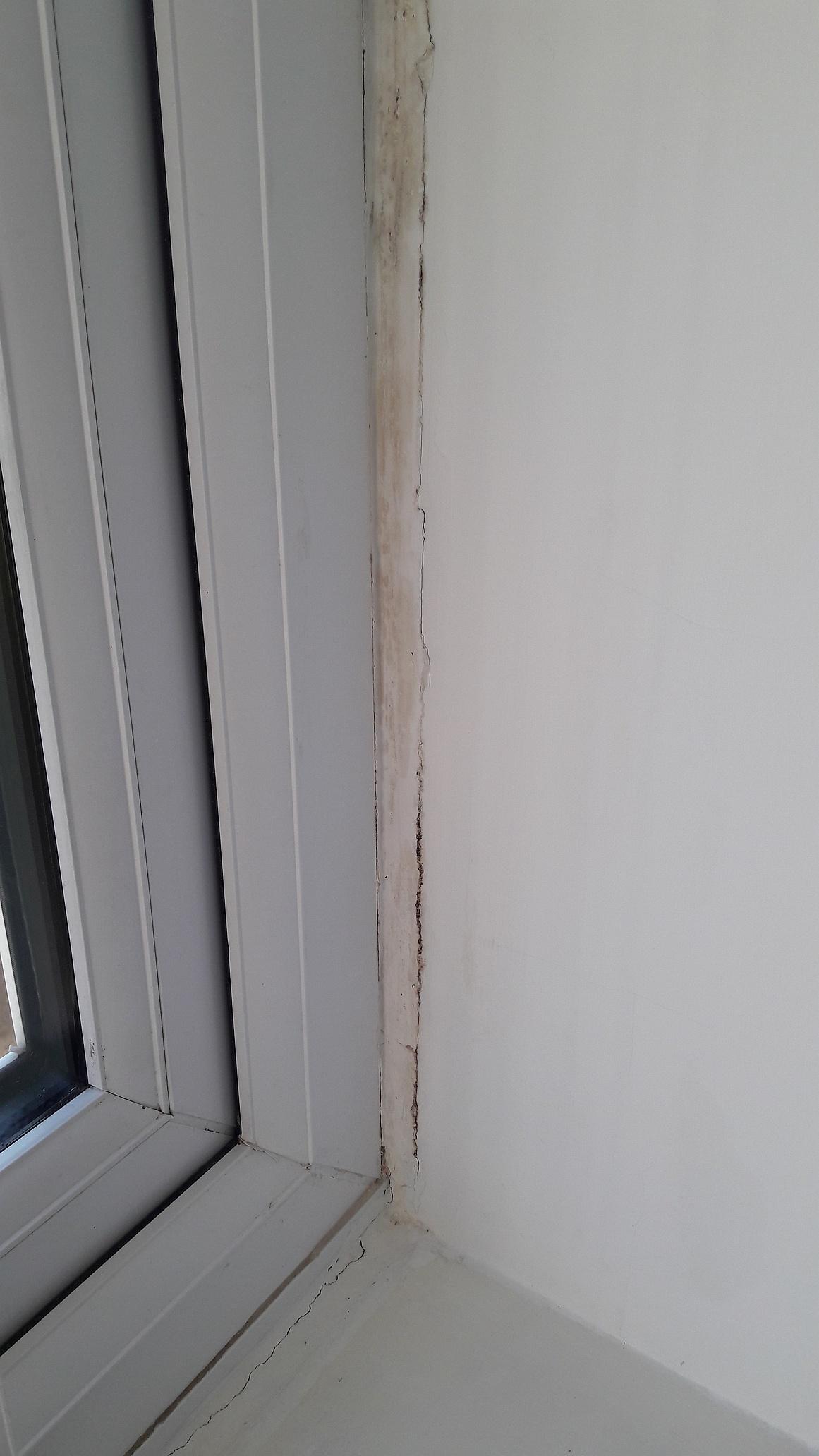

0
  1. On the window I am looking it - which I believe is typical of the four affected by a damp joint around its frame - I can see that there is hardly any foam. Most of the gap between frame and brickwork has been filled with grey mortar, which is continuous from near the outside of the bricks to around half an inch inside the frame, where it meets the plaster. It's this mortar which has been getting slightly damp. The plaster itself is not board, but hard plaster applied to the brickwork of the house. It has not been suffering from damp staining in the same way. Although it clearly must span the cavity I can't see how the cavity is closed off without making a bit more of a mess of it than I need to (why make more work!) but I would suspect it's the original method, whatever that was in 1952, and seems to be perfectly sound. Thanks to all contributors - plenty to think about, and I'll be back on if I find I am still stuck. This was my first post and I must report that I really like this forum and the quality of its help!

  3. PS, I see I didn't answer Russell griffiths, and I should have said that for it to look pretty is almost enough as the problem is confined to that 1/2 inch strip immediately inside the window - though I'd not want to simply cover it up, at the very least I will dig out the mortar from that strip to permanently get rid of the mould. It's what to put back in the gap (if anything) which I need advice on.
  4. Thanks all for your informed comments. The only place where there's damp staining and mould is that 1/2 strip immediately inside the window. I've no reason to believe that the cavity is breached though part of the previous owner's renovation was to have cavity wall insulation injected, however there's no damp beyond the immediate surround of the window. I can see the appeal of the PVC strip, also of gap filling foam; would I have to look for some special type of foam or will any general purpose foam be damp proof?
  5. Nothing untoward on the outside. The house is rendered from the windowsill level up, bare bricks below. The PVC unit is well sealed to the render, and the render is apparently sound onto the brickwork. The DPC is clearly visible and not bridged. The air bricks are good, and apart from this one location (on several windows) the house exhibits no other evidence of damp whatever. So yes, the outer skin of bricks is (very slightly) damp when it is wet outside, but isn't this just the natural absorption of damp from the air - which is why there's a cavity? Happy to be put right if this is not the case.
