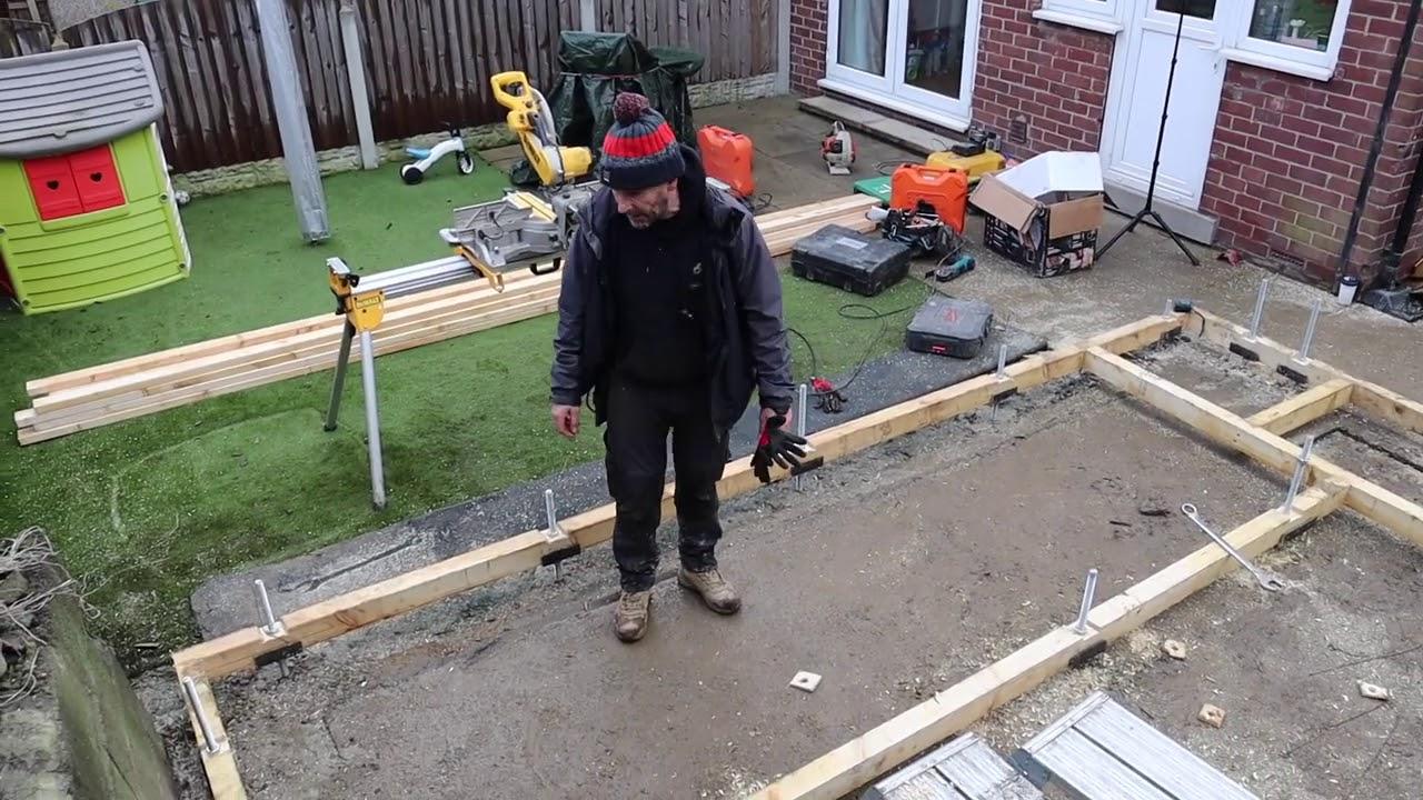

  3. Hi Iceverge, I'm using a different method. I'm not using helical screw piles, I'm concreting galvanized M24 threaded bar into the holes i've dug. The base timbers then sit on a 'shoe' which is a piece of steel channel held up and adjusted to level by the nut underneath. (similar to pic)

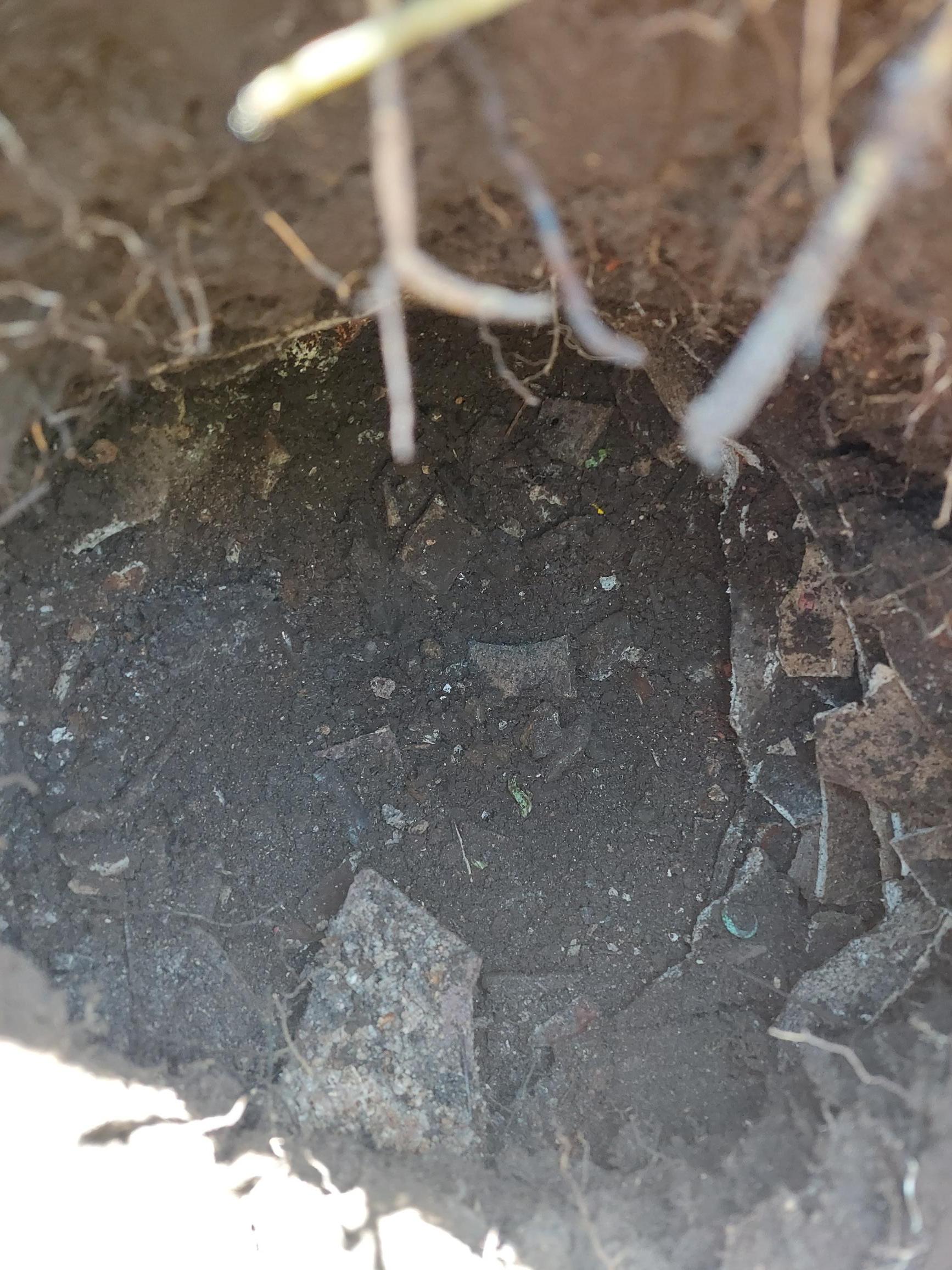

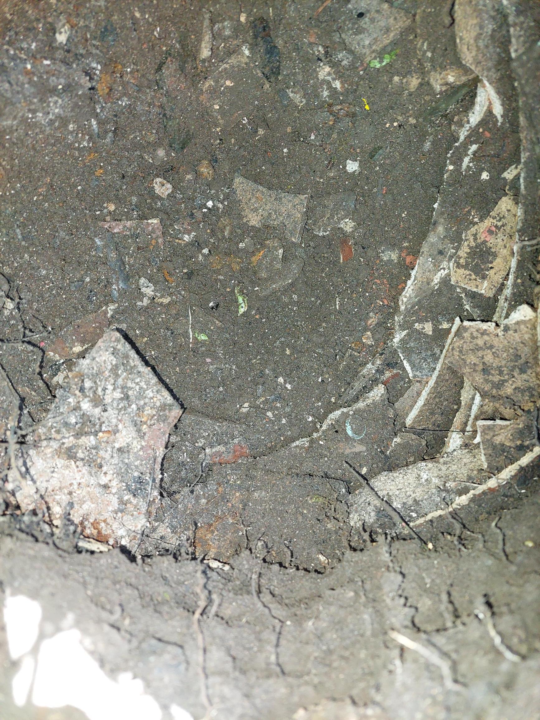

  4. I am building a garden room (7mx4m) at the end of my garden. The room will be of timber construction and sat on 34 screwed rods (m24) concreted into the ground. Digging my holes using post hole shovels I have discovered that the ground I'm digging into has been made up of all sorts of junk. I have found bricks, tiles, metal, asphalt and various other building materials below the top soil. I have dug these holes to a depth of 700mm and definitely not hit virgin ground at the bottom of the holes. I have come up with a possible solution and would like some expert opinion as to whether it would work; I was thinking of using a petrol post knocker to knock a 5ft scaffolding tube through each hole, hopefully creating a friction pile or possibly hitting better ground further down. I would leave say 200mm stuck up at the bottom of the hole for the concrete to adhere to. I am open to any alternative solutions to this problem, especially if anyone has had first hand experience. I have uploaded a couple of pics of the holes. Thanks in advance....................
