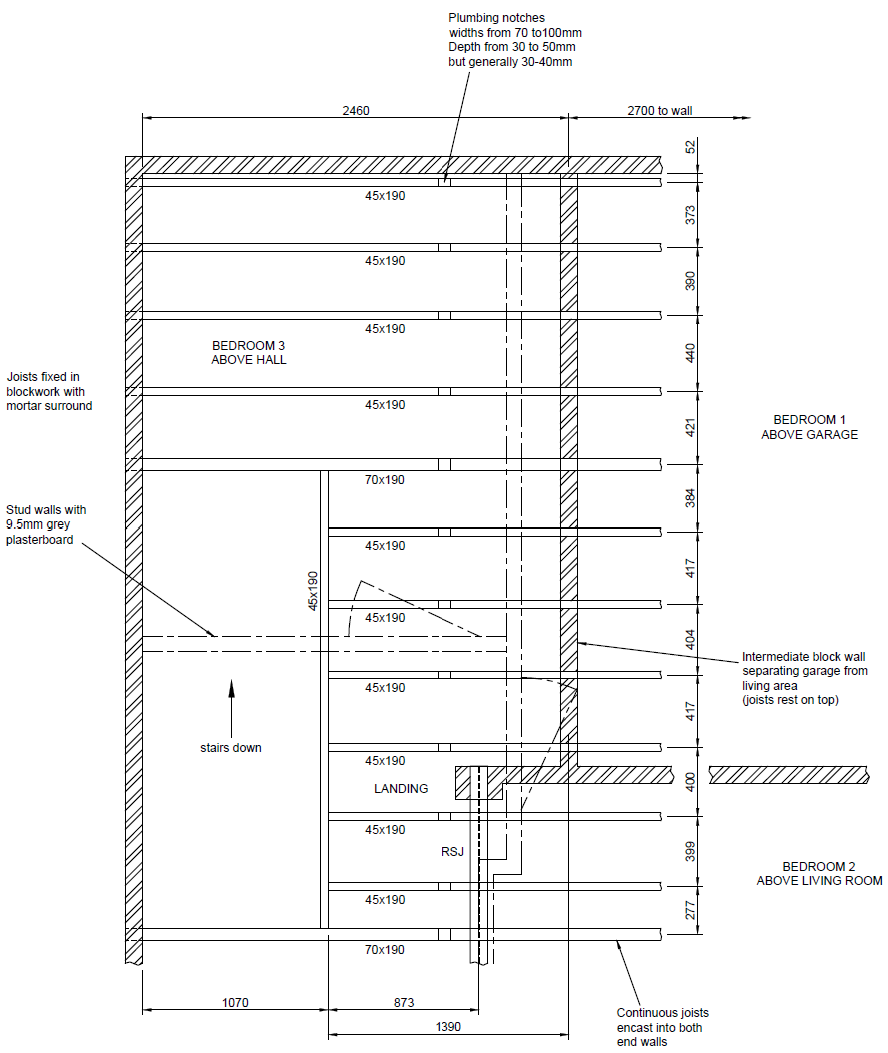

OK thanks for the messages. I will have to repair the joists shown on the drawing for the landing / small bedroom as per the PDF drawing as the notches are too excessive and there is a fine crack in the ceiling which to me indicates the beams are perhaps deflecting more than they should. -

When you say 'notching is how it used to be done' MikeGrahamT21, How should it be done nowadays? I thought notching was permitted within 0.07 and 0.25 x span. -

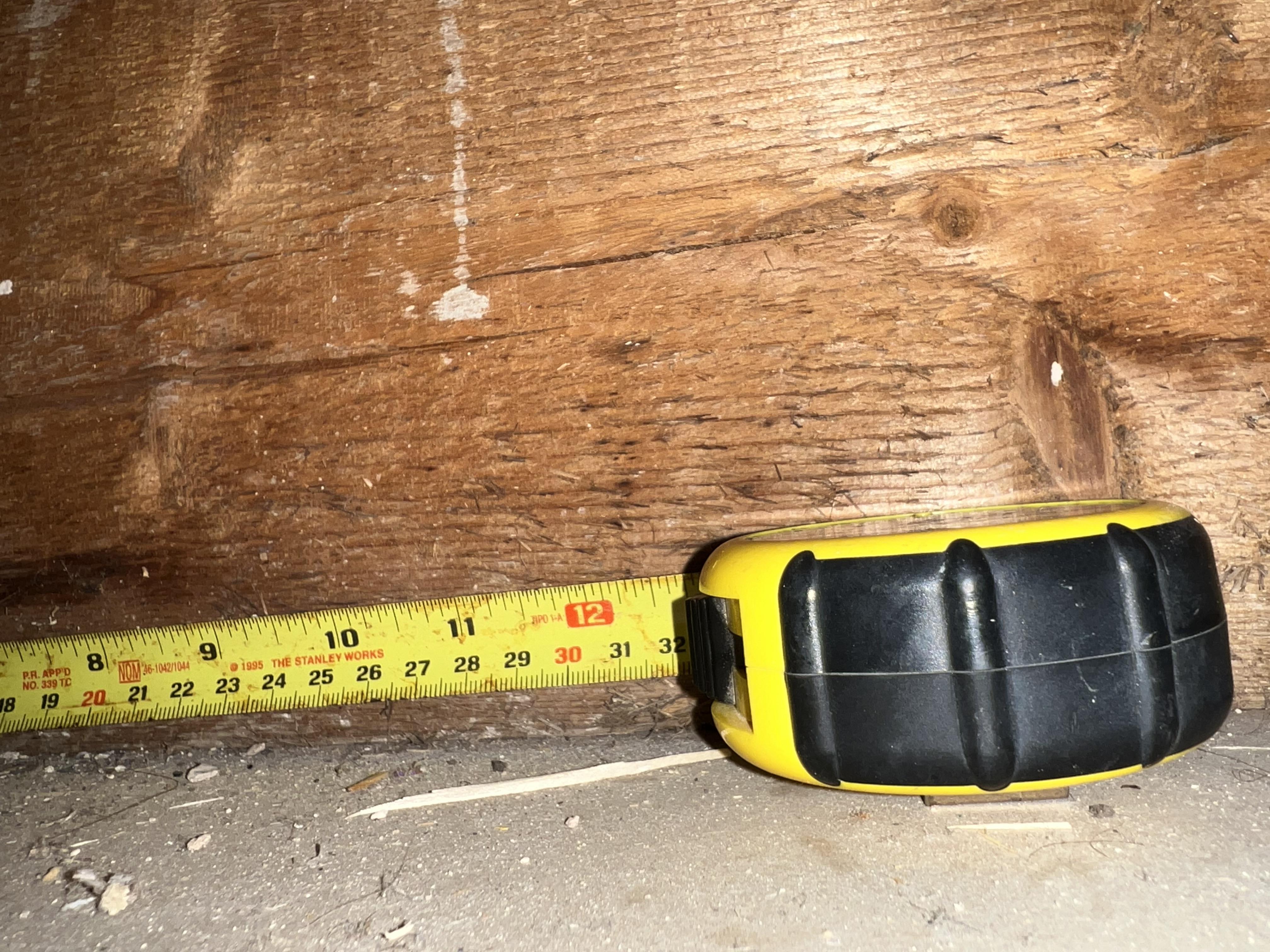

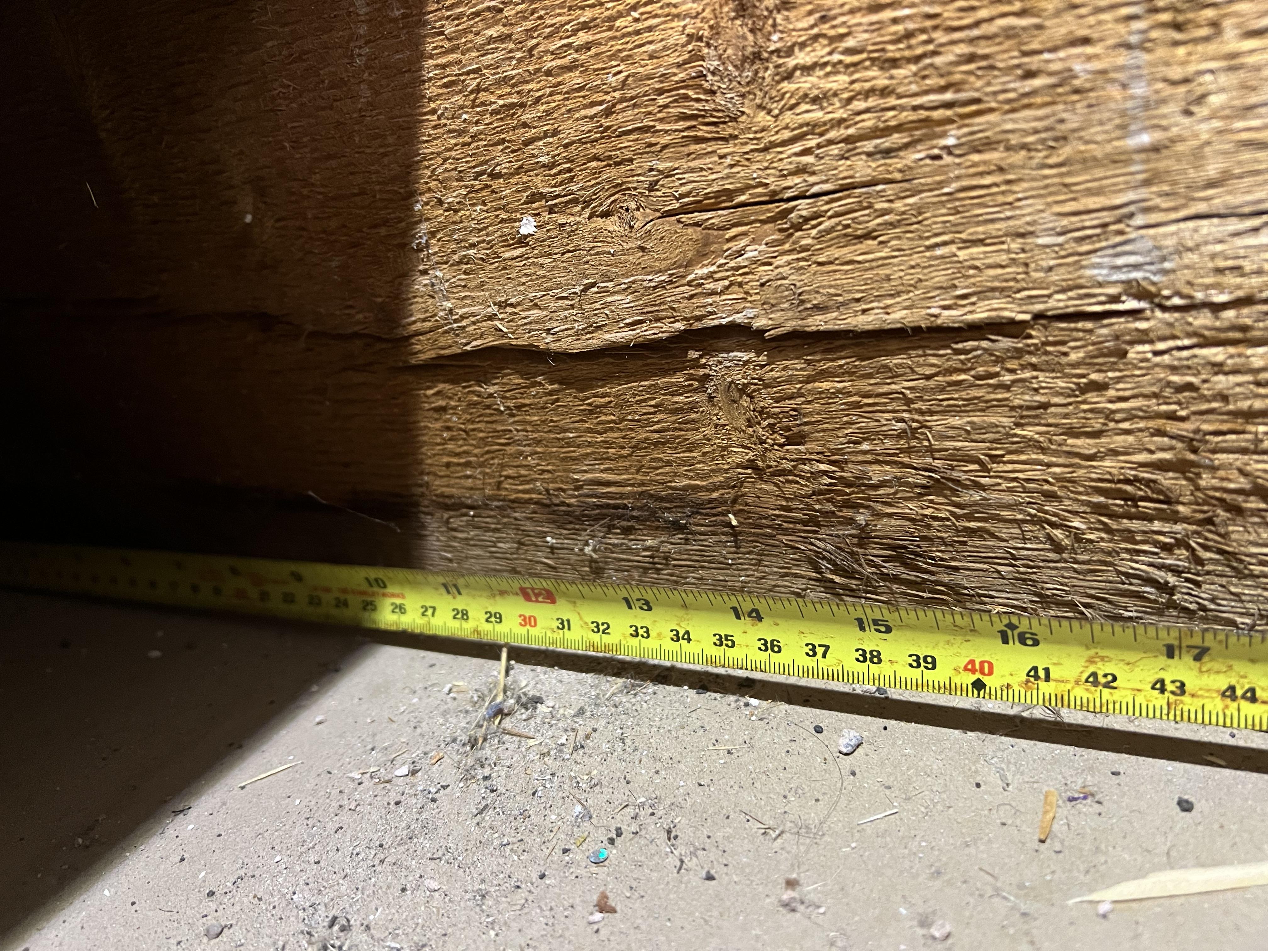

Just taken some photo's of one joist.... The span at this point is 2.05m and the joist depth is 190mm (measured) x 45mm. The notch is 30mm deep and there are no other holes for cables, etc. Although technically the notch is above D/8 it doesn't seem to look so bad. (2 x 22mm copper pipes in there) Joists / house is 1970 build. -
On the drawing attached, I have last night discovered some horizontal hairline cracks in 3 of the joists. They are approx 500mm to 1000mm long. The joist are continuous and supported on the midde wall so the cracks are on the left side (shorter span) as drawn and what is visible. Is the whole joist condemned and no amount of sistering up is going to make thngs acceptable? For all I know there might be other splits in the right hand side but the floor boards haven't been lifted yet. I wanted to avoid touching the right side as that is where the jost are cast into the party wall. The left side is the gable end of the semi. I didn't want to start the party wall act for putting new joists in on what I think now is hangers as this is the preferred way to connect to a party wall to prevent noise transmission through joists? Much appreciate any help.
