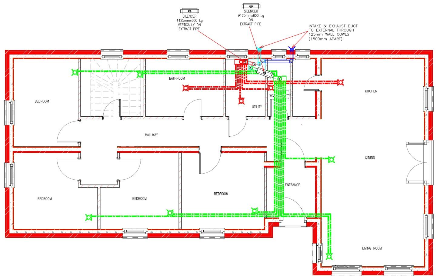

  1. The designer from BPC is very helpful and here is the latest design. The addition of the upstairs vents are included and because of this an additional extract was required to balance the system. I also decided to get a 15pt Manifold with a 200mm spigot today rather than buy an additional manifold with a T point in the future. Any final improvement you would recommend? I really appreciate your help

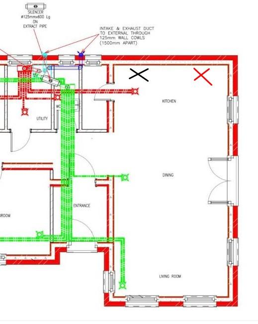

  2. Cooker hood is re-circulating. Thanks for the input.
  3. They said the size of the dining/living room (35m2) requires one single and one double inlets. I would of thought one dining/one living room or a double inlets was enough on the supply end. We're planning to convert the loft at a later date. It was there first, but I wanted to get as far from the cooker as possible and the designer recommended to put above the kitchen sink.
  4. This is an ICF house and no obstacles other than walls. At what length do we need double the duct run? any baseline number? At the moment, that's a study room and we'll convert the loft later on. Black is the sink, red is the cooker however we have a cooker hood.

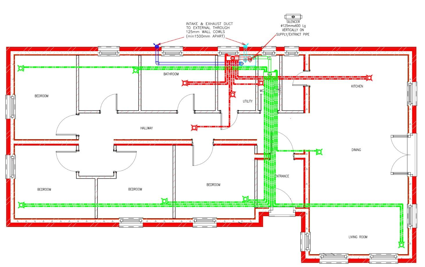

  5. Hi all, I'm looking to retrofit install a Vent Axia Sentinel Kinetic Advance SX MVHR system in this small 109 m2 house and DIY the ventilation duct system. The current ceiling height is 3 m and I'd like to build a 30 cm deep false ceiling for the duct system. I paid for the attached design (BPC) but I'm a little worried as the designer keeps emphasising that "We do not provide an "as built" design service, we only provide a layout which is a visual guide and not a plan." I thought I would have fresh eyes take a look to see if there are any glaring errors. Any opinions welcome! Thanks K
