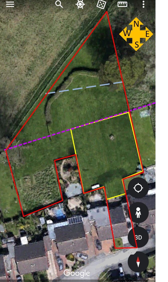

The response from the pre app was that in our area 3m is the minimum width of access permitted.
That's one of the questions we're asking the pre application planning officer.
Appreciate your considered response Ferdinand. I would love to build a second there as our retirement property and sell the (hopefully mortgage free) main house at a later date. The council has form for approving backland developments of single houses (1 in our village last year and one 7 years ago - none refused those are the only ones applied for) and also small backland developments elsewhere in the borough. We're currently waiting for pre application advice based on a 2.7m access but asking the question would it need to be wider e.g 3.2m? If we won the lottery we would knock the bungalow down but there are always compromises with a self build and that would need to be ours. I'm erring more to take off 0.5m of the bungalow because of 'normal' access like supermarket deliveries and washing machine/furniture deliveries etc.
I'm only building one new house for my family. I'm not building to develop because the site certainly has potential but that's not my intent. The bungalow will either be lived in by an elderly relative or sold to pay for the new house because the build cost may exceed predictions.
It's a single storey (bungalow) so no height restrictions and just a straightforward straight wall. It would be removing the hallway so straight into living room. Knocking through the kitchen into the living room because otherwise the kitchen would be one unit wide plue a metre. Bathroom would have 0.5m off but it has a water tank cupboard currently which could go as the kitchen boiler is ancient and could be replaced with a combi boiler. Then taking 0.5m off the second bedroom the full length. The garden is huge so could extend both rear bedrooms by a metre if it was economically worth it.
Completely removing the garage and walls leaves 2.7m. I'm considering taking half a metre off the side of the existing house. Is that a ridiculous idea or feasible for c£10k?
How would you orientate a house on this site?

Planning have said no to extending but yes to a second house. It's thinking about where it goes which is the tricky bit! -

The bungalow will stay as is. If absolutely necessary for access (2.7m at the moment and the need for sprinkler system) we could shave 0.5m off it and it would still be a 2 bed bungalow albeit with a smaller 2nd bedroom, bathroom and the kitchen would need to be in the living room. But the costs might not outweigh the benefits. My mother in law will be living there. It's only 2.7m for a 2m stretch due to the staggering of the garages. -

We will be using an architect but want to get some orientation ideas before we start. There's recent precedent in the village for infill garden sites and it's a designated growth village. Planning are on board in a pre application theoretical sense but obviously want to see drawings before they commit. The village has development sites for the next 15 years already agreed (far west - 400+m- behind the trees will be developed in next 2 years). Existing bungalow is a no go from a viability perspective. Already run that by planning! -
Bonus points for diagrams! This is the plot we're buying. The red outline is owned by the property we're buying. The yellow outline is designated garden land. The rest is agricultural after an unsuccessful attempt 5 years ago to designate as garden land (not proven rather than refused per se) The purple line is the edge of the village envelope. The blue line is a strip still in the ownership of the original farmer (cannot build on or past it). Only 2 trees to the extreme north and furthest point west. For scaling purposes the size of house we want to build is pretty much the size of the 'sticky out' garden bit NOT owned by the property we're buying. So from the red line to the edge of the grey blob all that rectangle is about the size of the house we're planning. The views are to the north and west. There's some scrubland thin trees to the east (above the neighbour's garden past the purple line). The property and its neighbours are all single storey bungalows. Scaling/practicality wise it is 0.5 acres of completely flat land. Where would you put the house and how would you orientate it? Thank you in advance for your help.
