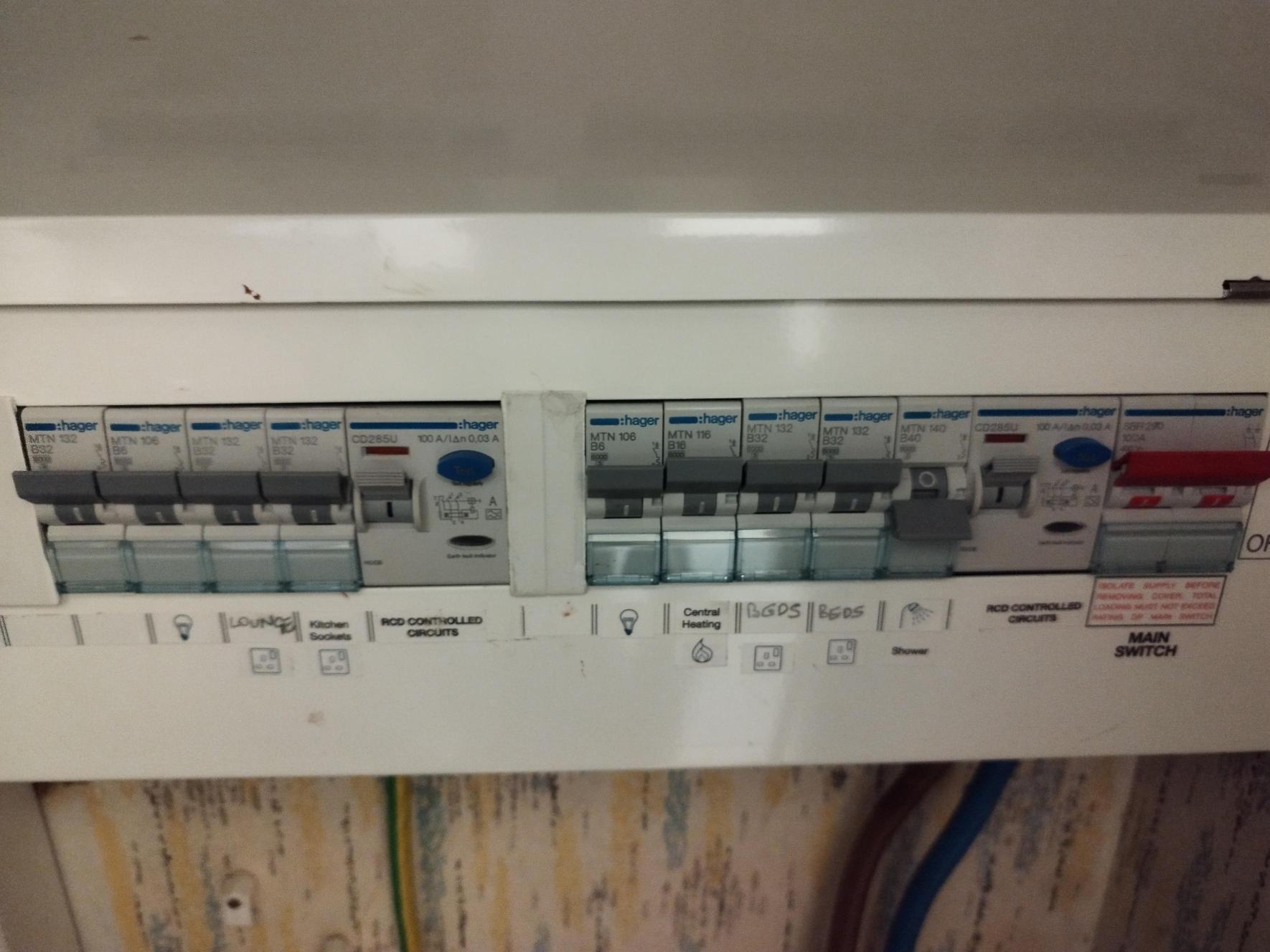

Hello, I have an EV charger going in. Image of consumer unit attached. Would i just need a 32a MCB in the very left hand spare way on the unit? Charger is a BG Sync with built in RCD - I think. I am just concerned about it being with the RCD in the panel. Also, possible surge protection not present. The guides i have watched seem to install a separate box. Yes this will be completed by a qualified electrician but i am just checking his advice as it seems a bit odd to me. If the single MCB addition will work, that will be great. Thanks very much.

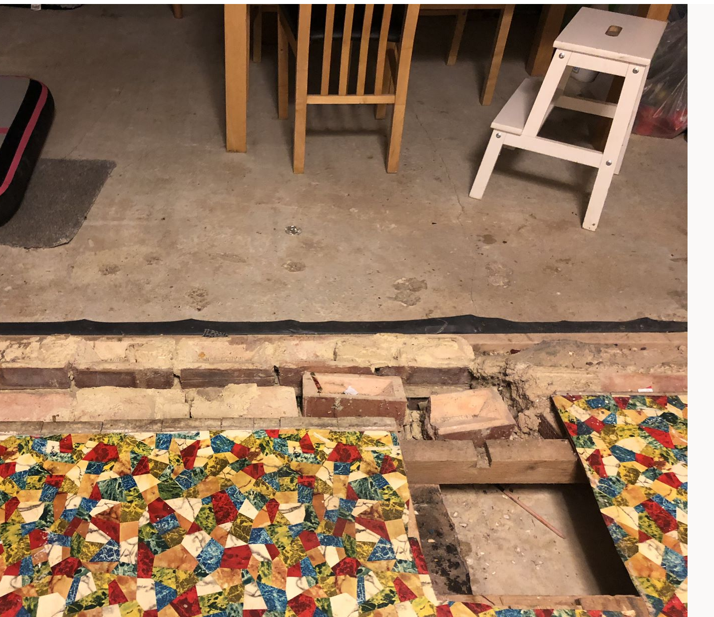

How can I join a concrete slab to a suspended floor?
carlosdeanos replied to carlosdeanos's topic in Floor Structures
Thats a good shout. I think it will need damp proofing but i guess thats just a DPM layer then. I will have a look - thanks. -
Seems to be concrete there. -
@TonyT I guess so? Thing is the extension runs across two rooms, the lounge and the kitchen. Would i need to get more concrete to do that? You can probably tell this is just me completing the work. Thanks. -
carlosdeanos posted a topic in Floor Structures
Hello, I have a concrete slab floor in an extension. Top layer is concrete, so the insulation is underneath. Original plan was to screed and put heating pipes in to bring the floor up to existing floor height. Now, I have left about 100mm to get the concrete up to existing, more than i hoped. Building control have also told me screed is a tough one to DIY. I asked if i could run joists on the concrete (as its damp proof) then board over, (I would insulate between and put my pipes in there) but they didnt like the idea. They suggested i use poly floor sheets to bring it up, then undefloor heating board (With the pipe runs built in) to match existing floor boards height . Do you think this is the best soution or does anyone have any other ideas? Thanks very much. Picture to help - -

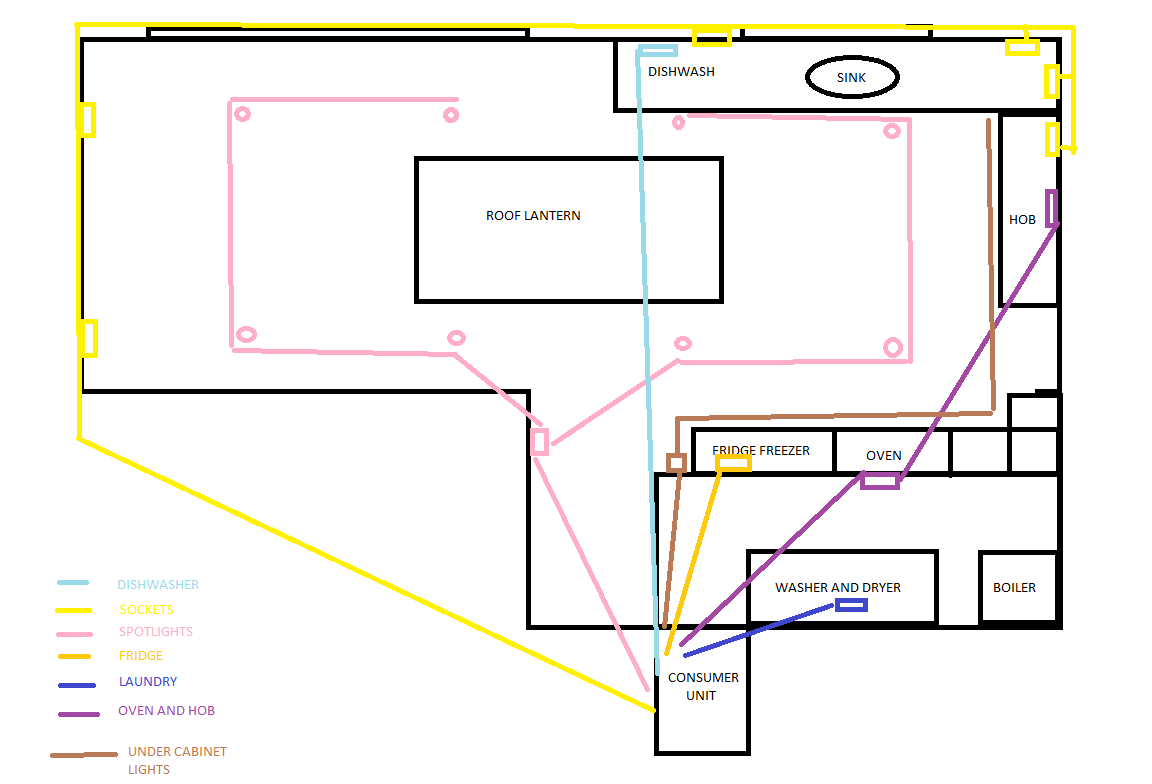

Electrical Circuits Required for Kitchen
carlosdeanos replied to carlosdeanos's topic in Electrics - Kitchen & Bathroom
What spec would I need that to be in terms of cable? Thanks. -
@ProDave that's brilliant thanks a lot. -
Hello, I am running in the electrics for a kitchen in an extension. I will then have a professional wire it up to the consumer unit and test. I was hoping someone could tell me what type of circuits I need to use in terms of Ring or Radial? I'm also a bit unsure on the cable thickness and amps. Image below with the following circuits I think I need and my 'guess' on what I need. I did just take a look in the existing consumer unit which was installed last year and I only appear to have 4 spaces left. I guess I will cross that bridge later. Dishwasher - 20A Radial 4mm t+e Sockets - 20A Radial 4mm t+e Spotlights - 6A lighting 1mm t+e Fridge - 15A 1.5mm t+e Laundry/Washer - 20A Radial 4mm t+e Oven and Hob - 32A Ring 10mm t+e Under cabinet lights - 6A 1mm t+e Thanks very much.
