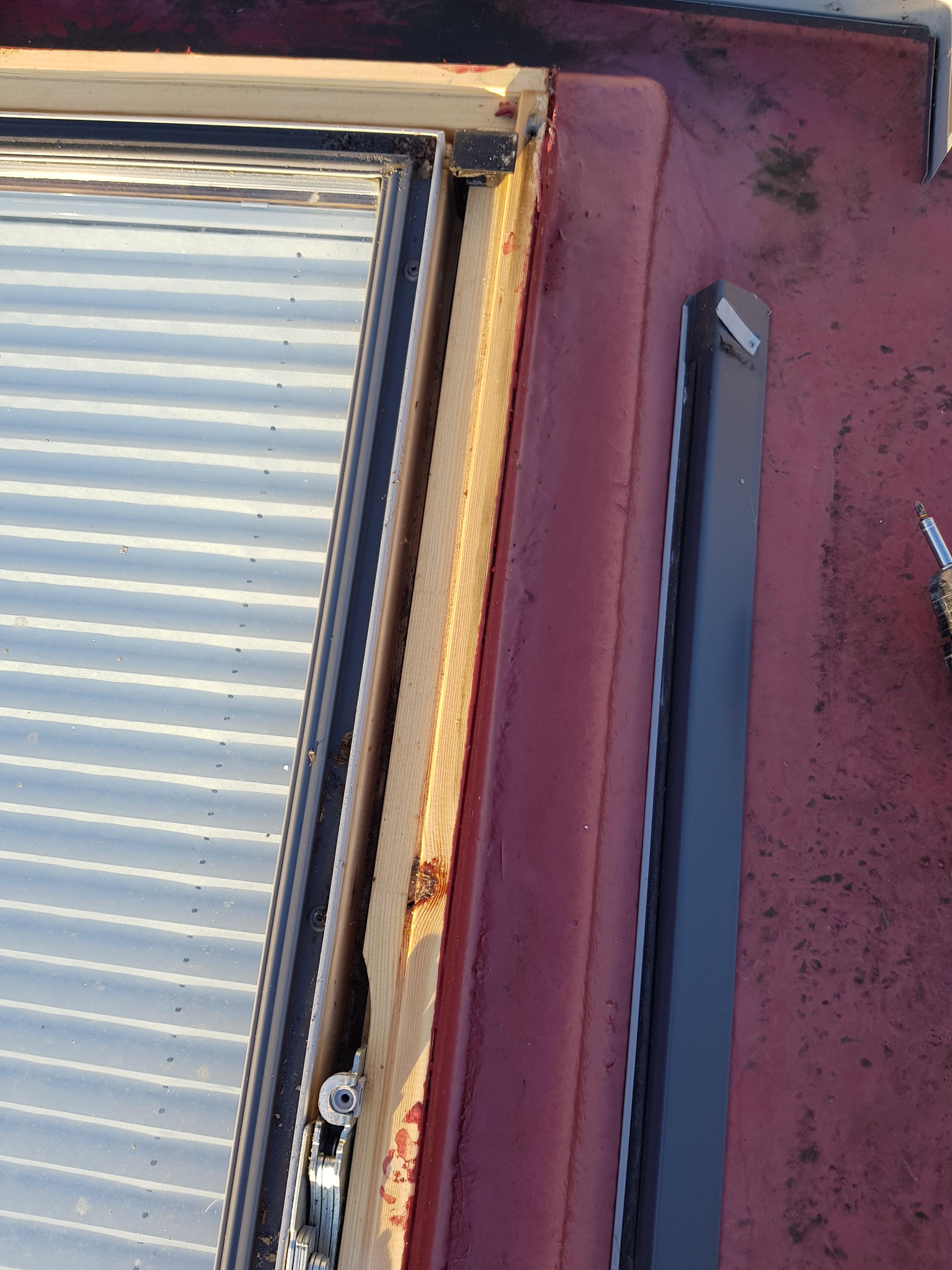

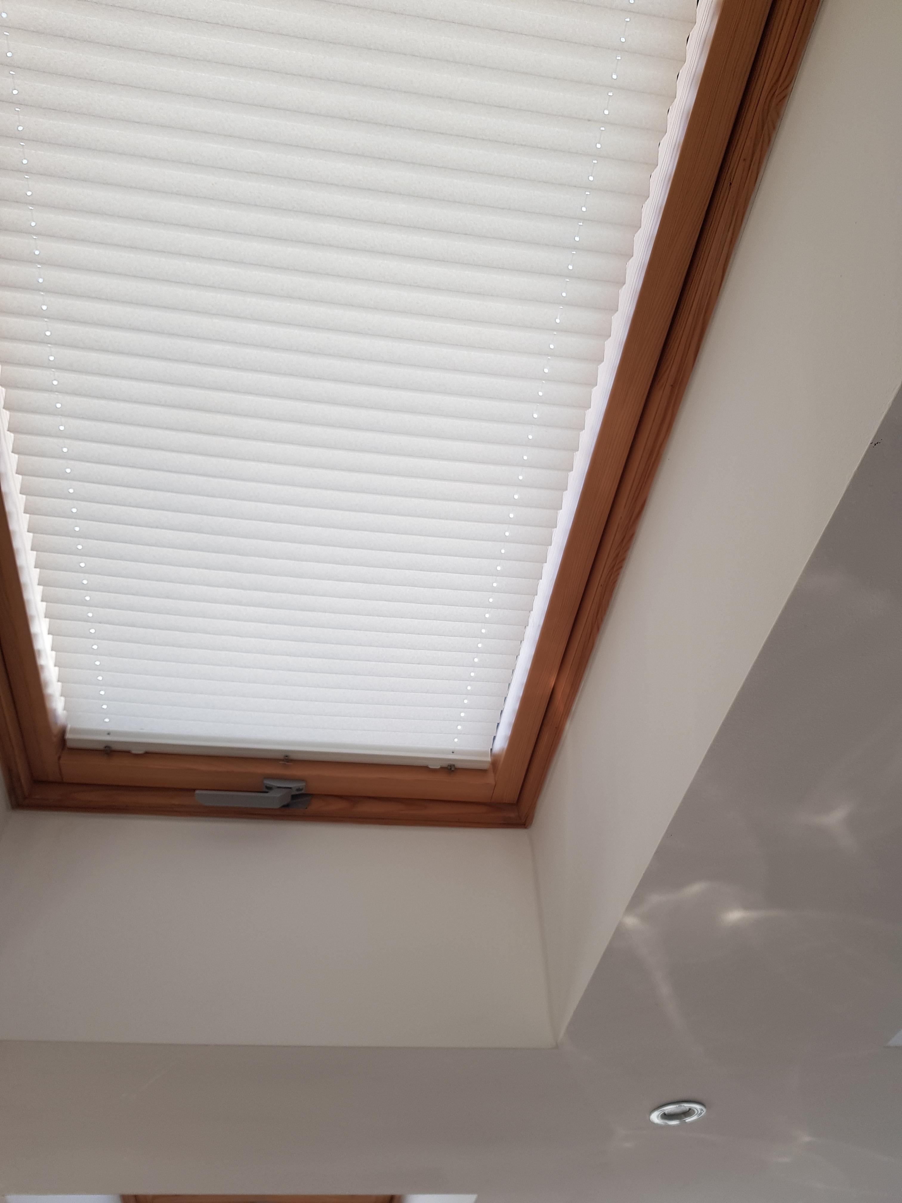

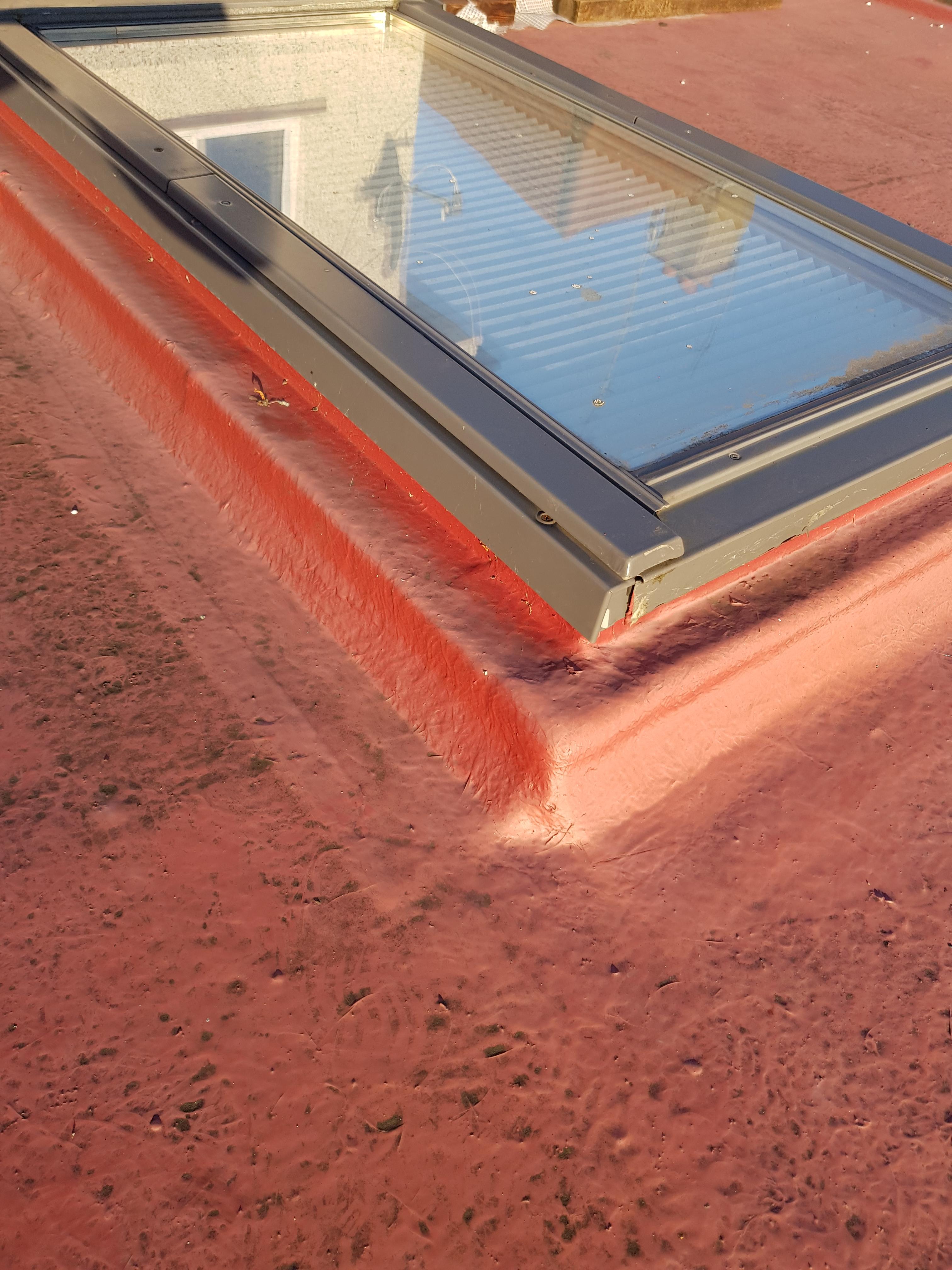

macloon's Achievements

  1. Hi all, thanks for the responses. The problem is that because the fiberglass goes over the frame of the window it makes it impossible to get the window with the frame out without damaging the fiberglass and also the plaster work internally. I'm wondering if there is a way of keeping the window frame in place and placing a new window on top of this or even just a pane of glass??
  2. Would the atlas window fit onto the frame of the old pivot window though?
  3. Hi there, they are roughly on about a 10degree pitch
