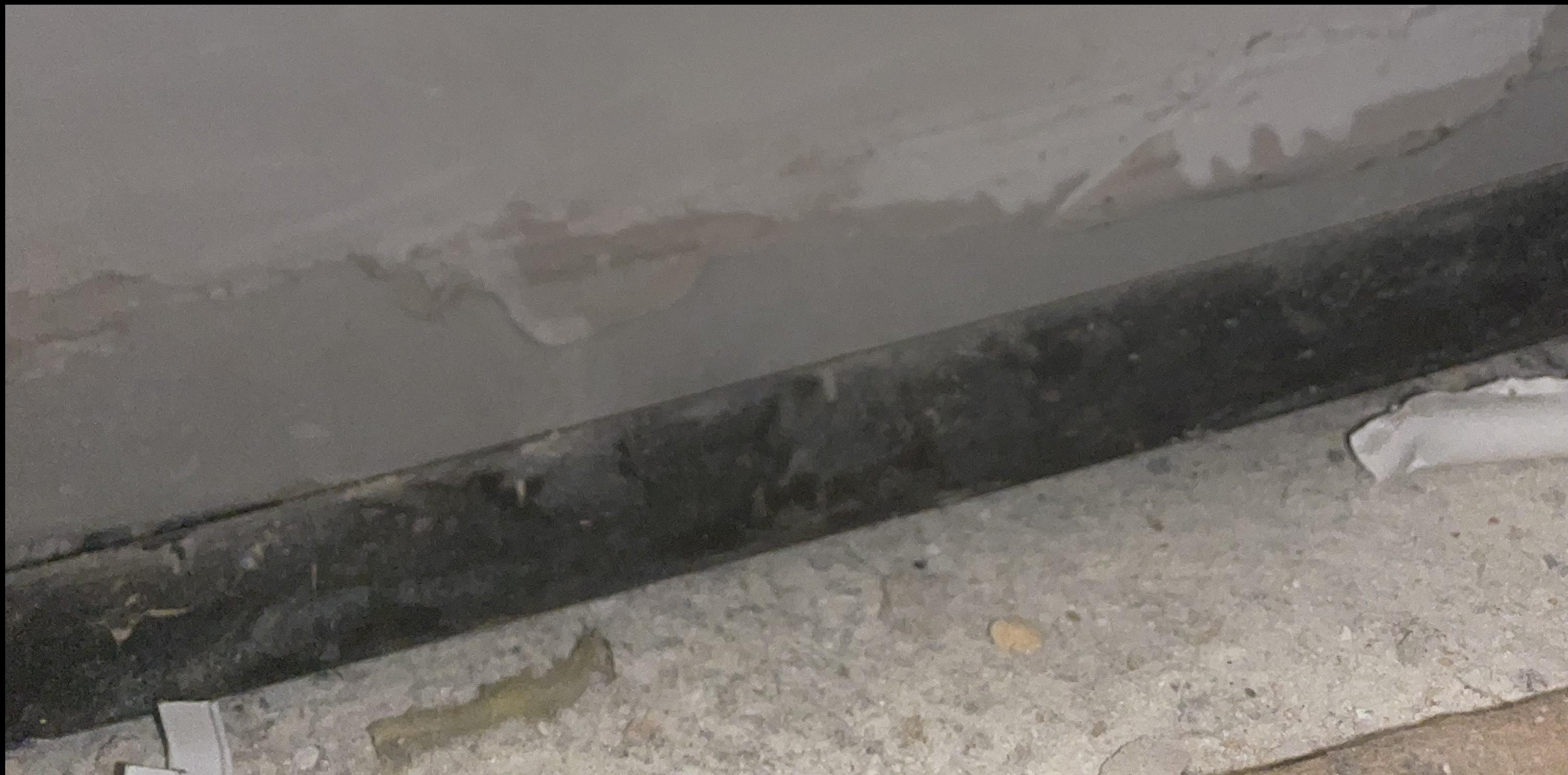

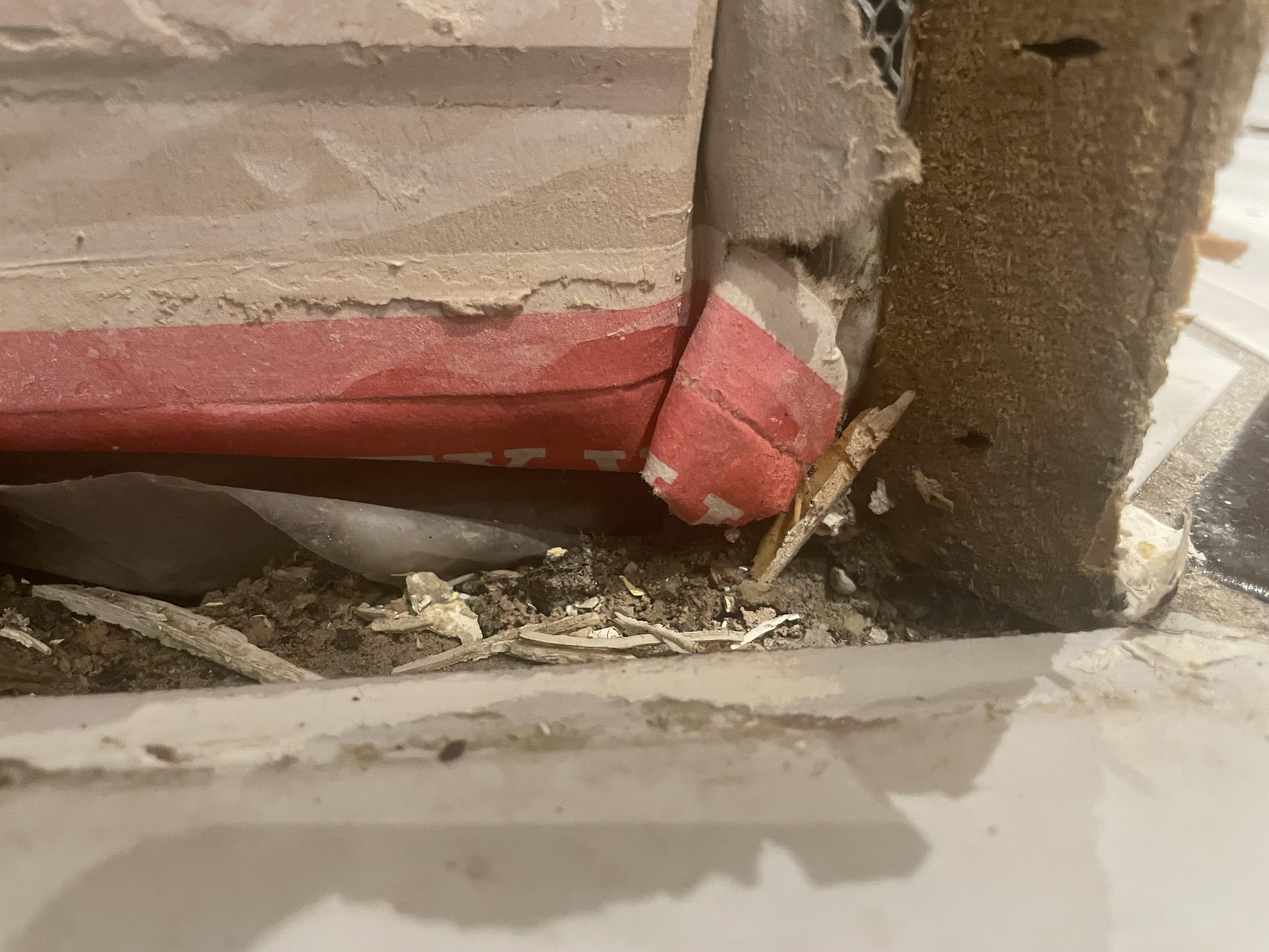

Thanks. Yes the floor DPC and I will take care of it before the skirting boards go back on. This is an internal wall but as you said gotta think continuity. You are also correct about insulating up to the ceiling. The kitchen is a funny room with part of it single storey and part of it under the bedrooms. I plan to get the kitchen roof sprayed and will look to make the "joins" up to the bedroom more airtight then.
Actually I just spoke to the builder again - he's here now - he seated the PIR blocks in something (I didn't catch what - insulation foam?) and sealed up all the joins and gaps. he's pretty confident there's no air leaks except in the area under the sink which he agreed was a potential source of an air leak and he just fixed.
Having said that the man who did the job commented on the poor state of the brickwork and did a good bit of repairing/sealing before the PIR boards went on.
I appreciate that. At this point I am looking for quick fixes and tidying up things that will be harder to do once the kitchen is complete. The floor is solid - cement over tile. I had a good look again and my guess is it's the cutouts for the pipes. This is the sink/dishwasher area which sits just under a new window - triple glazed. No bare block. Sadly too late to do much about it now.
Thanks all for your replies. @nodCan you expand on BLUE foam? This came up on a google search: https://www.screwfix.ie/p/soudal-soudafoam-expanding-foam-gun-grade-750ml I am looking for something that doesn't expand a lot? Or is it the brand: https://blue-60.co.uk/ @Nickfromwales Long time lurker of the MVHR forum I know what you are talking about. We got our windows redone recently and are slowly improving airtightness. The attic is a big source of heat loss and I plan to tackle that before even thinking of a blower test. This is more of an opportunistic attempt to improve what I can. As regards MVHR, I am planning to only do the upstairs bedrooms and my motivation is as much air quality as it is heat recovery. @Redbeard The boards were attached straight onto the concrete blocks. They were screwed in using some special type of screws and not a dot and dab job. This was followed by a full plaster which I am pretty happy with. The joins were pretty tight - I checked before plaster went on - and I don't think there was a perimeter bead there wasn't much room for cold air movement between the wall and the board as the boards were fixed directly on the brick and there are no battens. I only have an issue with the bottom inch on two external walls.
We redid our kitchen last week and I took the opportunity to get some PIR boards installed internally on all the external walls (concrete block) before the kitchen cabinets went on. When the plastering was done, the plasterer left an inch gap at the bottom (Floor is tiles on concrete) - I presumed this was customary for the skirting boards to go back on. However, I can feel a draught on the bottom of the external wall behind the sink and I presume there is some air leaking in all along the floor. Some of this is not behind kitchen cabinets so sadly out of reach but there are still sections I can get at. The worktop goes on in a week and the man who did the plastering is coming back in on Tuesday. Is there anything I can ask him to do to fix this? Airtight tape? Expanding foam? I don't think replastering the last inch is an option. I wish I had got them to plaster to the tiles at the start. I am hoping to go MVHR at some point so improving airtightness is something I want to do.
