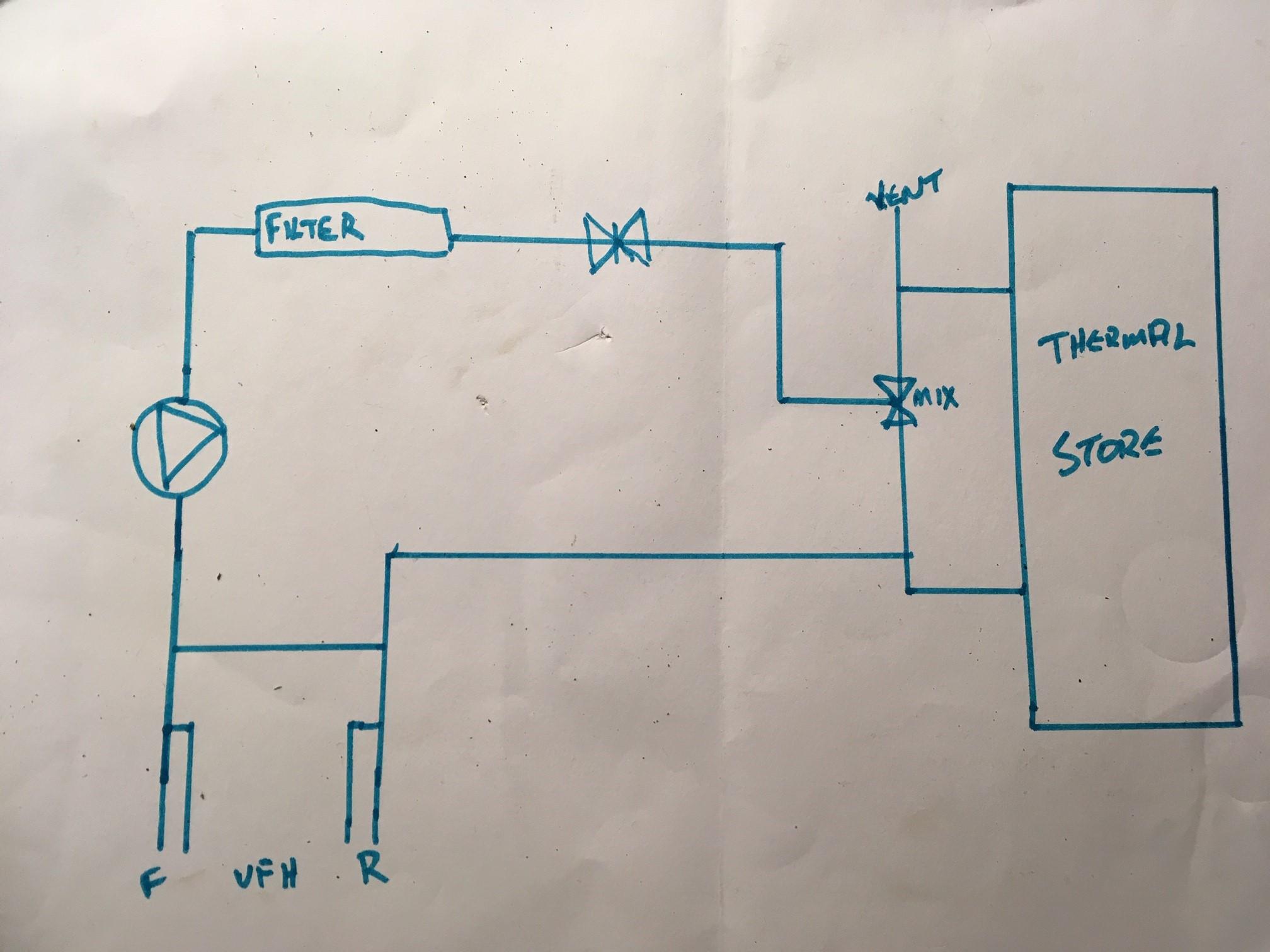

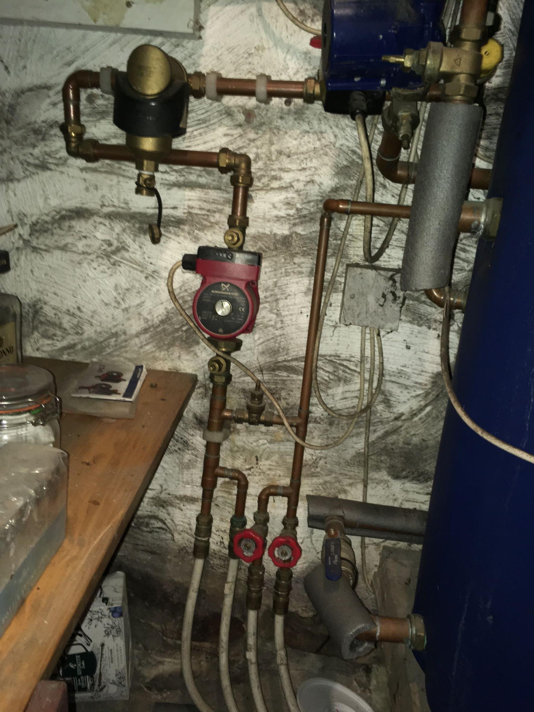

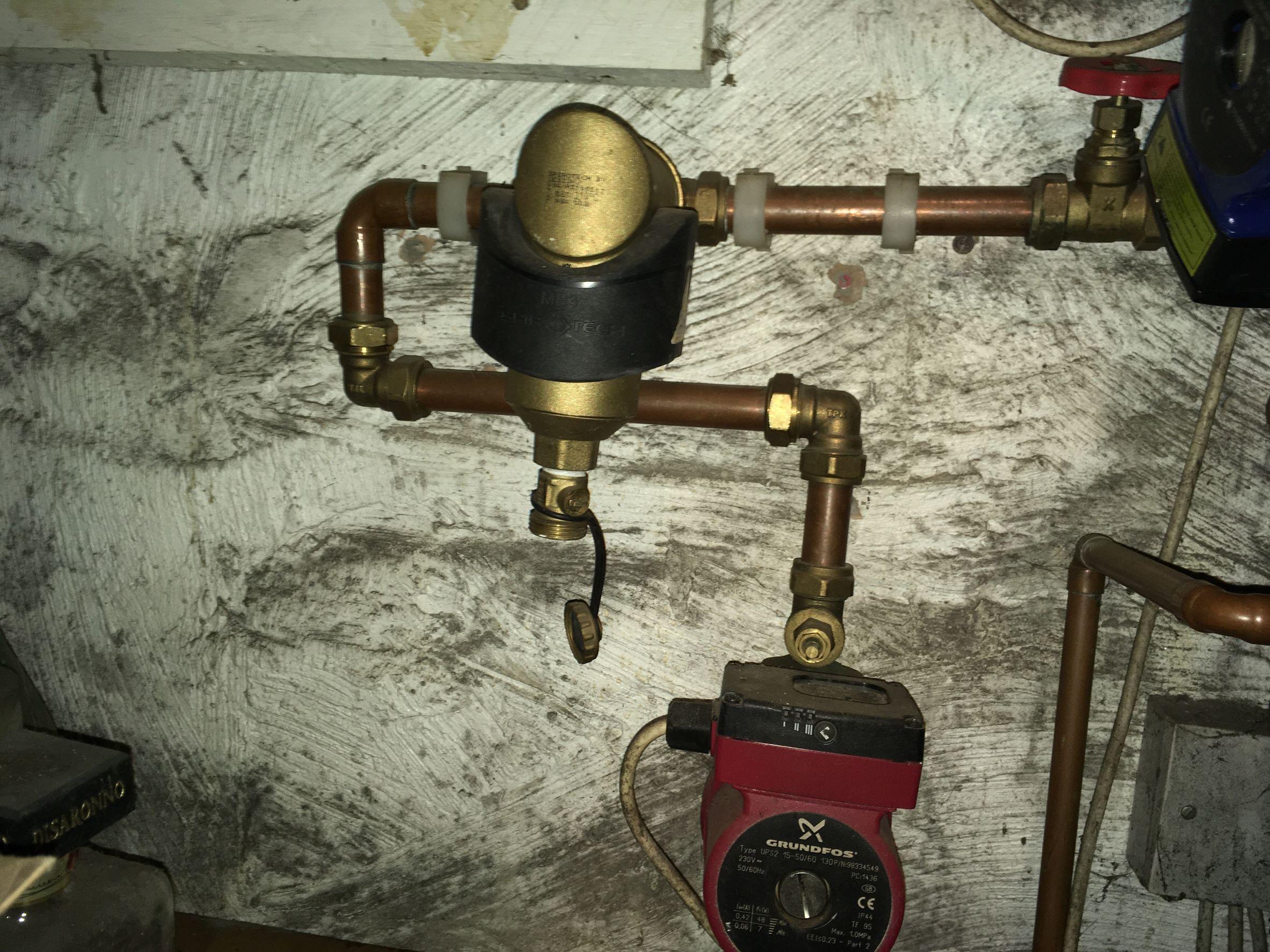

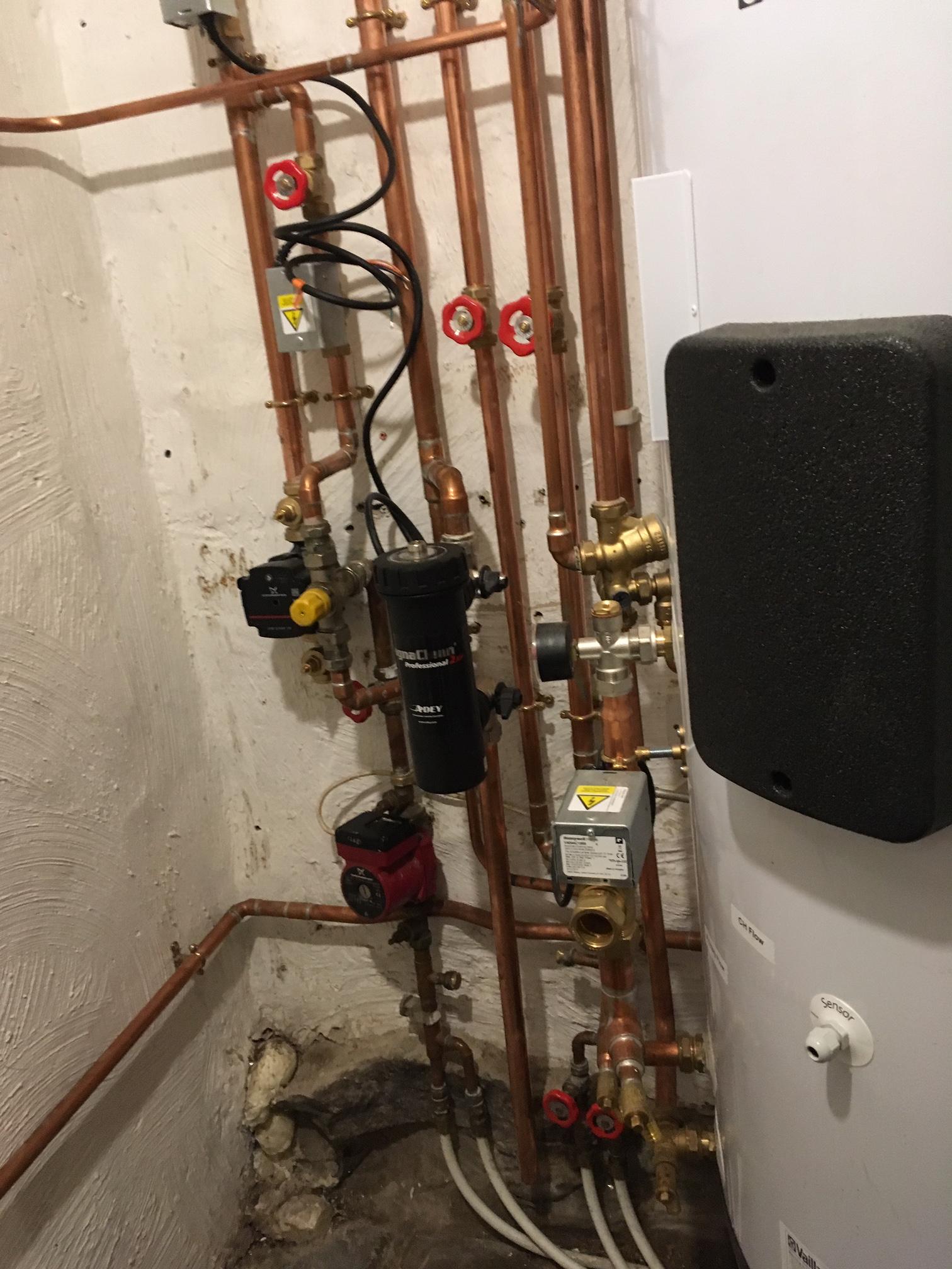

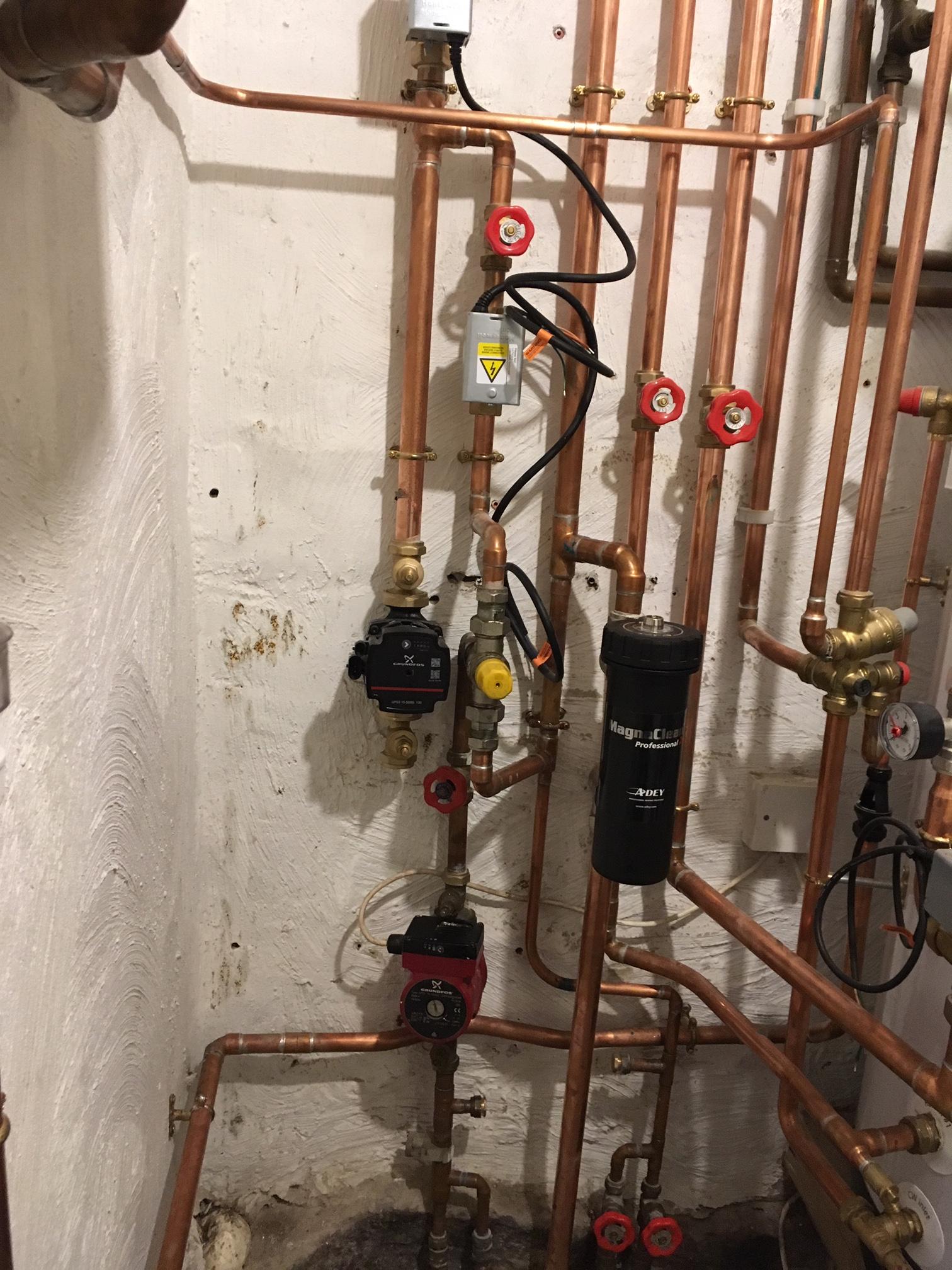

Hi Could someone please walk me through adding a Willis heater to my UFH system (meant to do this last year, but only just getting around to it......) My UFH is a pretty basic system (see pics below). There are two loops for around 28m2 of UFH and no manifold - just two flow and returns - pump, filter, mixing valve (yellow knob) and end feed air cap. The UFH is currently connected to our Thermal Store - which at the moment isn't being heated (still working on replacing a solid fuel Rayburn). Presumably separating the UFH from the Thermal Store is the most efficient way of doing it - so the Willis isn't trying to heat the entire 270 litres of water in the TS. But I'd also like to keep the Willis in the system to use as a standby in the future once the TS is up and running again (and supplying the UFH). I'm guessing the Willis could go between the filter and the pump? If I'm separating the UFH (and creating an unvented system) I've read in the thread below about needing a small expansion vessel and cold water feed for it. Where's the best place to put the expansion vessel and where would I get the cold feed from? Could I use the current UFH feed from the TS? I've got an electrician friend to wire it up once it's plumbed in. Any help appreciated. Obviously if there's a better way of doing it, let me know. Thanks in advance Andy I put vent but I meant end feed air cap.

The underfloor heating is currently fed from the Thermal Store...which is what is causing the problem and the reason for the original post.... I want to separate the UFH from the Thermal Store for two reasons: 1 Currently the only heat source into the Thermal Store is a solid fuel Rayburn which is coming to the end of its days and a pain to keep running. If I can find another heat source for the UFH then we can possibly live without the Rayburn - or just fire it up on really cold days to power the radiators upstairs. 2 The water which goes into the Thermal Store gets black and sludgy because it's fed from the Rayburn. This same black, sludgy water goes direct from the TH to the UFH - so the UFH gets blocked up and I guess pretty inefficient. It was a poorly designed system from a plumber who has since disappeared... The long term goal is to replace the Rayburn with a better heat source. But in the short term (and fairly urgently as its getting colder) I need a way of ONLY heating the UFH. A Willis Heater heating ONLY the UFH would be cheap to install (and hopefully relatively easy to do) and would give me some solid figures to work with (though I am concerned about how much it might cost to run). Obviously in the long-term I'll add the thermal solar panels I've obtained to the Thermal Store....which will give us DWH in summer - but they're not going to do much to a 277l store in Winter. I'm wondering however if there is a way of taking advantage of the weak winter sun and use a panel or two to pre-warm the relatively small amount of water needed to run the UFH. (It might save us a few quid on electricity.) The question I have is does anyone know a way of doing that? And if so how many pumps would I need. Thanks again Andy -
