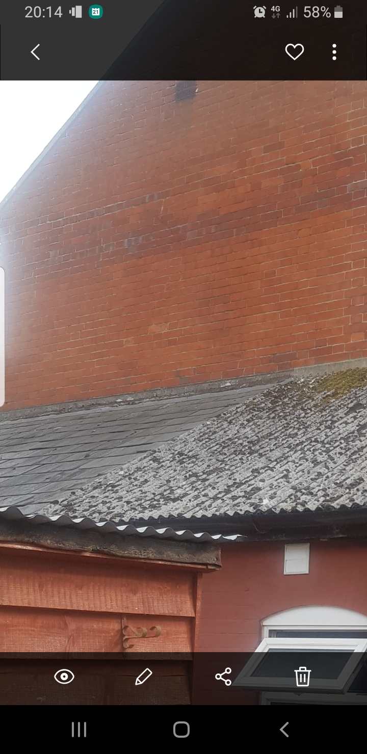

  5. I have a small lean to roof which I'm removing the existing corrugated covering from. Next door it's slates which extend about a foot under the covering, so I assume that someone just added the corrugated covering at some point for whatever reason. When I put the new slates on, how should these be tied in with the neighbouring slates? Will it need a jointing gutter, or can I just continue the existing slates into the new ones (which are the same 500x250 size). See pic attached
