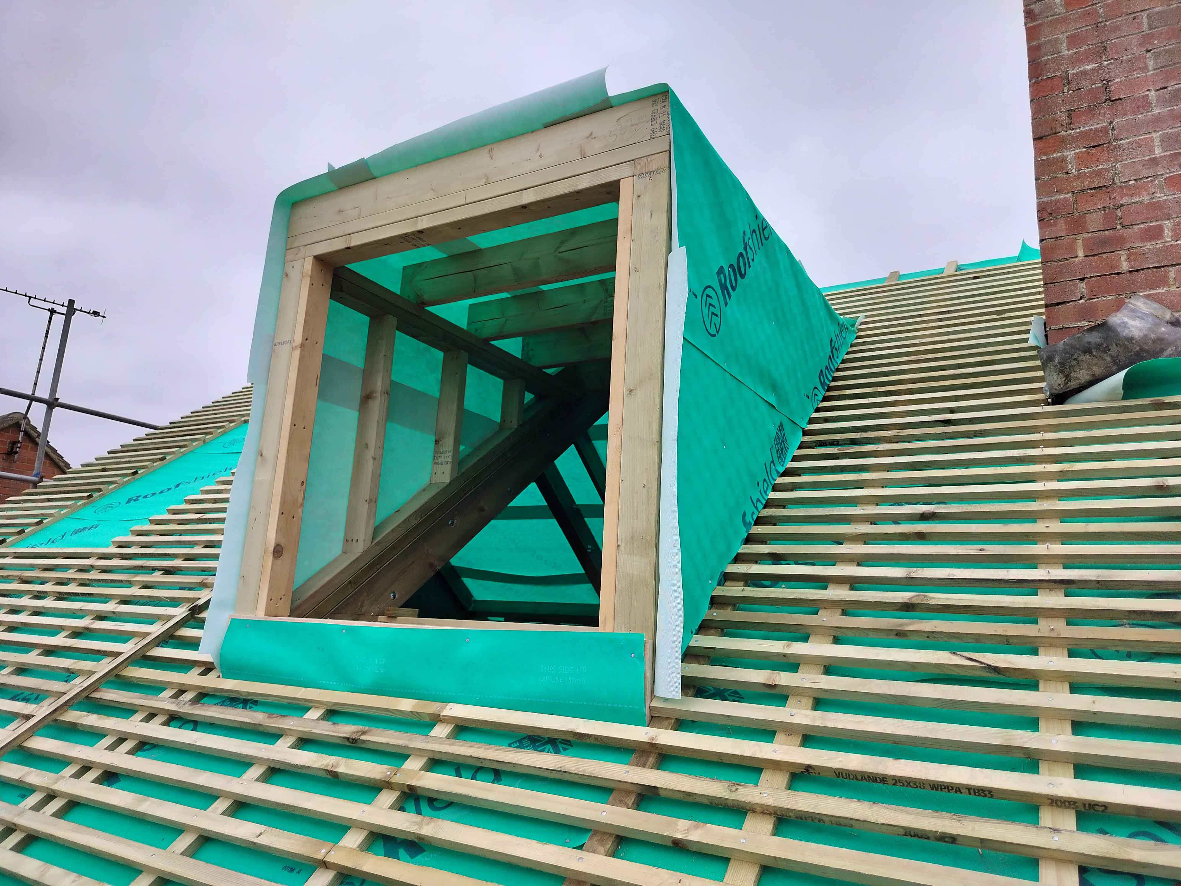

Thank you for your comments. Building Control wanted ventilation across the roof so we've raised the roof and installed some eaves ventilators. Better safe than sorry! -

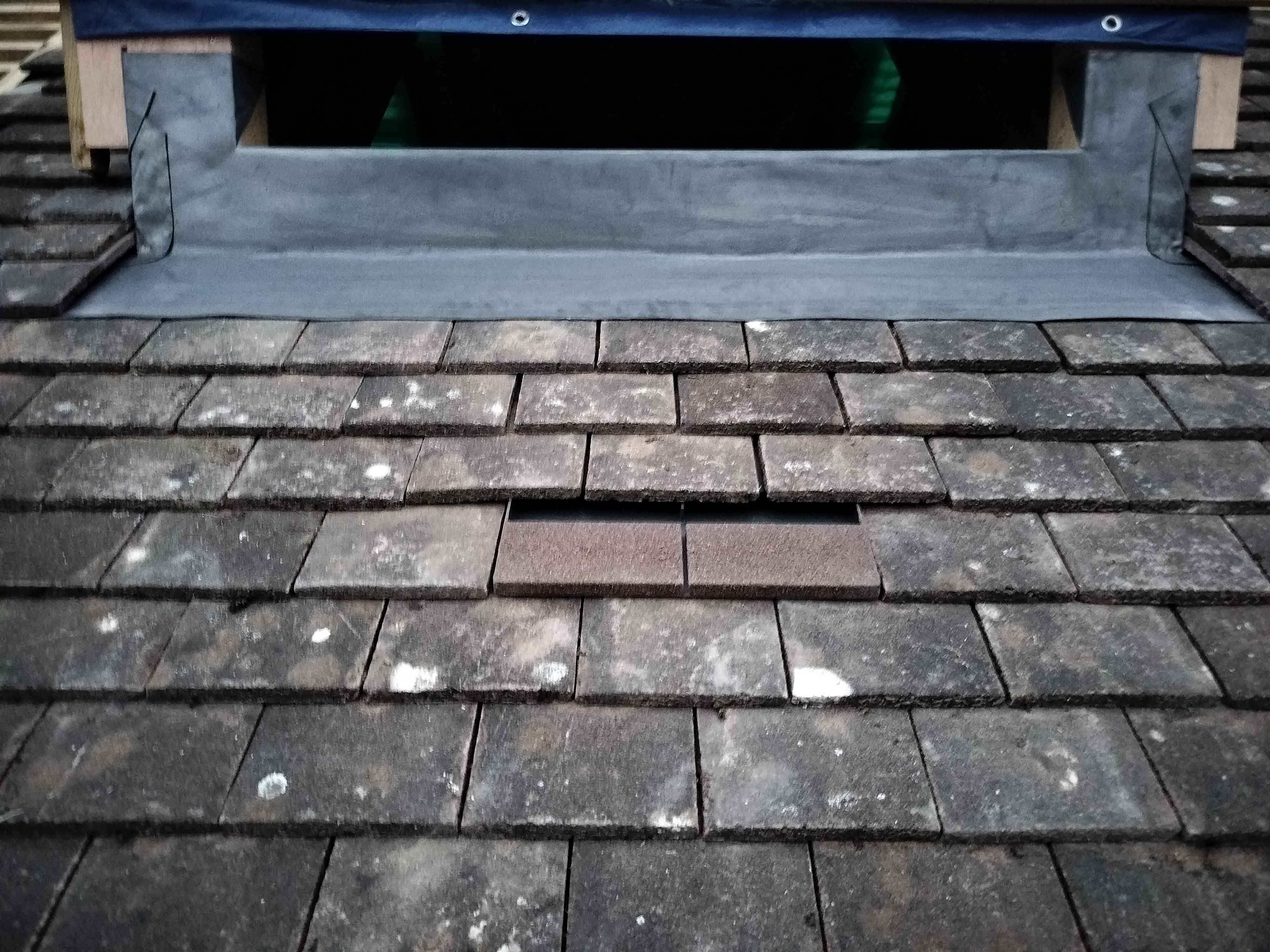

I'm currently renovating my property and have two flat cold roof dormers which have been mostly constructed and whilst the cheeks and roofs have been battened out to form a ventilation cavity, there is no actual ventilator to the roof – the contractor is relying on the cheek ventilators which they say will allow air to go up one cheek, across the roof and down the other cheek. Is this commonly accepted or should the roof also be ventilated independently of the cheeks? The cheeks have a 50mm cavity ventilation zone and the entirety of the dormers will be clad in zinc (or aluminium).

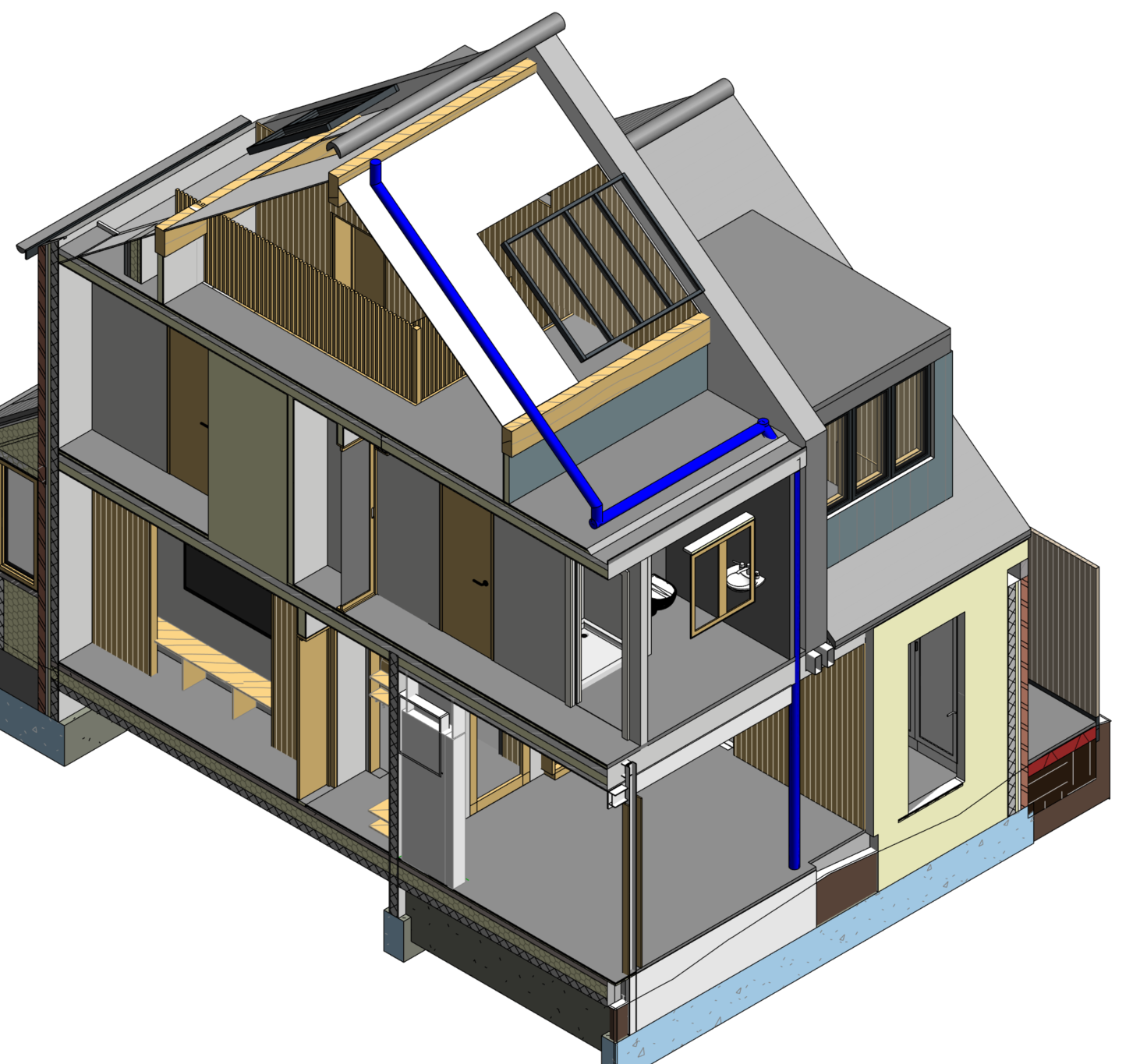

Hello I'm converting my loft space and need to redirect an existing SVP due to the new dormers and rooflights, which will all be opening so the vent needs to terminate 900mm above these openings. In order to achieve this, I would need to introduce two sharp turns into the 'dry' part of the stack. There are no new bathrooms, ensuites proposed within the converted loft so the original 'wet' part of the SVP remains unchanged. Unfortunately, I can't take the SVP up the other side of the rooflight as Building Control would not accept any restriction on the headroom in this area. A little unconventional, but if I can achieve this it would be great. Would welcome any thoughts.

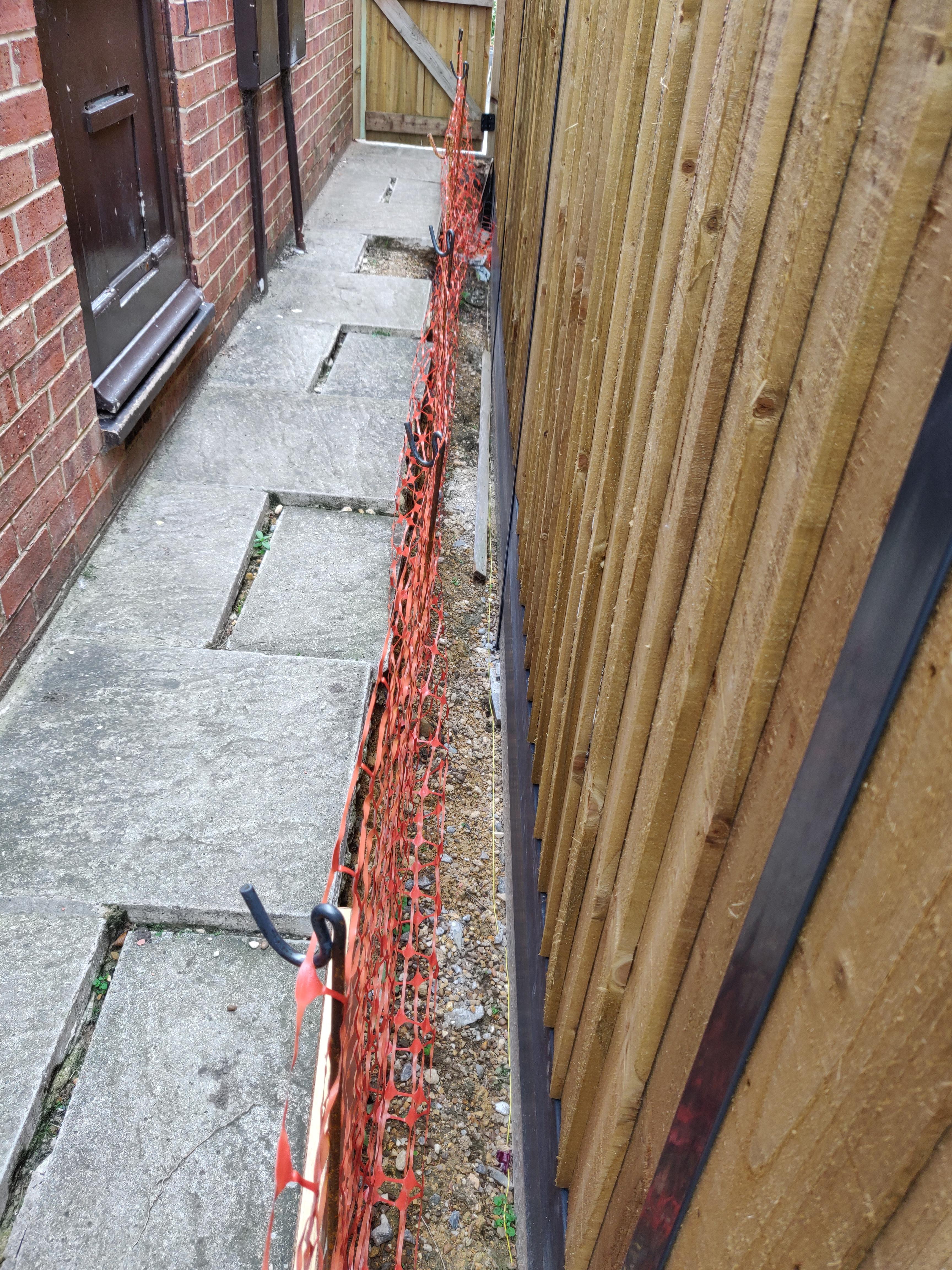

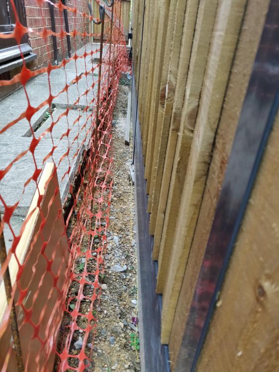

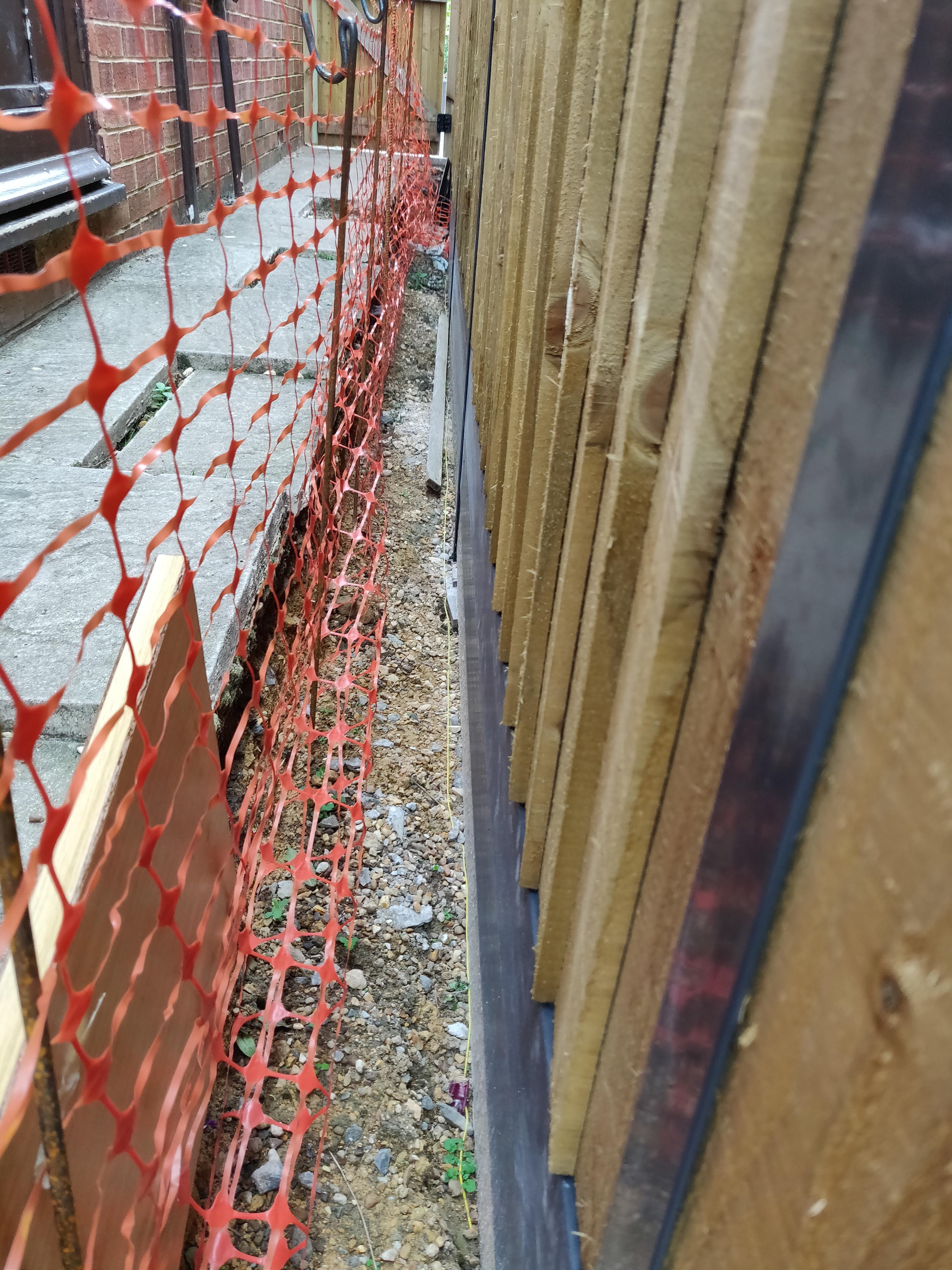

Hi all. I've laid a fairly deep subbase, say 200mm in 50mm layers, on top of a non woven geotextile membrane down the side of our house between my neighbour and I, and plan to lay porcelain tiles on top in the future. For the time being I wanted to make the area safe as the area had been partially excavated when we had our fence replaced due to our side being 500mm higher than our neighbours (we had to previously excavate a footwide trench to remove the old posts/gravel boards). I plan to take up the rest of our patio which links round, and lay a new subbase for this in the future (existing slabs currently laid on clay ?) I have a few queries having not laid a patio before. Is the compacted subbase a suitable temporary finish or will it degrade over time?..if so, how long can you leave it before adding the tiles on top? Do I need a weed membrane on top of the subbase? I can't imagine weeds will grow between the subbase and the tiles, but would like to know if this does often happen. Do I need to introduce movement joints into the subbase, and/or tiles? Can I lay the subbase in sections? We're altering the house in the future, which will create a larger patio area but I can't lay the subbase for this until we begin the alteration works. If it is possible to lay the subbase is sections, is there anything I need to do to teeth the different sections together? Thanks for reading!

Thanks for your comments. Would gravel/pebbles be solid enough to form a substrate for paving? Excuse my ignorance - I've never done paving! -

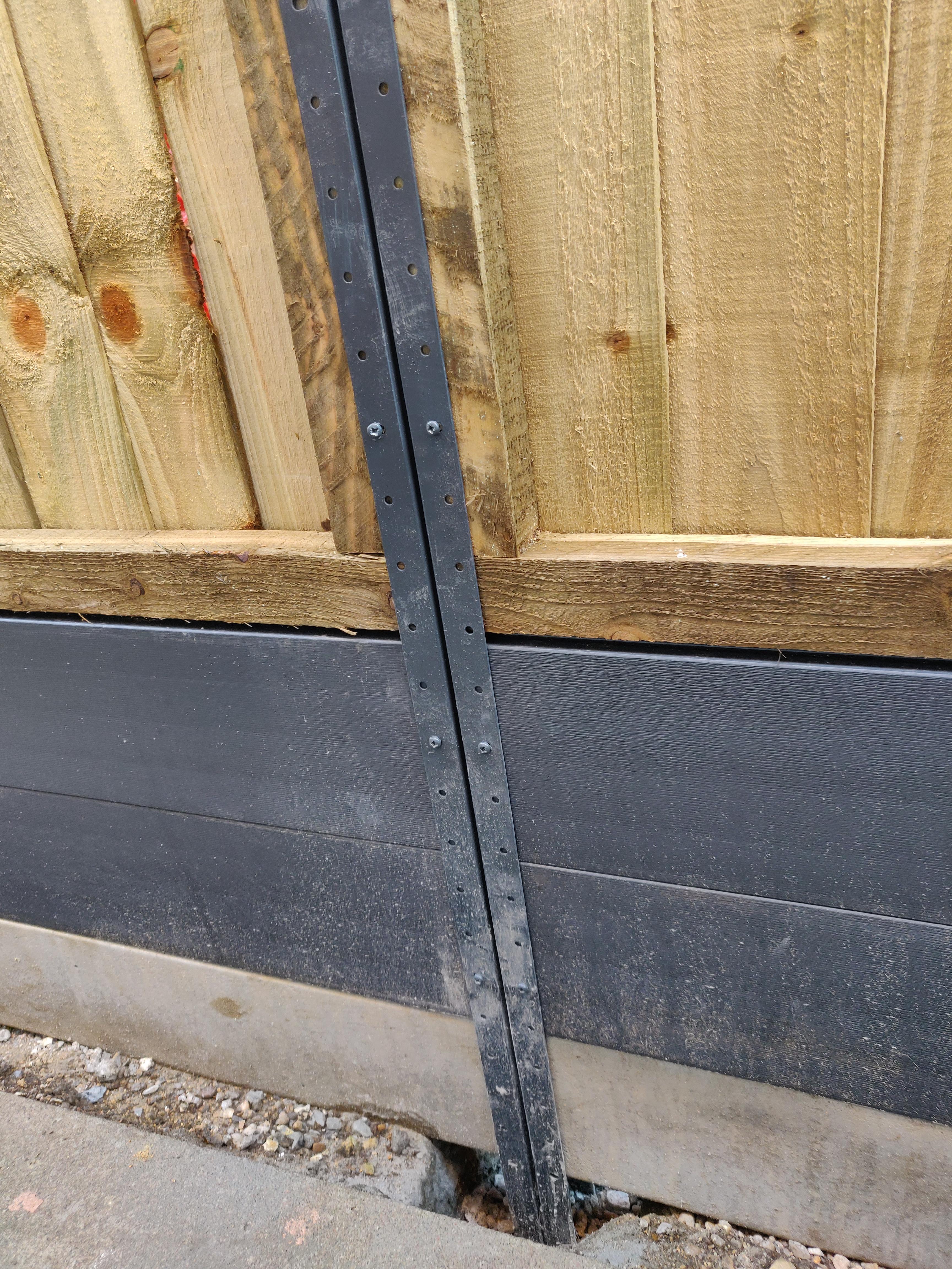

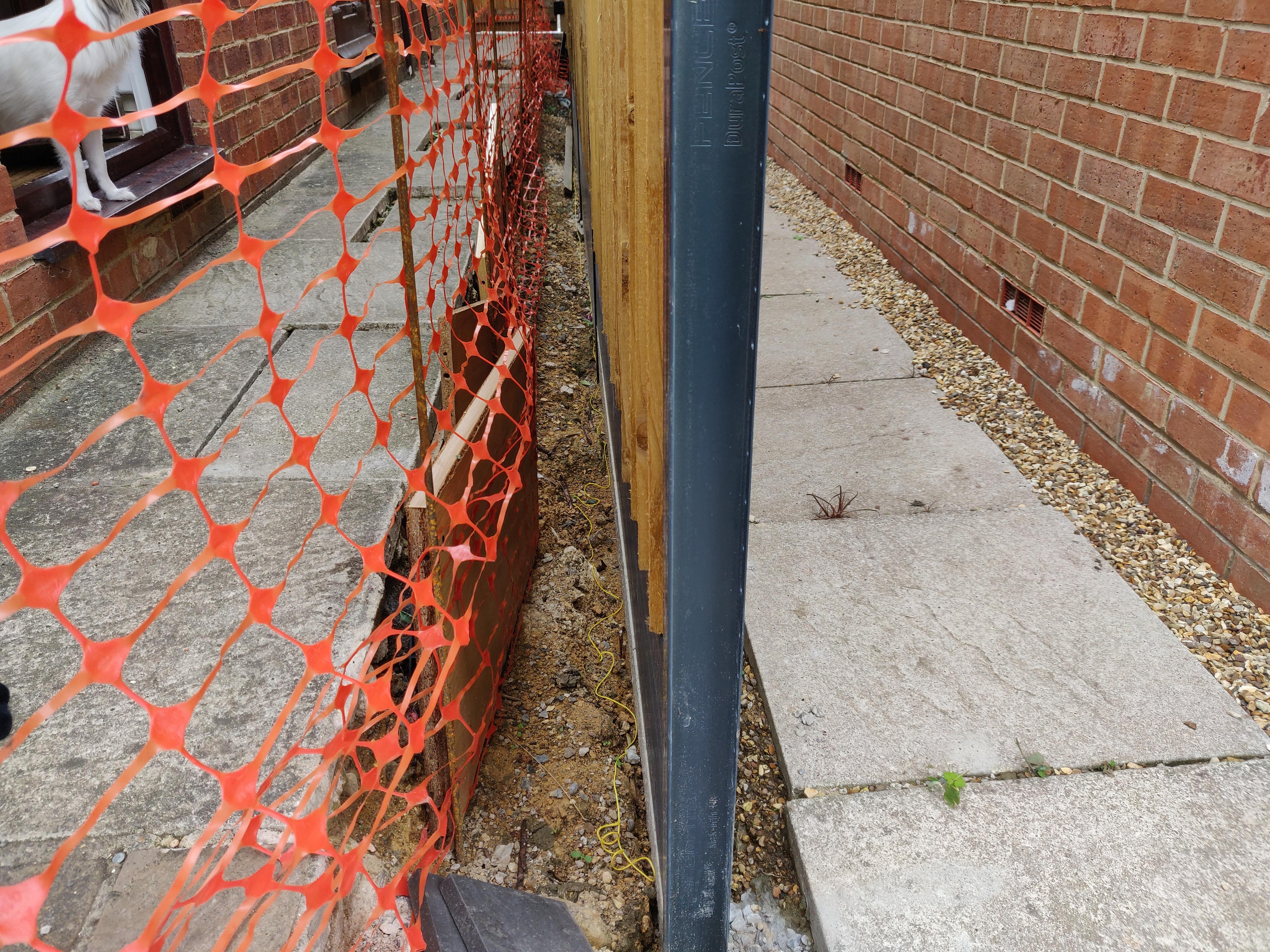

We recently chose to replace our boundary fence as the concrete posts were leaning badly onto our neighbours side. Our neighbours land is roughly 1 1/2 feet lower than our side so the concrete gravel board was acting as a retaining wall which had actually started bowing and cracking in the centre. I decided to dig out a trench on our side to take the weight off the new gravel boards (now comprising a 150mm concrete board, with two 300mm durapost composite boards with a steel retaining rod) and was planning on shuttering this area and pouring concrete to create a self-supporting concrete strip. I've now having doubts about this approach as I don't want to make this area completely impervious. I'm looking for a solution which won't place load upon the new gravel boards, allows water through, but it solid enough to receive paving. Any thoughts welcome.

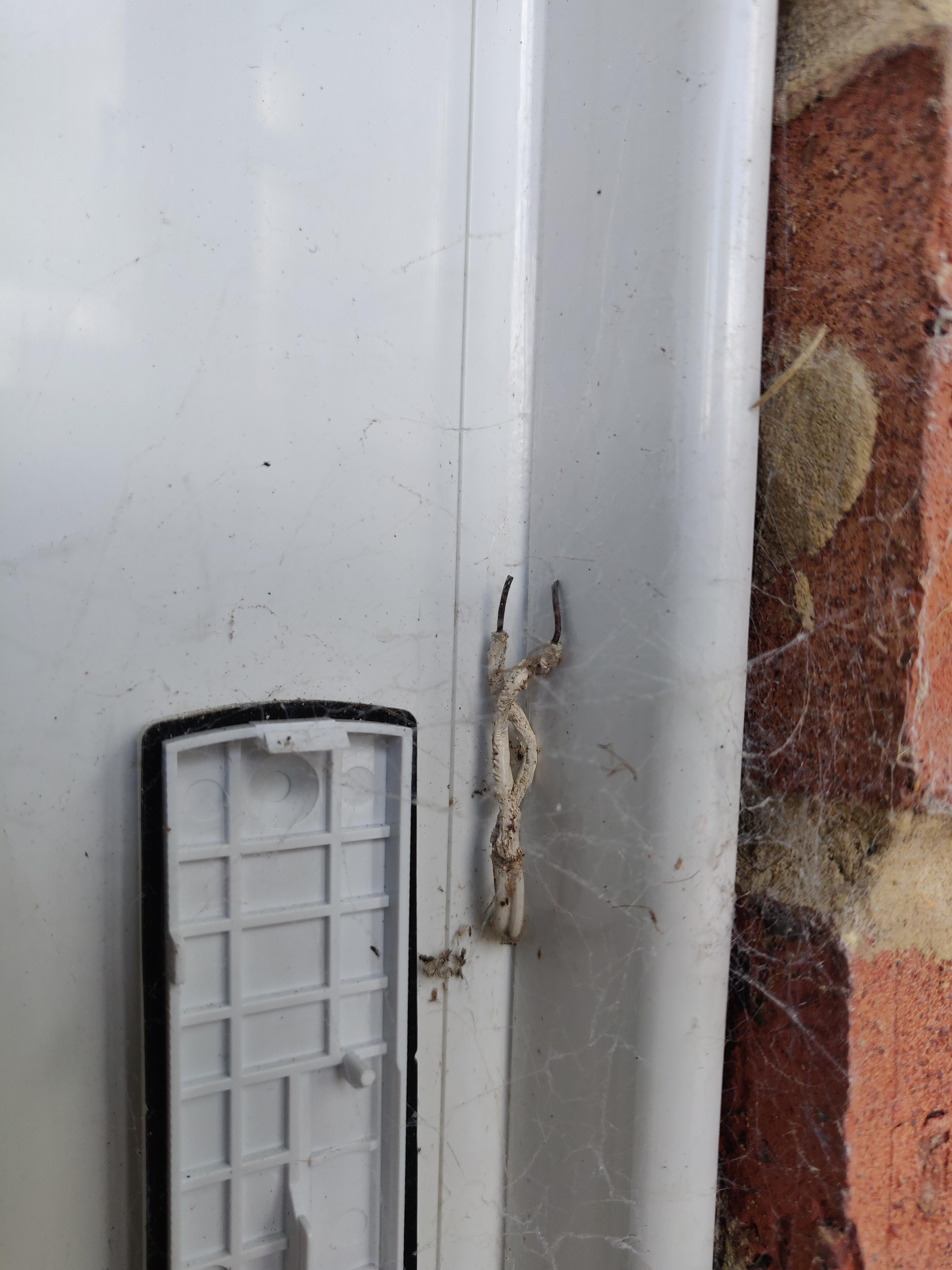

I was hoping someone might be able to confirm whether or not this old Doorbell is mains powered or battery powered and therefore safe to remove and leave the wire in the wall? I presume it is battery powered but would like to be sure before I cut the wire!
Do you mean just at either end of the gravel board or the entire length?
Hello, I'm looking to replace my concrete post fence which presently is leaning in all different directions. I want to do a proper job and make sure that the fence remains level. As the fence panels will sit upon a gravel board, I wanted to know the best way to make sure that the gravel boards don't sink - even slightly, as I want to top of the fence to run through. I think it would be overkill to pour a strip of concrete beneath the gravel boards so wondered what else might be suitable?
