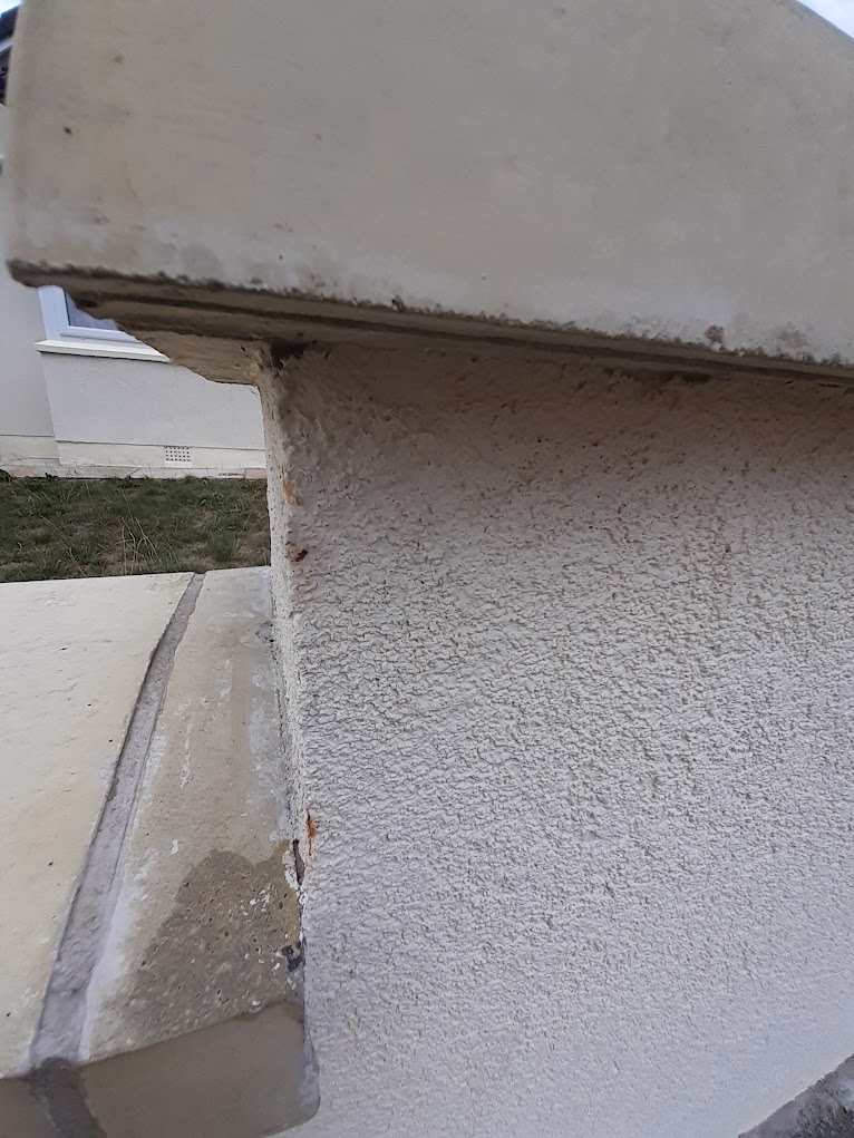

	Advice Sought About Cleaning Products and MethodsDaniel3103 replied to Daniel3103's topic in Building Materials Yes, the render is new. It was laid last year, and I have already had someone make the same comments as you, about using a metal bead rather than a plastic one and the rust being liable to come back. However, the rust hasn’t spread again since most of it was cleaned last winter – so I’m keeping my fingers crossed, maybe it won’t spread again soon…

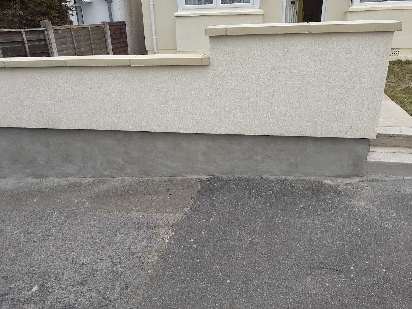

	I have just seen your advice, but I have already done the painting by now. The pavement is in a poor state anyway, so I am going to leave it as it is. It doesn’t look any worse than in front of the neighbours. Here is a photo of my now-painted wall:

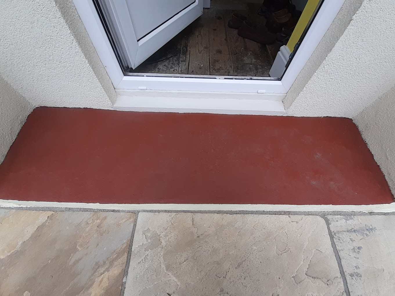

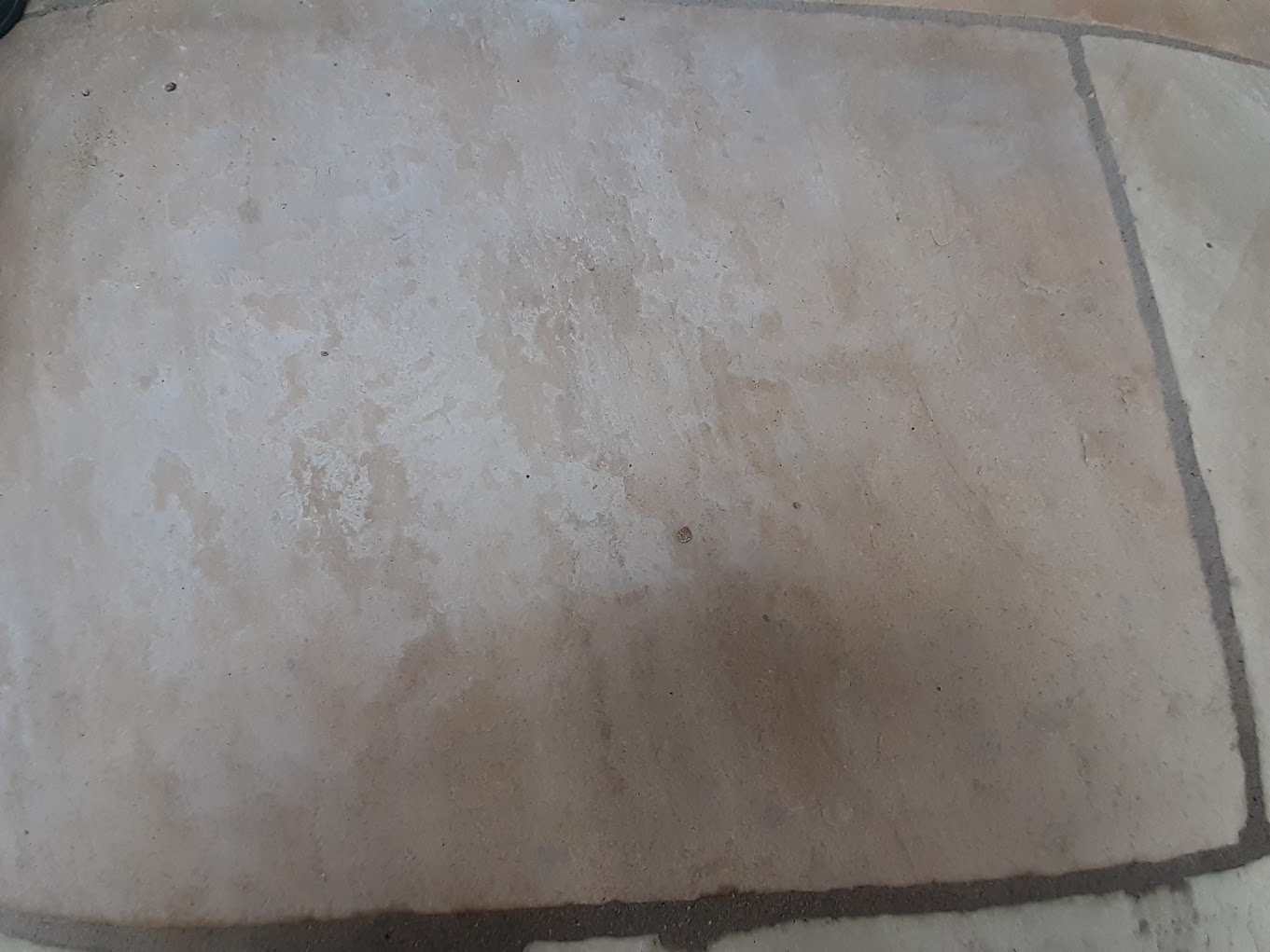

	Hello, I have three outside areas on my property that I am trying to clean, but it appears that they need specialized cleaning products or methods and I don’t know how to go about these jobs. I am posting here to seek advice from fellow members of this forum. The three problematic areas are illustrated by the photos below. 1. Some rust is appearing on the rendering on a corner of my outside wall. The rust used to cover the whole length of the corner. I have had it chemically cleaned by a professional company, and they have managed to reduce the extent of the rust to the two small patches that you can see on the photo, but they told me they couldn’t remove those two patches. They also told me that if I didn’t do anything further, the rust would spread again. They advised me that the rust was leaking from a metal angle bead fitted underneath the render, and that I needed to put a barrier coat over the rust, and then put some paint over that in the same colour as the render. Can anybody here advise me about where I can find something to use as a barrier coat, and something else to use as a render-coloured paint to put over it? Does anybody know of any good products to use? 2. My door landing is painted with a red textured paint, and it is easily gathering dust and earth that is sticking to it. I have tried to remove it both with a dry duster and with a damp sponge, but to no avail. Any idea how I can get rid of it? 3. Some slurry powder has fallen onto an Indian stone on my patio and is sticking to it. This happened when I was mixing slurry powder with water in a tub in the area. I put a dustsheet on the ground as protection, and that limited the damage, but some slurry powder still found its way onto the Indian stone, and now I can’t remove it. I have tried both a dry brush and a damp sponge, but it hasn’t had any effect. Any idea how I can get rid of that powder? Any useful advice would be appreciated.

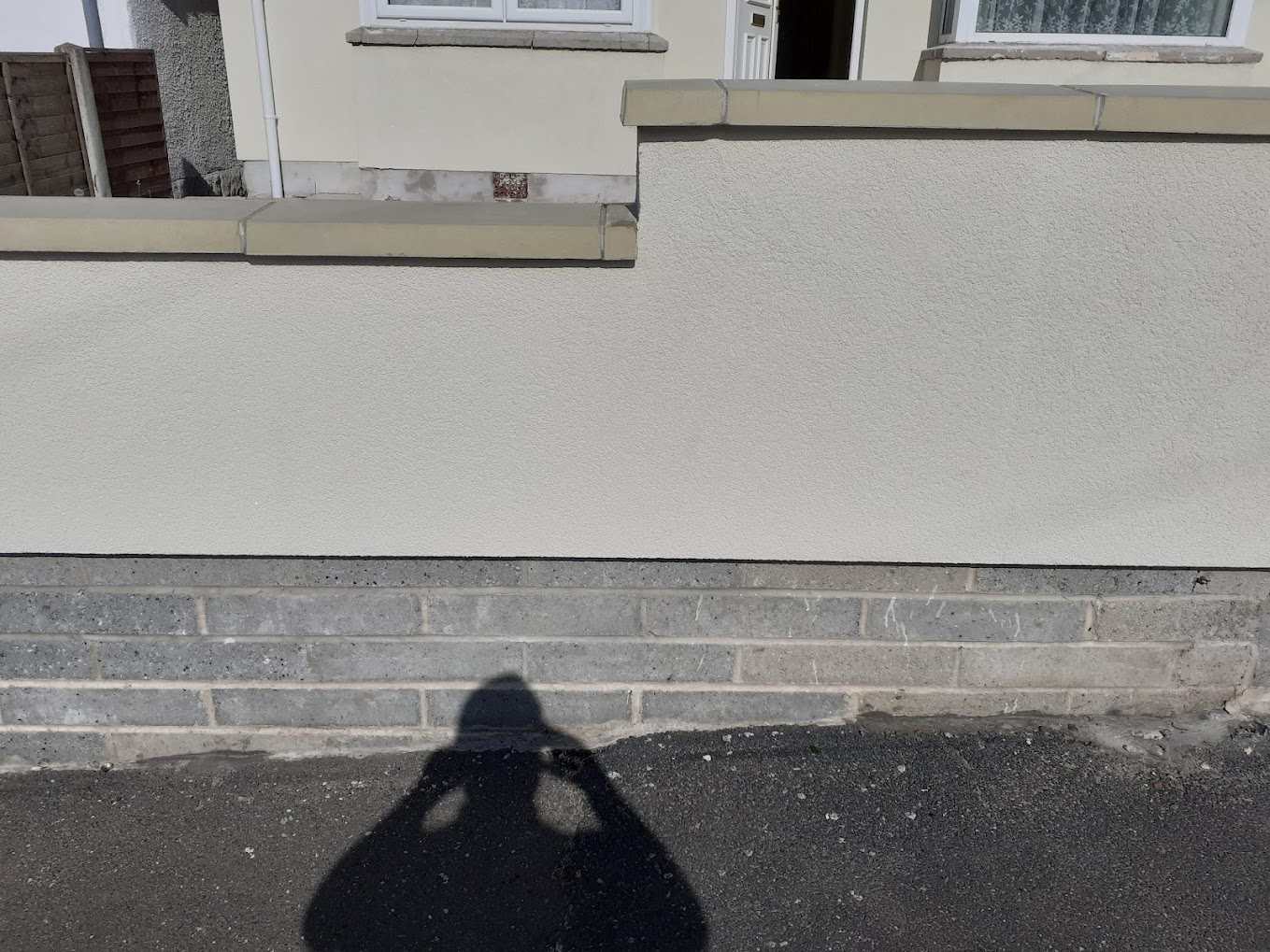

	Thanks for all the advice. RE slurry - is this available from local DIY shops? RE efflorescence - I’ll look into it. This would make sense, since the wall was built without a damp proof course, so water could rise through it and leave salts behind. Or maybe wates is dripping from the render above, then onto the blockwork below and leaving salts behind. That latter possibility could explain the fact that the white marks appear as streaks rather than patches. I will research efflorescence and see what treatment I may need before painting the wall - but maybe someone on this forum can advise further about this?
	Hello, I have some blockwork that is apparent underneath a couple of rendered walls. The photo below shows one of these places. I would like to paint the blockwork, and I am looking to use a light-coloured paint to make it look similar to the rendering above. I have two questions: 1. White streak marks sometimes appear on the blockwork. These marks are vertical. Any idea what they are, and do I need to do something about them? 2. If I use masonry paint, will it make the surface look homogeneous over the blocks, hiding the individual blocks and the mortar between them? Or do I need to spread a layer of cement over the blocks first?

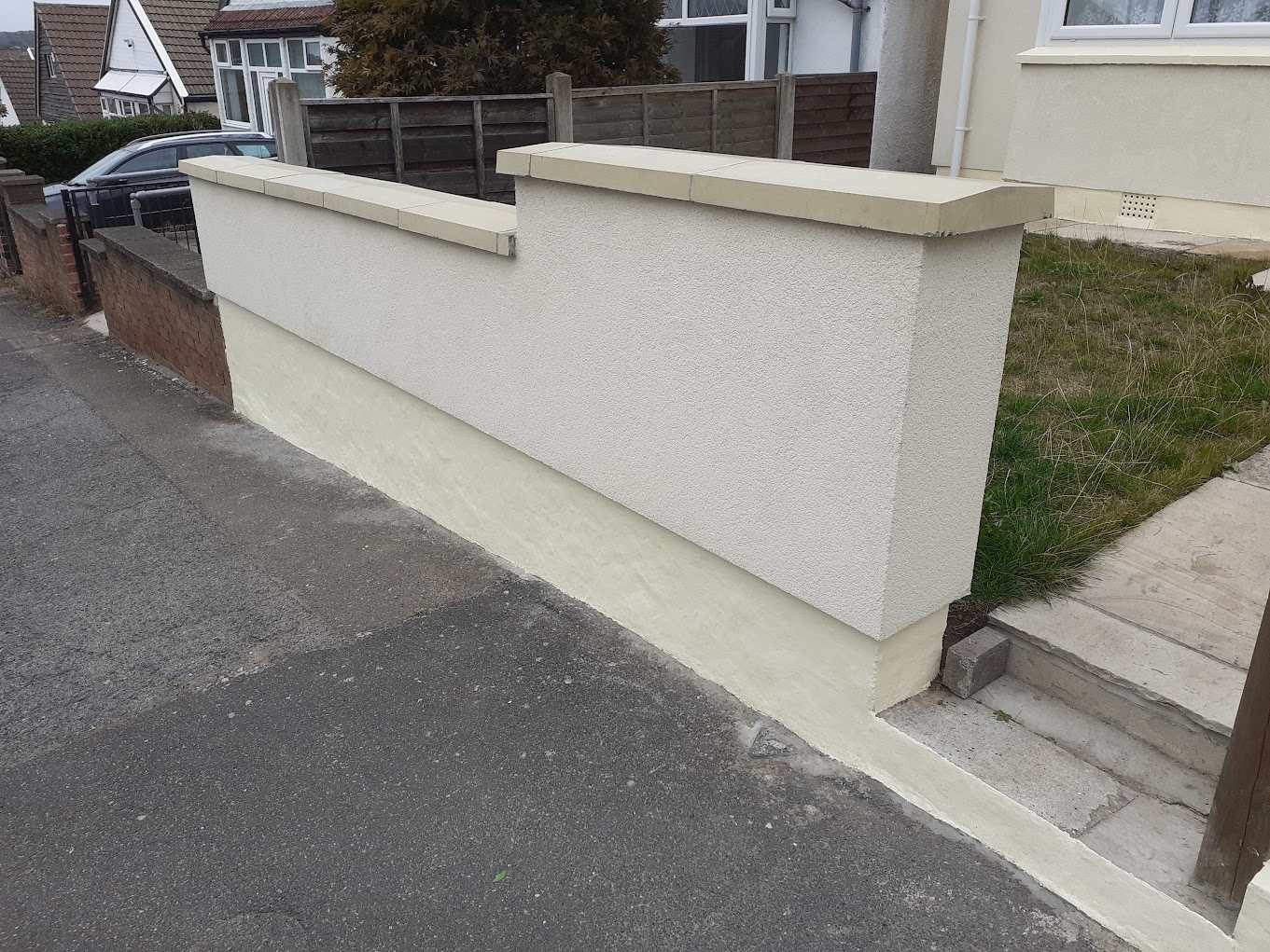

	dirty water marks on new renderingDaniel3103 replied to Daniel3103's topic in Plastering & Rendering Thanks to those who have responded! I was never notified of the responses, so I only noticed them today. Now, to answer your questions. The render is Silicone K Rend TC15. As for the grooves in the coping stones, I have now figured out what the problem is, with the help of some advice I have received. These grooves should be above the overhang, but they are actually above the wall, as you can see from the photo below. So, it now seems to me that I need to cut new grooves into the lower surface of the coping stones, between the wall and the edge of those coping stones. Does this seem sensible to others here? What kind of distance should the new grooves be from the wall, or from the outer edge of the coping stones?
	Hello, I am posting here to get advice about dirty water marks that are appearing on my new rendering when it rains. Recently, I had my boundary walls and the front elevation of my bungalow rendered. I was happy with the job but, every time it rains, the water makes vertical marks on the rendering when drips run down against the walls. Those marks start about underneath the joints between the coping stones, and they can go all the way down to the ground - as you can see from the photo. It is worth noting, however, that the problem doesn’t happen under every joint and that there is sometimes a slight offset between the joint and the vertical line underneath. Also, on the other side of the wall - not shown on the photo -, the water makes a vertical line that is close to the middle between two joints. All the marks disappear in a few days after a rainy day, and they come back at the next rain. I thought the problem was happening because the joints between the coping stones were not waterproof, so I coated those joints with a waterproof layer, but that didn’t change anything. So, my questions are: -Do these dripping marks indicate a problem that is more serious than just the cosmetic issue? -Why is water dripping from specific points at the top of the walls, not from everywhere along the walls? -If I need to do something about this problem, what can I do without causing any collateral damage? As you can see on the second photo, the same dripping problem is also happening on my bungalow’s front wall, below my windowsill which is cracked and hasn’t been painted yet.
