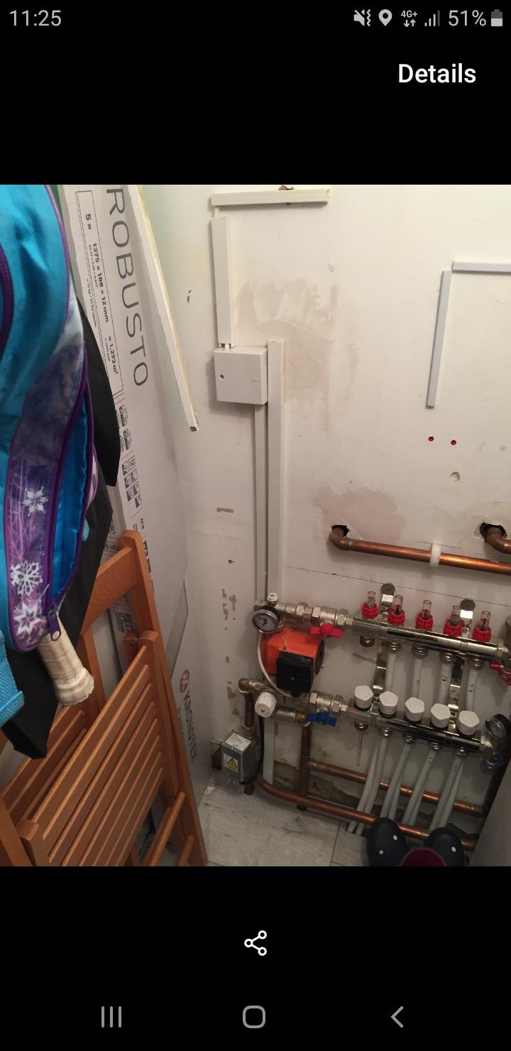

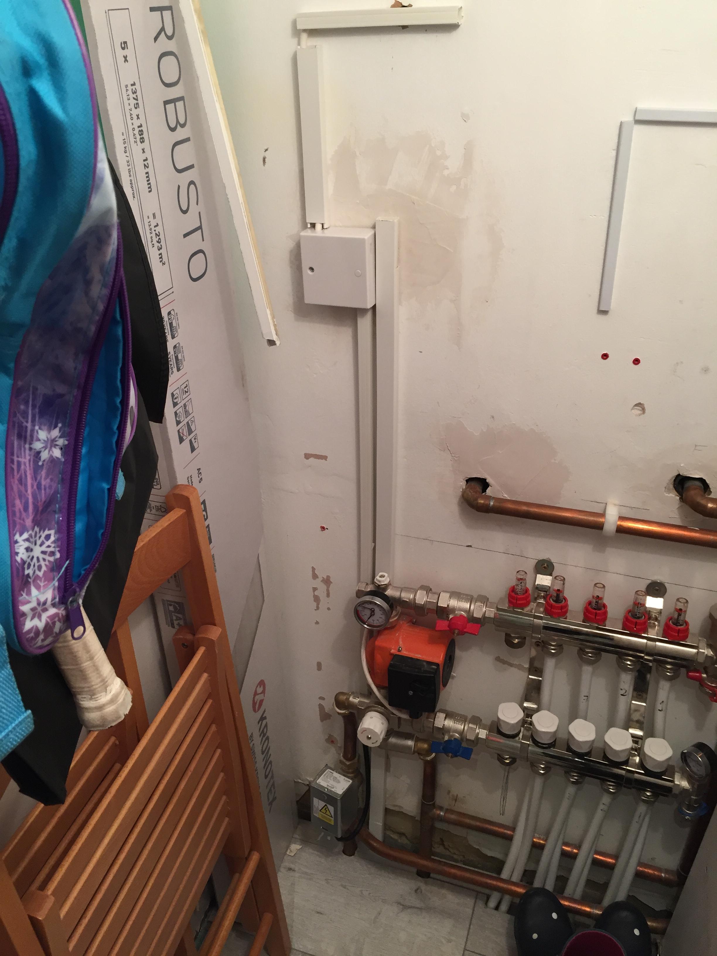

2

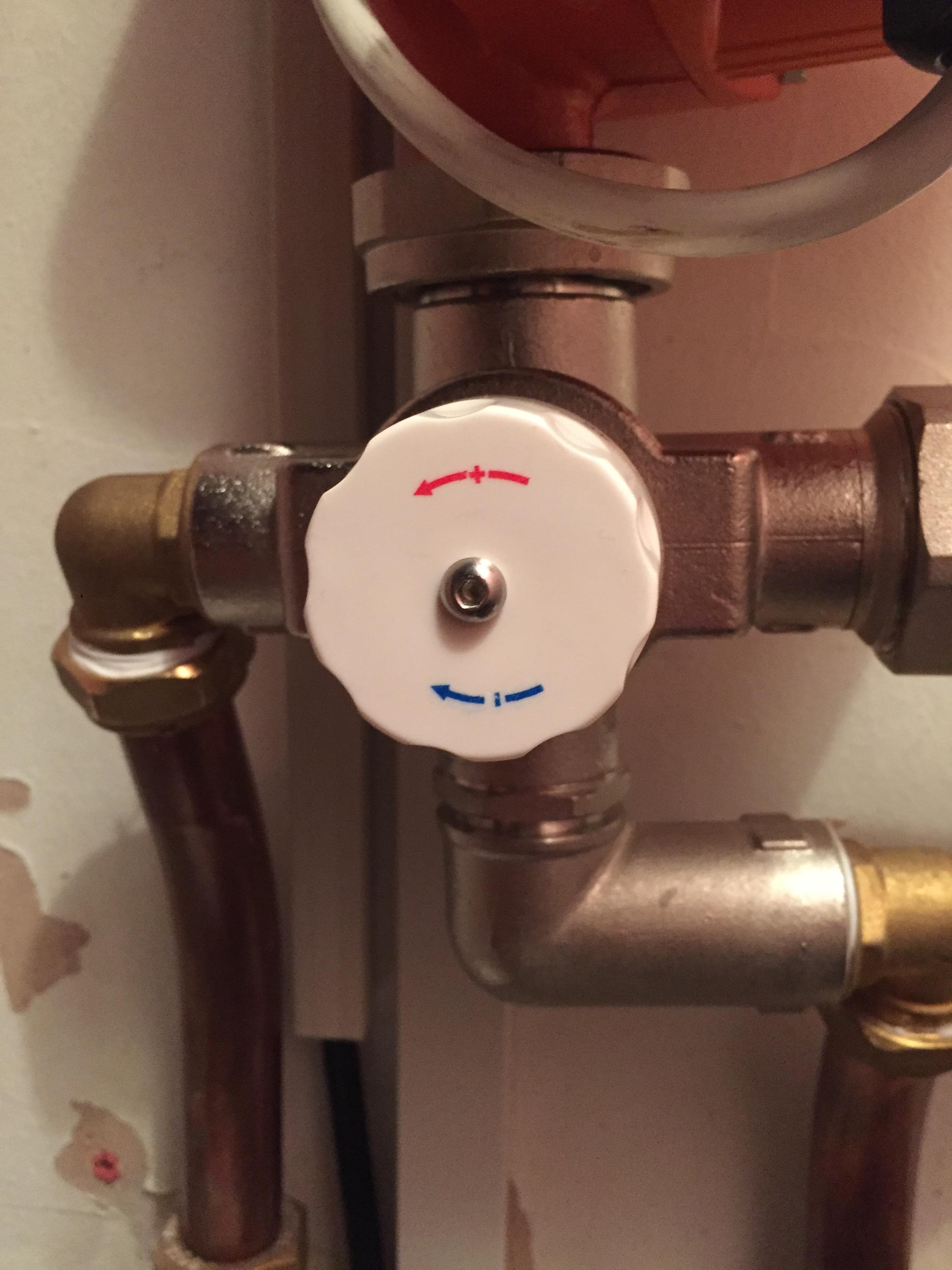

  1. Thanks. Found the issue. Flow and return piped incorrectly on mixer... see my response to ProDave. thanks for your help Team DIY.
  2. Spot on. I have just removed the mixing valve and the pump to learn that the plumber installed the boiler flow into the boiler return... so annoyed. I have been battling with this issue for ages and was assured on numerous times it had been done correctly. The indicators are on the bottom of the valve so without removing it, t’was hard to see. thanks for your help. I now somehow have to reconfigure the pipes which is going to look super untidy.

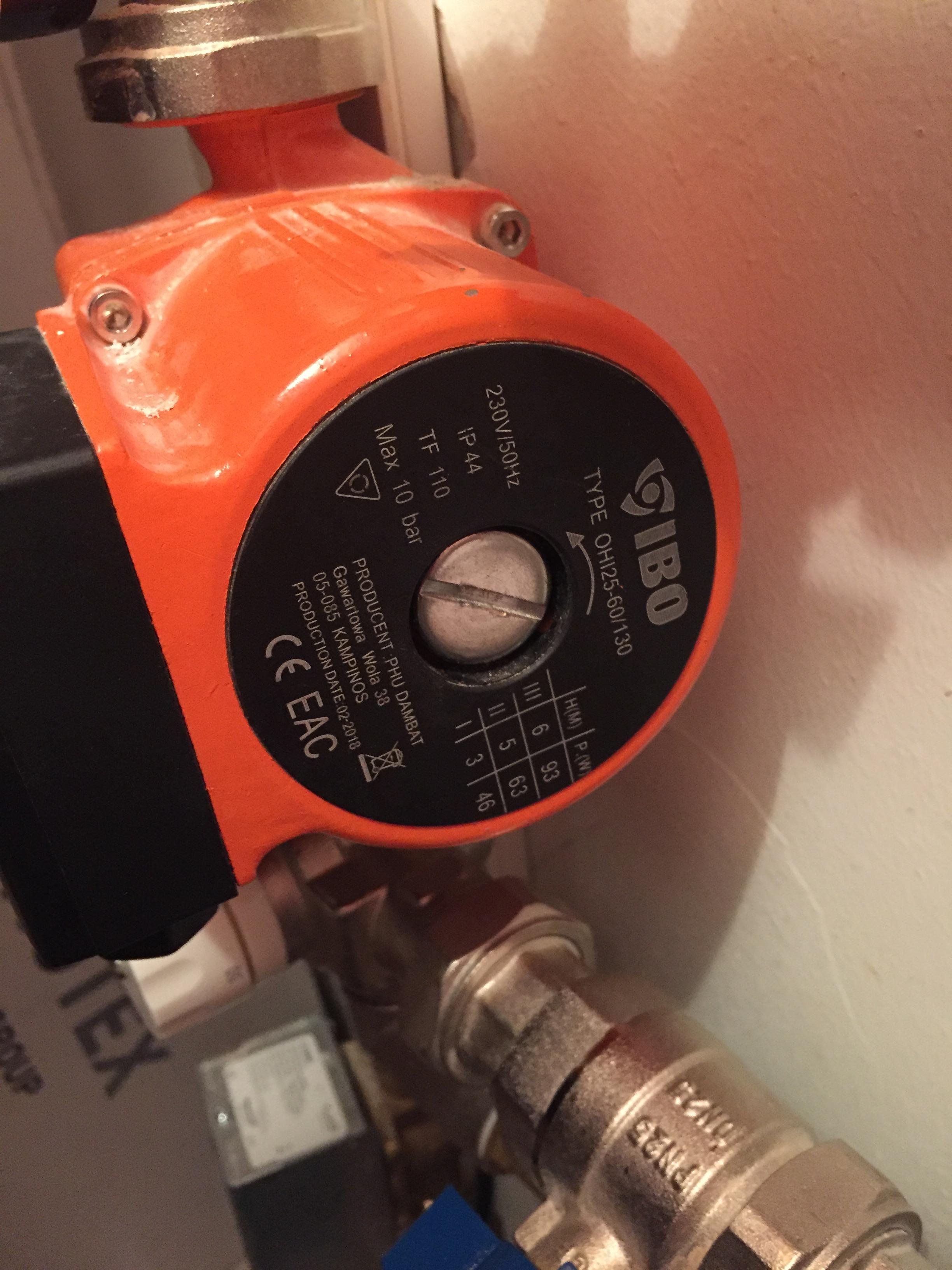

  5. The pump keeps running. I am completely bamboozled. I think it might be an issue with the blending valve.
  6. Flow and return are plumbed in correctly and UFH works as it should once i have done my routine with the blender valve of lowering the temperature and then gradually increasing it... I have checked the pump direction and flow and return from boiler and all is installed correctly.
