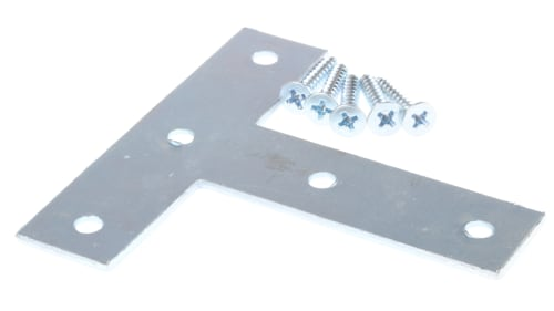

I'd like to hang a gas central heating vertical radiator on a single timber stud behind a thin plasterboard wall. The stud is 38mm wide (actual size) and (presumably, difficult to measure) around 75mm deep. The radiator would weigh around 35kg in total, spread across a number of screws which can vary between four and ten (I have some freedom with that). Would that be ok? If yes, what screw size would you recommend? Thank you.

Thanks! Given the fact that the weight of the empty radiator will be between 10 and 20 kg, would you have any advice about which gauge the steel plates should be?
Hi, I have an internal, decorated plasterboard wall with poor studding: from left to right, there is a 22mm wide (i.e., horizontally parallel to the wall) stud, then a 38mm stud (the two studs are spaced 60cm), then the jack stud of the door. I need to hang a ~2500 BTUs radiator, and I'd prefer to avoid both hanging on plasterboard and adding battens/noggins to fix the brackets. So I thought to fit a vertical radiator (total width 27cm) by fixing all the four brackets to the 38mm stud via steel plates/flat brackets similar to this one: Would that work or be doable? Any suggestion welcome.
