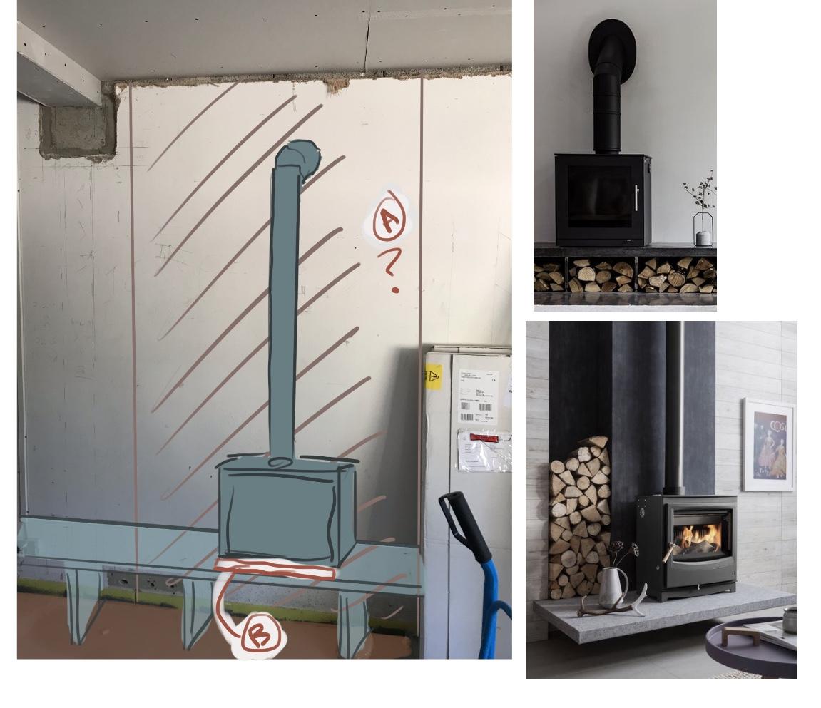

  3. Hey all, Please excuse the very not-to-scale drawing but it gives the idea. We're looking to install a stove like the ones pictured and I'm looking for advice on: A ) Correct material to use behind the stove. At the moment it's rendered block work that we where going to dot-dab and plaster. But I'm not sure if that would count as a combustible material and so shouldn't be that close to the stove - and even if it is suitable if the paint wont crack from the heat of the stove. What's best practice for a wall behind the stove? B ) The stove will be on a concrete shelf like the ones pictured. But the floor beneath that will be engineered timber, how much of a gap do we need to leave between the edge of the stove, the plinth and the floor? Many thanks, Matt
