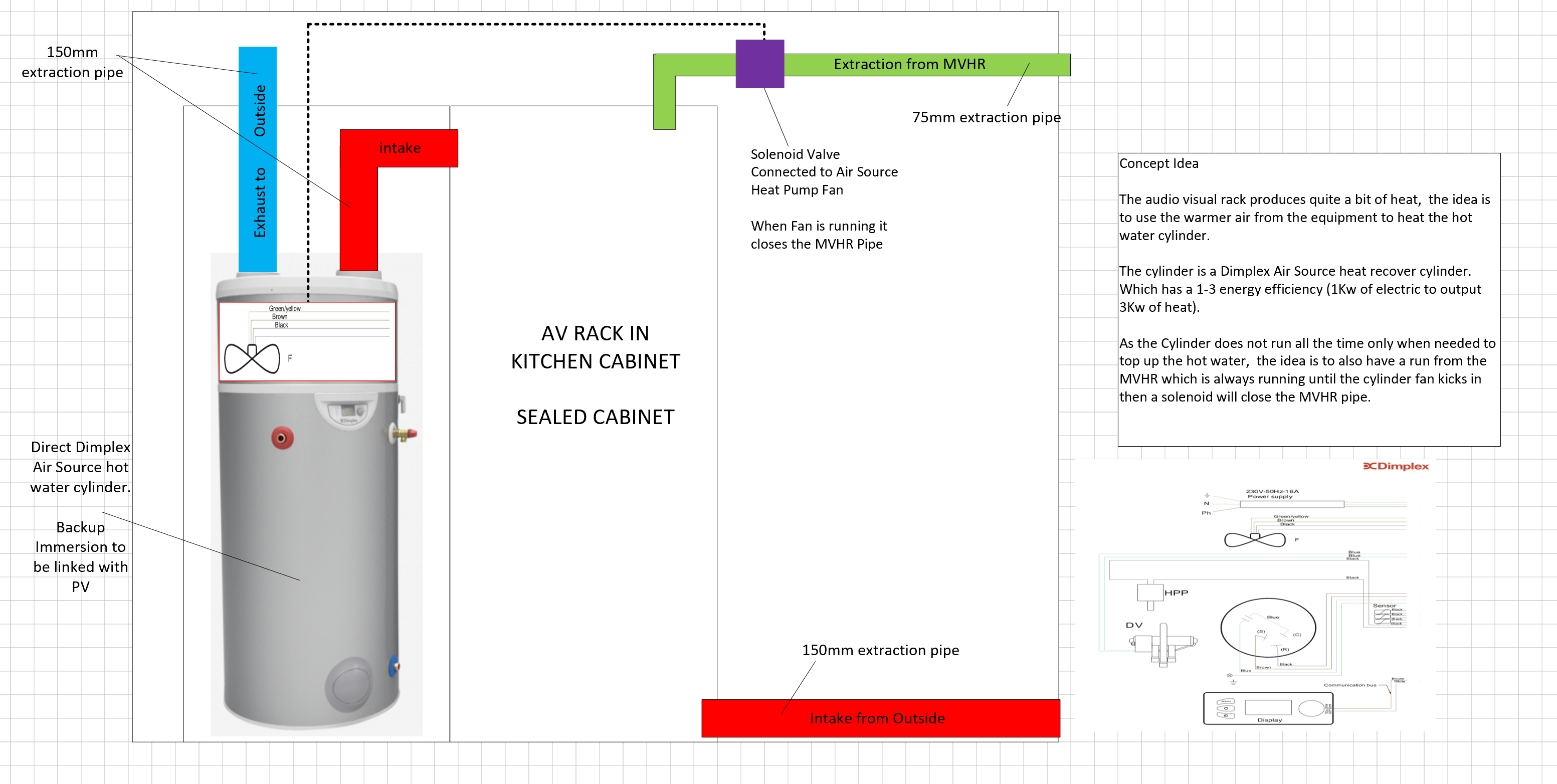

  1. So instead of ducting into the AEHR and the MVHR just have it ducting into the house then let the MVHR and AEHR do their normal thing... as the heat will recovered anyway in the envelope of the house... So just use some basic fan on a thermostat that sends it back into the house... Love the idea of the filters... What about the summer months I was thinking the MVHR would be on bypass mode and just chuck it out the house... Would the house MVHR do the same also as its venting the house? Thank you. Mick
  2. I am also thinking about the adjustment in air temperatures because of the cabinet and flow through the warm house... Would there be any, I get that it will contribute 0.2%, but because of the input fromqoutside running through a cabinet inside would there not be an increase in air temperature? Lets say outside was 10c but because the air moving through the house into the cupboard and then into the exhaust intake at the top would there be no increase in temperature that is useful to the AEHR ? there is massive difference in heating times based on AEHR temperatures. And it would keep the equipment cool which has a value massively above the MVHR and the AEHR... Thanks for the replies. Mick
  3. this is another great point, the heat build up that I have in my current rack (35C-40C) I'm guessing is a build up of the heat over a time, and with effective extraction this would therefor be much less heat because its not stale air in the cupboard. correct me if wrong - which would also mean the cupboard with effective air flow would not do much for heating because its a very small amount being actually generated by the equipment, just feels like allot because of the buildup happening over time. Thank you
  4. Hi Nick, Thank you for your reply. Correct, the cylinder is a EAHR. This is exactly the kind of information I am after, Dust, bugs, and the effect on the equipment for the high velocity air flow. Playing devils advocate the Cylinder has a cold to 60c time of around 4-6 hours at 23c (12 hours at -5) without immersion just using the EAHR. And this is generally only after holidays and on initial startup. I called Dimplex and they told me depending on the exhaust temperature, top up is usually only a few minutes up to 15 minutes at -5 degrees (this is not in the manual, this was a direct discussion with technical). being honest I don't know how often top up will occur - maybe another call to technical lol... I completely get the high velocity of air flow in the AV rack and around the components, and as you said dust is the biggest worry as dust and electronics are a no no. Because of the general short bursts of velocity Air intake would it still be so bad. most of the time the MVHR will be taking the heat at a much lower velocity (which I don't know yet). The Yamaha A2 is a fantastic amp with awesome sound and the KEFs are a much better fit, got to keep the neighbours happy! My SR7013 AV amp gets so hot you can just about touch it... its just the nature of the beasts! Thank you very much for the reply.

  6. I think we are digressing a little, I don't have a problem paying my bill or what the costs are, but all AV racks generate quite allot of heat because they allow you to consolidate all your equipment in one place, we don't need to have regs to know that putting 30 pieces of equipment that would normally be spread across the home in once place will generate heat. My current cupboard hits around 35-40c and then the extractor fan kicks in... (very inefficient pumping it out the house). I am trying to find out if my design will help with cooling the equipment and also use the inefficient heat generated in an efficient way by helping to heat the home and also heat the hot water. EDIT I should mention: I have two pieces of equipment going in Air Source Heat Pump Cylinder - this is for hot water has a heat pump built in the top of the cylinder Vent Axia - MVHR But more importantly I was after finding out if the design works, there is solenoid valves, sealed cabinets, I need to know if the design in the way the heat recovery will operate in the AV cupboard. I will be running a 150mm duct from outside air to the cupboard as I am nervous to create a vacuum in the utility room this is going to sit in. But I do appreciate all your comments they are very informative! Mick

  13. Hi All, I am in the last stage of completing on a house, So I have started the design of electrics, audio visual, and Lutron lighting throughout. The issue I am having is I don't know much about MVHR and ventilation, I have done lots of reading but wanted to ask an expert that could guide / critic my idea. Design Features: Dimplex Air Source Heat Pump Cylinder Use the warm air from the Lutron and AV Rack to help heat the hot water. Connect the MVHR to the AV rack cupboard, to utilise the heat recovery when the cylinder is not running. 150mm pipe from the Cylinder to the AV rack top part (heat rises) 150mm Pipe from outside to the AV rack to allow cool air to be pulled in and cool down the equipment. AV / Lutron Rack to be sealed in using rubber, and the whole cupboard the rack sits inside to be completely air sealed. MVHR Pipe will have a 75mm Solenoid valve that connects to the Fan cable of the Air Source Heat Pump - when the fan is running the normally open solenoid will close. I have created a drawing, of the proposed system which will explain my idea... So what do you think, and thank you for your time. Mick
