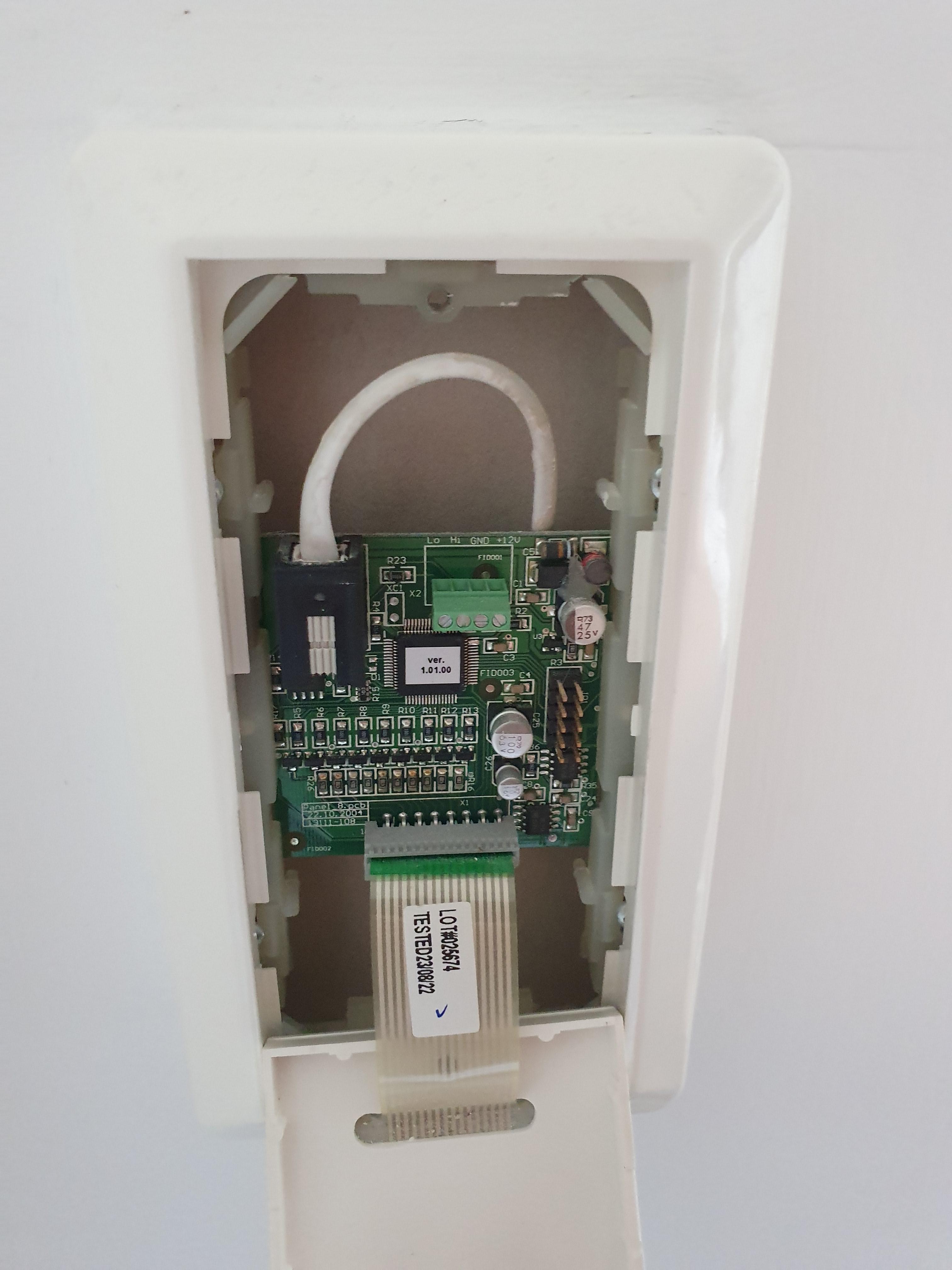

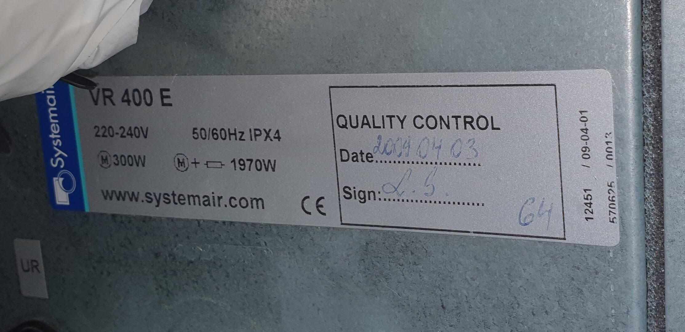

I meant to add, comparing power consumption to flow rates I get the following values: Mode Power Consumption Flow Max 320 100% Normal High 182 92% Normal Low 152 80% Min 95 47% I need to dig back into the unit and see if I can find the elusive dip switches and rotary dial so the speed can be more accurately controlled. -

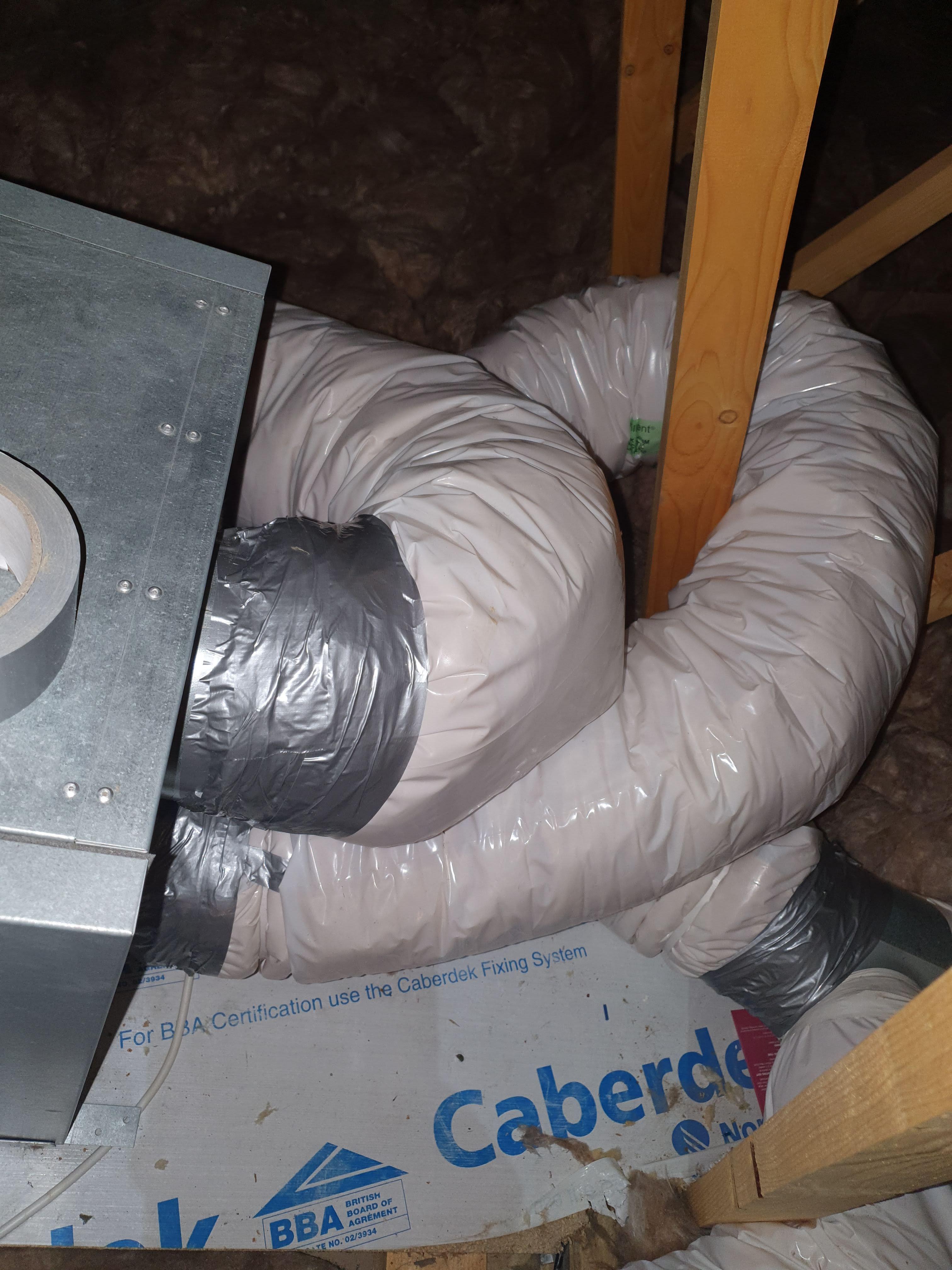

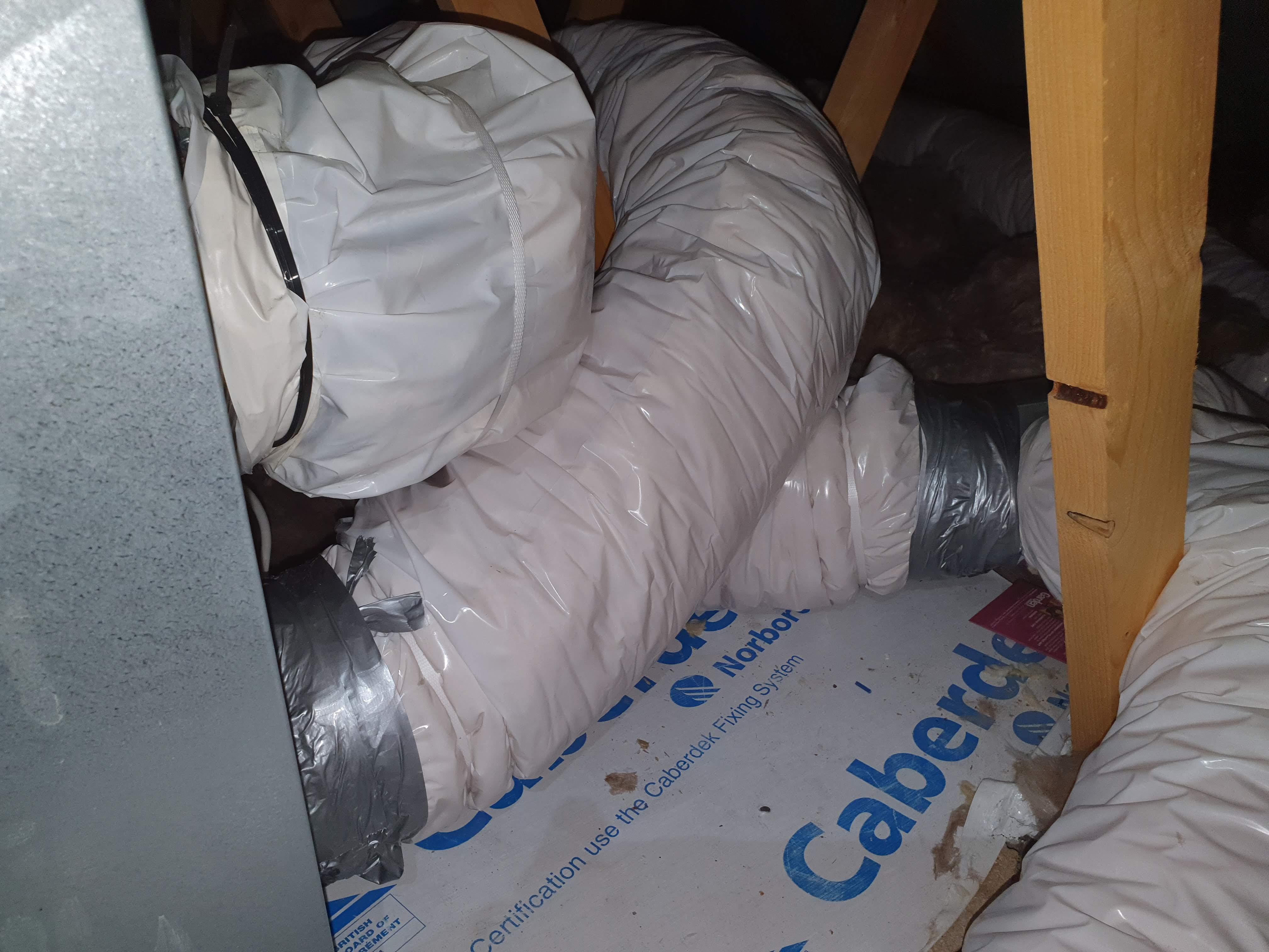

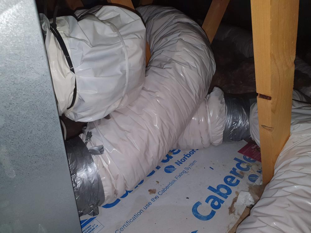

The acoustic duct arrived today and in Villavent land the only thing which identifies this as different from normal duct is a small green sticker on it. I am therefore guessing the lovely acoustic duct is installed under the insulation on its way to the silent bedroom. It would be far easier if the entire white membrane had a green streak in it to clearly mark it out as a silencer. This was relatively easy to fit and I made sure it went around a bend as per the instructions: After turning the unit back on the only thing to be heard was silence, so noise problem solved! I feel much more confident navigating the unit and ducting now, so decided to tackle the main extract duct at the top of the picture. I knew it wasnt properly connected but removal revealed another horror show: I removed all of this, stretched the semi-rigid duct and smoothed the curve (as much as I could) before reattaching: Powering back on the extract was noticeably more powerful especially into the bathrooms with the incorrect terminals! I managed to balance everything out on Max to the following levels: Extract Flow Rate Inlet Flow Rate Master Bedroom 10 Master En Suite 8 Dressing Room 8 Bedroom 2 6 En Suite 8 Bedroom 3 8 Bedroom 4 8 Bedroom 5 6 Bathroom 8 Hallway Kitchen/Family 13 11 Porch Hallway Dining Room 8 Office 7 WC 8 Utility 10 Total 63 64 It is now lovely and quiet everywhere, even on Max. One thing I have noticed is that the unit is drawing even more power. Despite improving the ductwork significantly it is now consuming 180W on Normal mode and 320W on high! The temps have dropped over the last week or so and it was switched from summer bypass to heat recovery. I noticed the control panel has an error on it indicating the rotor motor has failed. Dismantling this I found the bearing was seized so I managed to loosen this with some WD40. I am not holding out much hope and I think the motor will need to be replaced along with the filters in the coming weeks. This unit was introduced back in 2009 so it is lacking any smart features and the only control is via the wired control panel (which lives in our utility). I have therefore fitted a smart plug and that combined with the air quality monitor, temp/humidity sensor and IFTTT means I can start to automate its usage such as making sure the unit is running if humidity in a bathroom increases, or CO2 in our bedroom starts rising above a threshold. Because of its high power consumption I still think opening windows is preferable at this time of year, so the unit can be left off all day and switch on/off depending on various input conditions. -

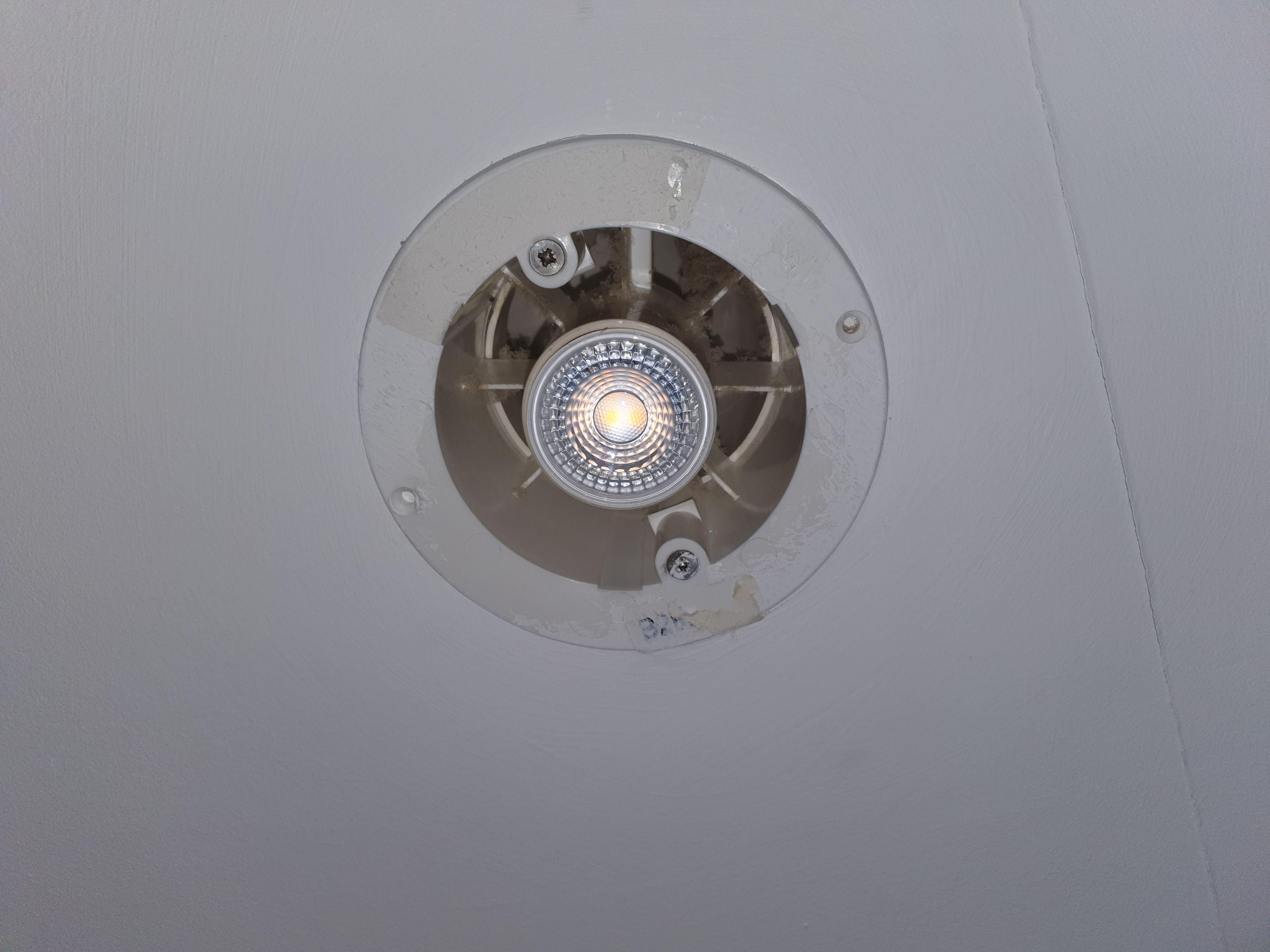

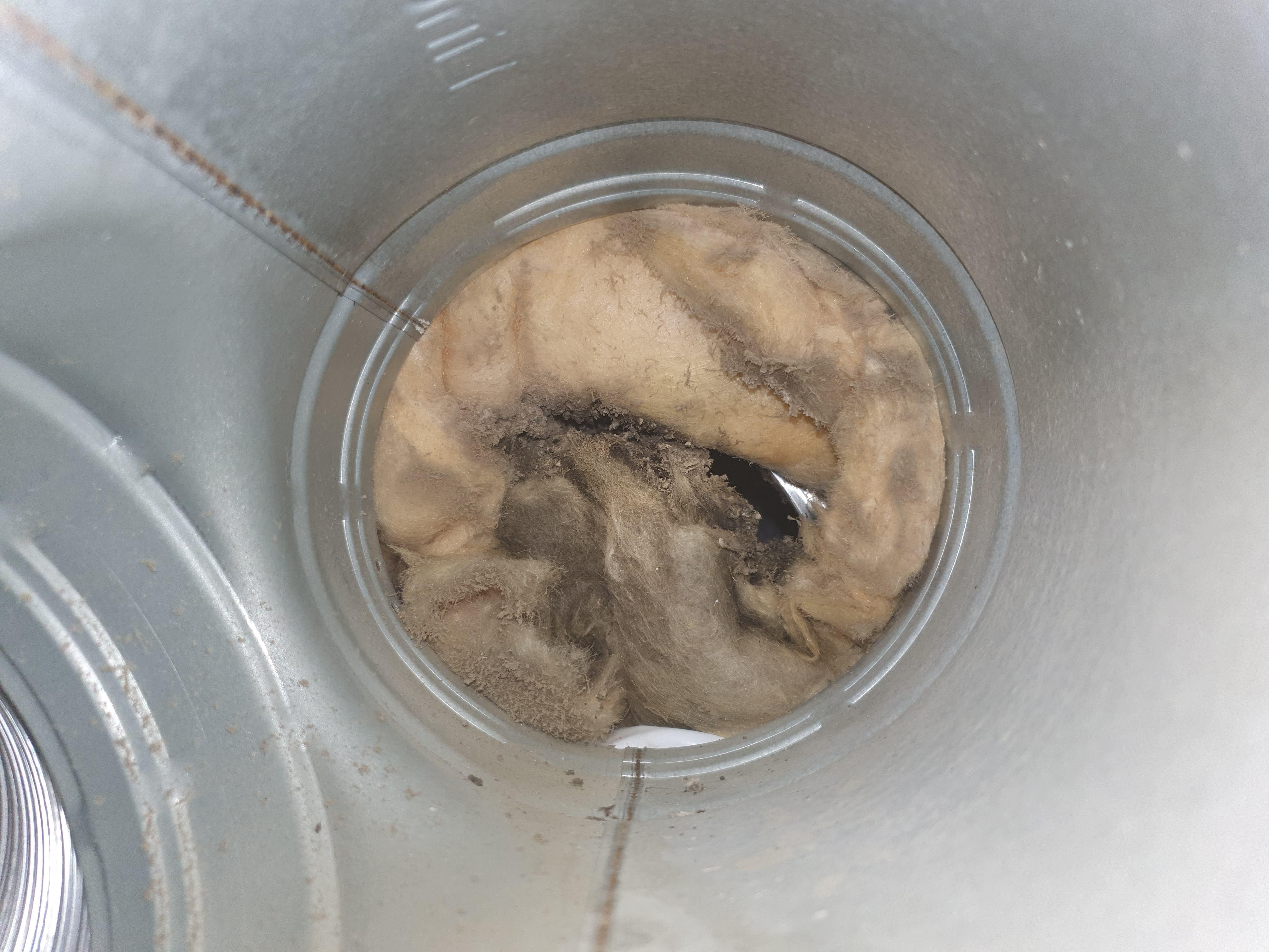

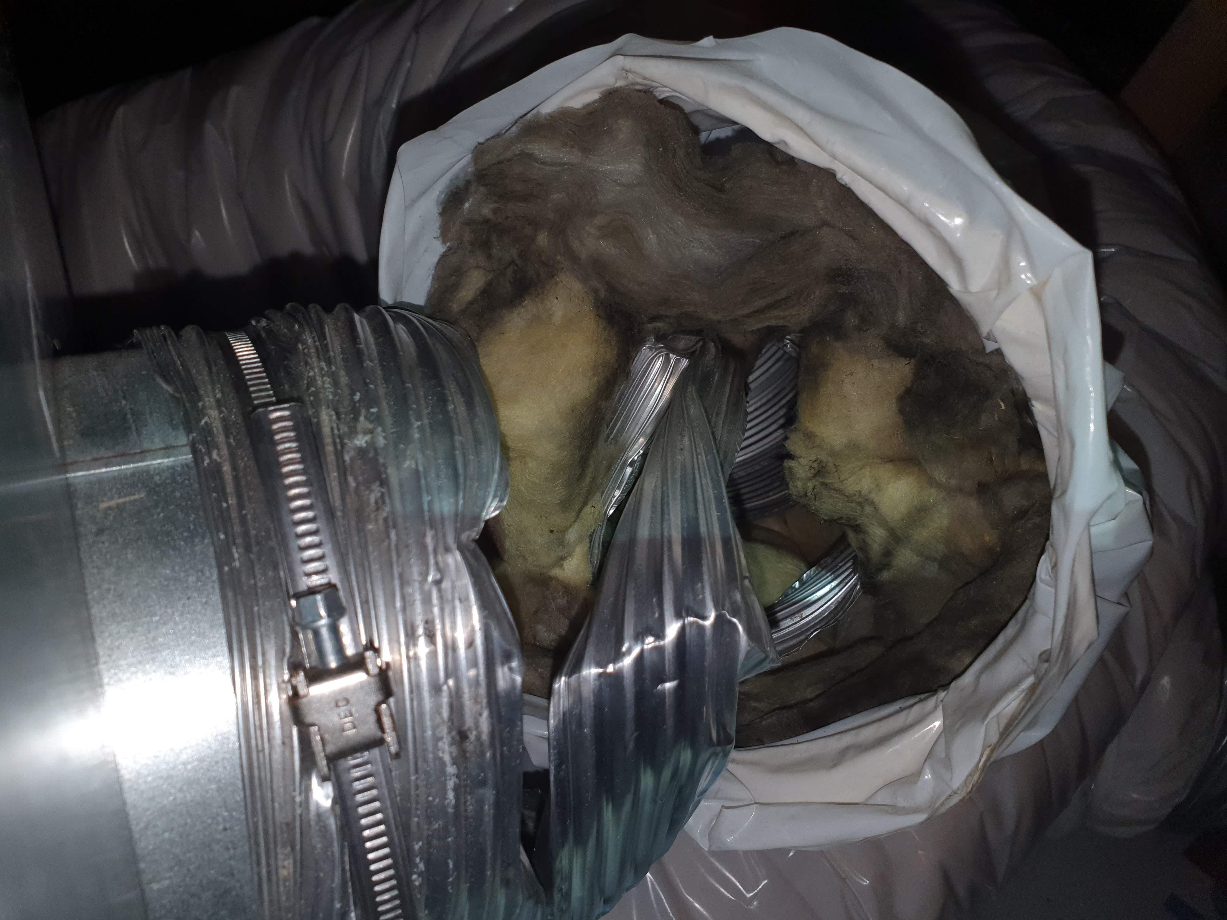

To answer my previous question I dont think you do. My voyage into the world of mvhr has uncovered some lovely installation/service bodging. I managed to acquire a testo 405 and attempted to balance the house but this proved almost impossible because the bathroom extracts were all near zero. Venturing back into the loft and tracing the extract pipes I quickly realised the bathroom fitting needs 100mm pipe but the t-pieces used were 125mm. Their solution was to use insulation to pad the 100mm pipe up to 125 and tape it in place! I also found the 90deg bends were not attached to the ceiling fittings so all 3 bathroom vents were extracting loft air (well, what could get through the insulation!). I am also not convinced the ceiling fittings are designed for mvhr as opposed to a simple extractor fan with the fan removed! All of the ductwork is beautifully insulated, except the main extract runs from the utility and the kitchen. So the warmest rooms were losing all their heat to the loft! All of the t and y pieces are uninsulated for some reason. It now seems quieter and the extract numbers are way higher. However I notice the main extract duct is attached to the mvhr in a similarly shoddy fashion so must be wasting loads of air velocity there as well. I tested the quiet room up to 13l/s and it was still perfectly quiet, so I think the noise we are hearing is motor related. I have therefore ordered a flexible silencer for the fresh air feed and will install that straight off the unit. Assuming this makes things nice and quiet i will then set about sorting the main extract duct and then go about re-balancing it again. It's really frustrating that this was supposedly serviced a few weeks back and was said to be tip-top when the engineer left... -

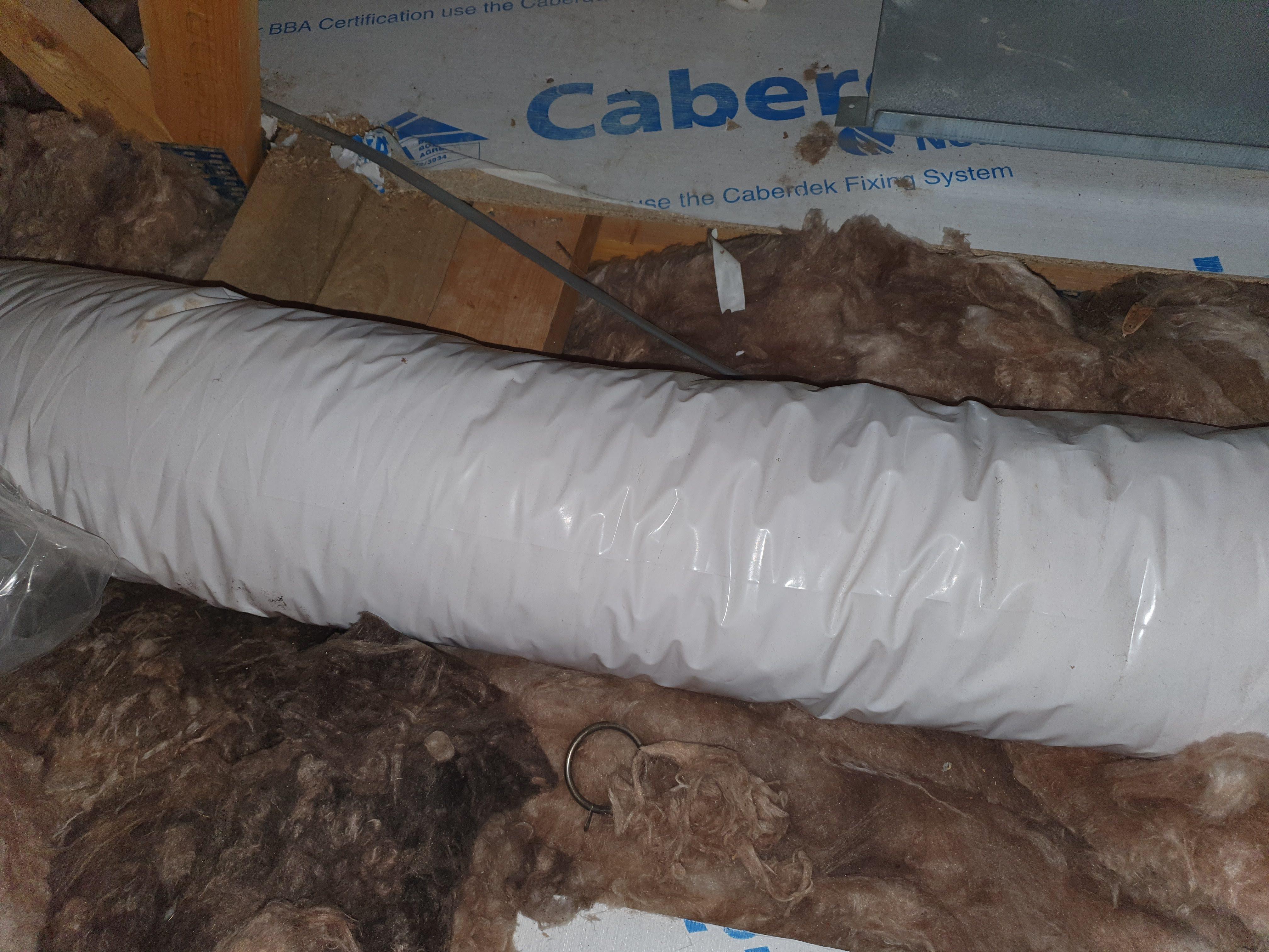

With the system on min and the vents opened up co2 peaked at 1205 overnight so better. However, the heater within the unit kicked in for some reason and it burned 9Kw of energy despite the house remaining >19c all night. I can see no evidence of that 8Kw in the room temps, they fell slowly and consistently all night... Out of interest, any idea what the white insulation wrapping is around the ducting, am thinking I might remove it to see if I can work out how to fit a silencer in the right place? -

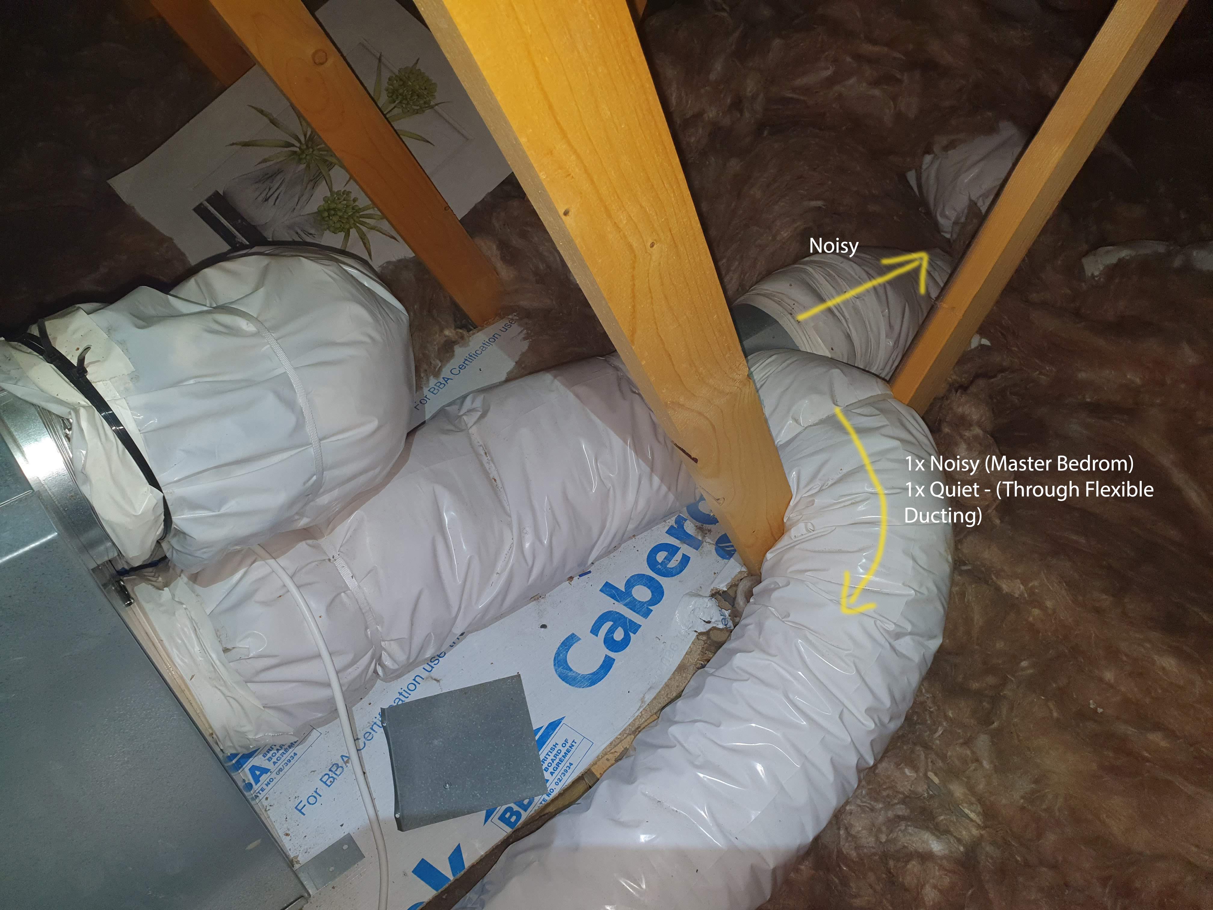

Thanks, I have opened all of the valves significantly and very scientifically; I measured each duct opening as the diammeter of my little finger! Tonight I will try running the system on min to see how CO2 levels rise compared to when the valves were almost closed. Sleeping with it on normal or high isnt going to happen anytime soon. Having looked at the ducting in more detail the first part is solid metal up to the first tee where it branches into 6 noisy rooms and another branch into 1 noisy and 1 quiet (through the flexible ducting). I think the proper place to fit a silencer would be before the branches which would silence all rooms at once. However, I am somewhat nervous taking it apart here. The branch to our room feels like insulated semi-rigid, probably in the realms of 75mm diammeter. As an experiment would it be worth me buying a small silencer, cutting this smaller duct and inserting the silencer into this section? The cost of the silencer seems quite low although I am unsure how I would join 75mm duct to a 125mm silencer? Alternatively, is this a terrible idea? -

Everything into and out of the unit is insulated and looks the same. Would a silencer typically be left uninsulated and therefore be obvious? -

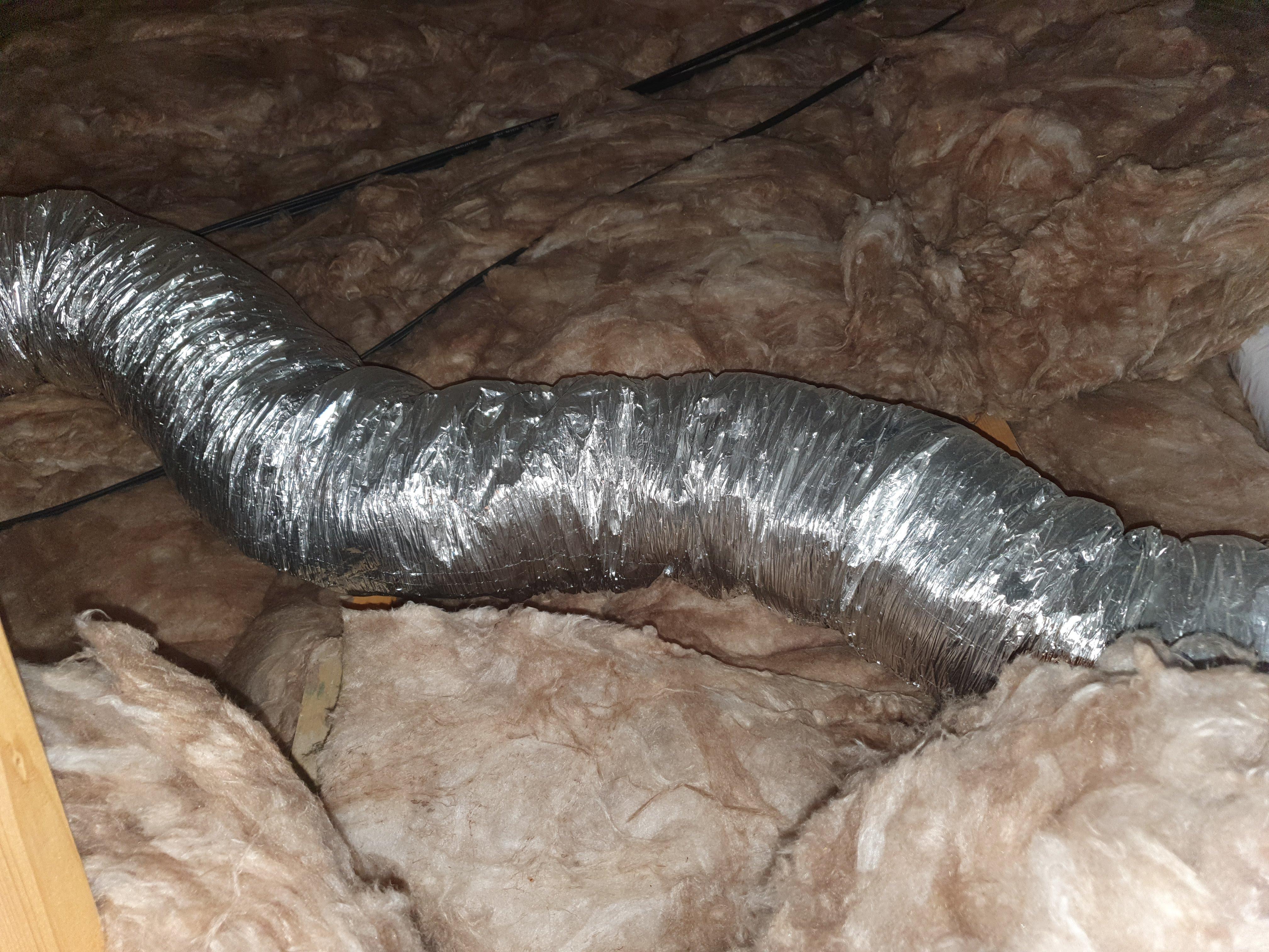

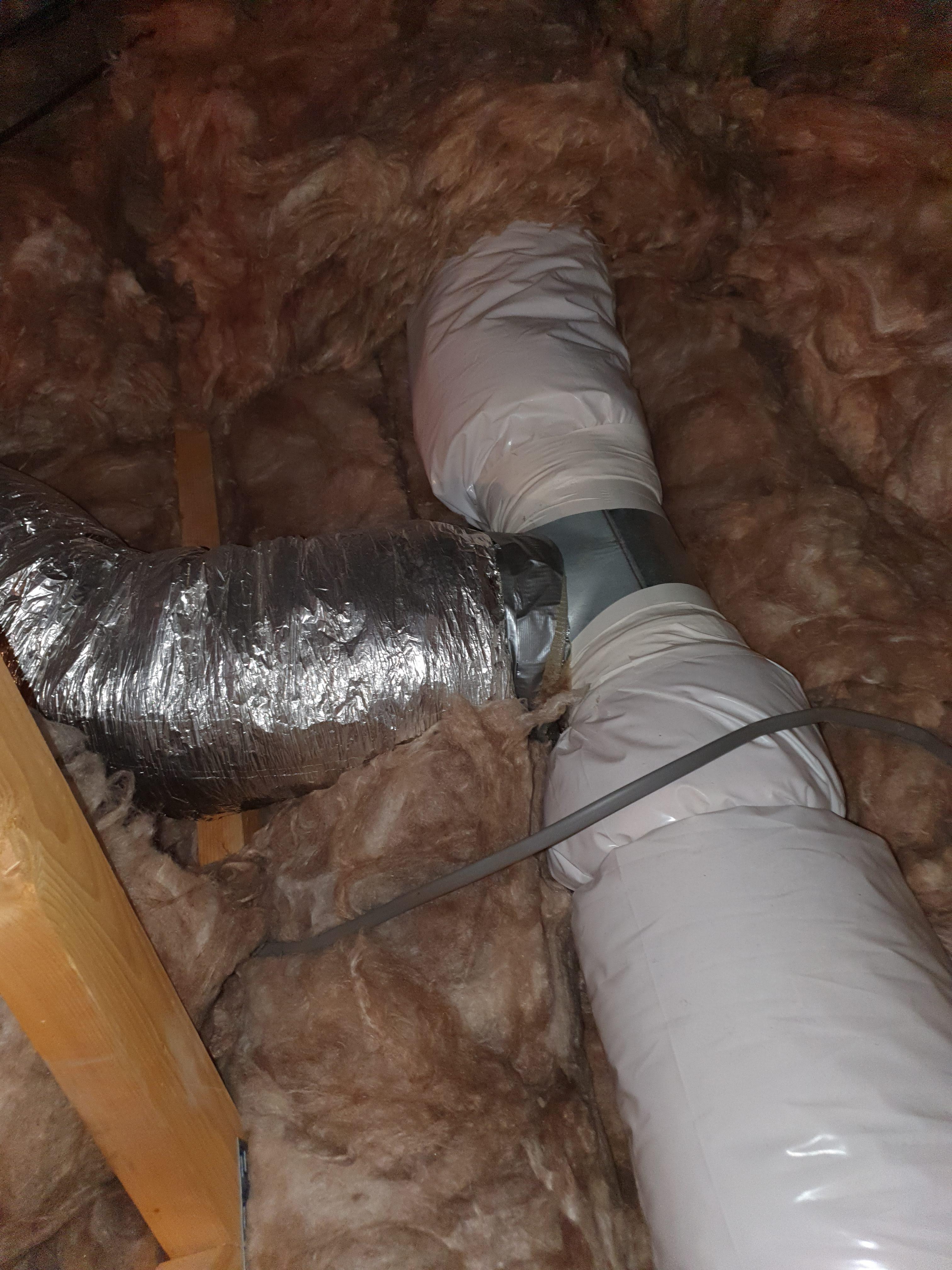

Now tried that and it made no difference so whilst the filters are dirty I guess it eliminates them as the cause. I noticed some of the ducting going to the 'quiet' room is different. All of the ducting is like this: But going off to the quiet room there is this: -

Another fail, quieter but still far too loud for my wife. We have 8 fresh air inlets in our house and 7 extracts. All 7 extracts are essentially silent. 7/8 fresh air inlets are noisy, one is silent and I dont understand why. The instructions said attenuators should be fitted to inlet and extract, is it possible these were missed? How do you tell, all I can see in the loft is a mass of insulated ducting... Thanks, 20190811_230746.mp4 -

Looking at the engineer report the sum of extract was approx 52l/s and fresh air was approx 90l/s which suggests it is miles off. I seem to remember them changing flow rates but it looks like the report only shows pre-adjustment flow rates. Is there somewhere the anemometers can be rented so I can check this myself? -

This fits with the unit being configured for normal ‘high’, the switchover is 50l/s according to the manual...
