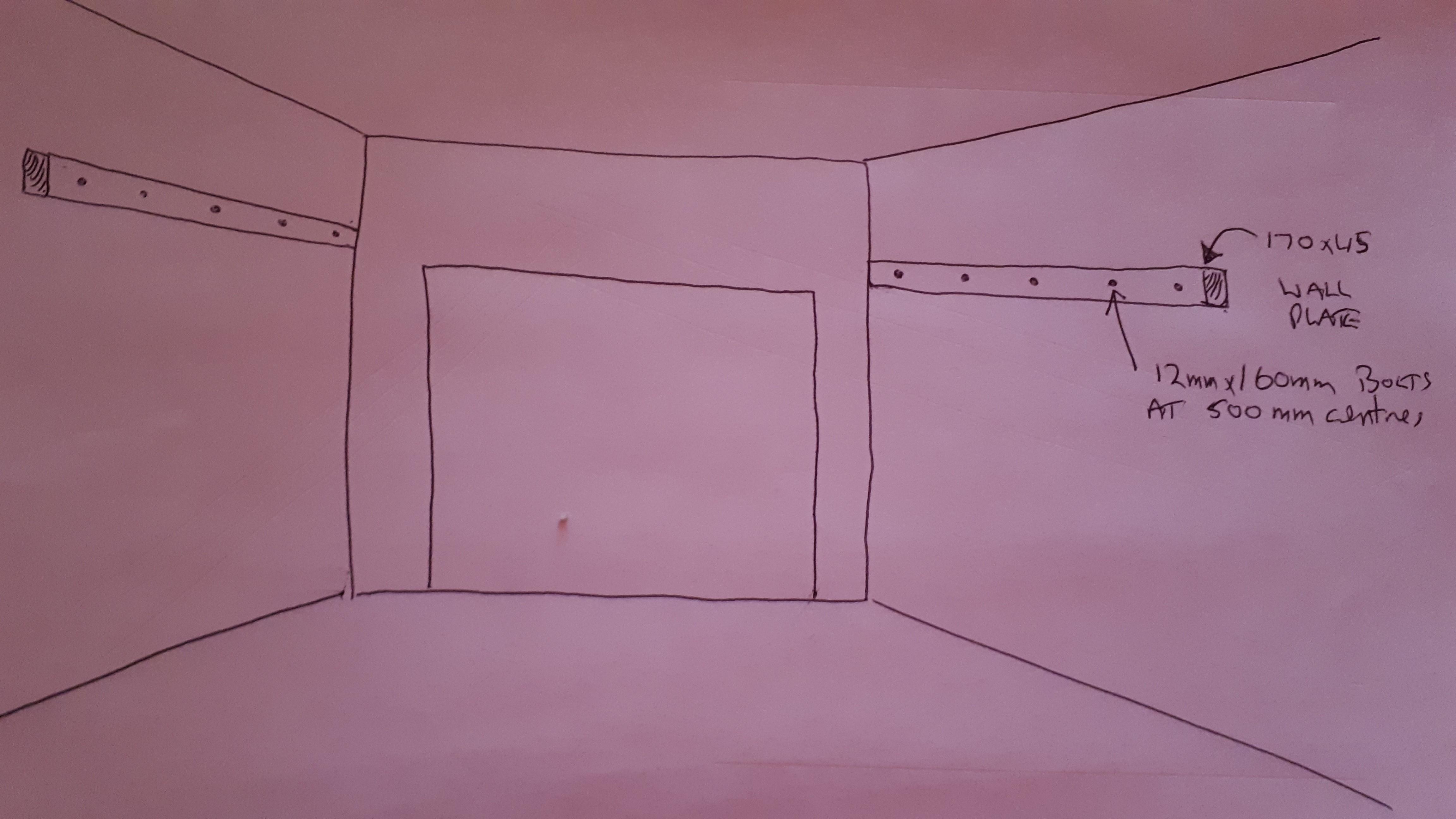

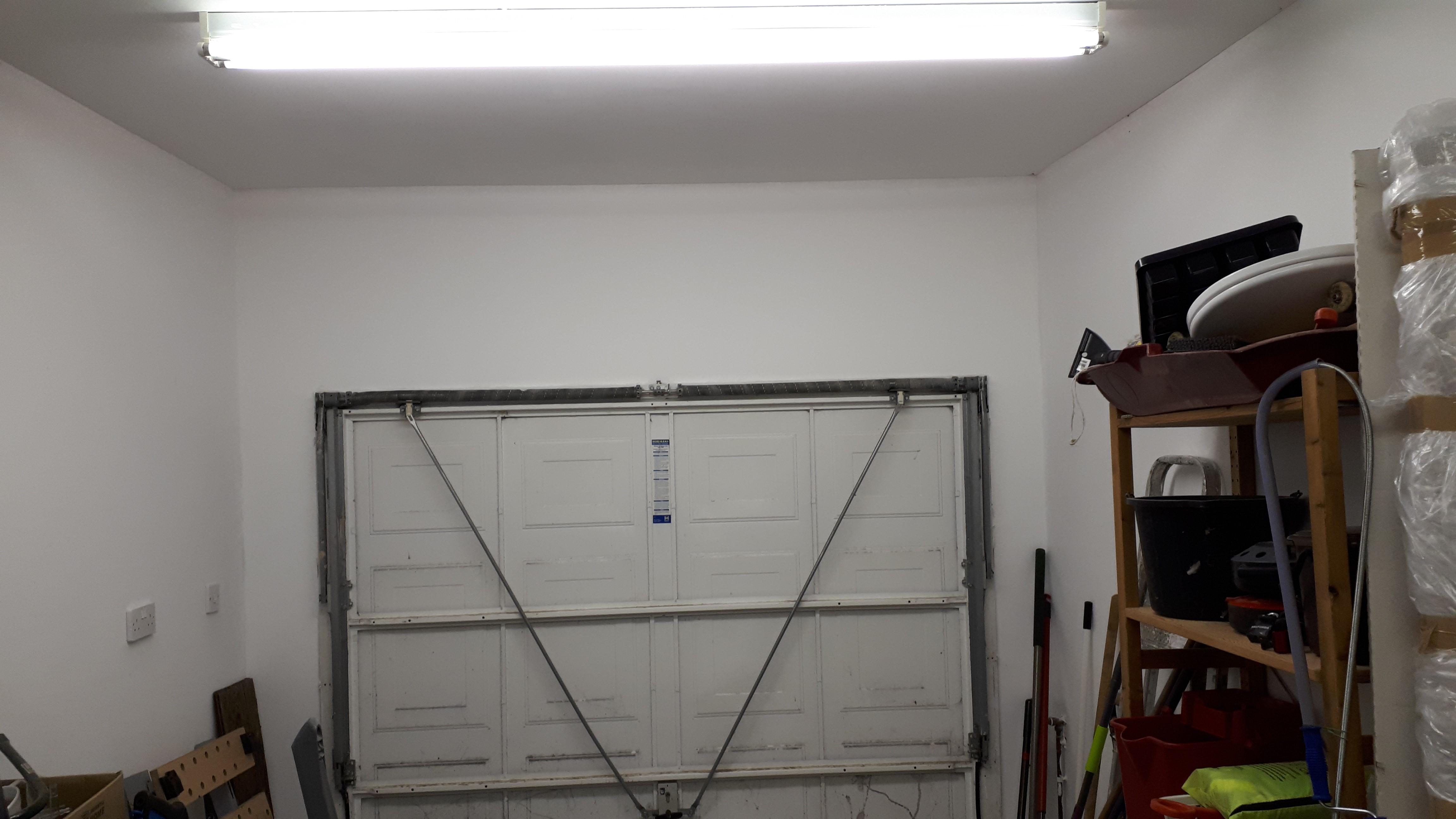

4

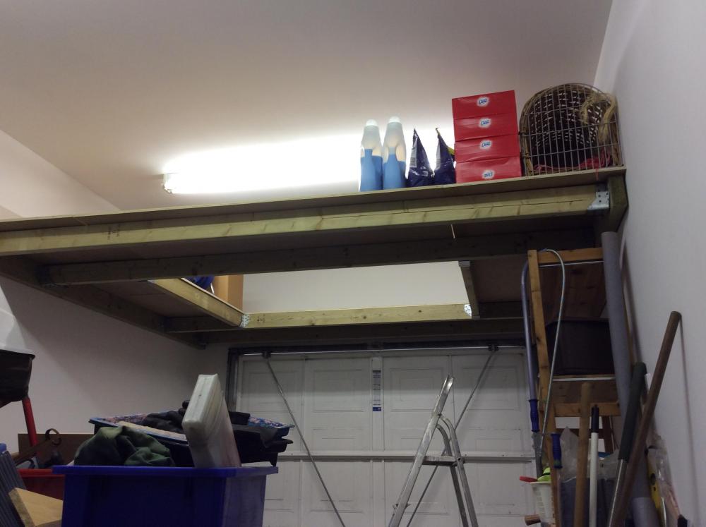

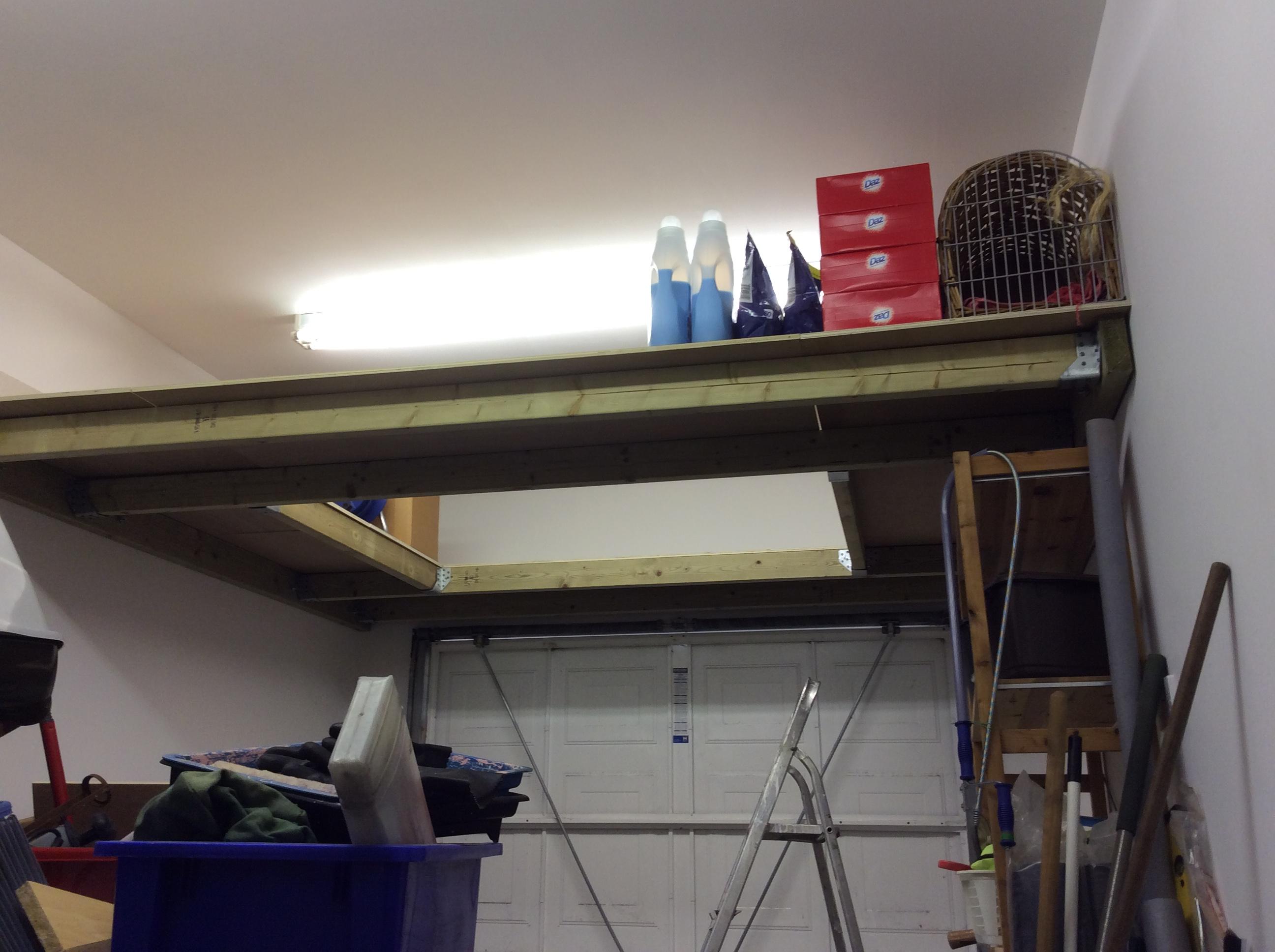

  1. It must be due to proper planning. Not jumping in before thinking through potential points for errors. Then getting all the materials and thinking through the order for construction which identified things to be aware of before an error occurred. Final result better than I had hopped for.
  2. Thank you Cpd. I feel very good about these shelves.

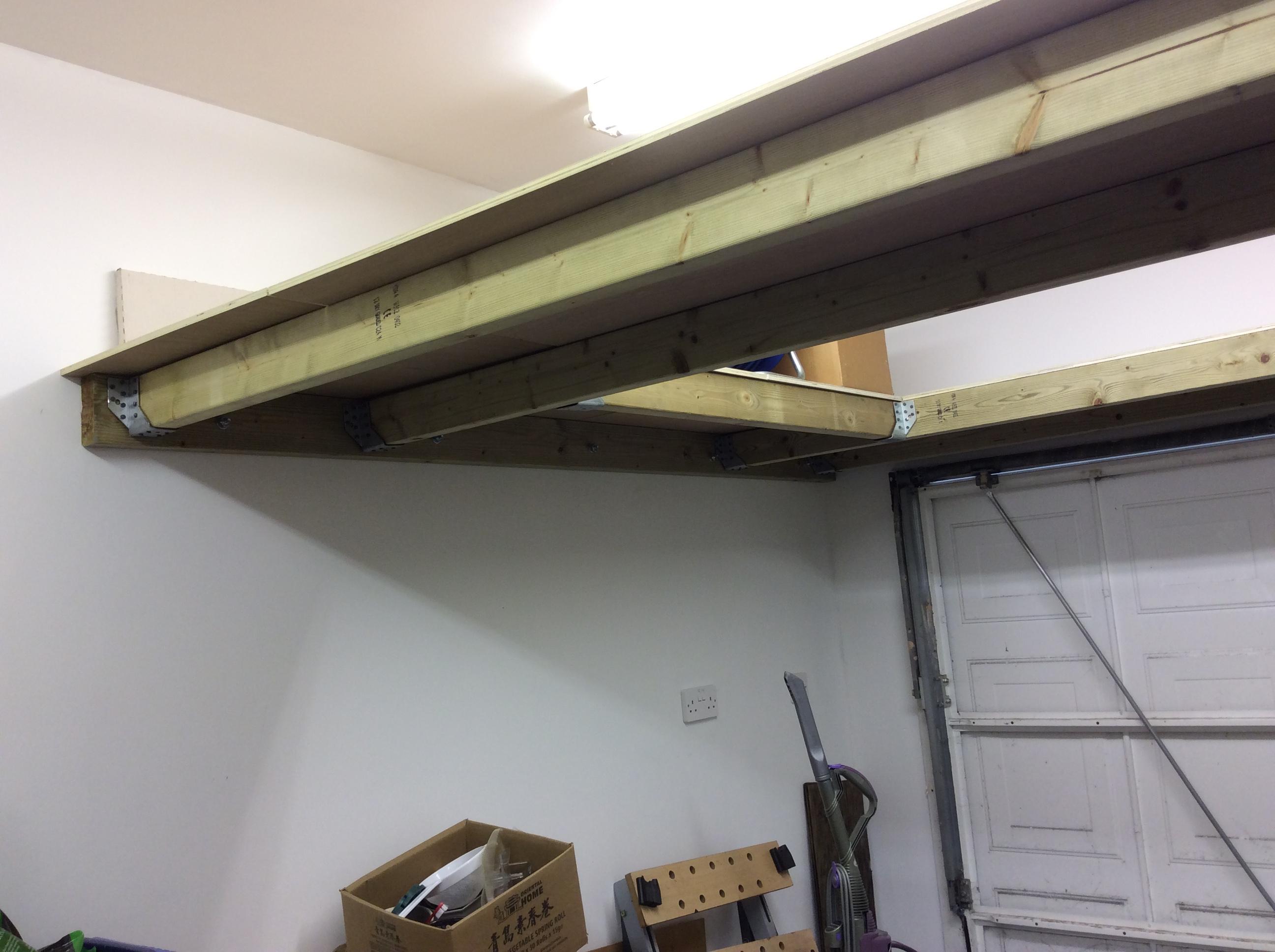

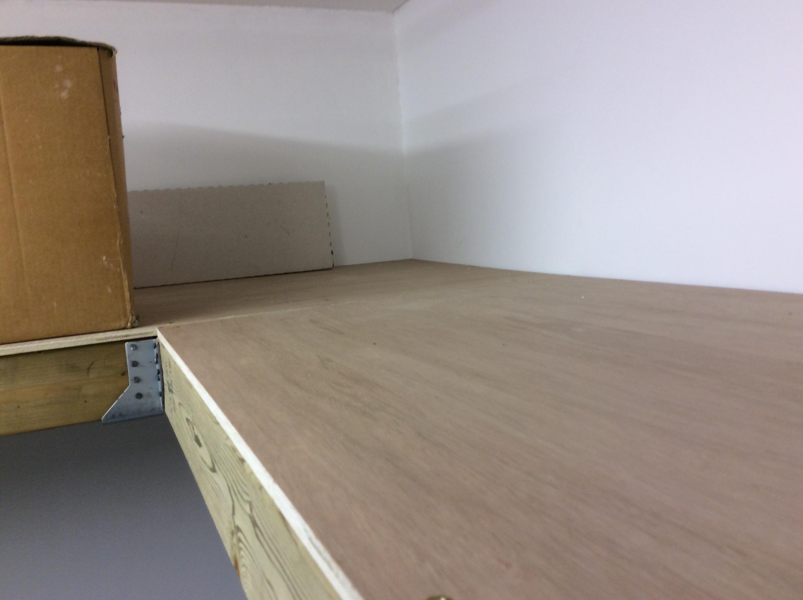

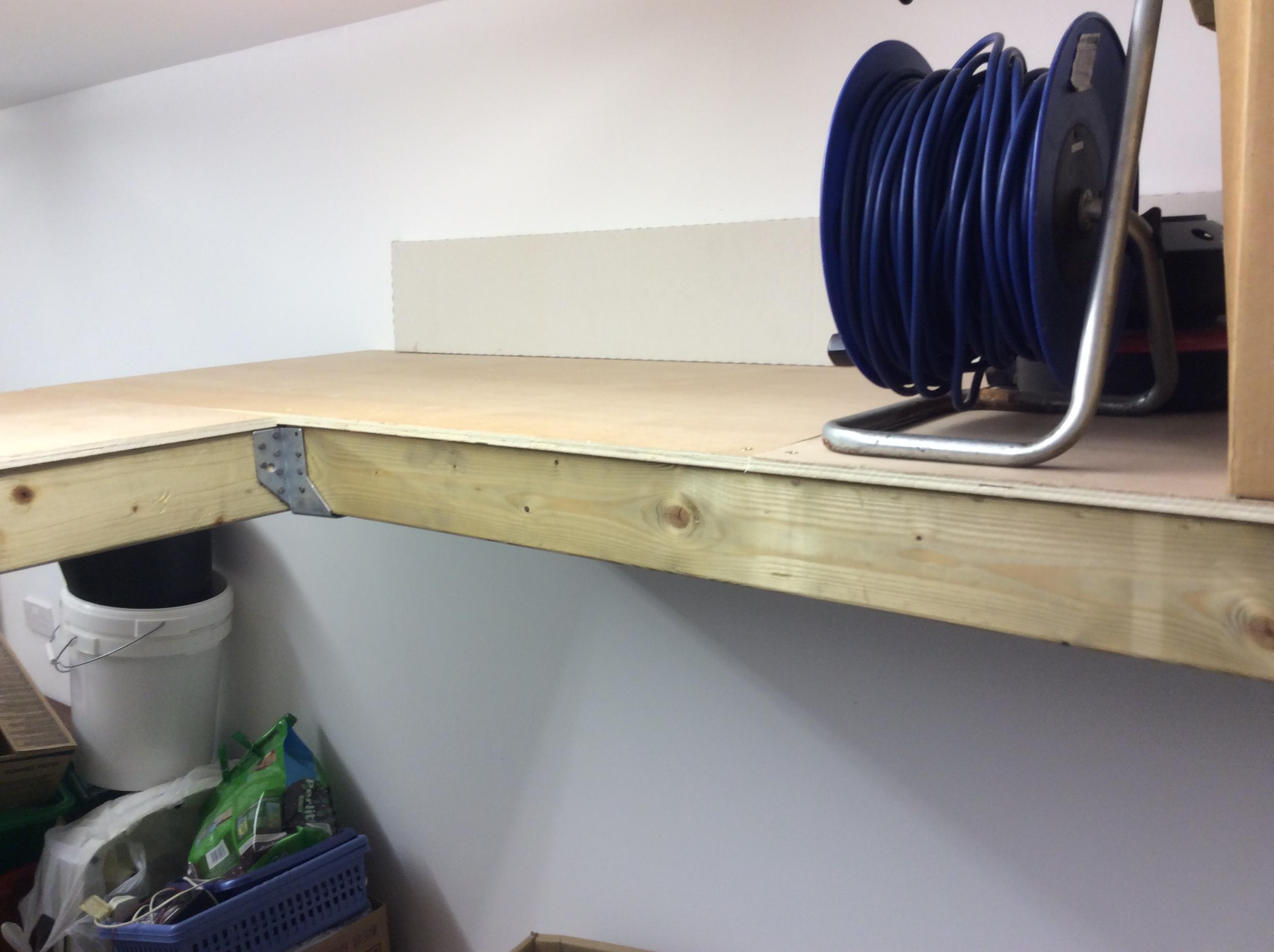

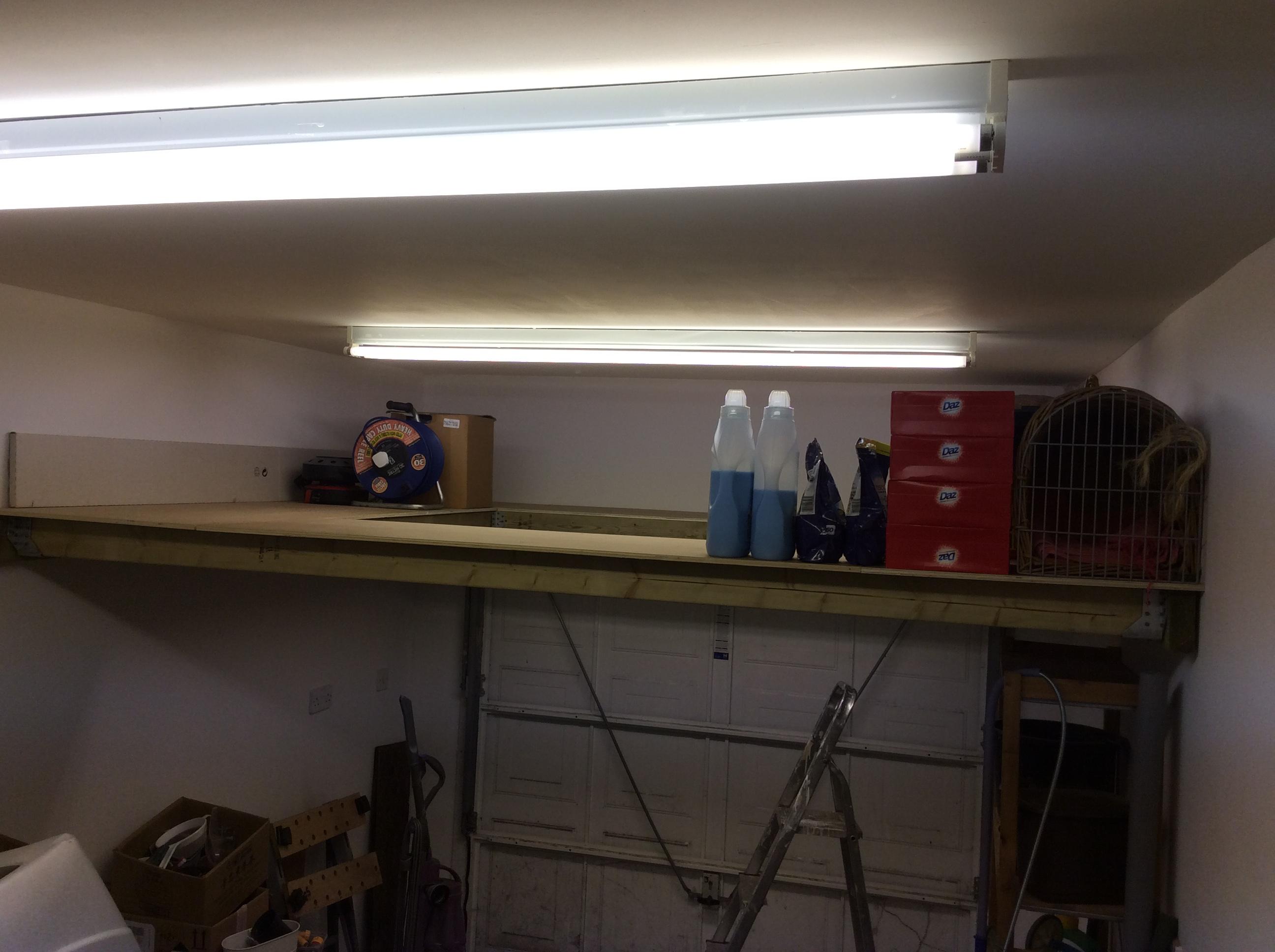

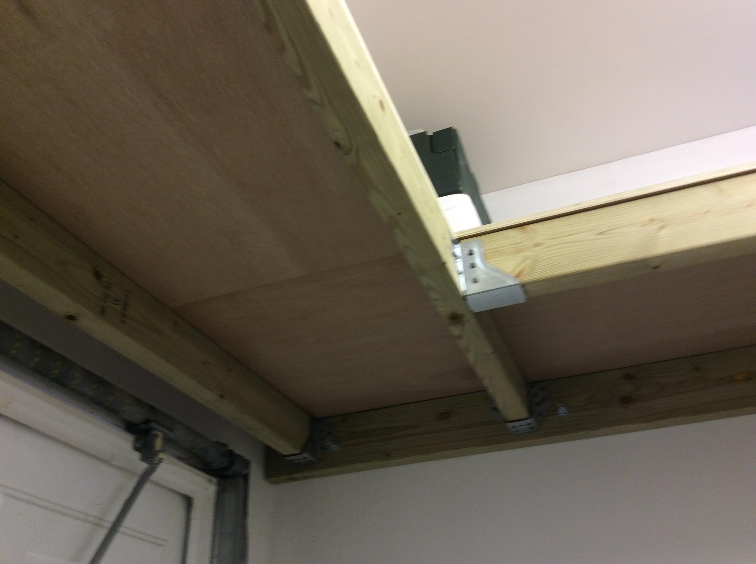

  3. Thanks for these ideas. I will have to think about what I will do. Lighting using LED lights is the way to go for sure. The twin fluorescent strip will be near the middle of my planned shelving. So I will augment it with some led once shelving is up. Well the shelving is up and all good. I have been up on the shelves while I was fixing the shelf to the joists and no movement at all. I also hung from each joist and they barely bent at all. in the end I went with 120x47x2400 wall plates and 95x47x2700 joists (cut down from 3000 to fit) using M12x160 resin anchors five per wall plate, 12mm hardwood ply for shelves fixed down with 5.0x40 twin cut multi purpose screws - 6 per sheet. I am very pleased with the result.
  4. Thanks for these ideas. I will have to think about what I will do. Lighting using LED lights is the way to go for sure. The twin fluorescent strip will be near the middle of my planned shelving. So I will augment it with some led once shelving is up.
  5. No, I didn't want the whole thing as a shelf. Just 610mm shelf along sides, 610mm shelf over door and another 610mm shelf further into garage, so I have a square hole in the middle to access things on these shelves. I didn't want to fix into the ceiling. primarily to keep the shelves free of anything limiting the items I put up there. I can see what you mean but I wanted clear space.
  6. OK. Would 18mm hardwood ply be OK? And I'd put 3 joists under the 610mm width.
  7. Added picture of garage. When garage door opens the closest to the ceiling it gets is 680mm. So I figured I would have at least 500mm of space above the shelving allowing 150mm for the support joists. I was thinking of 5 bolts resined into each side wall at 500mm centres. Would that be enough? In reply to scottishjohn, I could reduce centres of the joists and have 3 at 300mm centres at the front of the garage and the same further into the garage. Just depends on if the 45mm x 120mm joists would be up to it or not. Is this a deep enough section?
