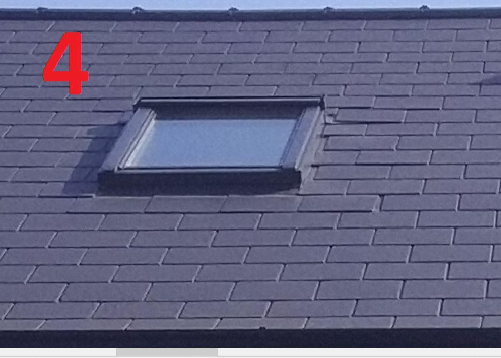

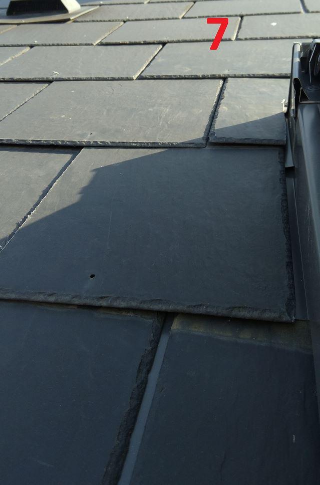

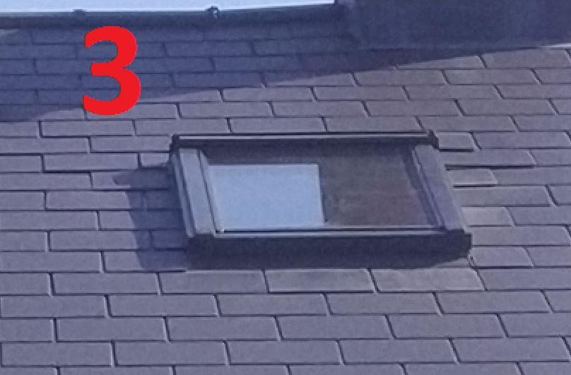

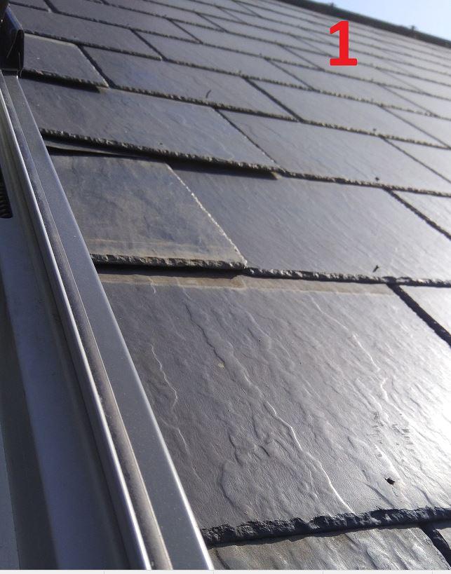

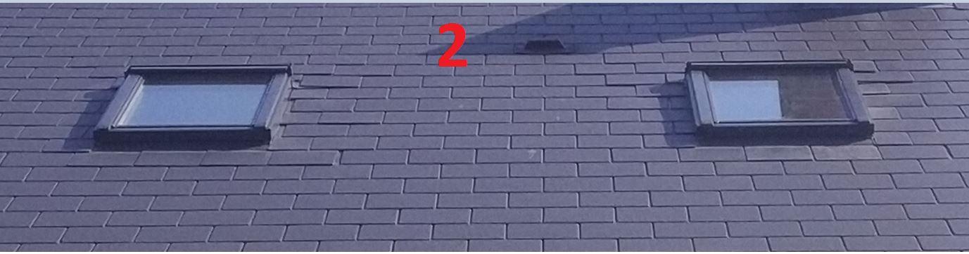

Repsac's Achievements

  1. thanks for your advice guys, I will address the issue with your comment
  2. Hi PeterW, I honestly don't know what sarking board or battens is, sorry I work with computers I tried googling it but to no avail. Declan52, thanks for the videos, I see what you mean... I did highlight the issue it to the workers, they said it's still work in progress and they are waiting for some clips and stuff and that it will all be nice and flat in the end, which I am not convinced at all.... ??

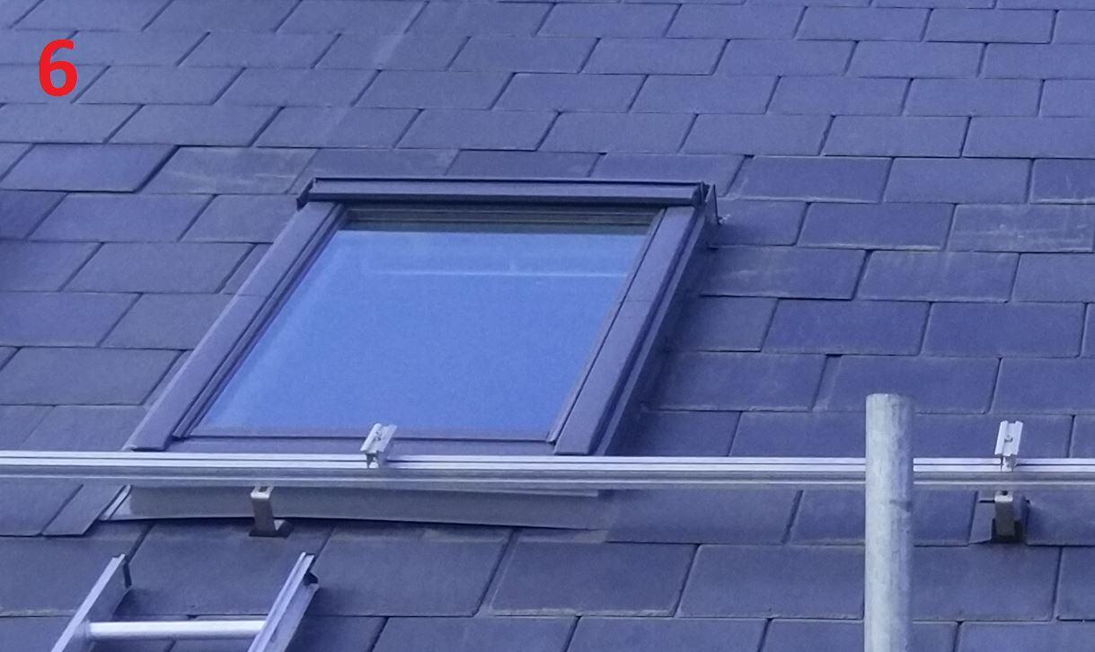

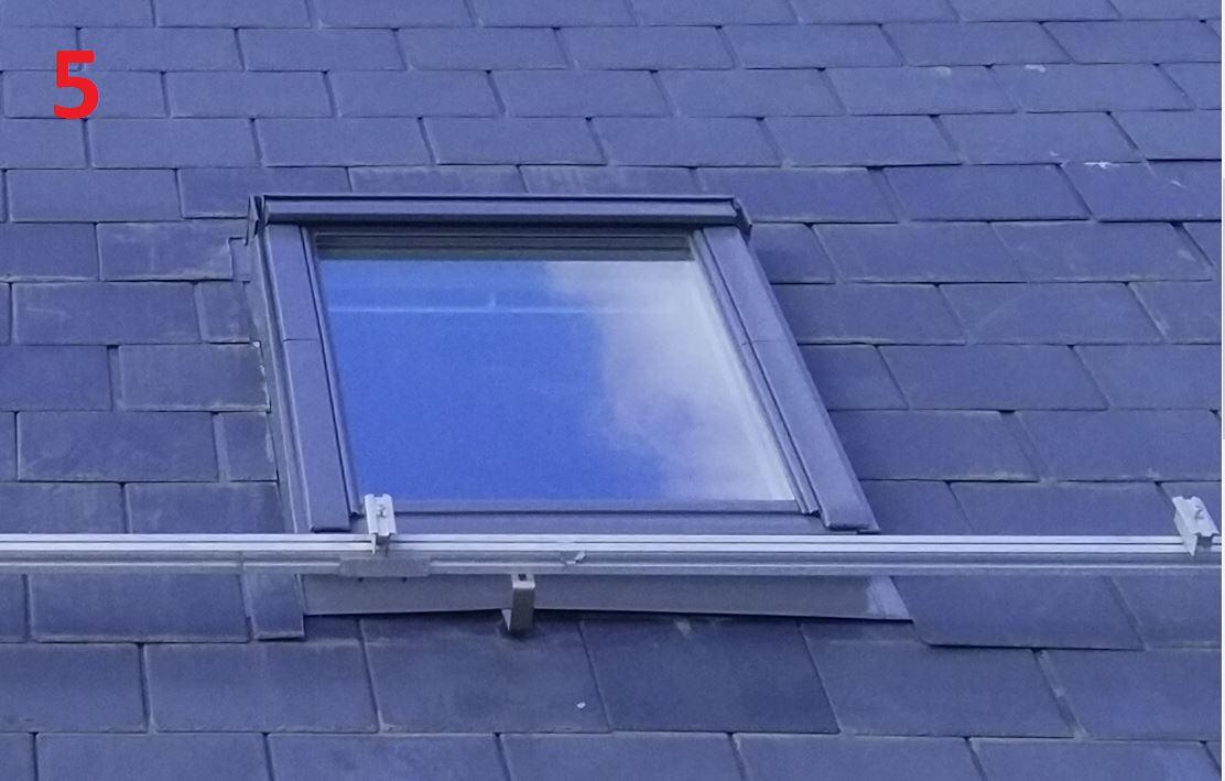

  3. Thanks guys, it's not good new as i expected. What about pictures 5 and 6, these are from the other side where there is scaffolding, and it look tiny bit better then the other side. Do you think there is a risk of water coming in if left untreated ?
