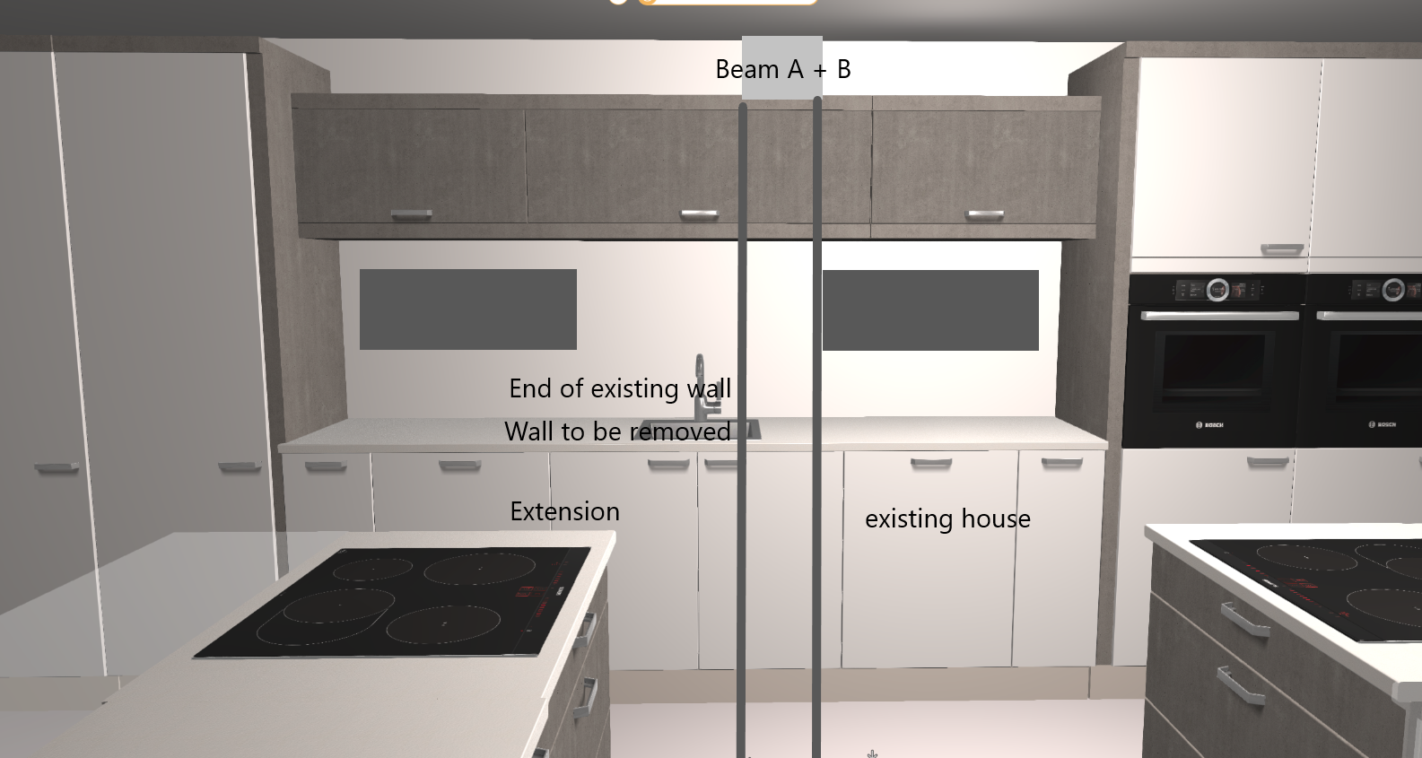

New window under new structural beam
dannyboy123 replied to dannyboy123's topic in Building Regulations
Thanks, the structural cals has already being done. Your comment about alot of weight bearing on a small area was my concern and I'm not sure I want it to go back to structural and then building control. I might just take the hit and do it without any windows...just thought it might look better with windows. The extension will have 5.6m bifold doors and three large velux roof windows so it should be enough. -
I will try to make as much sense as I can and I hope this is in the correct section. We are getting a single storey extension to the rear of the house. We are designing an open plan kitchen and when the rear wall is removed a structural beam will be placed across the rear of the house. I am designing the kitchen and would like to place two windows above the work surface but I am worried that the one on the right will affect the strength of brickwork supporting the steel work above. If the windows are not directly below the new steel work is it ok? and is there any way widows can be placed below this steel work? Thanks in advance, I have included a sketch to help with my explanation.
