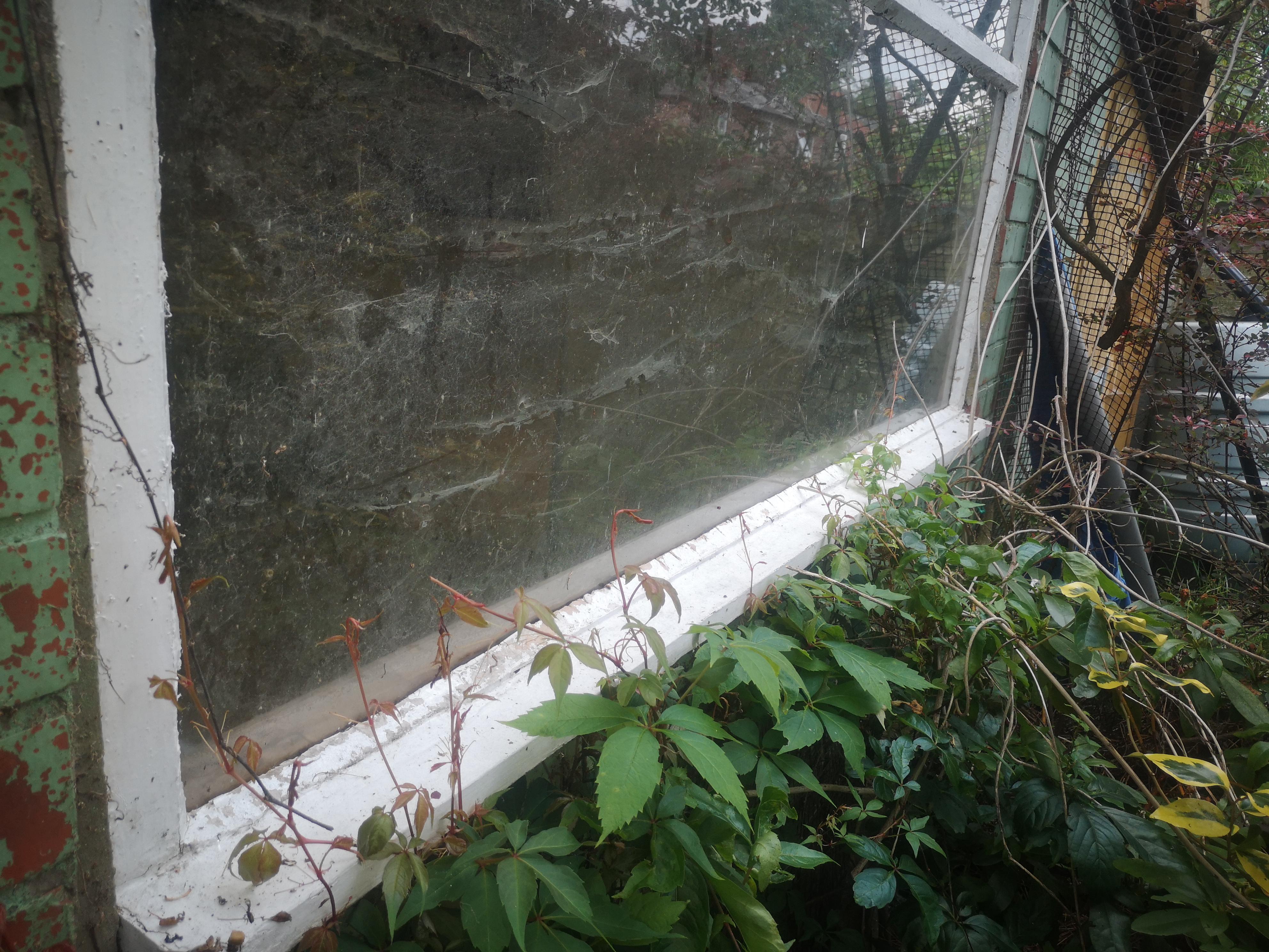

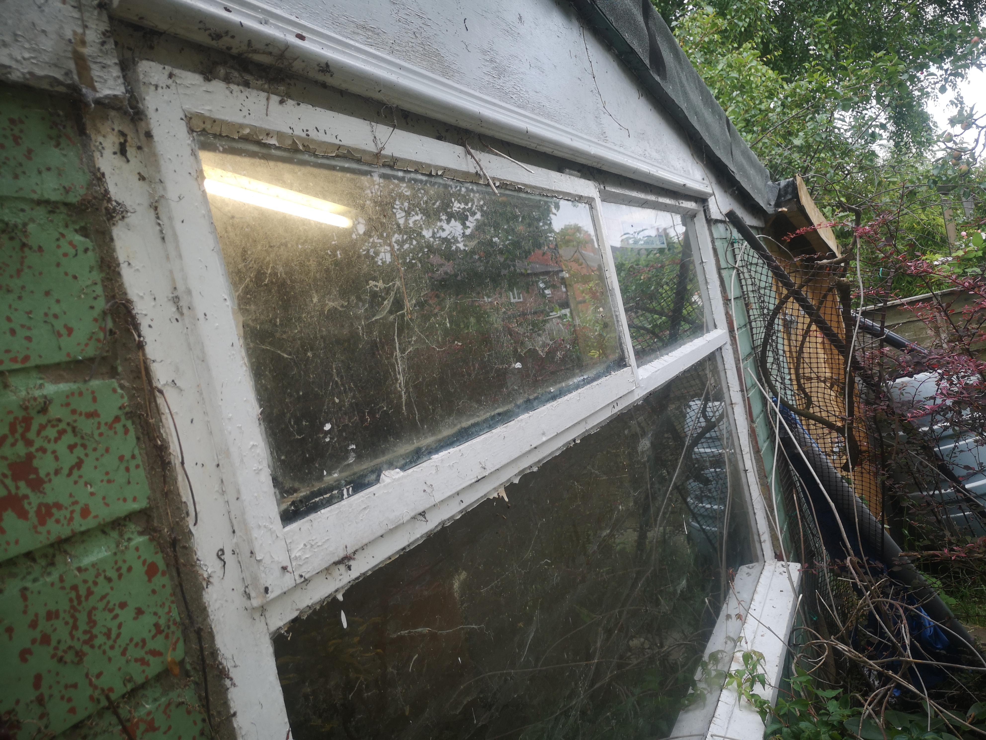

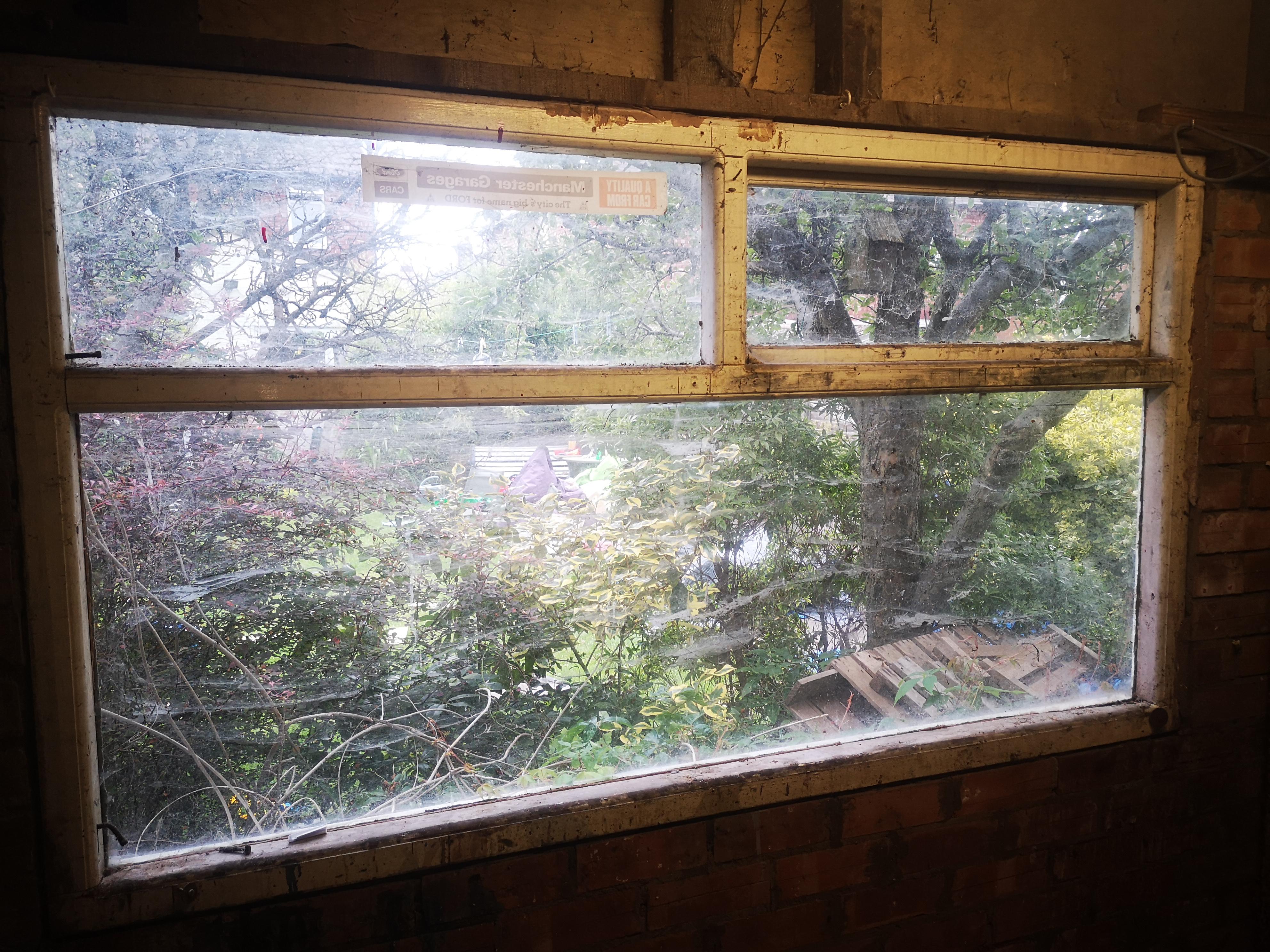

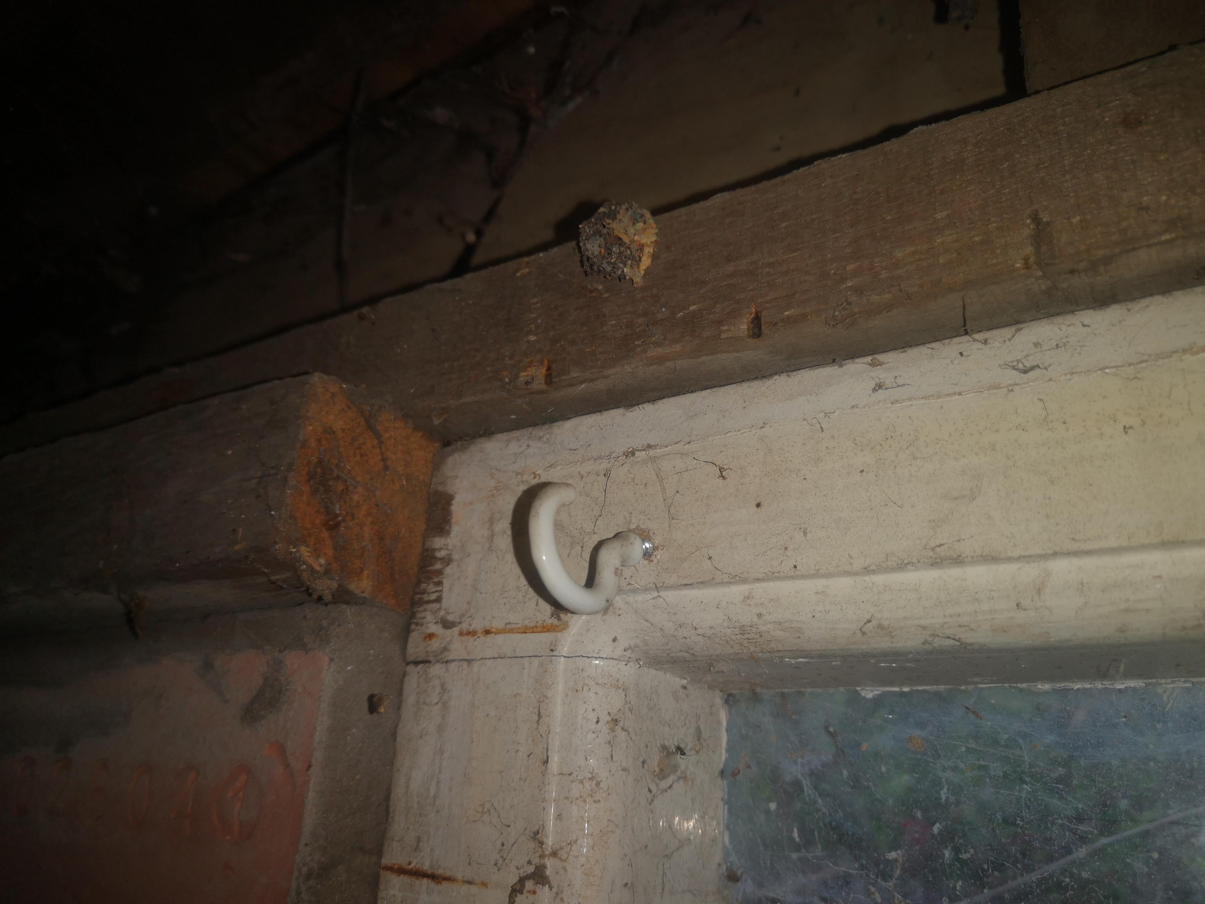

OK thanks. I'm still wondering what to do about the sill. The original sill is exactly the same width as the frame. Is this ok to have it like this? I'm noticing all the windows come with a sill that is wider than the frame.
Ok I will get a sill for sure. PeterW, nice ideas but purely to keep things simple and so I don't have to bother cladding on the outside, Ill just get the custom made windows. I am noticing that the windows I'm looking at come with a sill 100mm wider than the frame. My original window has a sill exactly the same width as the frame. Is this bad? I was thinking Ill just get them to make the sill the same width as the frame?
Great thanks. Seems quite straightforward. So no cementing necessary then? Am now trying to think of a reason why I need a window sill. I am converting the garage inside. A stud wall and a wooden frame will be made to surround the window. The original has a sill outside but surely it doesn't matter if I just buy the window with out a sill and fit it?

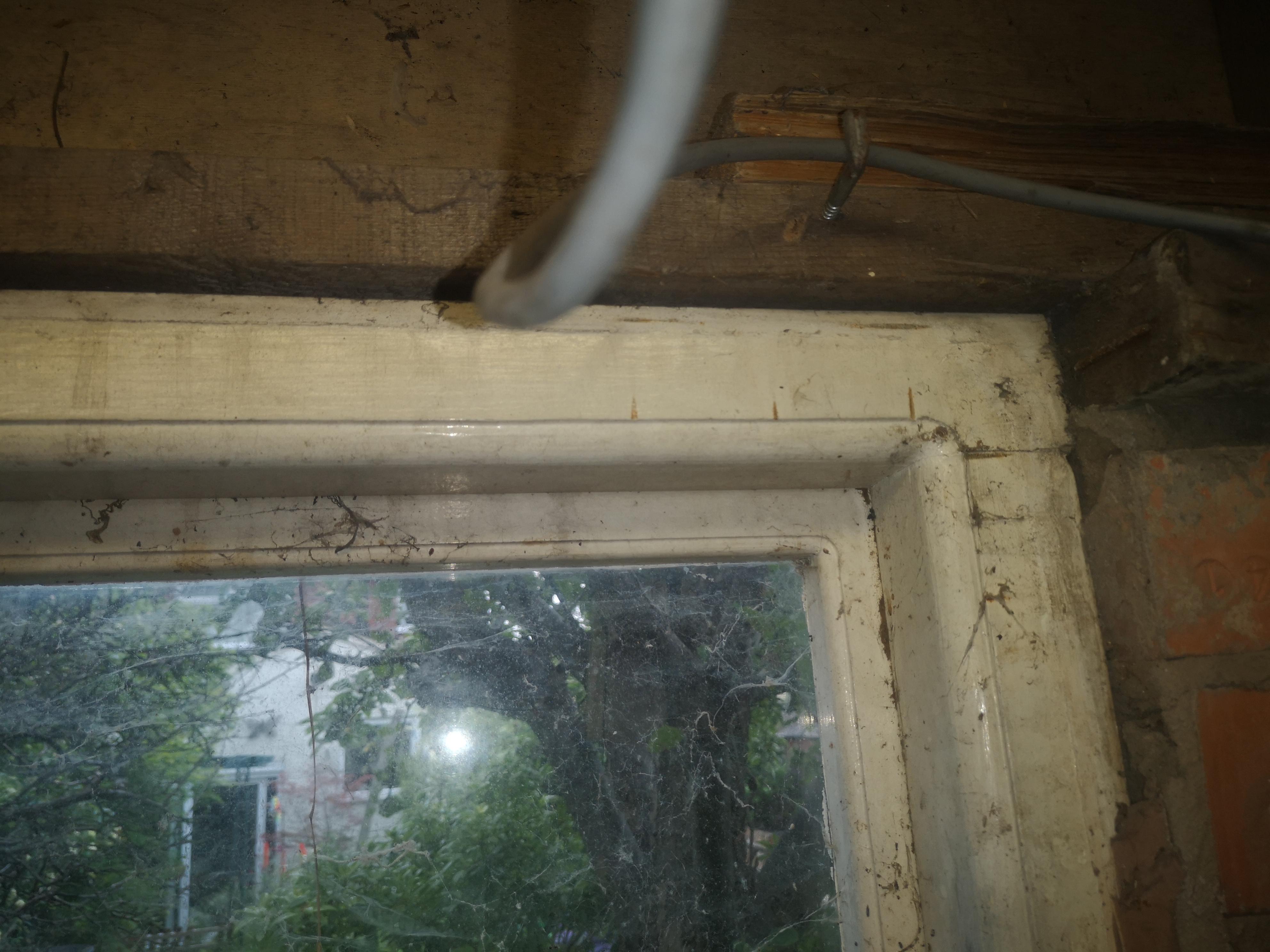

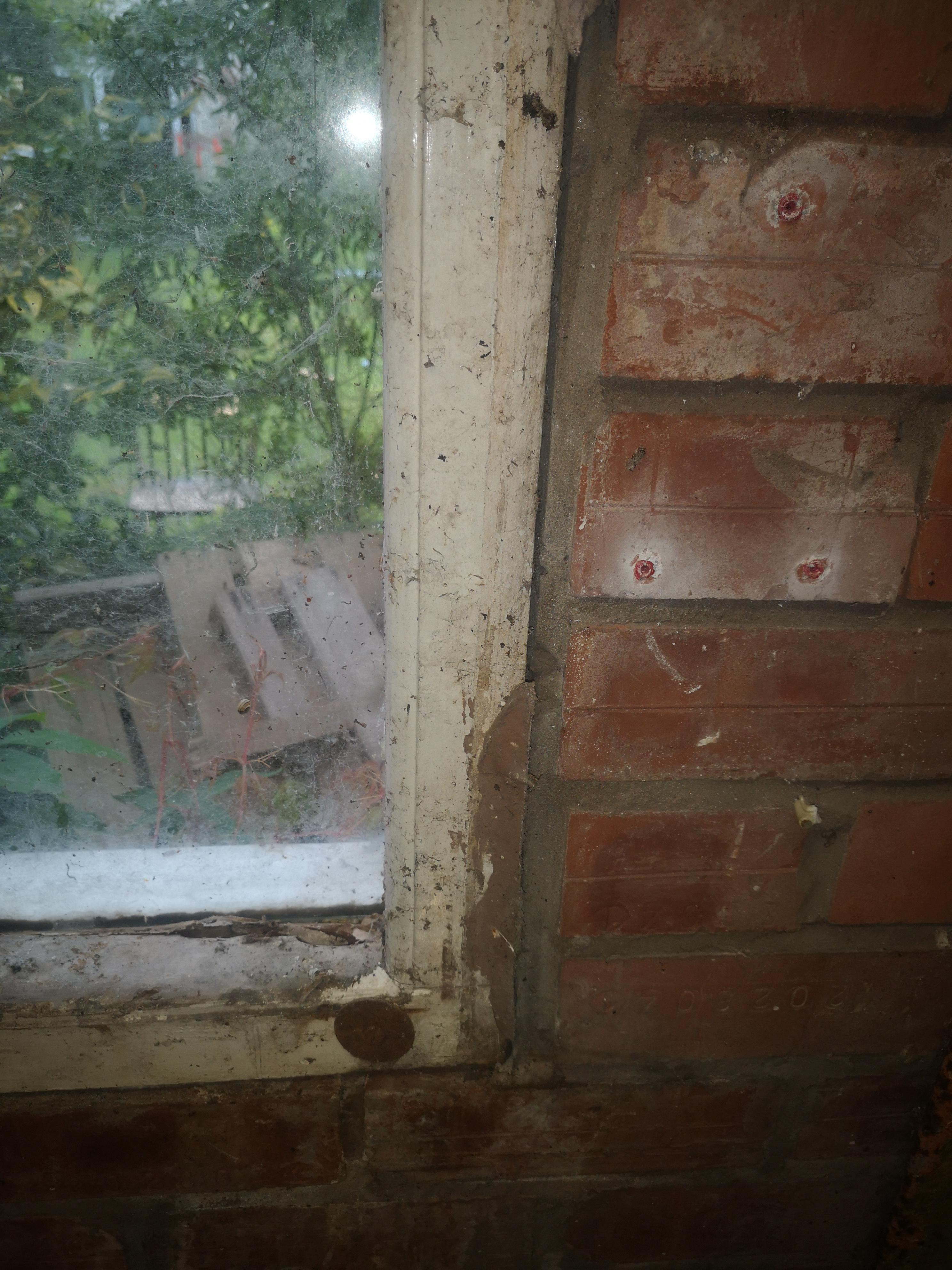

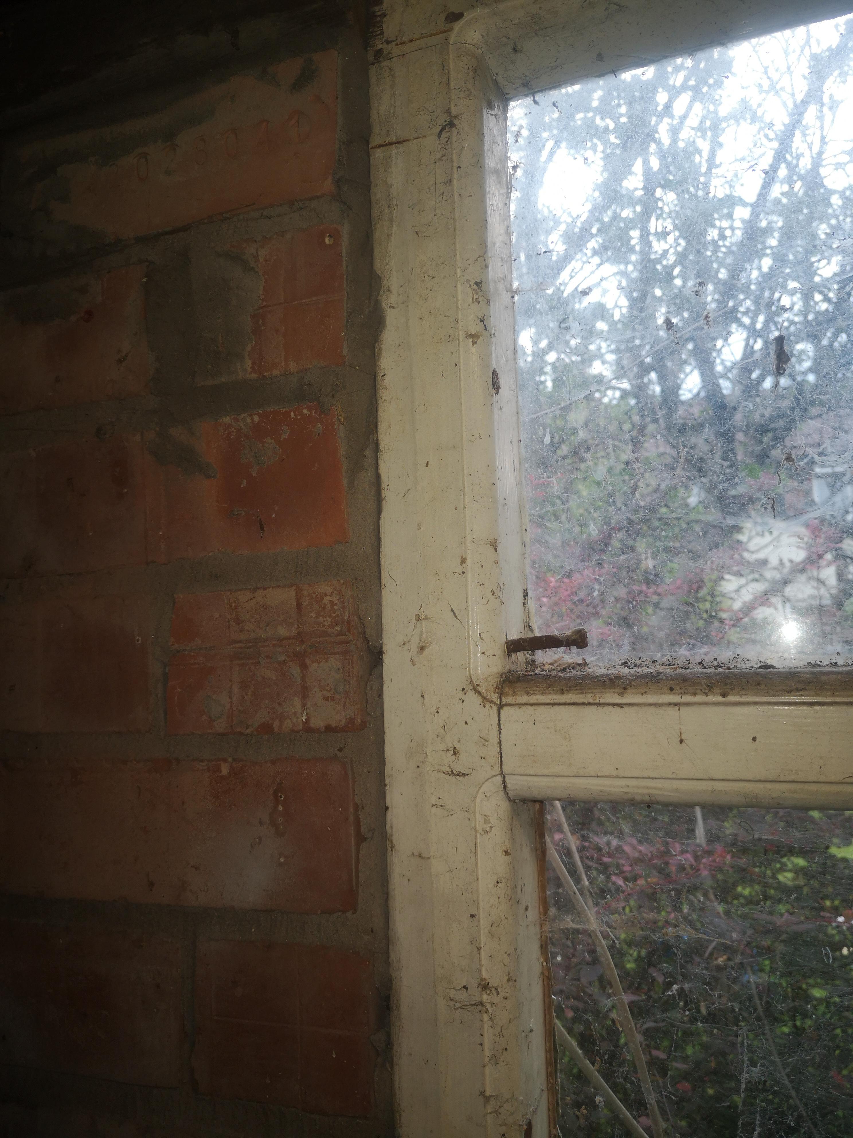

Can I get some advice on the procedure for fitting a new window in the single brick wall of my garage? I am going to get a brand new double glazed unit. The old original timber one is approx 106x188cm, seems to be not a common size, so I think I'll need a custom made unit. It appears to just be secured with screws and bit of mortar so shouldn't be too difficult to remove.
