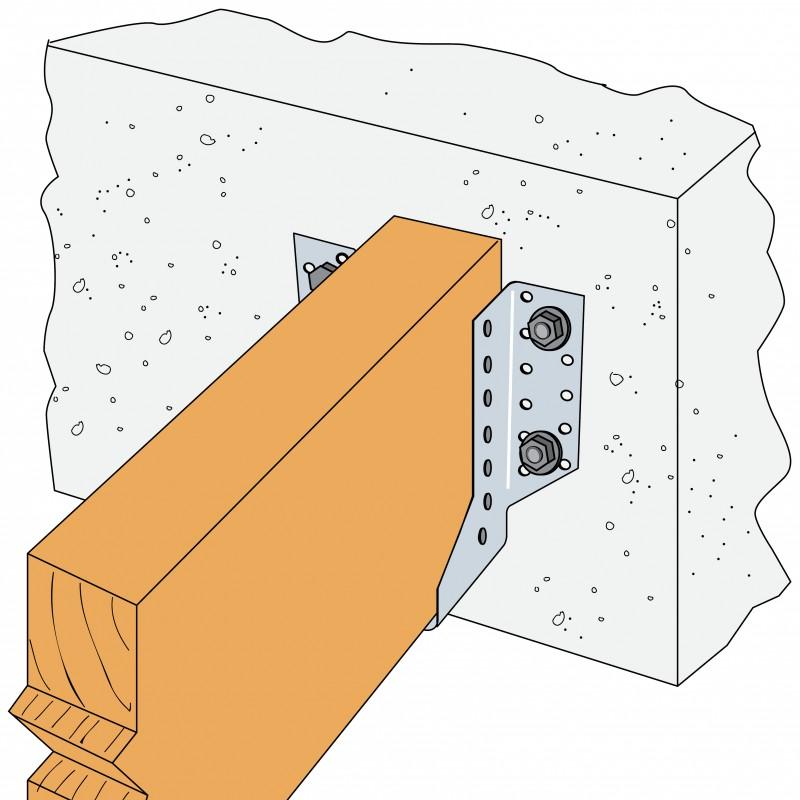

  1. so change of plan, the party wall is not an issue so it seems now. As the work would come under the Party Wall Act, so I would only have to give 2 months notice to neighbour before carrying out the work. This means I'll be spanning the joists across the shortest distance across the width of the room, meaning I can reduce the size of the timber to 38mm x 120mm according to NHBC Standards, but will still run them at 300mm centres just or extra strength as suggested. 3000mm C24 38mmx120mm wall plate attached to the brick face with M12 threaded bolts 100mm deep, then the above joist hangers installed to give a 84mm bearing on the joist end.

  11. Just had a reply from Simpson Strong Tie as for suitable joist hanger which would provide the minimum solid joist timber bearing length of 75mm. They pointed me in the direction of this product https://www.strongtie.co.uk/products/detail/face-fix-hangers/39 Looking at the installation images, I may not require the timber wall plate, as there are 4 x M12 bolt holes for fixing directly into masonry ??
  12. Great, thank you both for the advice sounds a lot easier and quicker than chasing out the pockets for the new joists to fit into

  14. Thanks for that, the joists will need to run along the 3000mm span, as across the 2200mm span at one side of it would be a party wall, so rather avoid that if I can. I was looking at using M12 threaded bar (rawlplugs R-STUDS-12220-A4) inserted 100mm into the masonary at 400mm spacing (1 midway of each joist space either end) using their R-Kex II resin to bond these into the masonary ? Hadn't thought of the flooring, was going to use carpet as current bathroom is, but 15 or 18mm plywood as the base ?
