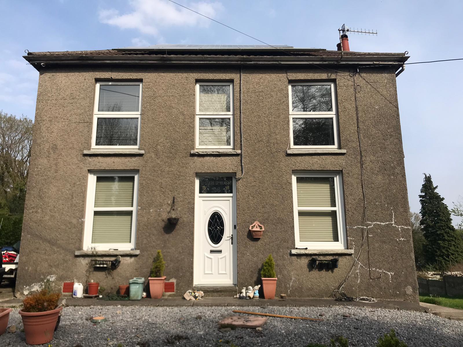

@joe90 first picture is the house at the bottom of my street, probably been up about 8yrs. The 2nd house is a house on my mothers street about 2 minutes drive from me, not a single house looks like it on the street and as you can see from the rear, it's literally dwarfs everything around it, this got build at the start of 2019. And the case worker for this house is the one that dealt with mine ? ??♂️ and did I mention he's a local builder and owns a building firm ?
