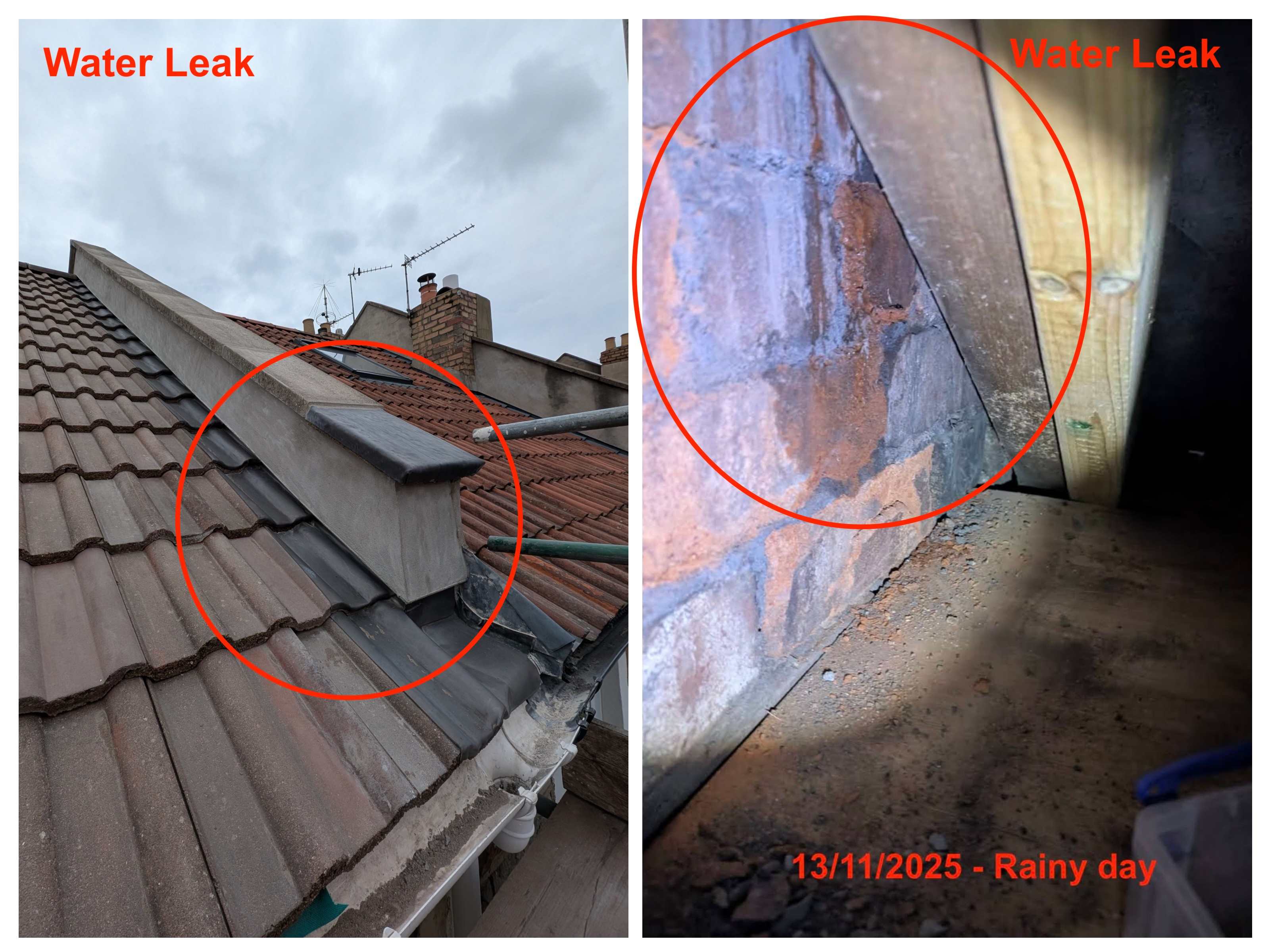

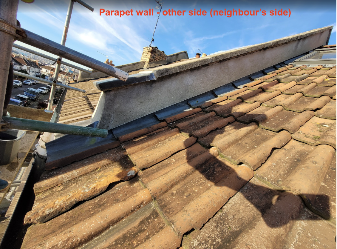

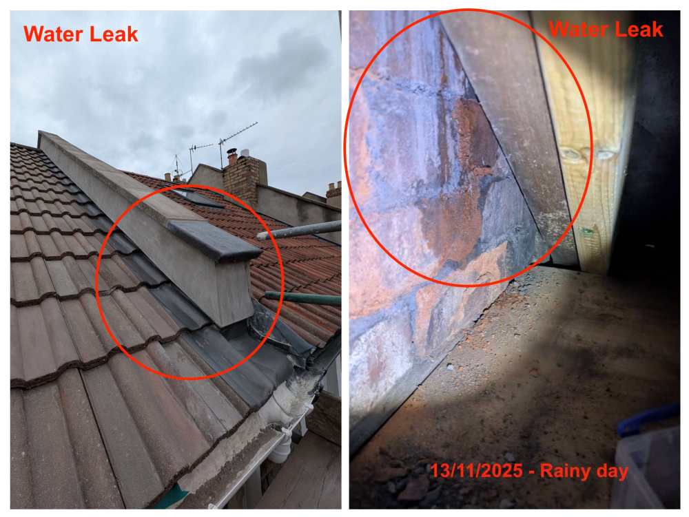

  1. Thanks Jack! There are actually a drip groove (small carved-out channel) underneath the coping stones to direct water away from the parapet wall. I think the DPC is just under each coping stones (not visible though, so I cannot confirm). The render of the parapet wall is new (on our side) so there is no crack where water could get in. However, yes I agree that the brickwork looks very "gappy" and any water getting in could use a number of pathways to get out... Maybe we should look at our neighbours cracked render despite the fact that our roofer said that it is highly unlikely to cause an issue to our property unless they have the same issue in the same place... Hmmm, I don't know, I am very confused...

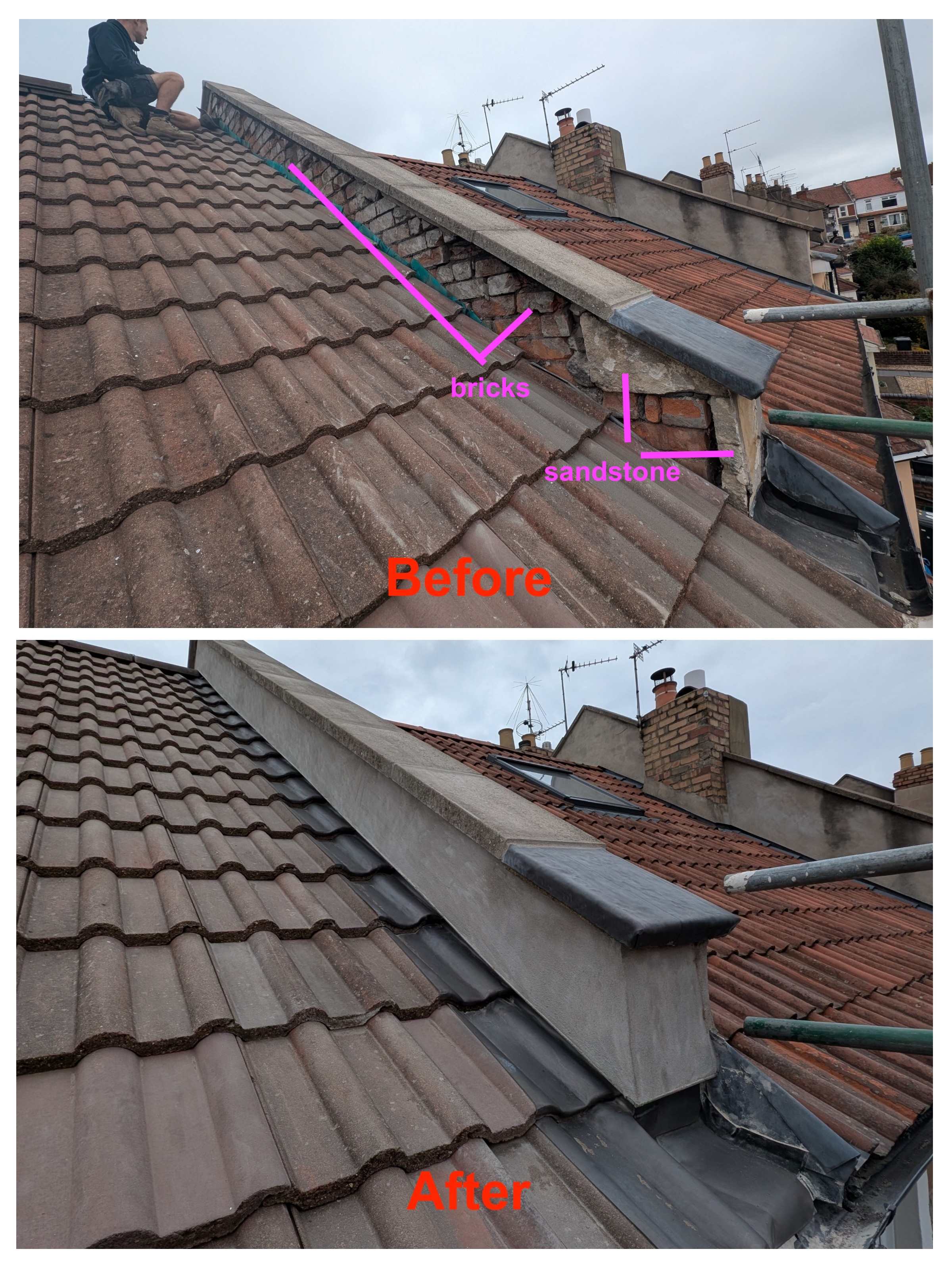

  2. For more than a year now, my partner and I have been trying to pinpoint the root cause of a leak on our roof and have roof works done, but in vain. The roof is still leaking. Our roofers have confirmed and done the following: - Coping stones are less than 10 year old (unlikely to be porous) - Coping stones have dpc underneath them (protection from water ingress if coping stones were failing) - Replaced the lead flashing (to correct position if lead flashing had moved/slid and caused the leak) - Re-rendered the parapet wall (to avoid having any cracks in the render that might have caused the leak) - Repointed the joint between the coping stones (to avoid water seeping through between the coping stones) Need confirmation: - dpc under the coping stones has been applied, but probably not unders the last coping stone (old sandstone keystone at the front) - water test (buckets / watering cans) splashing onto the coping stones - no results - water test (buckets / watering cans) splashing onto the tiles / flashing - water ingress wall, but slightly further up the party wall, NOT where the usual leak is occuring Potential root cause > proposed solutions by our roofer: - last coping stone failing (block keystone, sandstone) > cap the coping stones with torch / felt system - head lap coverage of each tile / lead soaker issue > front elevation needs to be redone at the correct batten spacing to increase tile head lap Other potential root cause: - cracks / missing render on parapet wall (neighbours' side) allowing water to penetrate / run through the coping stones and appear on our side? > (roofer's answer: highly unlikely to cause an issue to your property unless they have the same issue in the same place) How would you resolve this issue?
