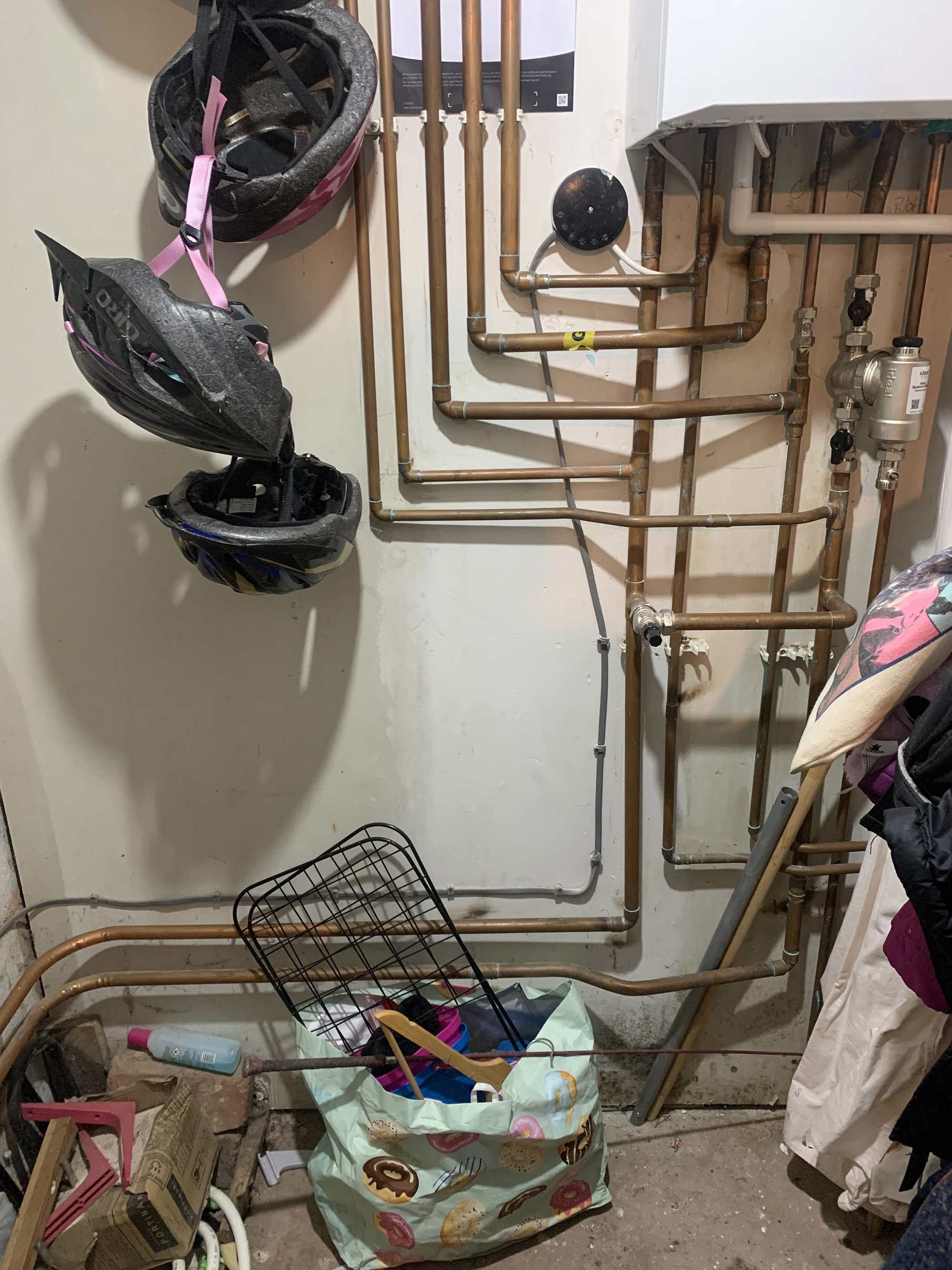

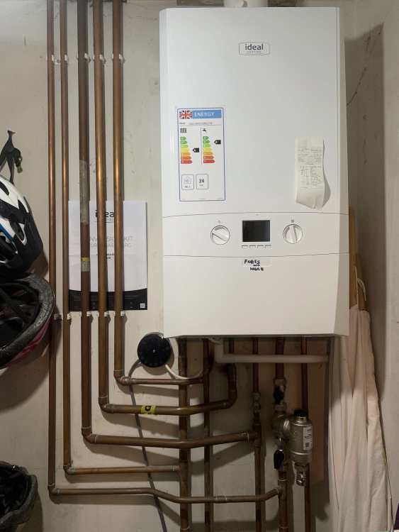

  2. Still looking into this and having done a little more research, to try and understand how everything works, i'm wondering if the Automatic Bypass valve is causing the problem? The new Boiler is an, Ideal Logic+ Combi C30. The old one was Worcester CDi. The new boiler has a built in ABV, where as (if i'm right) the old one didn't, so needed the external one. That is currently set to 0.5. Could the ABV be robbing the ufh of the heat it needs to warm large/multiple rooms? It will comfortably warm my 3m x 3m bathroom but if I add another room the manifold & pump cool down.

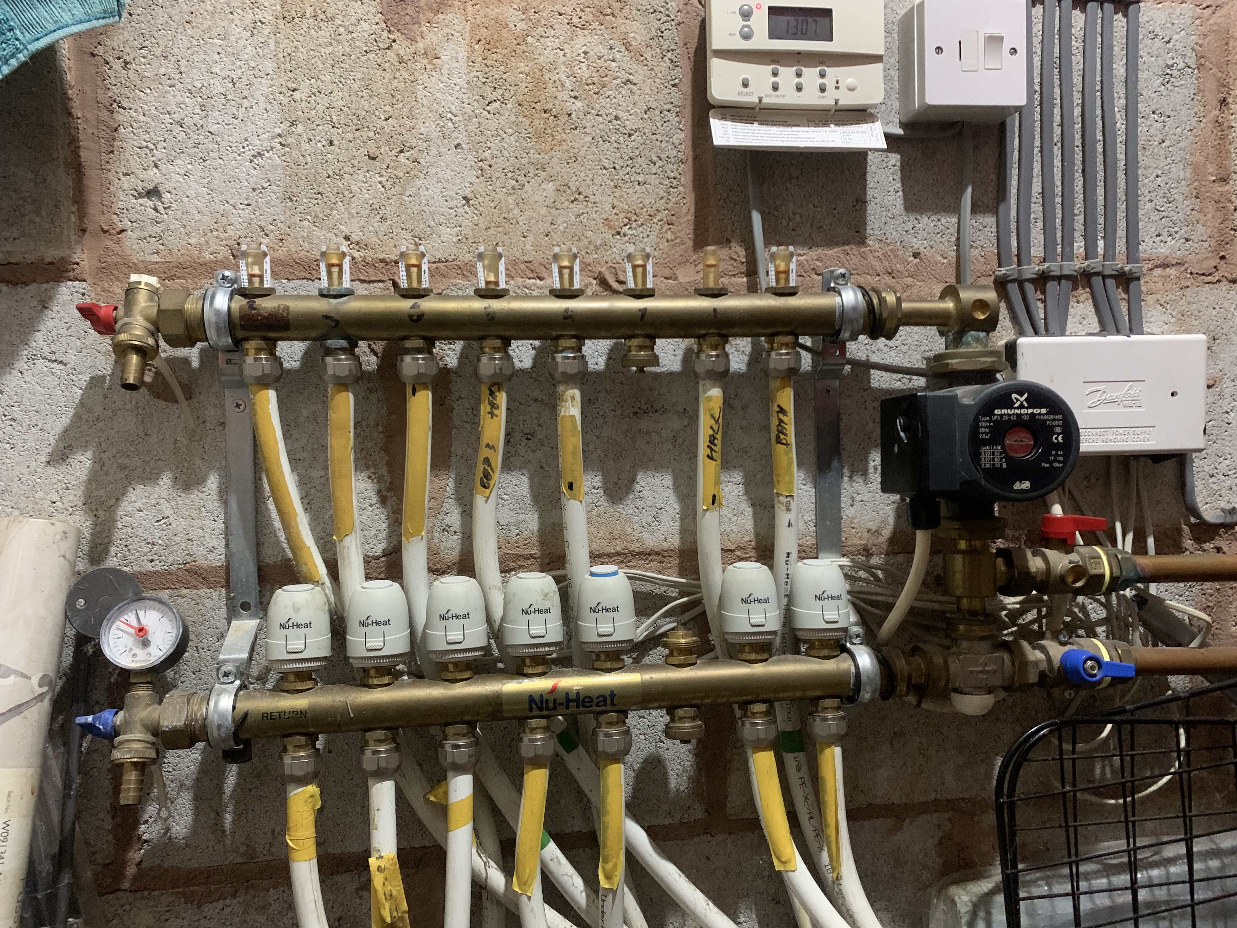

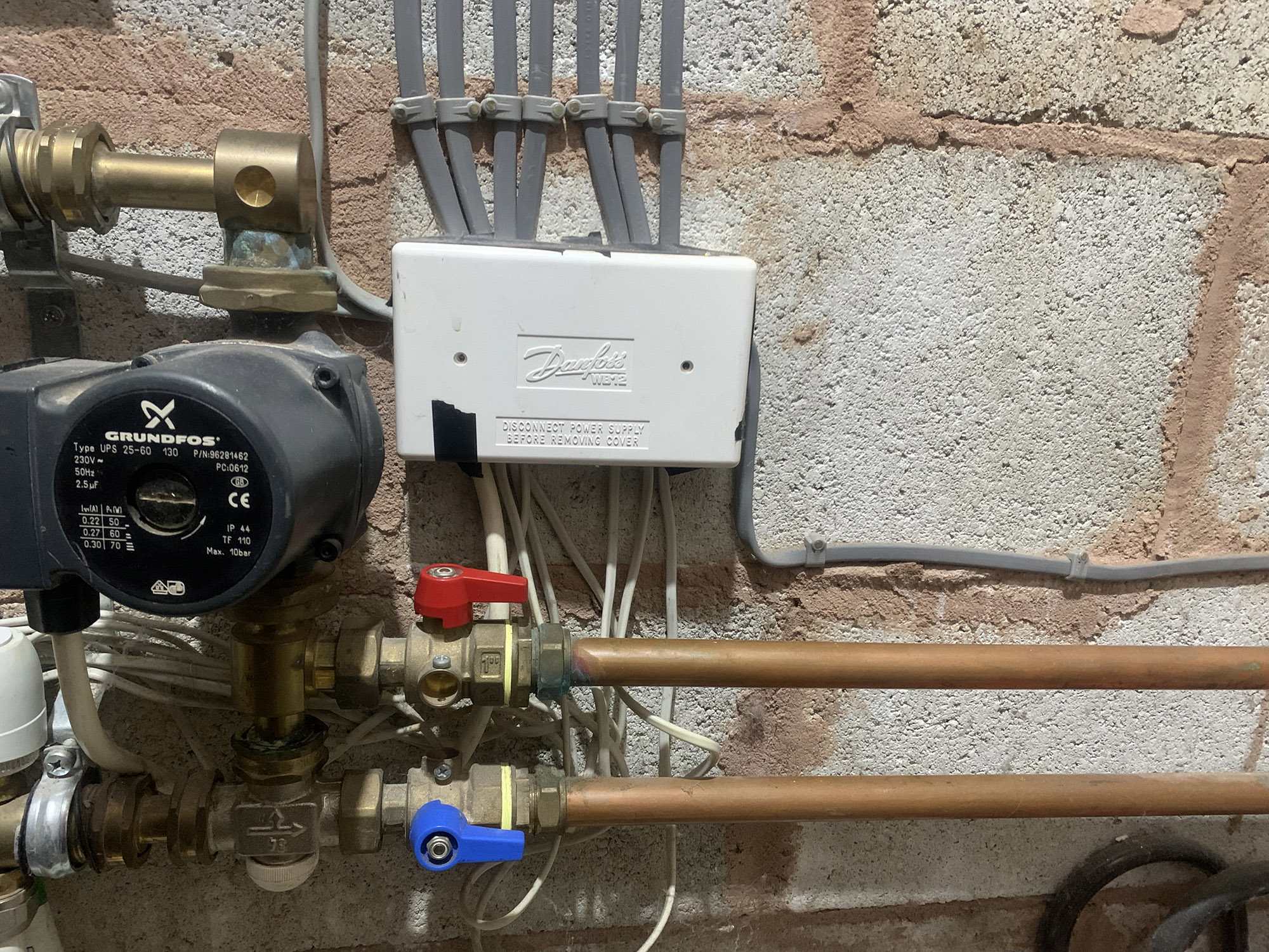

  5. Reporting back. So I shut off all thermos except for a problem room. Waited around 10 minutes. Turned on a problem room thermo and waited for its actuator to rise. Using a radiator key I began the bleed. Warm water began slowly coming out of the little hole. I turned it a little more until it lifted to an arching stream and then closed it. I didn't hear any air. And the stream of water didn't splutter at all. It was a steady. I closed it after each bleed within about, 5 seconds. Results: Problem room (1) Bedroom. Flow marker didn't move. Supply pipe warmed to around 26 °C Actuator rises and warms. Pin moves. Tried increasing flow by two full turns. Termo gun reads the floor temperature between 13-15°C which is the same as a similar room with the heating turned off. Problem room (2) Living Room (Thankfully we have a wood burner in here!) Flow marker did move a little. From 0>2 Also noticed it bobble when I powered off/on the ufh system & boiler. Supply pipe warmed to around 26 °C Actuator rises and warms. Pin moves. This room did warm, but after I wasn't calling for heat! This really threw me. I can only assume that the pin hadn't been pushed down properly by the actuator (which was closed). Rather ironically at this point I was worried I wouldn't be able turn it off. I removed the actuator. Called for heat so it rose. Replaced it and turned the thermo off again. This closed it and the floor eventually cooled. I haven't tested the living room again yet as I wanted to be sure it was cooling fully. The floor (laminate with underlay) warmed to around 19/20° ======= Things i'm wondering: Could the flow makers be stuck? If I understand correctly they only display the flow level but have no effect on the actual flow. This is set by turning the brass 'bit' under the actuators. Even if I power everything off they flow markers stay in the same position. Is it safe to spray the pins with a little WD40? Just to be sure they are moving freely. Could the thermostat in the bedroom be faulty even though it clicks when I turn it up. And its actuator rises? Does the pressure reading confirm there is enough water in the system? Am I correct in thinking that the further a pin moves, the more flow a room is getting? Sorry for all the extra questions. I'm trying to ask the right things to help rule things out.

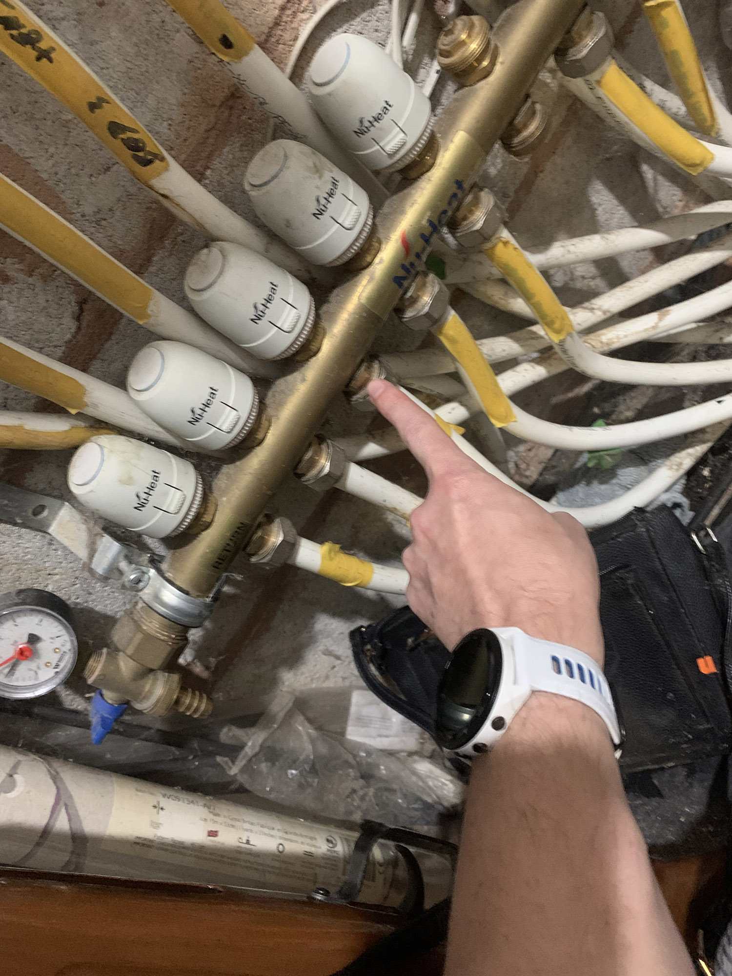

  6. Sorry, I meant 'water starts'. 🫠 I see the little hole (photo attached). Will try and find time to test later, if not tomorrow. Still in nursing mode. Thanks again for the help.
  7. You were correct about the pin. After I raised the height, the pin moves freely. I set it back to how it was calibrated. The red flow marker didn’t move though. I’m going to try this next. Couple of questions (sure they’ll sound daft): You say I may have to open and close the bleed a few times. Will it be obvious when to stop? Guessing it’s when the water stops? Regarding the loop starting running. How will I know? Because the actuator is already warm & lifted. Am I looking to the flow marker? Also, I’ve attached a top down photo of the bleed. I've turned the plastic white part left & right 360 degrees but nothing happened, so I assume I need to turn the brass part shown instead?

  9. Hi, thanks for the replies. Really appreciated. Sorry for the late response, my daughter isn't well so I've been preocupied. JohnMo, I've taken off the actuators and the red markers don't move. Should they start moving soon after removing, or should I leave them for a few hours to be sure? One thing I have noticed is that, although the pins move, the part that surrounds them (sorry I don't know what that's called) is much lower down than the working ones. Photos attached. Gus, I'm trying to find a manual on the system but finding that difficult. I haven't had to purge the sytem before so not sure what I'm doing. The plumber that fixed the system is no longer available unfortunately. Trying to save myself a little money and fix myself if it's straight forward enough. Watching videos online it seems pretty easy other than re-pressurising. Thanks again.

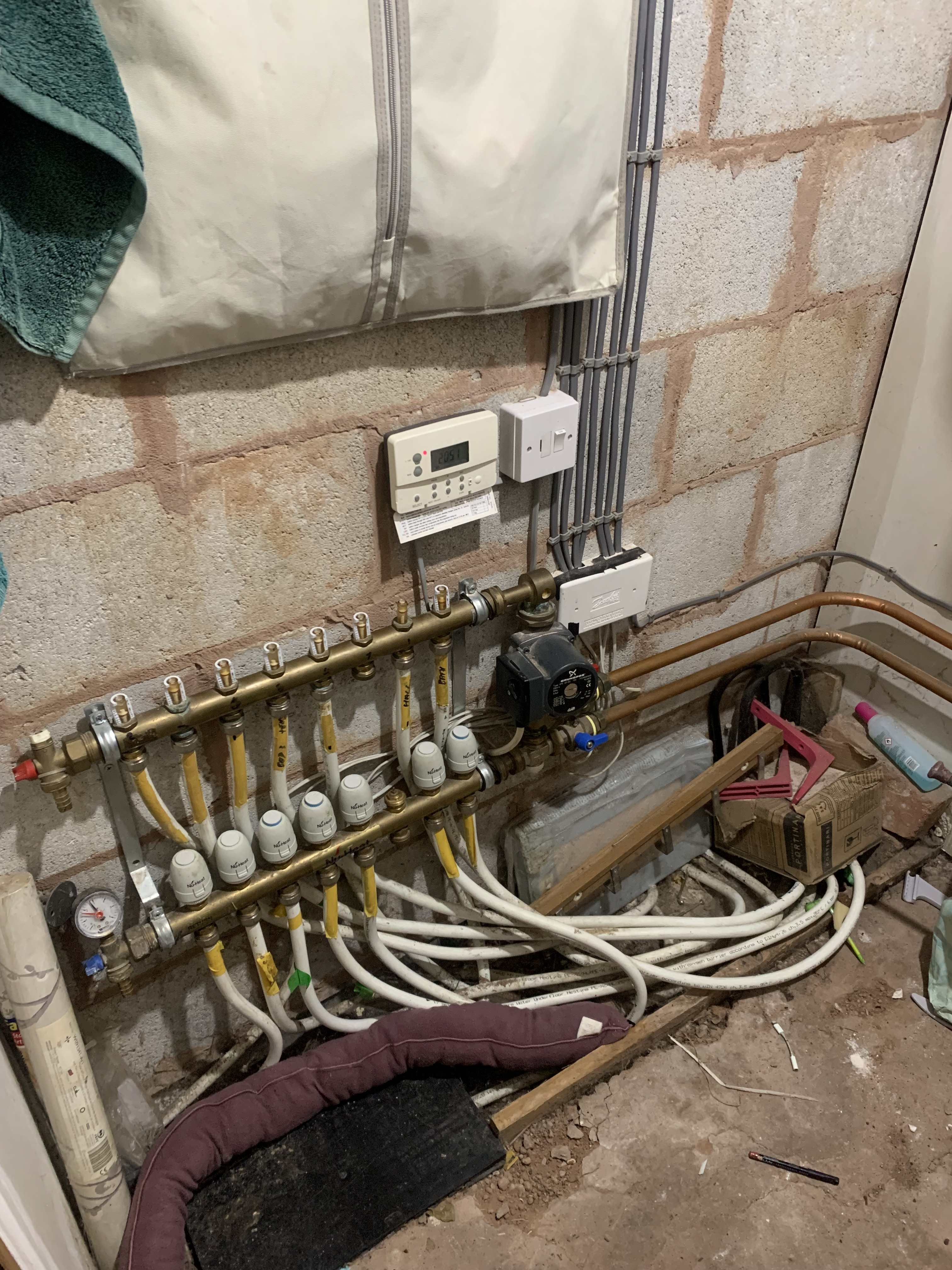

  10. Hi, hoping for a little advice. After switching on my ufh I’ve discovered that two rooms in our bungalow aren’t warming. The system was installed before we moved here (just over 10 years ago) but we haven't altered anything in that time. Upon closer inspection I found that the two actuators, linked to the thermostats in those rooms had stayed closed. I removed them, tested the pins (which all tested similarly to the others, firm but they do move) and re-attached. Voila! (I thought) as they slowly rose up. However, after several hours, no heat came to the rooms… I’ve tried testing each non-working thermostat in isolation by turning them to max but no joy. I can’t feel heat coming from the supply pipes leading to those rooms either but the actuator tops do get warm. I’m wondering, is if this all sounds familiar to anyone? And is it something can resolve myself? Or am I in, call out a professional territory? We did have a new boiler fitted around March this year. Though we haven’t had any problems with it. We also had a small leak coming from the return area of the manifold. This was repaired shortly after boiler was fitted by the same person. I have no idea how long we had the leak but when I did find it, it was a single drip every 30 seconds or so. Attached photos of the set up. And one (where i'm pointing) from when I noticed the leak. From left to right on the manifold, the seven connected rooms are performing as follows: O - NW - W - W - NW - NW - W (O = Off, W = Working, NW = Not working) I do have Bosch AdvancedTemp Infrared Thermometer. Incase it help with fault finding. Thank you for any help in advance.
