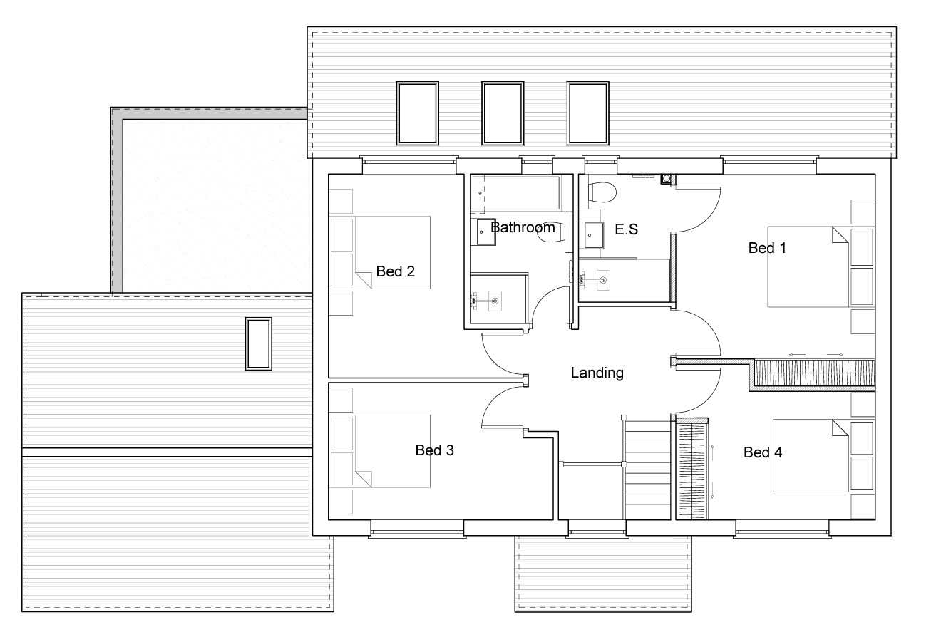

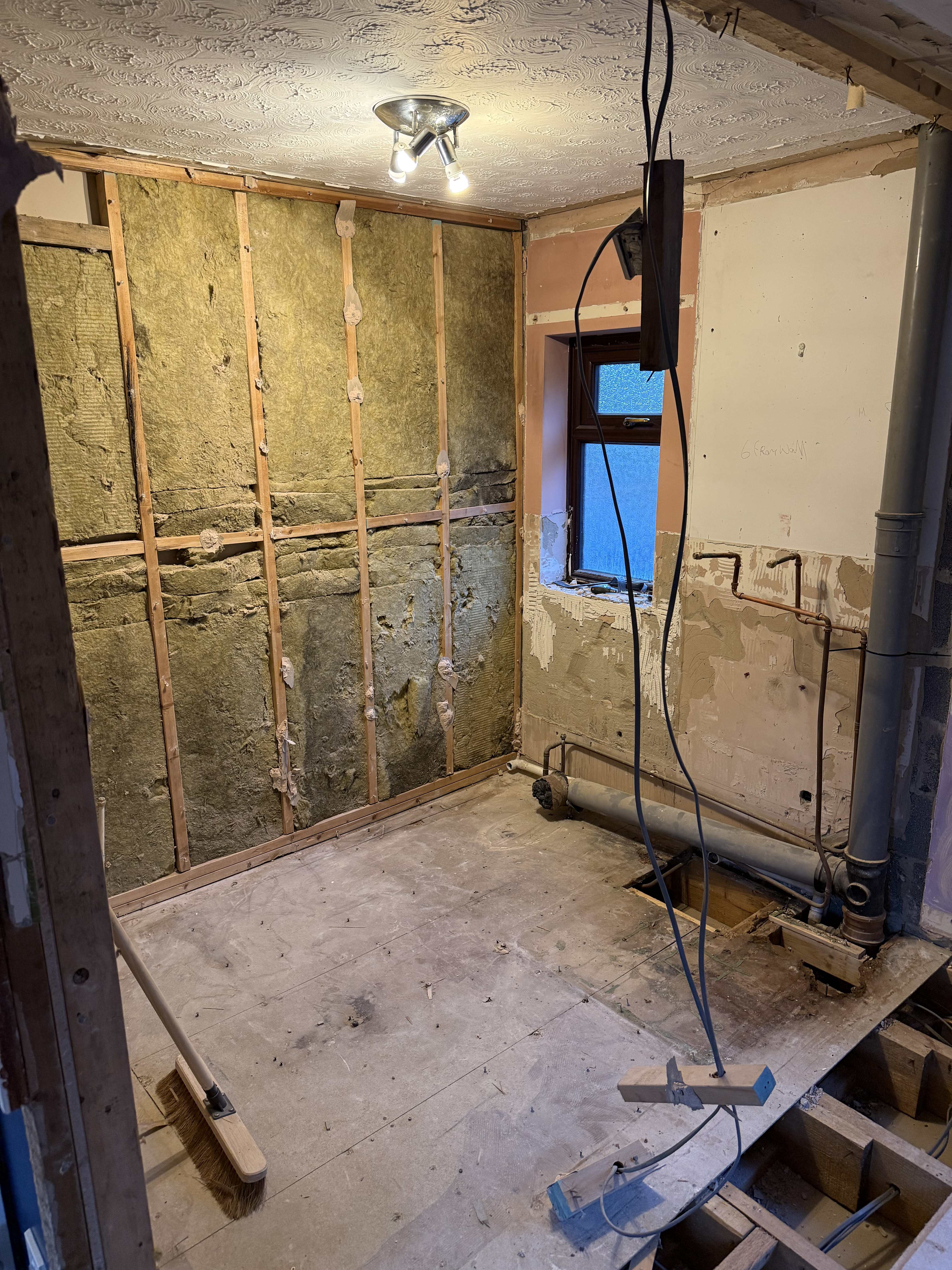

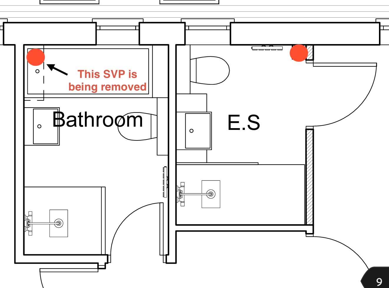

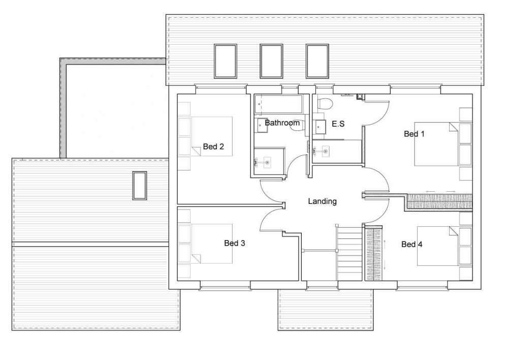

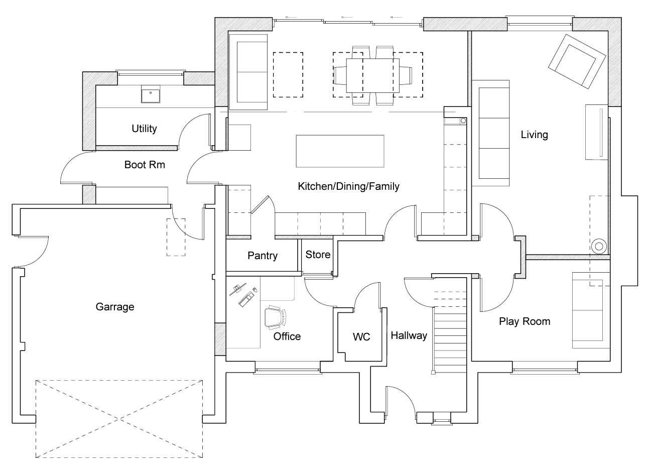

    Suffolk, UK

  1. Sorry Nick, you've lost me now. You're now saying both toilets can't share the same horizontal pipe? If so, how will have space to run 2 individual 110mm pipes to the SVP, especially as they would be connecting at the same side?

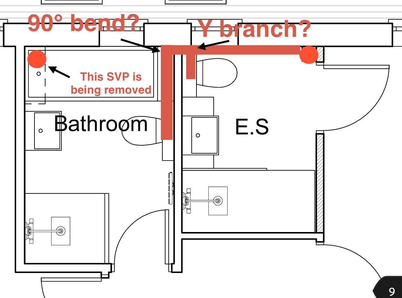

  3. Hi Nick. Thanks again. I think I understand you. I have thrown a rough sketch together to ensure I understand. 90° turn in main bathroom to start the horizontal pipe. Horizontal pipe remains straight, through the wall, to the SVP, with the en-suite toilet connecting via a Y Branch connector? Is that right? Obviously maintaining a fall on the horizontal pipe. Regarding toilet type, attached is what we’re going with for the en-suite. Main bathroom is undecided, but likely to be a freestanding toilet.
  4. Hi Nick, thanks for your reassurance. How exactly will it work? Will I extend the horizontal soil pipe through the wall into the other bathroom, and then have the second toilet connect into it? Are there issues when connecting 2 toilets to the same horizontal pipe?
