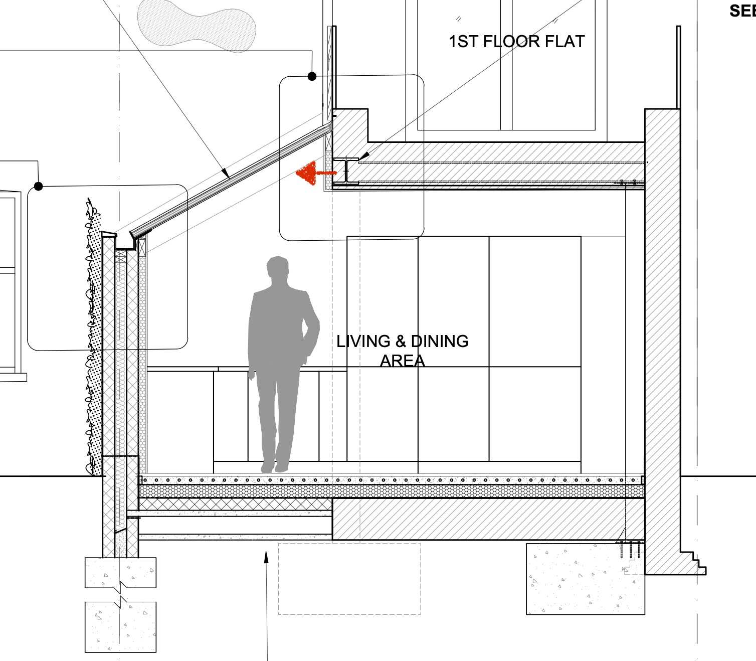

  1. Thanks both. I'll try to stop overthinking it 😅 I've asked BPC to price in for Coanda effect nozzles. I did also wonder about placing the vents in the open plan area so they come out horizontally just below the top of the pitched roof. I assume though that goes against your advice @Mike of keeping them away from the walls by at least 350mm? I asked BPC about the Zehnder CA 160 and they've quoted a doubling of the total cost to include it (~£1700+VAT for system with Vent-Axia Sentinal BH vs ~£3400+VAT for system with Zehnder CA 160). I'm not sure such a jump is justifiable. Question is whether there's something in between that would still be more reliable than the Sentinal BH (I see more bearing issues crop up in this forum for them than any other model) - the Vent-Axia Econiq S or Zehnder 155WM, perhaps? Maybe I'm just overthinking things again...

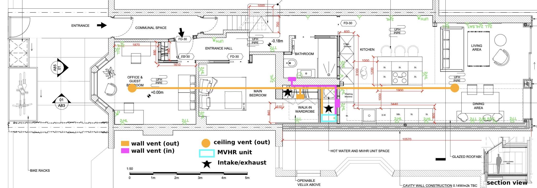

  2. Hi all, I've come across several posts on this forum while trying to decipher differing quotes and designs from suppliers (BPC, Paul Heat Recovery, the Airshop, ...). I'm still unsure on a few points and hope I can get some help here! We're renovating and slightly extending our 2-bed flat, taking the opportunity to make it airtight and install MVHR, among other things. It's going to be about 71m2 with an average ceiling height of about 2.5m. That's approx 89m3/hr for 0.5 ACH, 53m3/hr for 0.3 ACH (PHR say commission on 95m3/hr). We've been specced a Vent-Axia Kinetic Sentinal BH or a Zehnder CA 180. The questions I still have are: 1. several people have mentioned setting their units to effectively their lowest speed, and even wishing they could go lower. They seem to always be talking about larger spaces than ours and I worry that we'll never be able to reach the low speeds we might eventually desire. The two units specced reach down to about 50m3/hr, are we going to feel like that's still too high? 2. linked to (1); the more premium units I find on most websites (e.g., filtering on passivhaus certified) seem always for larger spaces (and would _definitely_ not allow us to reach lower flow rates). Only the Zehnder CA 160 is shown on BPC when filtering up to 200m3/hr + passivehaus certified. What are some of the units that people recommend for <100m2 spaces (<125m3/hr incl. boost)? 3. We've had a few different recommendations on vent layout, with BPC suggesting two outlet and two inlet vents in our proposed open plan kitchen/diner/living area (~34m2). This seems excessive to me, especially since PHR suggest only one double plenum inlet and outlet for the same space, but they won't budge on that layout when pushed. I've attached what I think makes most sense but am now unsure after BPC's strong recommendation for more vents! 4. The only place we can feasibly fit our hot water tank and MVHR unit is in a space carved out of the main bedroom wardrobe area, with access also only realistically possible from that direction (i.e., we can't create a complete sound-insulating seal as there'll be an access hatch). Are we likely to be able to hear it in operation from the bed? 5. Finally, given that each room is relatively compact, we're finding it hard to find good spots for our vents to avoid "cold spots" where people might feel the flow over them as they sit/sleep v. close to a vent. Particularly, in the living/dining area since exact positioning of furniture is TBC and we want to avoid a vent ultimately dictating where we can put things. Where could it go so that it's able to do its job properly but also won't cause any discomfort? Do we just need to think about a pre-heater for that vent? Thanks all!
