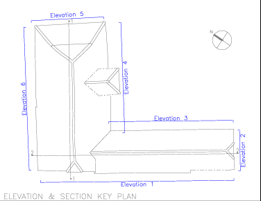

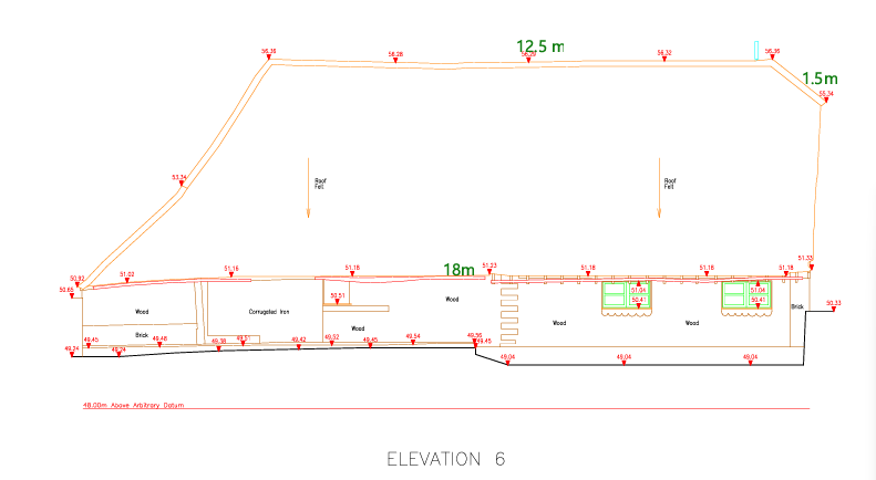

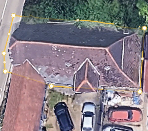

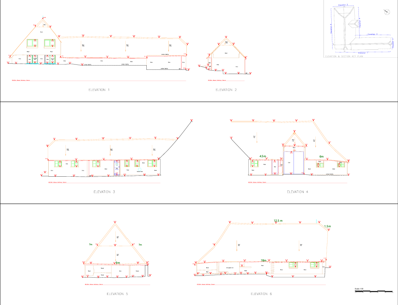

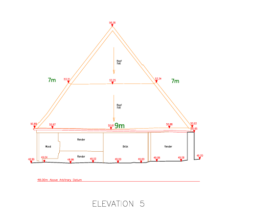

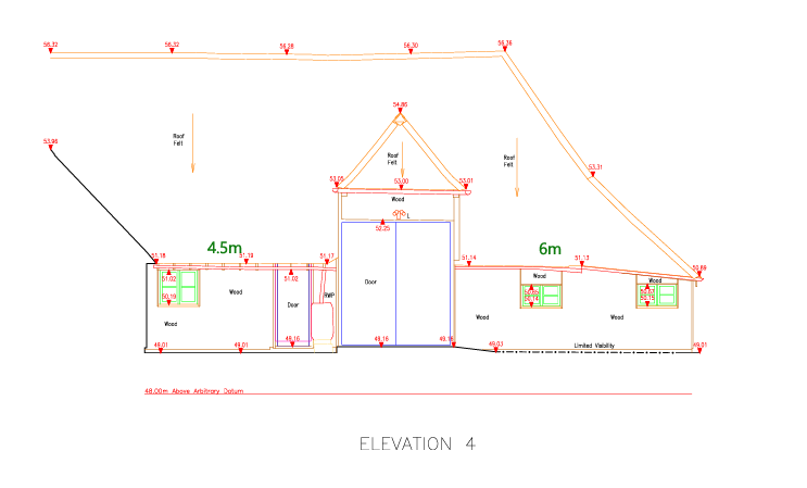

  1. Hi all, Hope you're all keeping well. Also hoping, I could get some help if possible. I'm looking to place an order for some reclaimed roof tiles in readiness for a roof replacement on my barn as part of its conversion to a residential dwelling. I could use some help figuring out an approximate number of tiles I'd need to order. I'm looking to use Rosemary clay tiles which are 265mm x 165mm. 60 tiles per m2. I know I'll need eaves tiles and tile and a half's too but for now I'm looking to get the bulk of it ordered. The part of the roof I'm looking to replace are elevations 4, 5 and 6. I have attached reference images of the roof and measurements (in green) which I took myself using the 1:50 scale from the drawing. Is there any info I'm missing? Thanks all

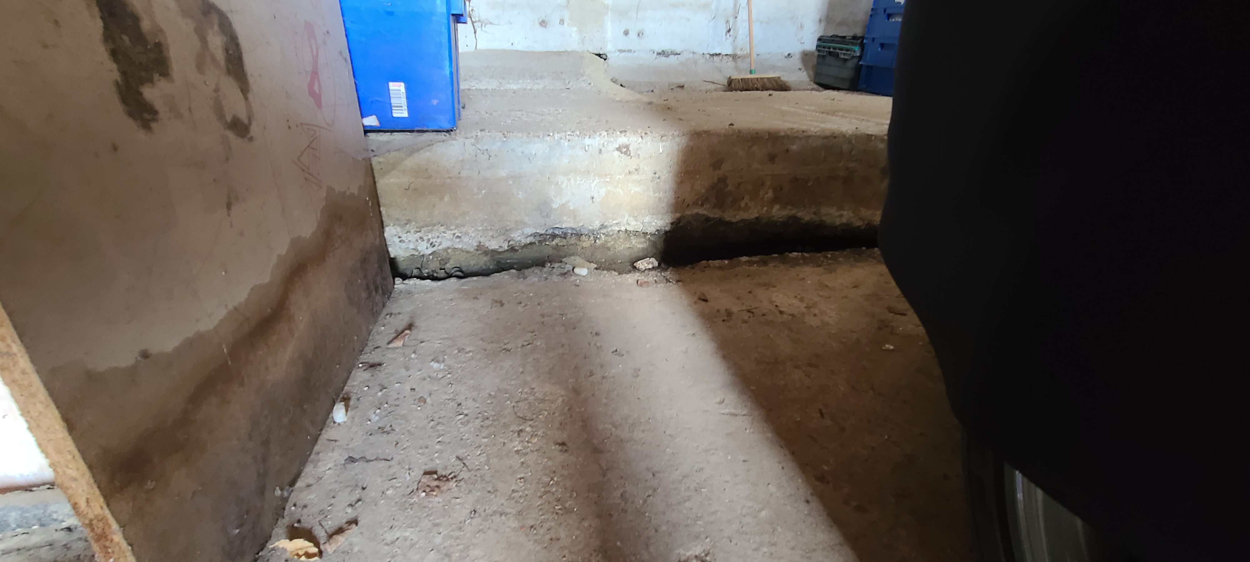

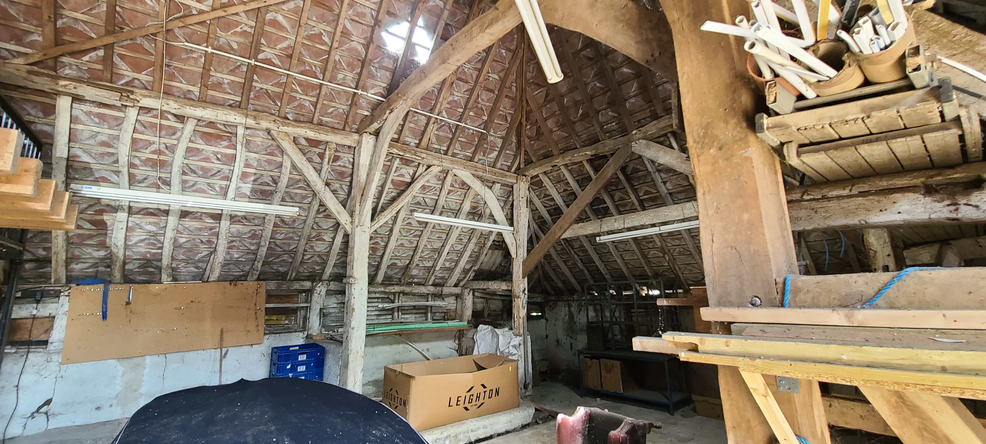

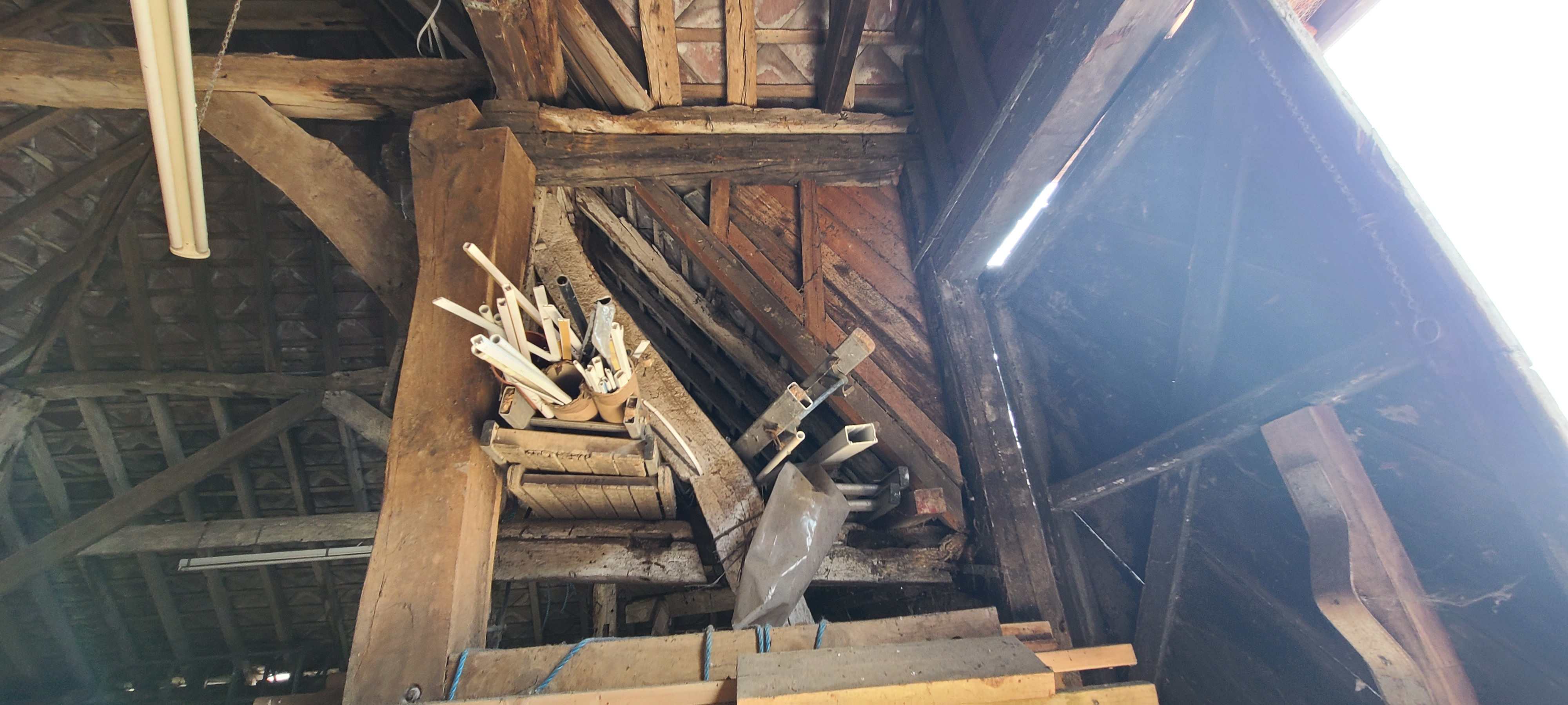

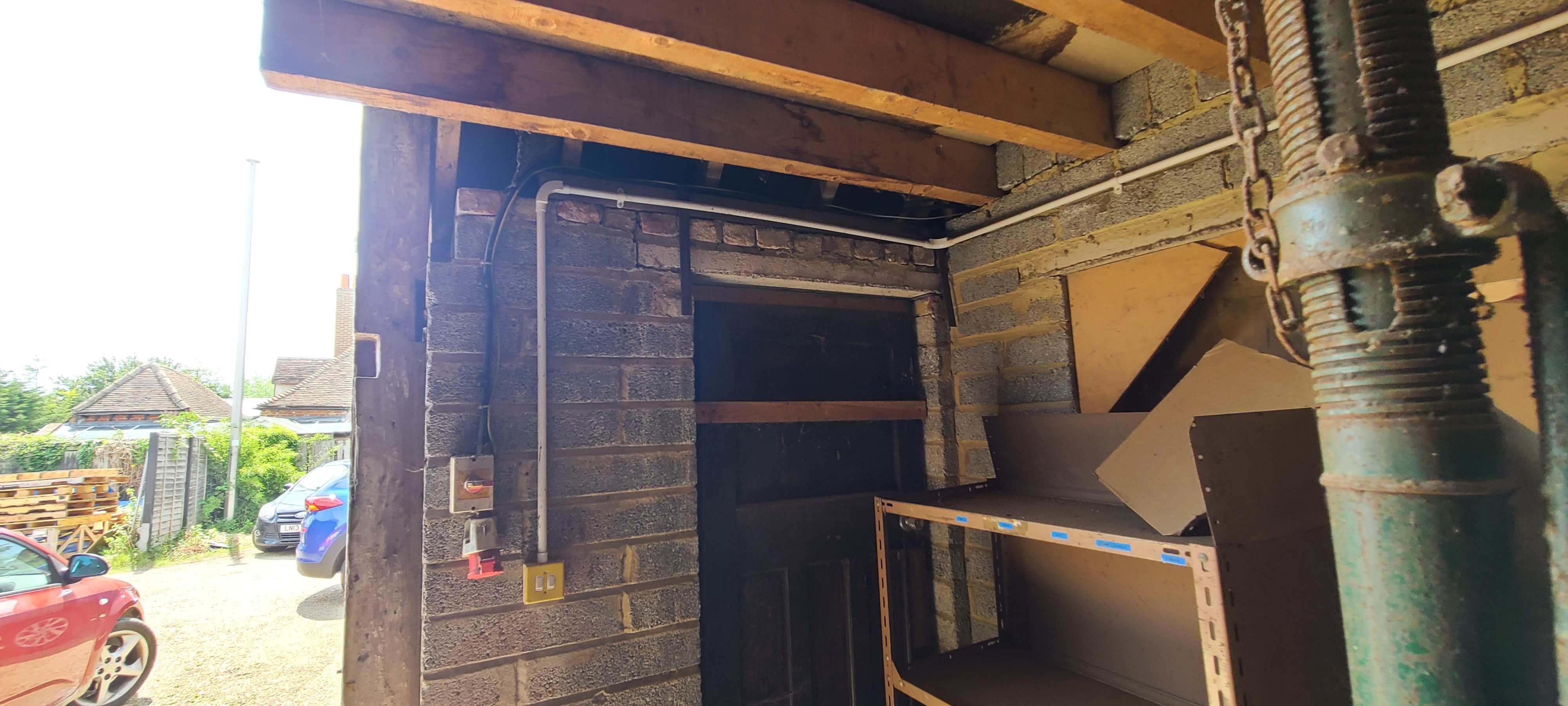

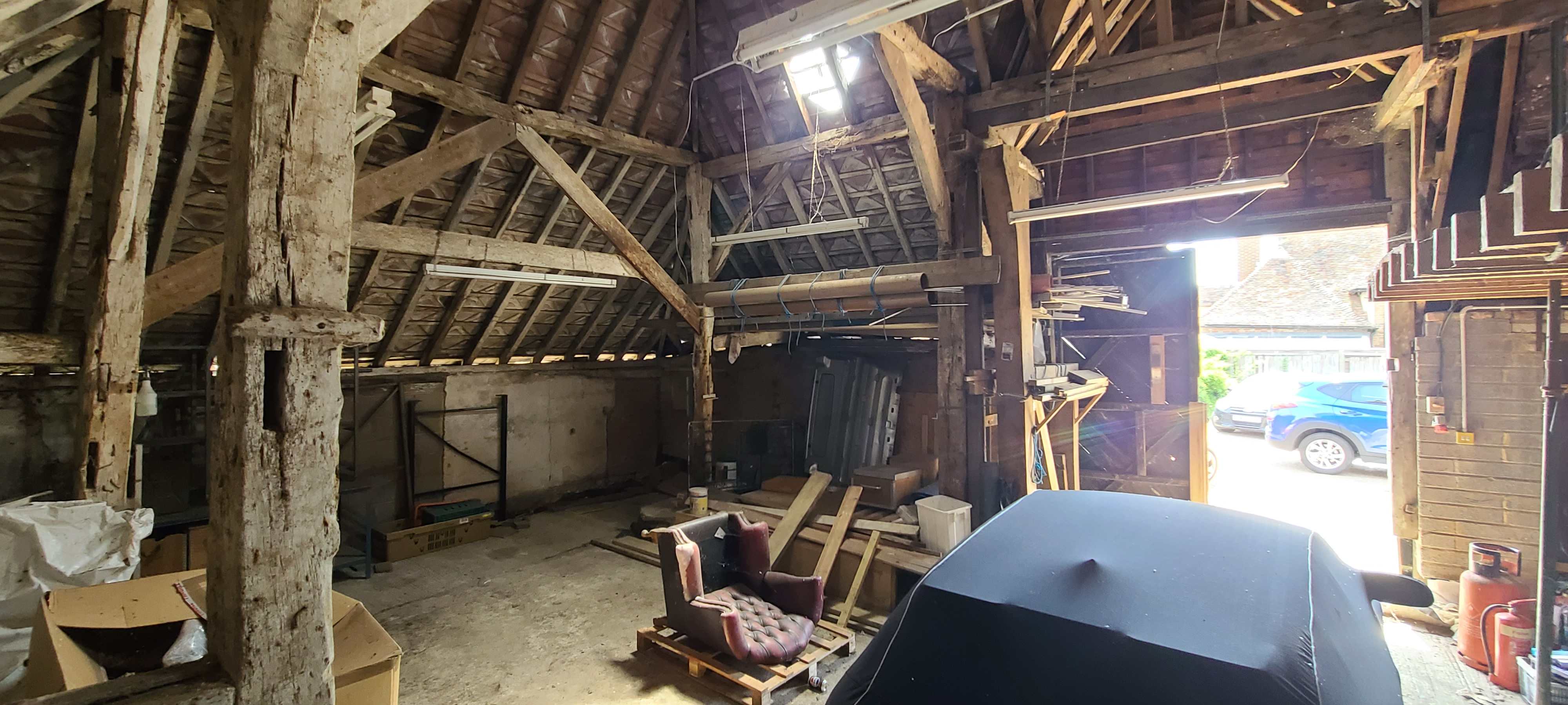

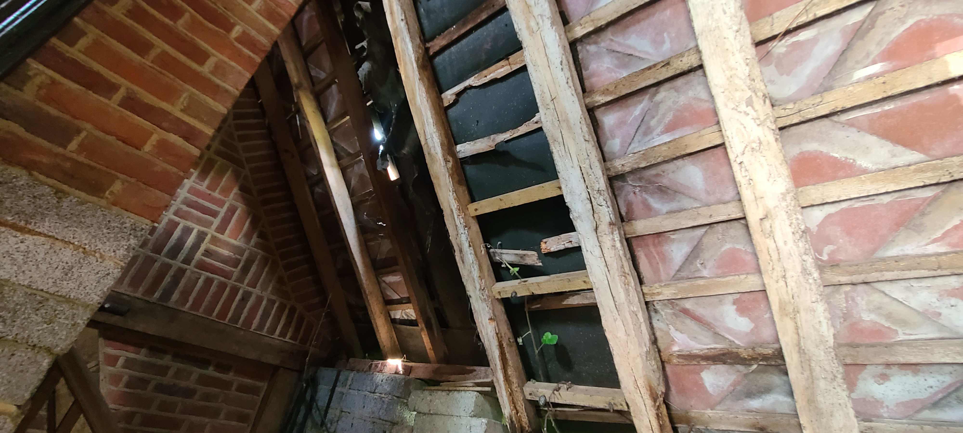

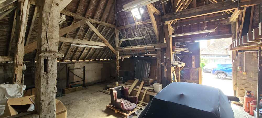

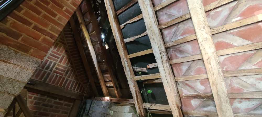

  2. Here are a few pictures of the current condition. It’s an L-shaped building made up of the barn and a long block section that was previously used as offices. The office section isn’t in bad shape, just a bit dated but the main focus to start with will be the barn side. A laser scan was carried out on Friday, so I’m now waiting for the completed measured survey report. The barn currently has an asbestos tile roof, which will need to be replaced with clay tiles. Since clay tiles are considerably heavier, the existing beams will need repair, reinforcement, or replacement. I’ve reached out to a few structural engineers to assess the load-bearing capacities of the beams and walls, but haven’t had much luck getting responses so far. One company did suggest waiting until the measured survey is done before they take a look, so hopefully they’ll be happy to come out once that’s ready.
