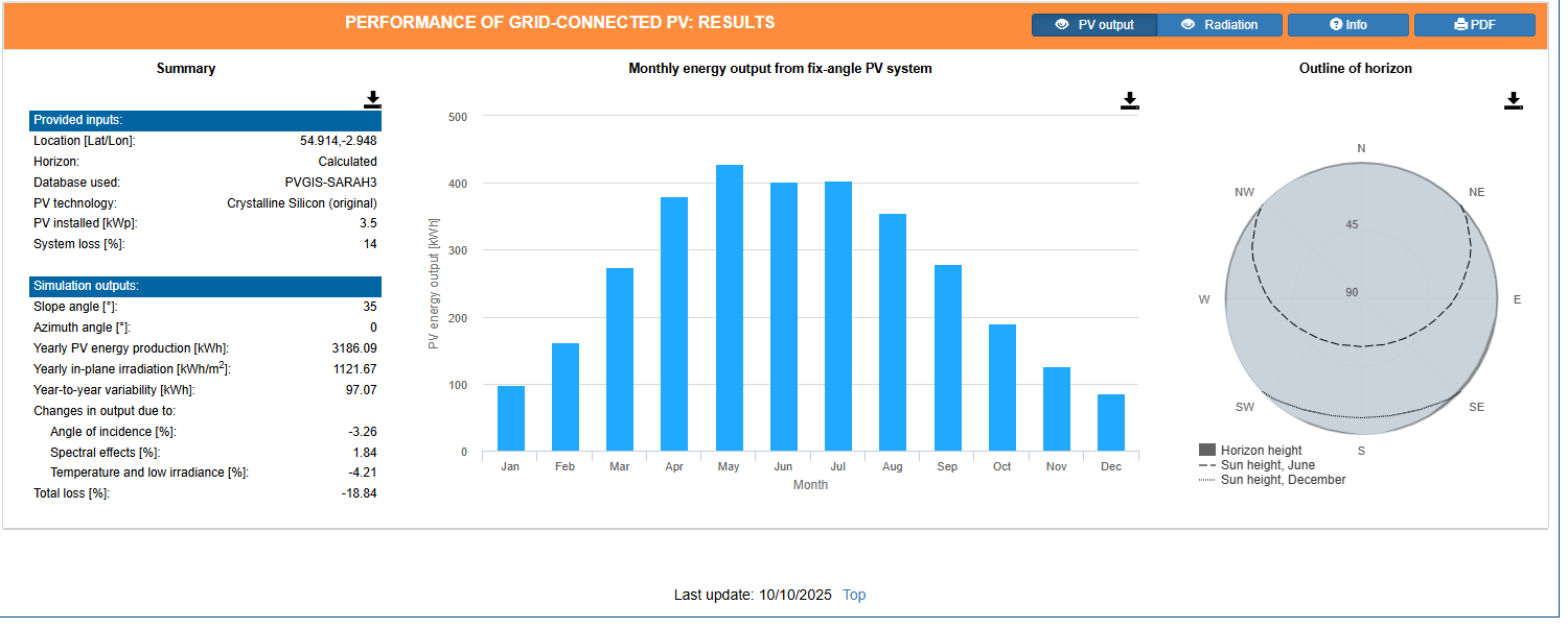

  1. This is what I get when I change the output to 3.5KwH. Is that OK? What does it actually mean in terms of my thoughts as it just looks like a lot of pretty blue bars to me? Ive 'fag packet' calculated my average KwH usage is around 16 Kwh. This is just the mean average so obviously a lot more in the winter than summer.....although to be fair the monthly electricity bills range from £188 in Dec to £136 in September so not a HUGE difference.
  2. Thanks SteamyTea, I went to the link but could not make heads nor tails of it and could not get anything like your image from it....sorry! I intend to try to use the existing solar panels to run as much (thinking as close to all as possible) of the General Electricity usage in the house (hot water via emersion, Cooking, washing clothes, electric showers etc) when connected to battery storage for evenings (not home really during the day so 80% would be evening use with some morning showers etc) Is this even feasible without having to have a massive KwH battery storage and therefore making it completely not viable from a financial point of view. I thought/think I'm in a good position as the PV part of the system is already there so my expense is on battery storage and installation etc. I was hoping to be able to run all electric side of the house (not heating) from battery storage (taken from solar panels when they can and cheaper rate KwH over night for use next day) Am I being too simplistic and its not really financially viable? Yes, I love our planet too but my wallet also like £ notes in it each month I dont mind a pay back period of 8 years or so. I have the money for a battery system now (which I probably will not have in the future) so my thinking is that I use it for battery storage and then will save around £80/£100 per month off my bills going forward. One other thought that just came to me....maybe better to pay the £7000K off my mortgage instead? Bloody mine field....not even got into how big a battery I need debate.....Ahhh.
  3. Additional thought. My old electricity usage on my previous house was £1800/ year (gas boiler so just normal electricity items used). If I was to get a battery say £6K including installation etc and run everything but the heating (get another gas warm blown air unit to replace existing one). Is my maths below missing anything vital? Assuming I have to buy some off peak elec during the mid winter months to keep the battery with enough juice to run electrical house items (maybe £80/ month for 4 months = £320/year) minus small gain back from feed in rate over the summer. I could potentially save around £1500/ year on my elec bill. Battery cost 6K with installation would give me a payback time of 4 years for the battery then large yearly saving after that. Does this sound correct? Thanks again
