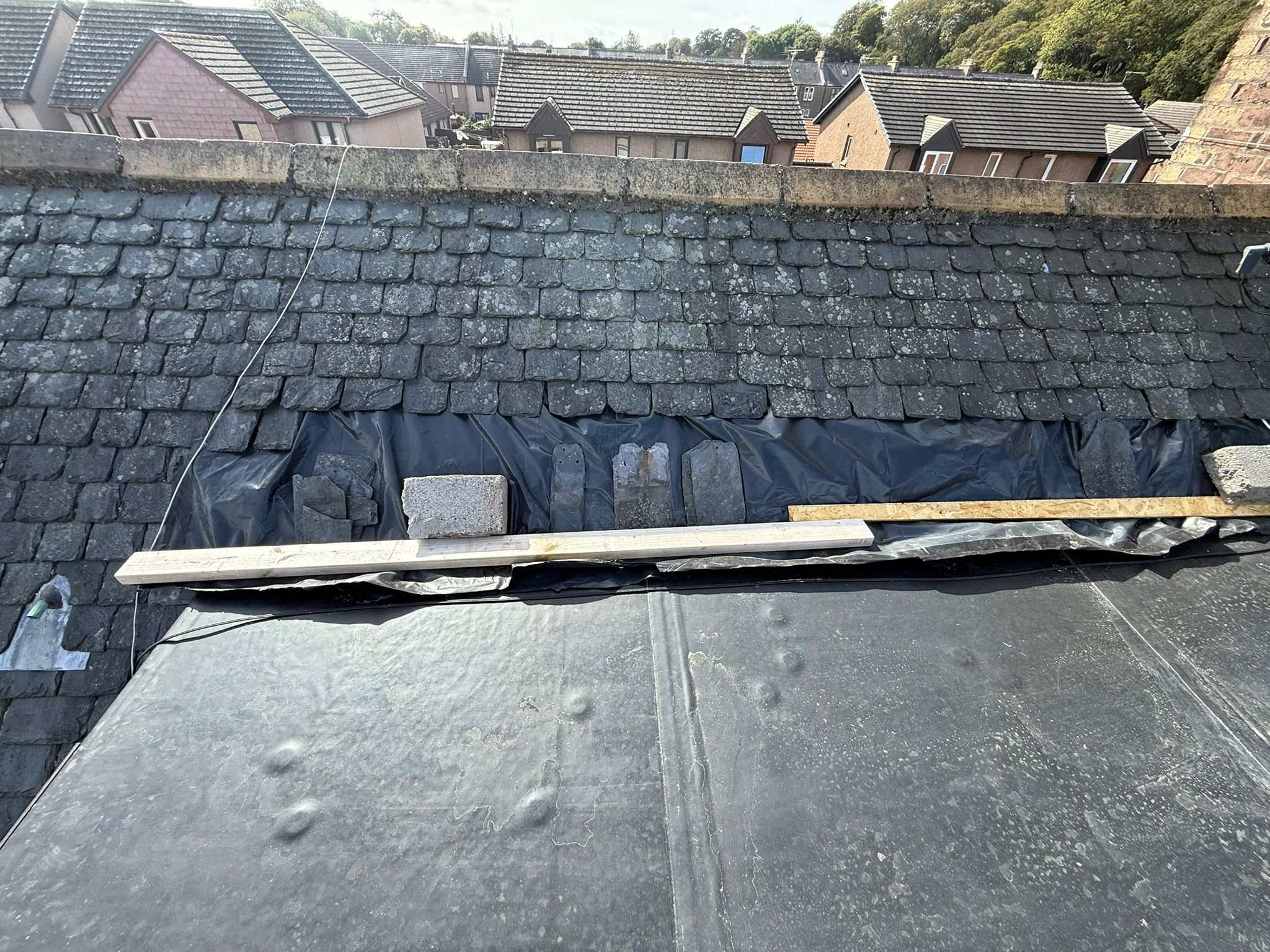

  1. Hi any help would be appreciated. I have a pitched roof that terminates onto a flat roof. I recently laid the EPDM on the flat roof and due to the pitch roof sarking boards not being in great condition I overlaid with 9mm osb3 30cm up the pitch so the EPDM had a good surface to bond to. I have went to dry lay the slates and the osb has caused the bottom of the eaves course to kick out about 1" from the pitched roof. Is this acceptable?
  2. What do you mean by the tilt fillet may need cutting? I have been thinking of maybe getting slate hooks for the slates above. Sorry for the delay, im working abroad
  3. The water will just drain onto the flat roof
  4. Would you treat the under eaves course above the flat roof as a normal under eaves course and just keep the slates in line with the existing slates on the left while maintaining the same headlap?
