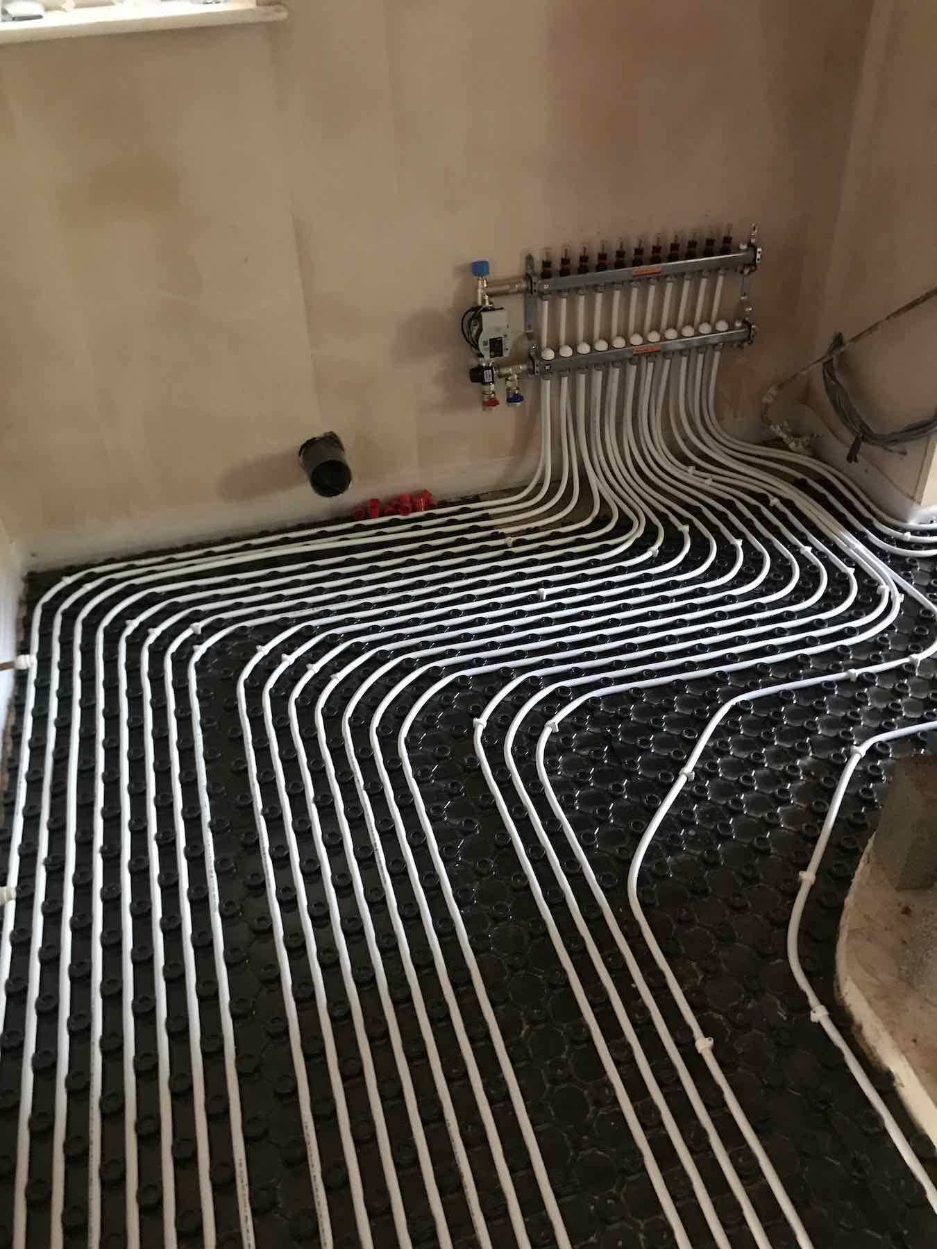

  1. I don't think you have any experience on 50mm pipe spacings. It appears you have done one install, on 300mm pipe spacings, using a totally different heat source and flow temperate to mine.
  2. I was responding to your claim that LoopCAD does model what I said it doesn't model. Keep up 😜
  3. Yes, as an example of 50mm pipe spacings, which you see regularly on photos of UFH installations online, and their impact.
  4. I disagree. If the flow temperature was say 40 degrees, what is to stop the floor surface temp increasing way beyond 27 to 29, where you have very close pipes in transition? The rest of the room where you have normal pipe spacings, yes, you design the flow rate to ensure 27 to 29 degrees, so an area of floor with much closer pipe spacing would lead to a higher surface temp. In this type of situation you essentially have two different set of parameters, which will ulitmately lead to two different floor surface temperatures.
  5. If you had a 4m wide room, with a bunch of transition pipes at one side only, LoopCAD does not highlight that as being a hot spot - all it does is show an average floor surface temperature for the entire floor (in that view). Beyond some distance (say 1m) from the bunch of transition pipes, there won't be any increased floor surface temp due to the transition pipes. I don't think the average for the floor would be correct either.

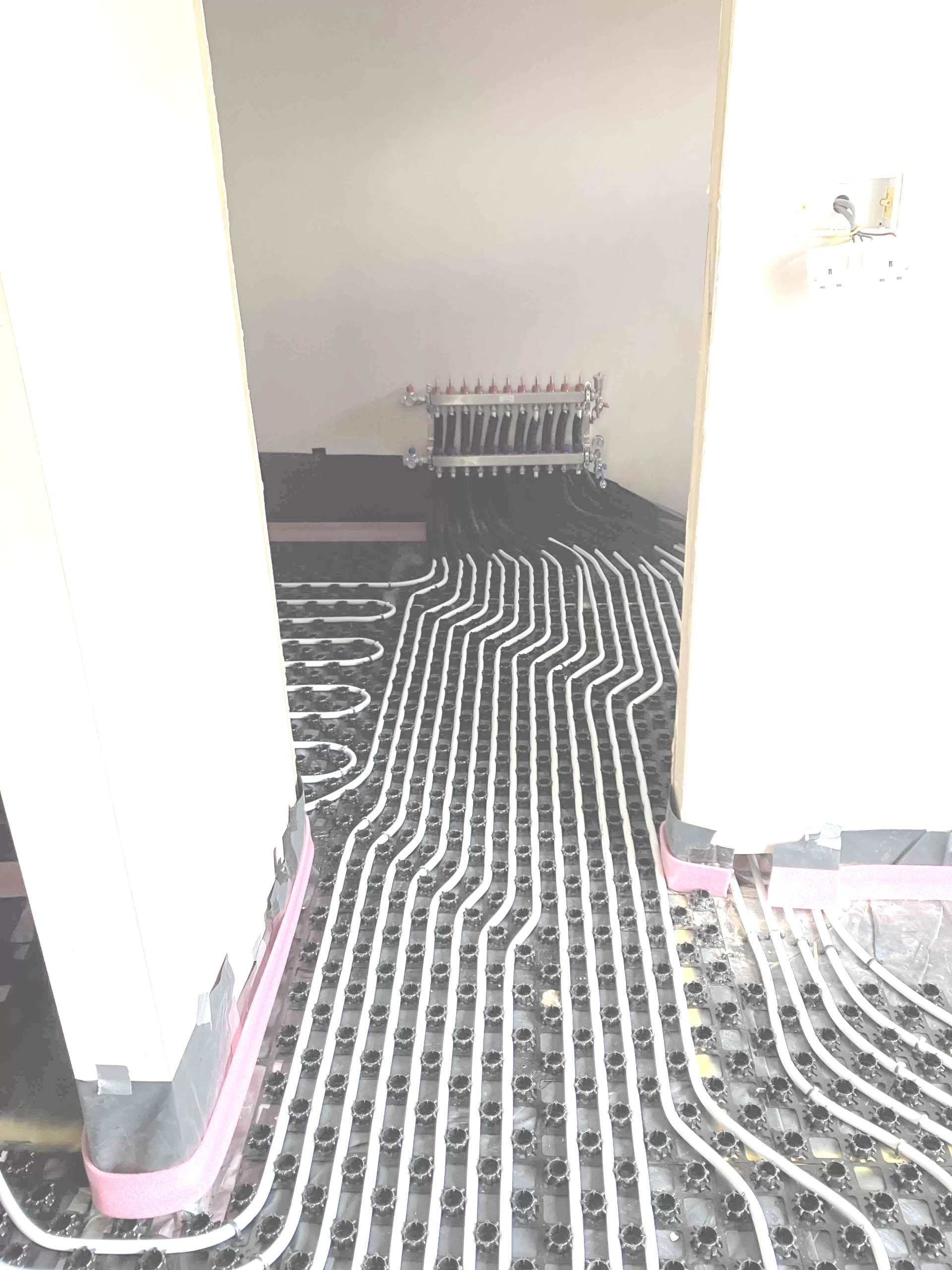

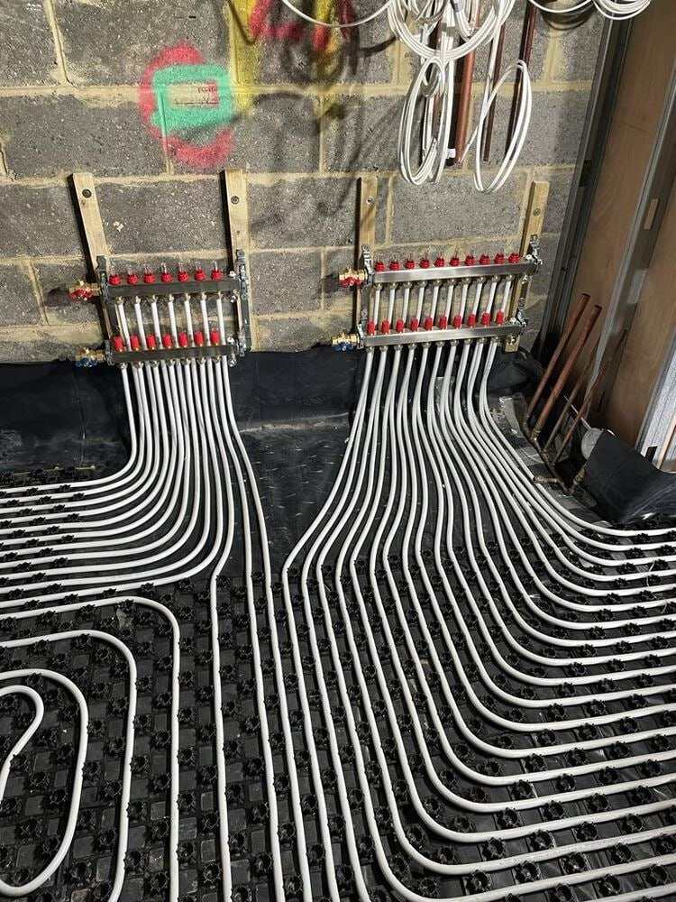

  6. Here's some examples of masses of transition pipes at 50mm spacings, NOT sleeved. Must result in over heated areas above 27 to 29 degrees if the flow temps are set to achieve 27 to 29 in the rooms they are going to? Is my assumption correct, that if a flow temp and flow rate for a particular circuit to achieve a floor surface temp (top of screed) of N degrees (27, 29 etc.), then bunching up a load of transition pipes together with closer spacing, will result in a higher floor surface temperature? LoopCAD doesn't seem to model this; looks like it creates an 'average' floor temp (can't see an analysis view for hot spots 🥵) What about short-circuiting from flow to returns, at what is the extremeity of the circuit (hottest part of the flow, coolest part of the return)? I can't see how the floor temperature can be controlled in these areas 🥵. Surely will lead to much higher floor surface temperature, for whatever floor covering is going above (tile or brick slips would be fine, but carpet, wood etc.
  7. The bend radius is the same for 50mm pipe spacings on 90 degree corners, as it is for any other pipe spacing, which is the bulk of a sprial counterflow circuit. It's only in the middle you have to revert to 150mm spacing to create one or two 180 degree returns.
  8. I'm genuninely curious to know if there are any negatives other than those I outlined (cost, etc.) for 50mm spacings. Thanks
