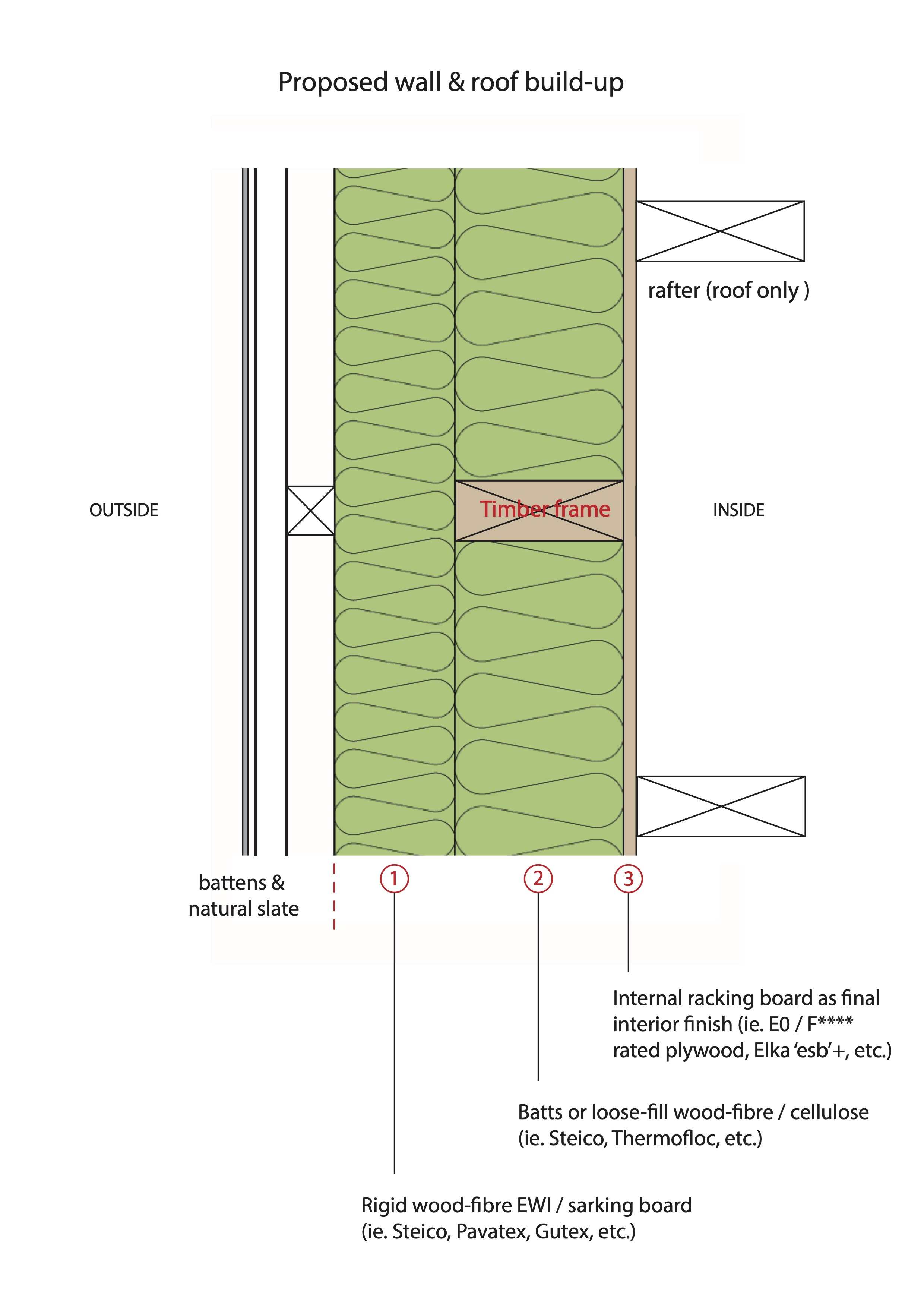

  1. Thanks ADLIan, that's a helpful point. We're considered blown cellulose for layer 2 also, but I guess that doesn't make much difference... Is the wall finish ext & int to FR60 enough, or a whole tested system necessary (therefore a pricey proprietary system no doubt šŸ˜µā€šŸ’«)? Thanks for your time
  2. Hello all, I'm a long-time fan of this forum, and first-time poster, so thank you all for your insights so-far. I've designed and just received planning for a Mansard-inspired upward extension, with vertical 'roof' walls turning to a double pitched roof, all slated like a giant pointy hat. Our priority is to keep the build-up vapour permeable, so using wood fibre and maybe even vapour-open racking board as the internal finish (ie Panelvent / Elka). I've attached a draft build-up below (internal racking / frame & bio-insulation / solid wood fibre / battens & slates). The only issue I can foresee, however, is that we are within 1m of our boundary on both sides, so fire rating is obviously going to be a BC issue. My question to you, the well-informed congregation, is — does anyone know of a proprietary / tested system similar to my drawing, or have any insight? Am I right in thinking the external cladding needs to be 1hr, and the internal 30mins—therefore this should work if I treat the internal for 30 mins (but is the external void behind the slates an issue)? Hoping to iron this all out before it becomes a problem on site! Any thoughts would be most appreciated. We're trying to keep the build-up as simple as possible, with woodfibre etc for the high decrement factor. Thanks for your time! Ano wall_buildup.pdf
