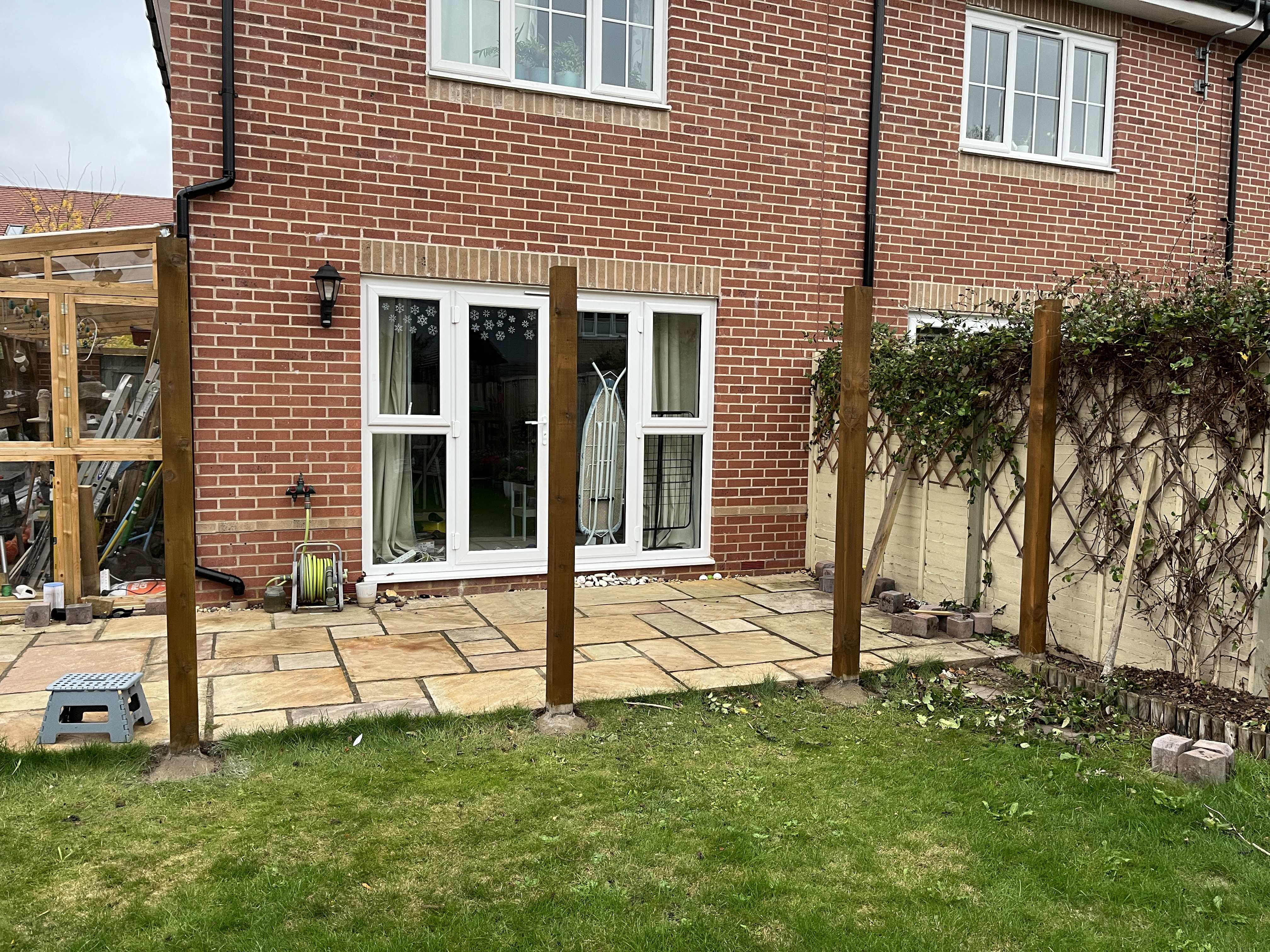

  1. Yes the pergola will rest on 4 vertical posts. I am not sure about putting the fixings in the mortar though, as I recently repositioned a down pipe and the mortar between bricks or whatever compound they have used, did not look very strong.

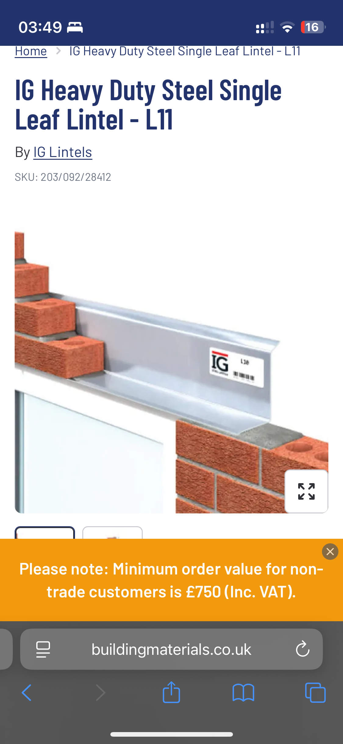

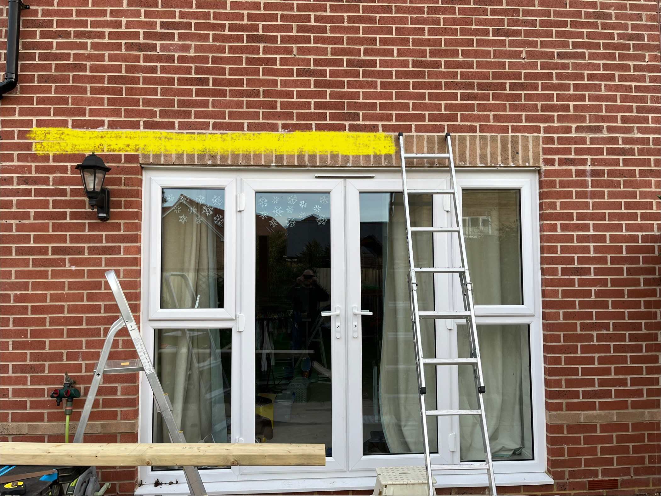

  2. Hi All, Will it be ok to attach a timber ledger (6x2) on the lintel area above the patio doors? This would be for a lean to pergola (4.5m x 3m) The ledger was supposed to be installed where the yellow line is in the attached pic, and it should need about 3-4 masonry screws for fixing on the lintel area. I have read some post saying it could damage the house structure and posting this as I am concerned… Are lintels steel inserts like the one in the 2nd picture attached? The house was built in 2020 Eventually the ledger could be installed higher but I was hopping could attach it here as it would be the same height as the side house existent pergola. Thank you!
