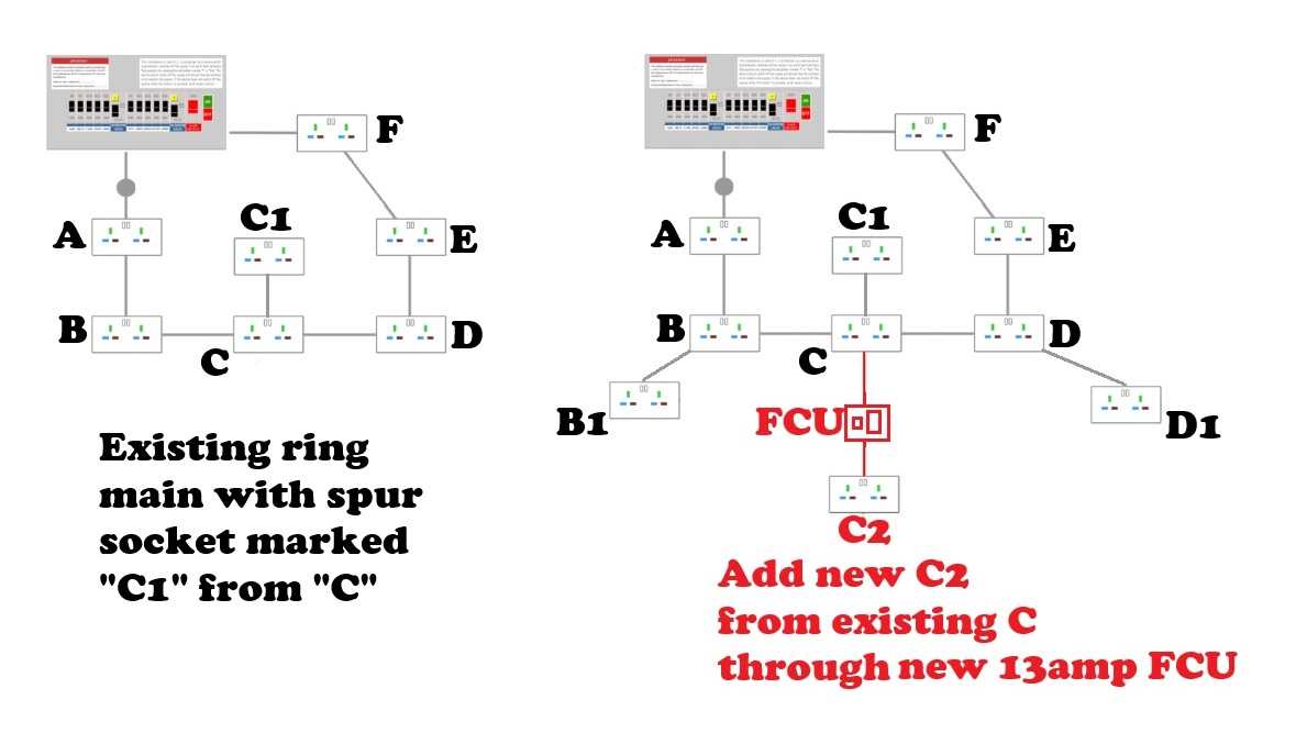

  1. Hey, I want to add additional socket on a ring main. Initial plan was to spur from existing socket C, however it appeared to be that C and all the other nearby sockets (B and D) already have spurs attached to them ( I am not exactly sure where these spurs from B, C and D are located, as all the wires are in the subfloor and I have not traced the cables nor did any continuity checks). Could you please let me know if the proposed option on the right is feasible and within the regulations? Or do I need to find locations of either B1, C1 or D1 from B, C and D resprectively, do the break between them to place a 13amp FCU in between and wire these up in order as it should have been done the proper way? Looking for the suggestions
