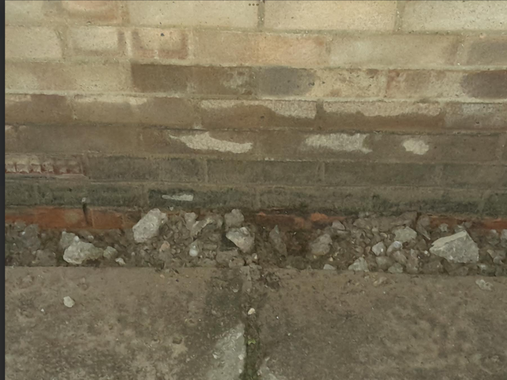

  1. I have had a linear channel drain cut into the concrete along the wall. After this was done: New brickwork below the channel became exposed Some of this brickwork had missing/poor pointing and the builder didn’t repoint before inserting the channel. After rain, the wall started getting noticeably wet low down, forming a horizontal band The wetness appears above and below the DPC, is uneven, and is not splashback There has now been over a week with no rain, yet the bricks have not fully dried, and the damp pattern has barely changed. This never happened before the channel was installed. I think I have created a moisture problem that didn’t previously exist, possibly due to capillary action from the ground or the newly exposed brickwork. Would removing the channel and reinstating the concrete be a sensible way to stop the wall drawing in moisture or is this new plan possibly making things worse. This is a classic example of leaving well alone. I should have ignored the original gap. The bricks were never wet. Thanks for all the replies.

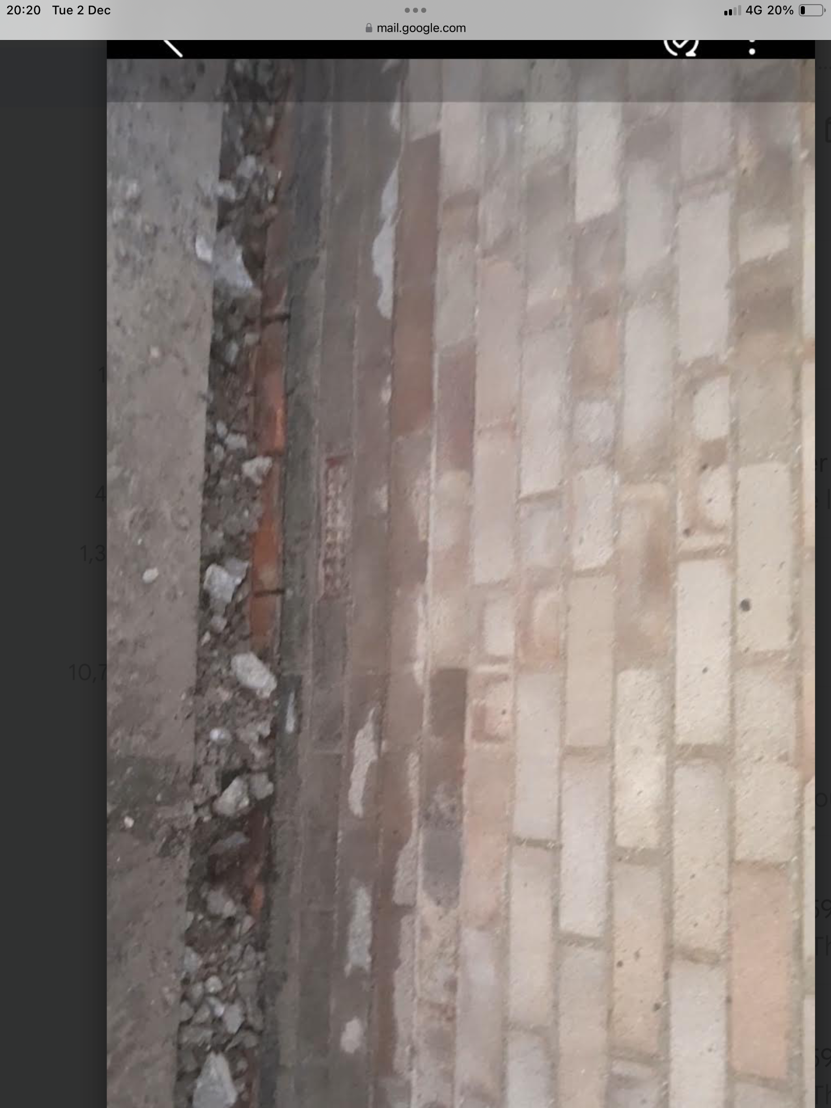

  2. Hi, it is definitely the bricks that are wet. And the property is 1970s and there is a cavity wall that is filled with a foam type substance. And yes, the top photo is before I decided to take the concrete up. I have attached another photo that shows the underneath bricks with a fair bit of mortar missing.

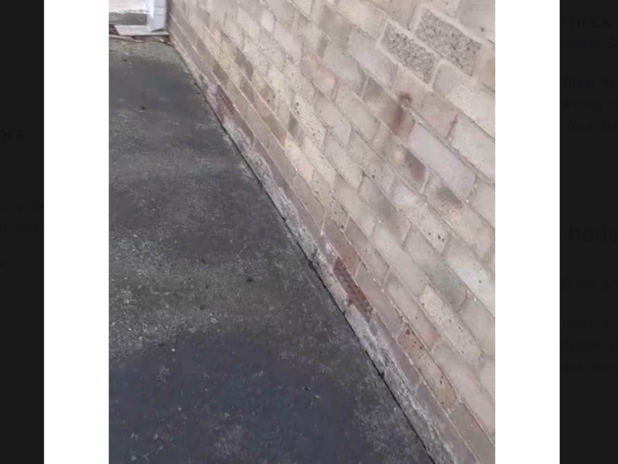

  3. I was concerned about a gap that had formed between my concrete path and the wall of my house. Over time the path has sunk and now slopes toward the house, so during rainfall I was worried that water might be running into the gap and potentially causing damage to the brickwork or leading to damp issues inside. (This was checked and no internal damp problems were found.) To address this, I cut a channel and will be installing channel drains. Since doing this, I’ve noticed something unexpected: after rain, the bricks in that area are now becoming very wet, seemingly through capillary action. This never happened before, even when water was running straight down the gap. I’ve now realised that the bricks below the original pathway level are exposed, and quite a lot of the mortar has come out of those joints. Could this be the reason the bricks are now getting so damp (as shown in the picture)? I assumed installing a drainage channel would improve things, but it seems to have made the wall wetter. Any ideas why this might be happening? And do you think I am doing the right thing by installing the channel drains? Thanks in advance.
  4. Hi Russell, thanks for the advice. Is this similar to a French gulley? Also, from what you’ve said, do you think the rain draining down the gap so far wouldn’t have caused any damage to the bricks or foundations? Thanks again.
