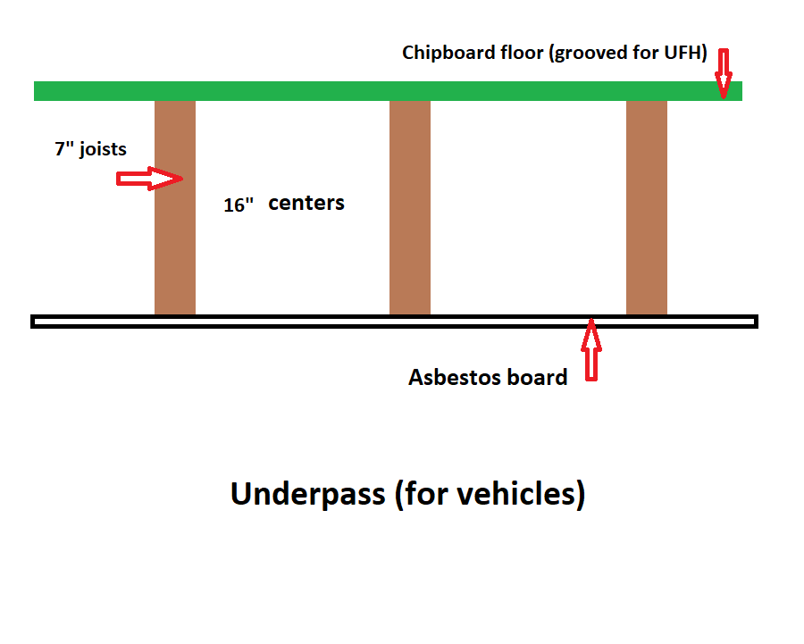

New Member

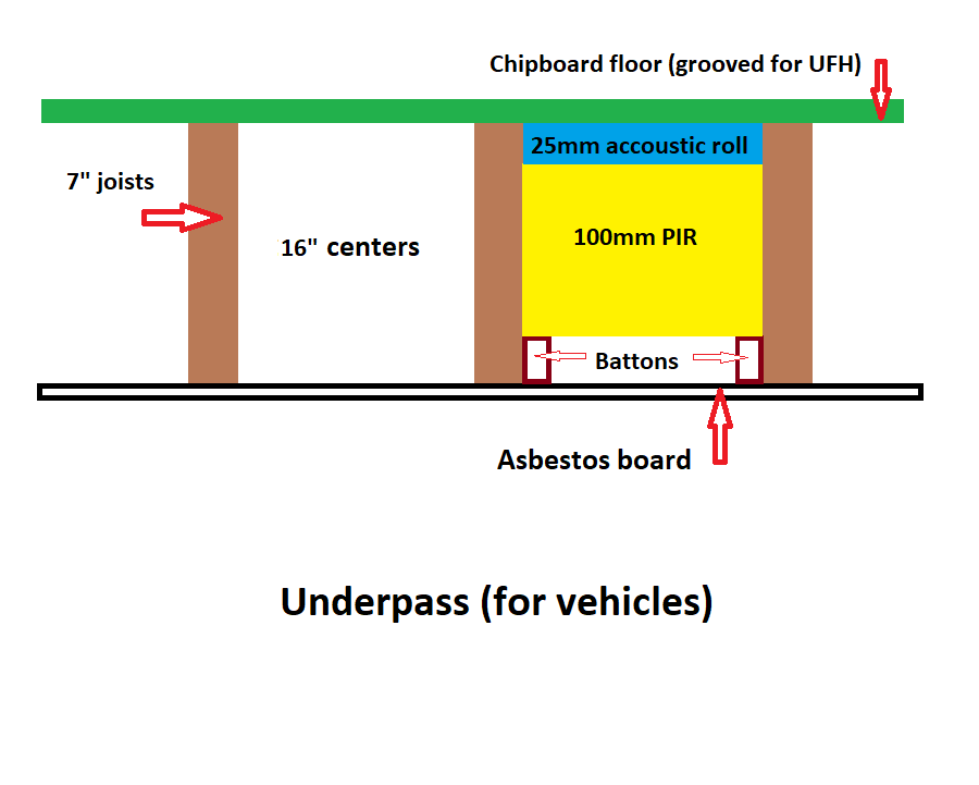

  2. Thanks for the replies. I'm not able to fit anything below or above the joists due to the floor type being set (already bought) I can only really choose what to put in the 7" void. Redbeard, if i just stuffed the void with RWA45, would you be concerned about it sitting directly on the asbestos boards? Would stopping all air movement around the joists be a problem in terms of rot?
  3. I should add that removing the asbestos cement board from below and re-fixing using resilient bars or similar isn't practical (due to height and asbestos) I should also add that I've already bought the chipboard for the floor (it's Torfloor2 plus) I realise that this will never be great acoustically. My first idea is to use 100mm PIR plus 25mm acoustic roll (knauff or similar)
