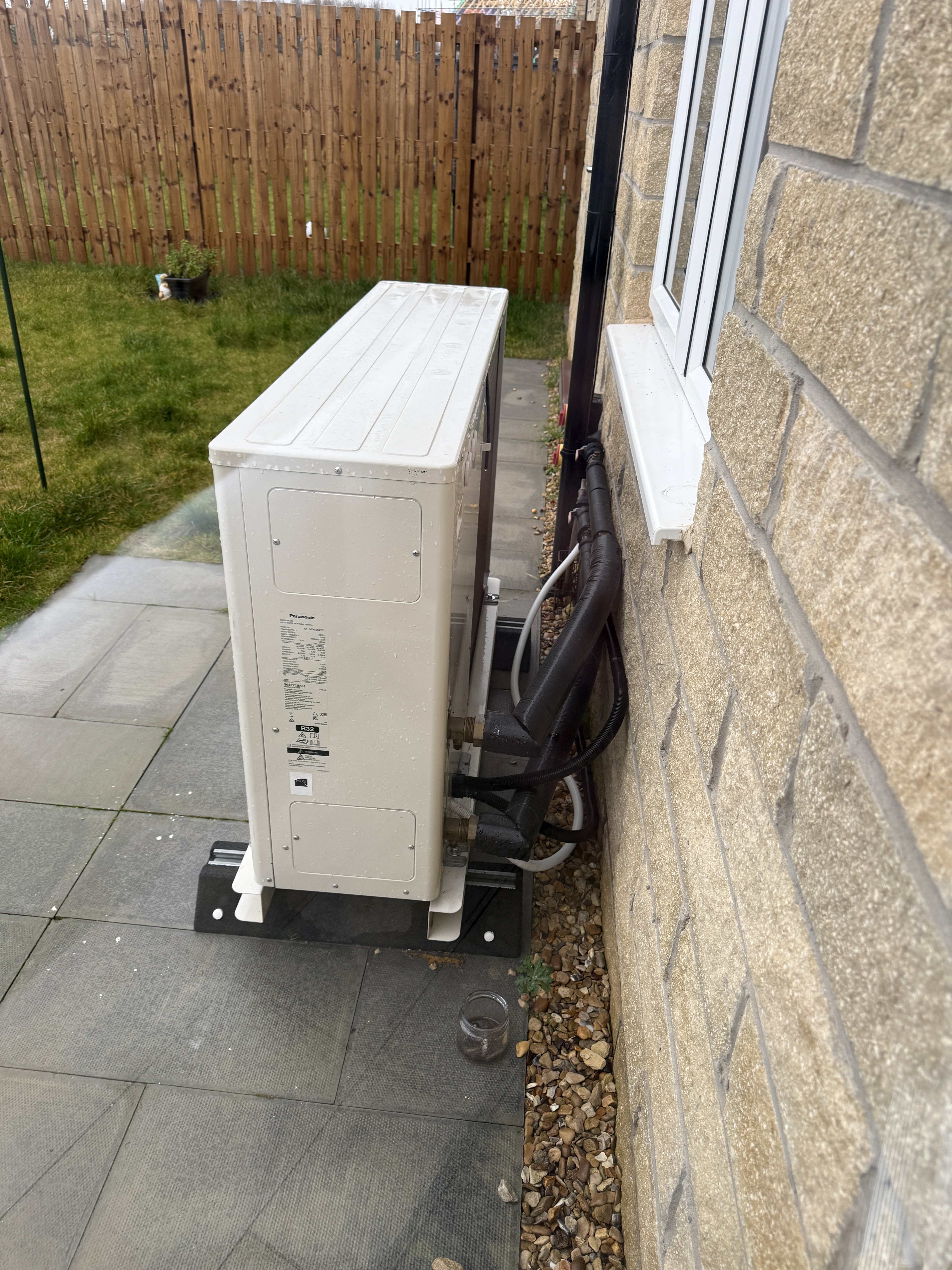

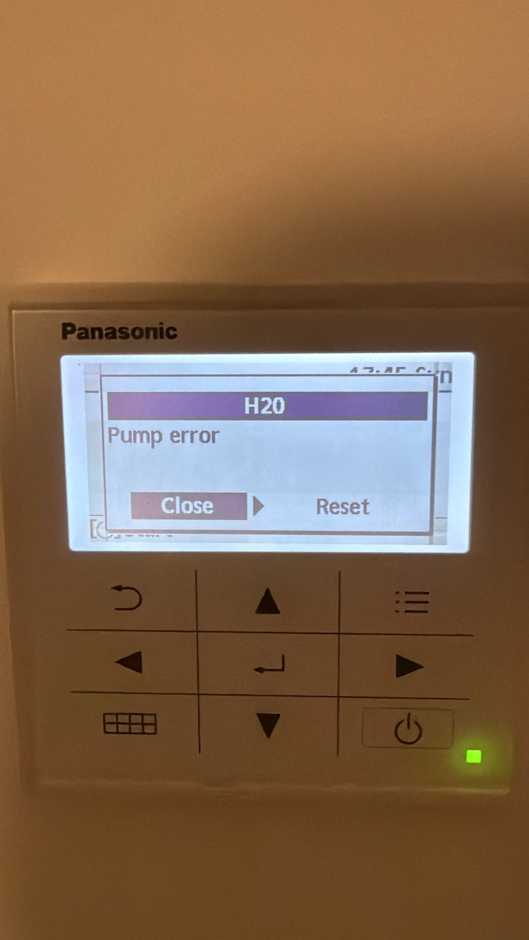

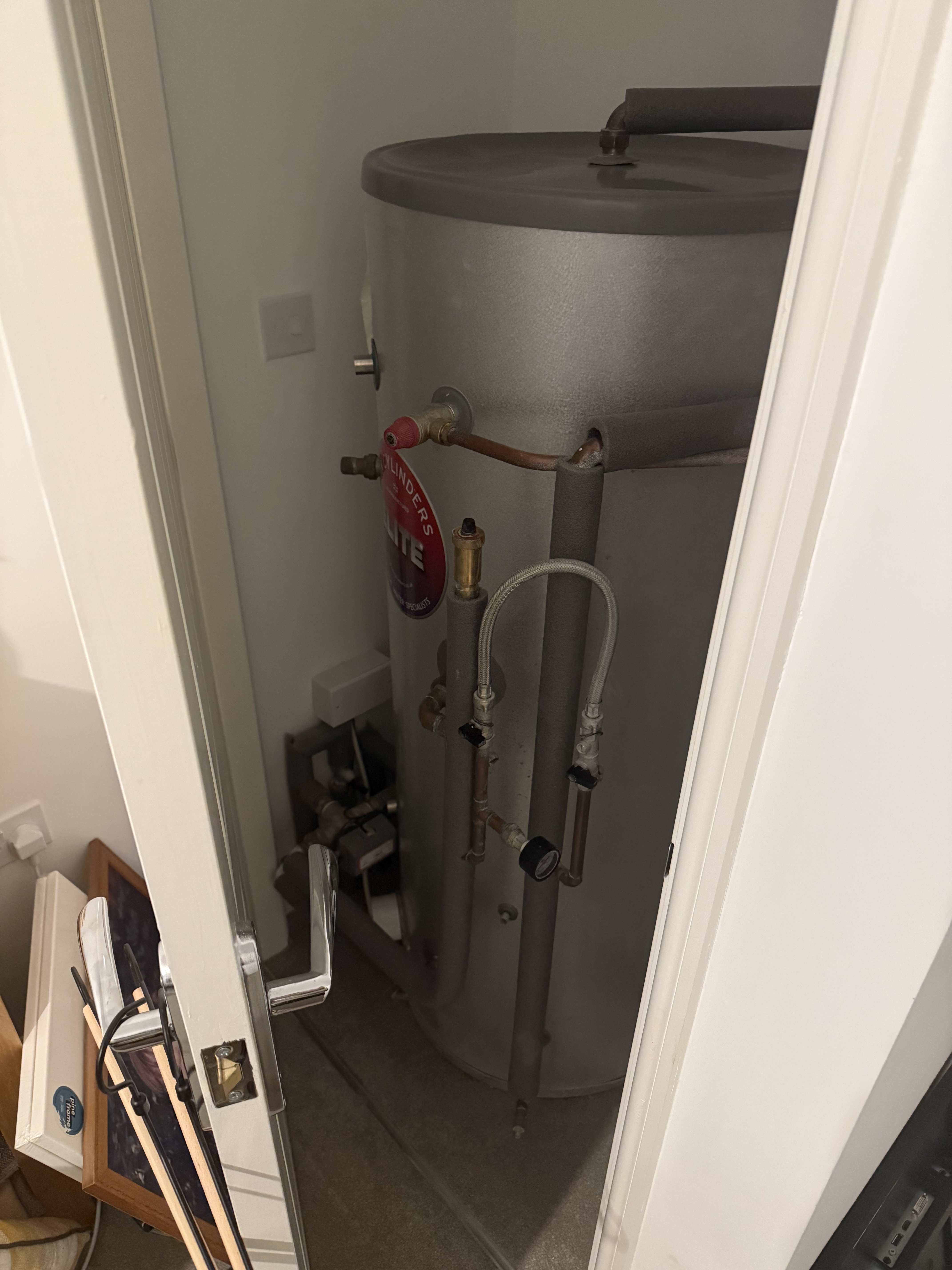

  1. update: plumber came this morning and the little pump inside the outside unit has been replaced and it's now working. unfortunately it was wife that was home to attend and i didn't had the chance to see how to replace and where to buy a new pump in case this happens again

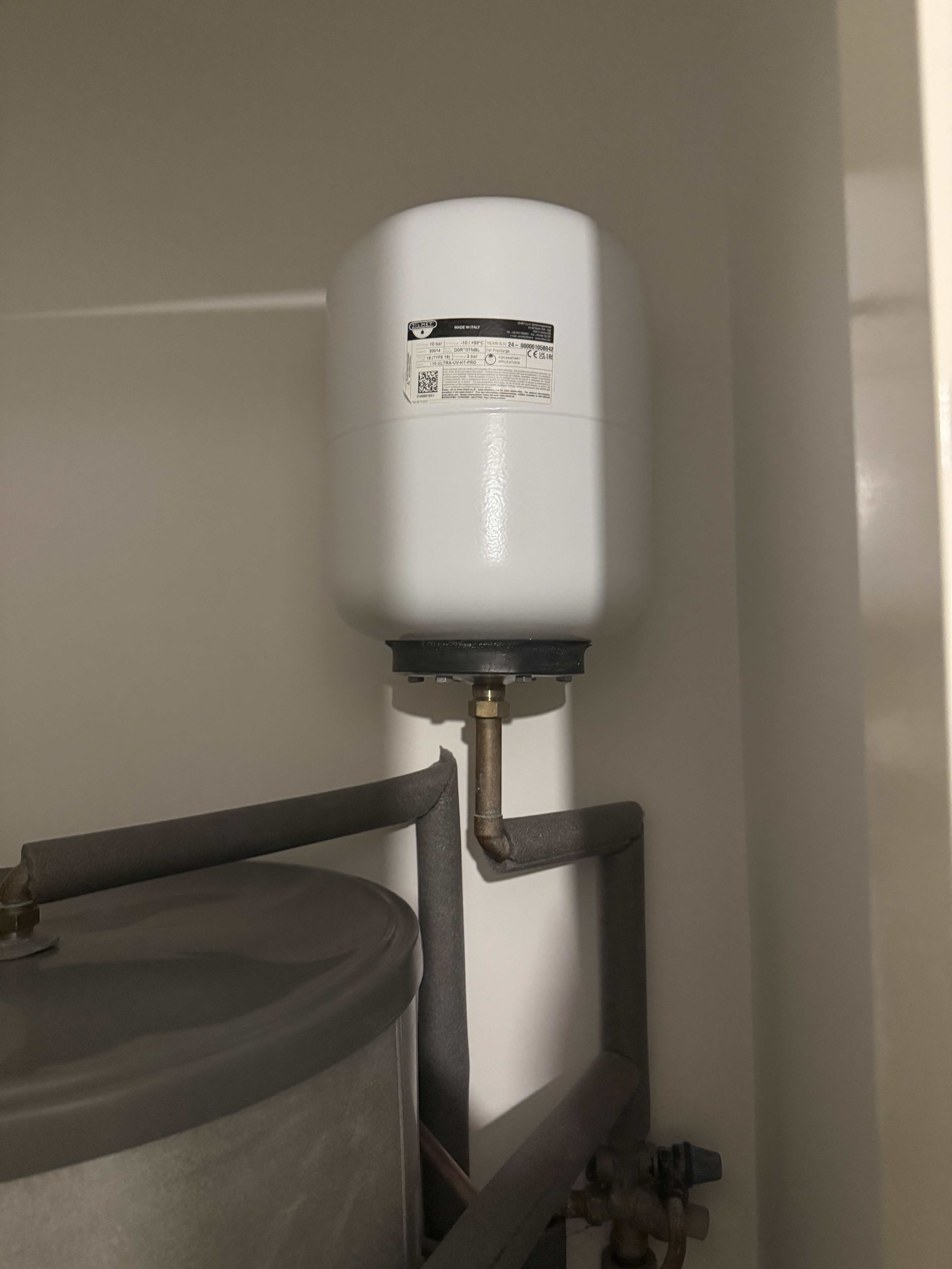

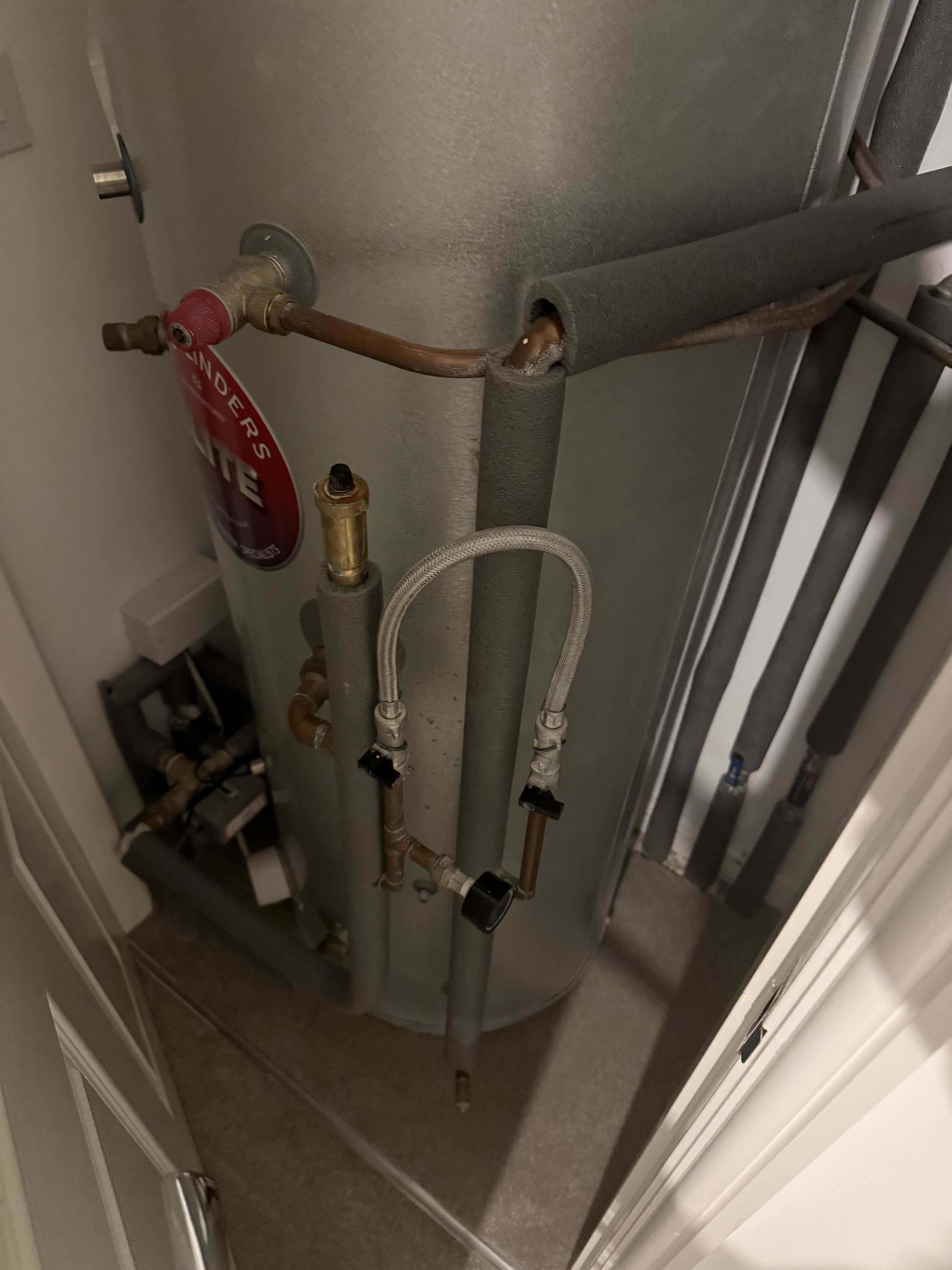

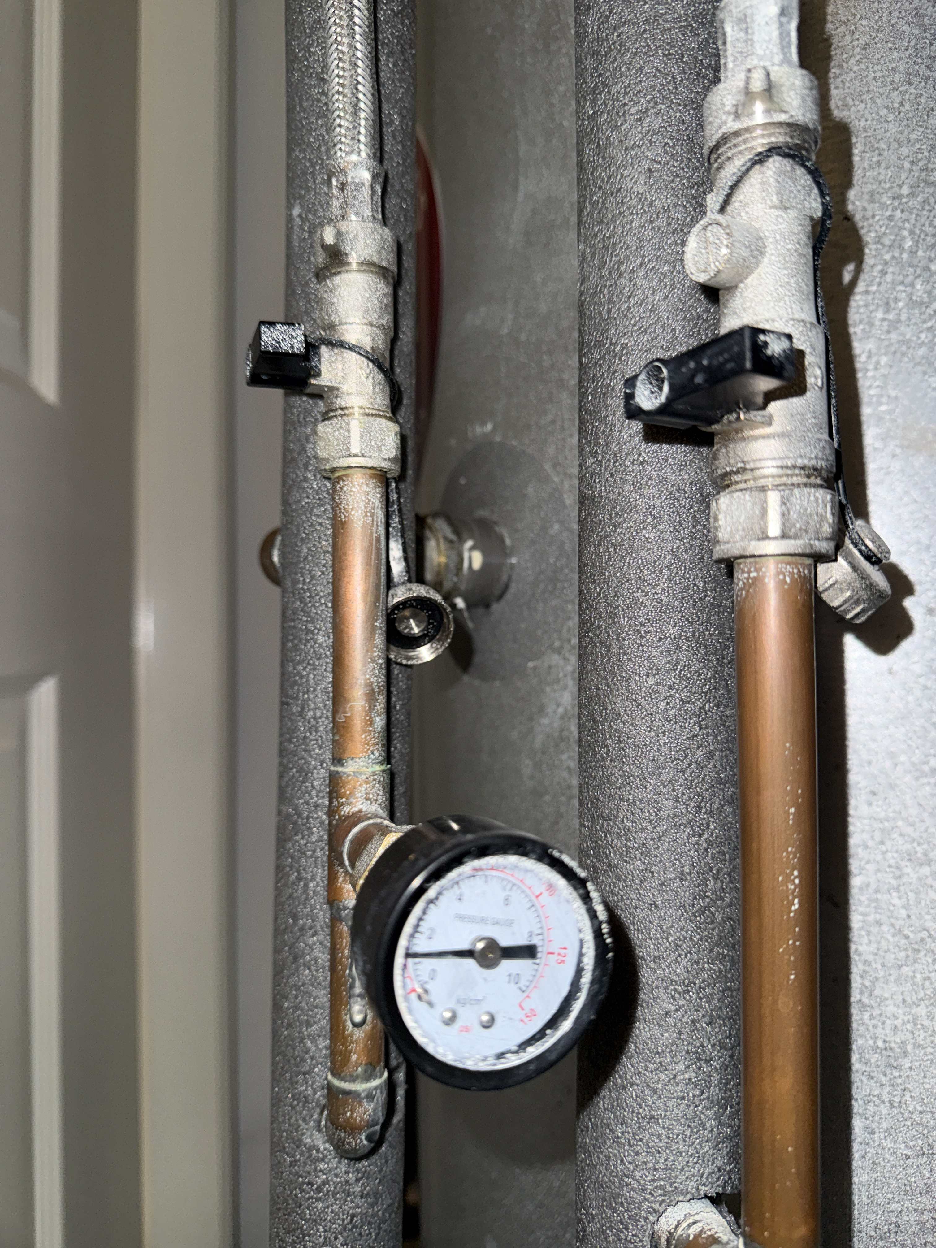

  2. yes, wife did yesterday but I just did it again after you mentioned and upstairs they all hissed and came out water which is good i guess. Downstairs they didn't hiss but water came off. I've done a reset once again but still same error code.
  3. @JohnMo turn both valves and let pressure went up to 1.5 as you can see in pic and reset the system. still showing same error h20.
  4. Both valves? okey dokey, will try tomorrow! Damn, I love this forum. People are so kind and helpful, unfortunately I'm not skilled enough in any of these topics as I would love to help people like this
  5. Thank you for the quick reply, currently working a night shift. Will try tomorrow. Before I left home, i've turned the switch which i think it's the immersion for hot water but radiators were still very cold althought the live usage on octopus app was showing more than 4000w, so I told wife to turn it off since it's not warming up the house. When she turn the switch off, she said something sparked around the switch, so not sure. I am not sure which one I need to turn to top-up water, tomorrow will take a couple pictures. When saying "switch off power to heat pump" do I actually turn it off in the meter box or just turn it off in the thermostat?
  6. I will tomorrow, currently doing a night shift. Thank you for the quick reply!

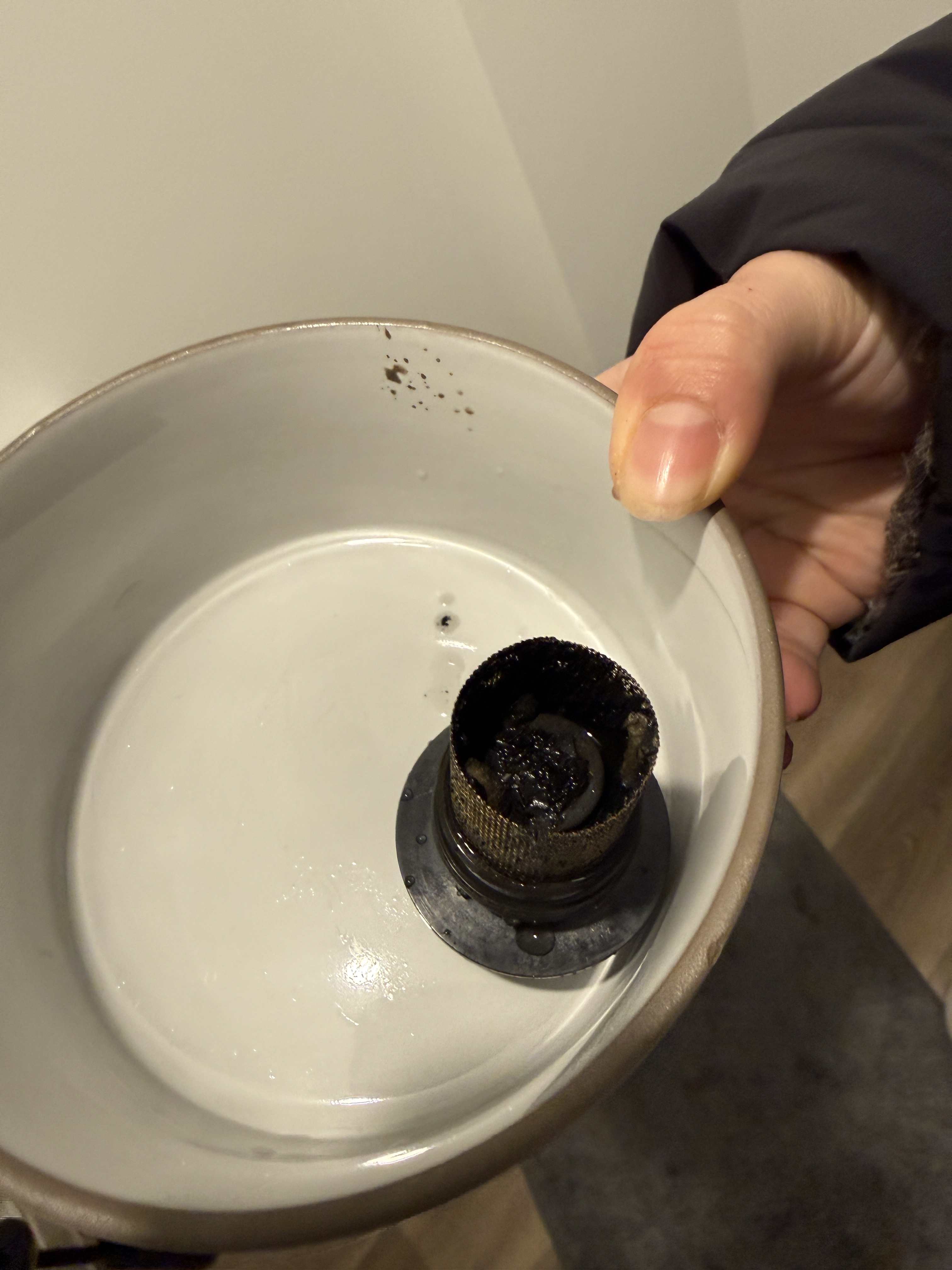

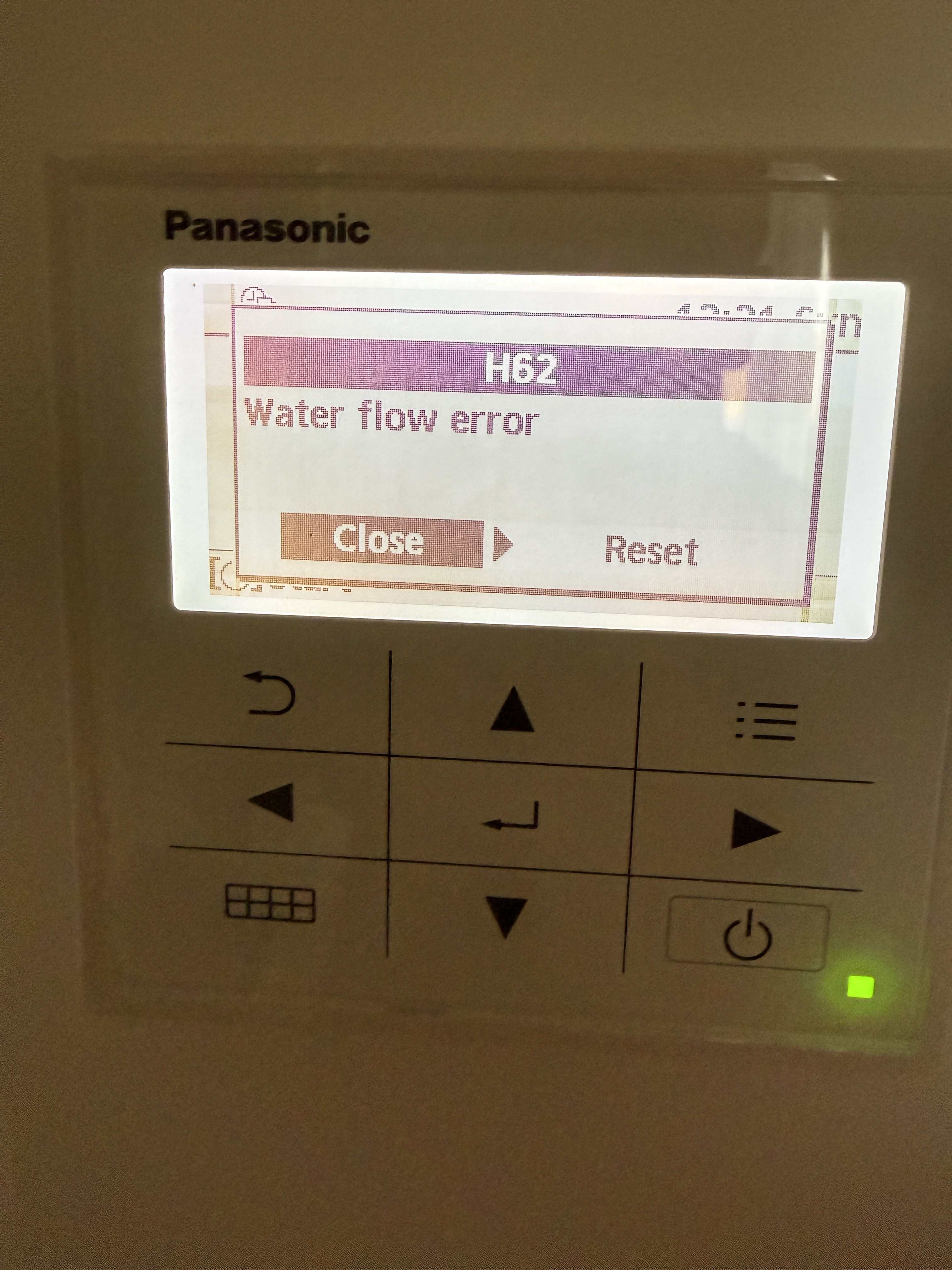

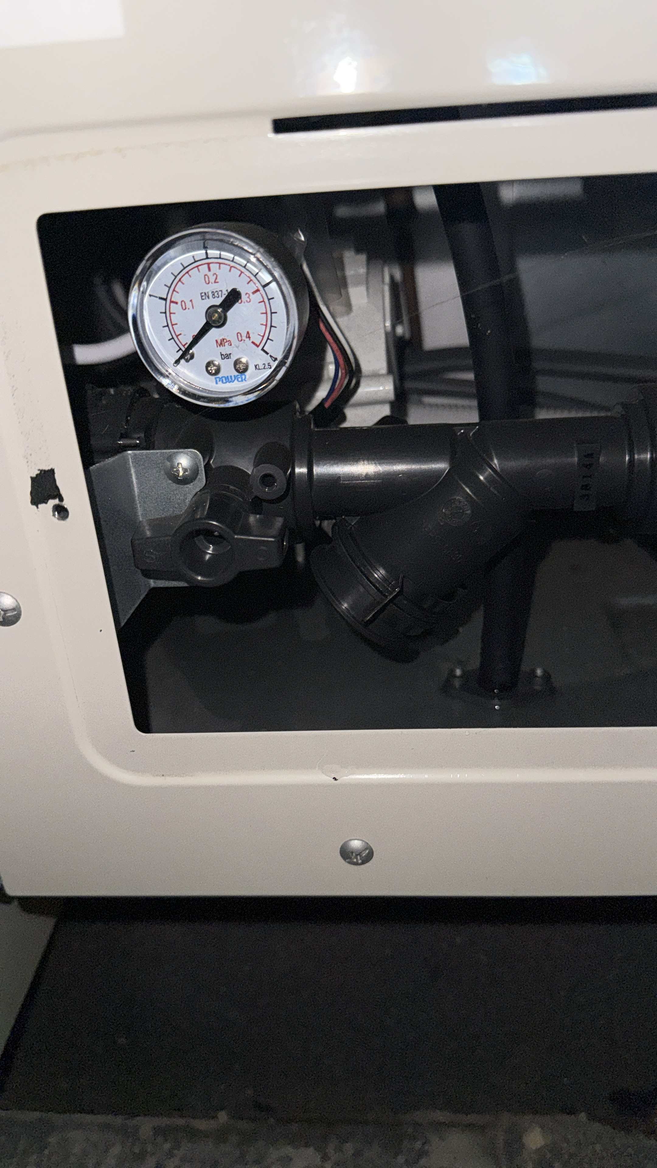

  7. @JohnMo Hi everyone, I completely forgot about this topic as eventually I saw that many people were spending much more money than me, I'm only spending between £100 and £150 in this weather while I see people spending over £200/£300 which is crazy. I have a new issue, this H20 and H62 error came up yesterday and house has been cold and no hot water, I need to shower my son asap. I've cleaned the filter as seen in the picture but still not working. Radiators have been bleeded, some of them no hissing and no water coming off. What else should I do? Please help
