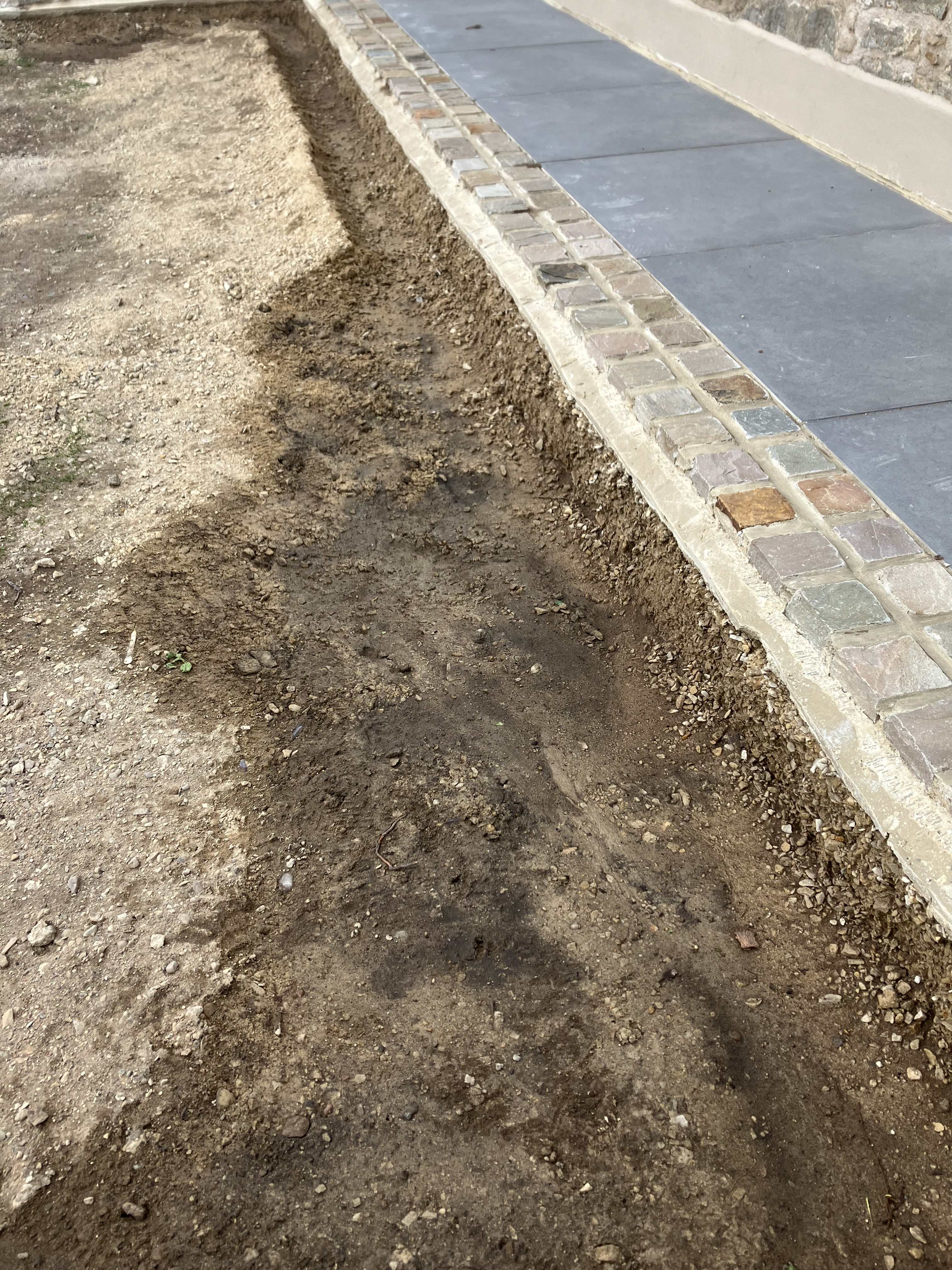

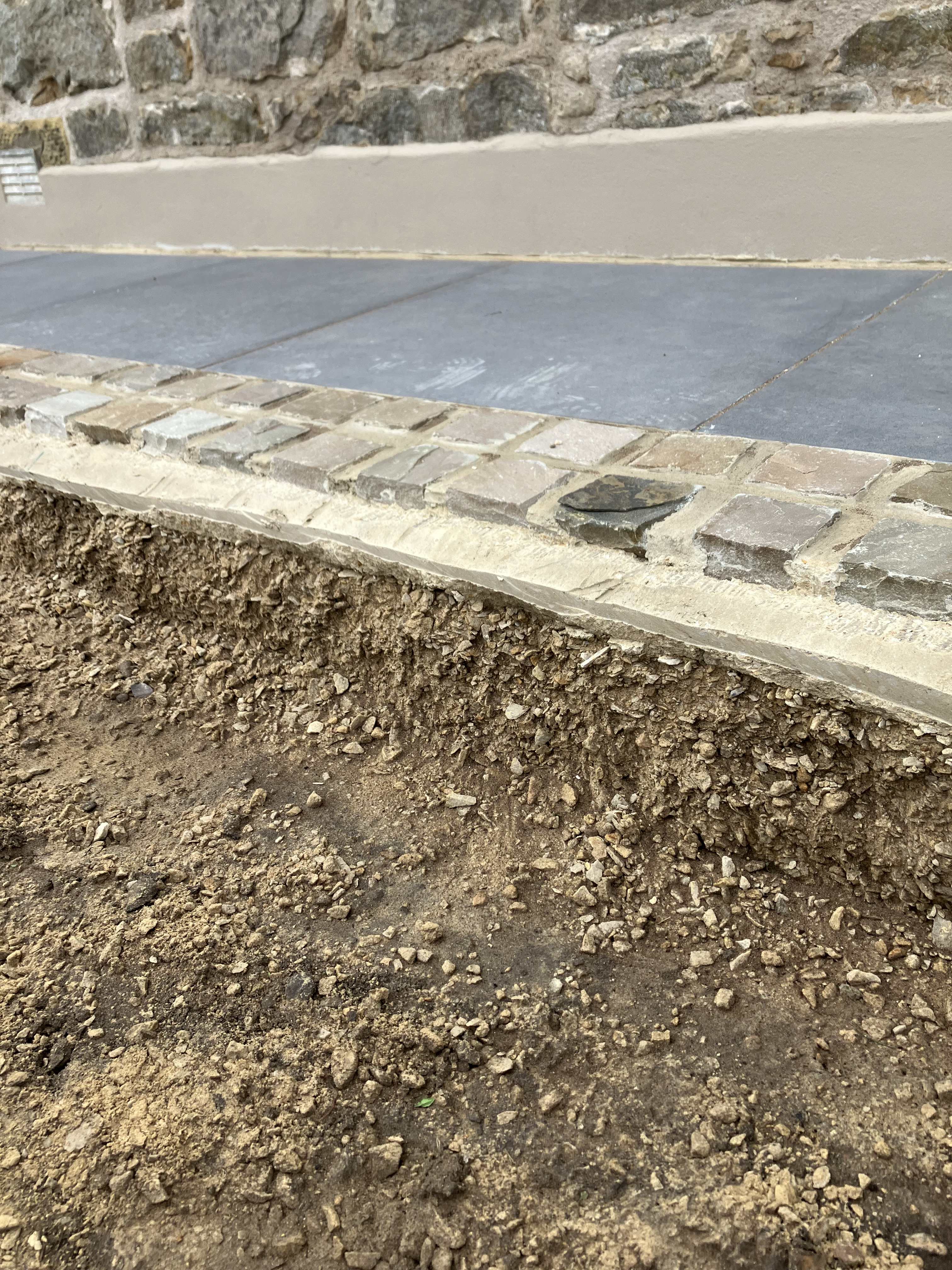

Recent Profile Visitors
Mr Green's Achievements
New Member
