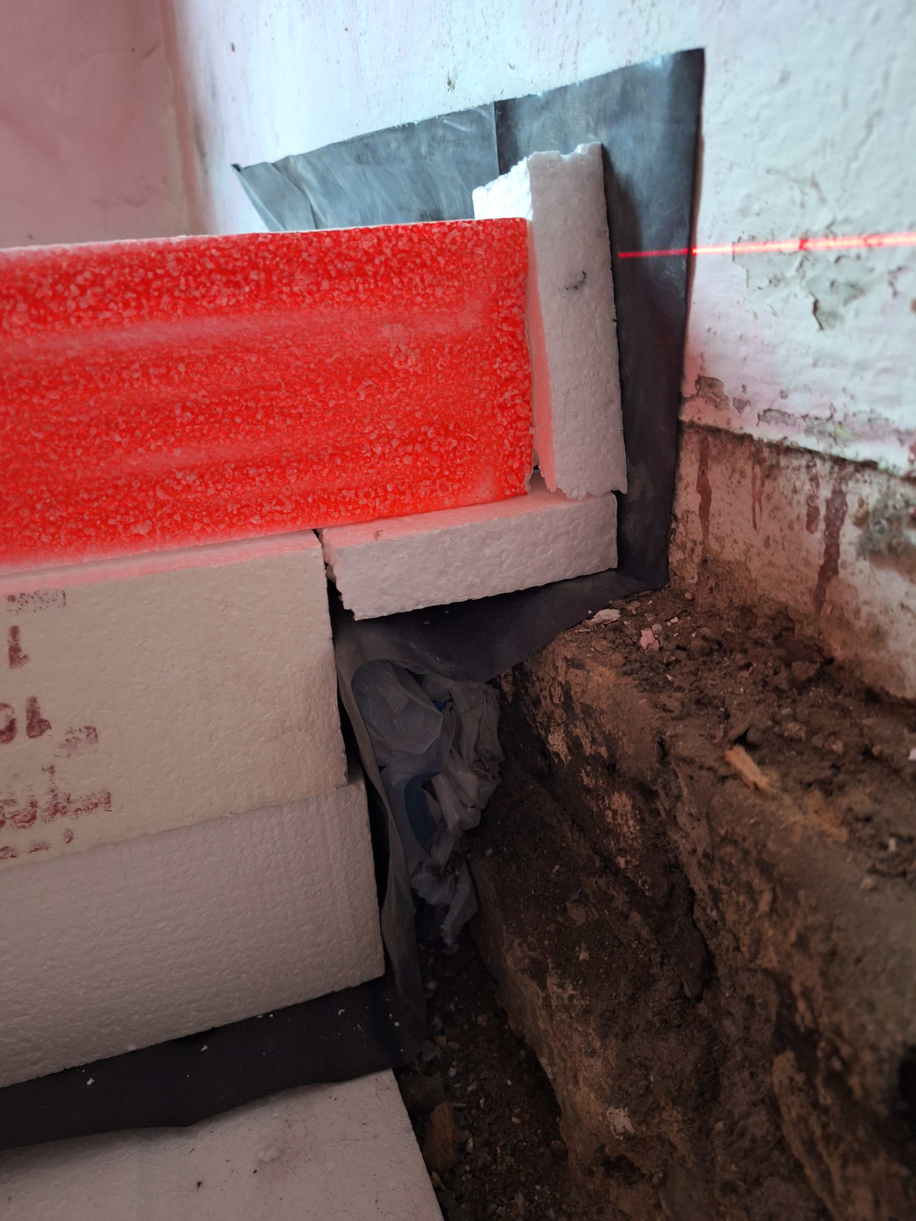

  4. After much deliberation I decided to go with the option of pulling everything out and properly insulating. The house is of two parts, new and old, the old has the wooden beams simply sat in the expanded clay to support the floor boards. Below the expanded clay (approx 300mm) is just a rubble. Here I intend to: -dig out all the expanded clay, -compact the layer of rubble with a whacker plate -50mm sand leveled and compacted with whacker plate -dpm -300mm EPS insulation (there will also be house wiring and plumbing laid into this) -ufh foil and underfloor heating pipes stapled to insulation -100mm cement screed (probably done by hand with a mixer, looking for advice on this cement type and make up) - finished floor, mixture of vinyl and tiles In the new part we are in the process of ripping out the old slab and will be the same idea but since we won't have so much depth here we will do 100mm PIR insulation to keep floor levels equal. Looking for advice if this is ok. Do I need another layer of concrete at the bottom? Or a thicker concrete layer or reinforcement or something? I'm worried over time the concrete layer will settle and crack and possible damage and break the underfloor heating pipes so not sure if I need a stronger layer on the bottom or a top screed over the concrete or something. Any advice would be greatly appreciated Thanks in advance

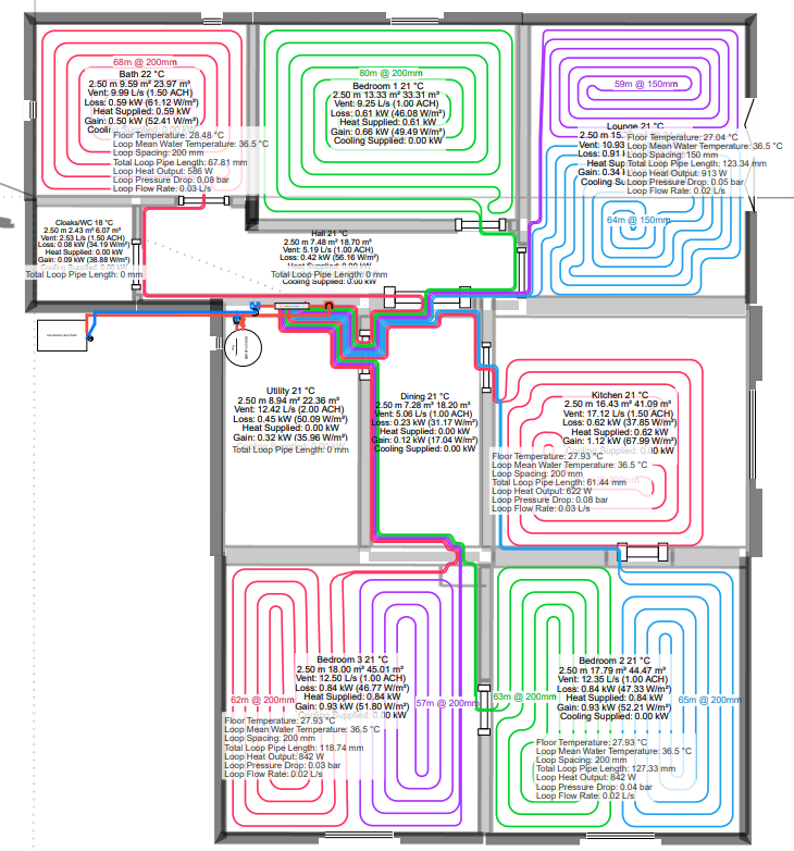

  15. Thanks very much for the help. I'll run some more numbers and scenarios using heatpunk and h2x to figure out the best spacing as you suggest
  16. Thanks for all the advice so far, it's been really helpful. Whist I tried to sell the merits of fan coils to my wife we are still pretty committed to underfloor heating. After going over all floor and ceiling levels again yesterday I figured I could manage 100mm of insulation throughout all of the older part of the house and half of the newer part (maybe even 200mm in bathroom) leaving me only two rooms (living and bedroom making up approx 28m2 together) where I can only manage 50mm insulation. Would it make sense to do this and maybe do 100mm centres in the rooms with 50mm insulation and 150mm everywhere else. Coupling the slab does seem like a good option as well but thinking with 100mm of insulation through 80% of the house this might be a more economical option.

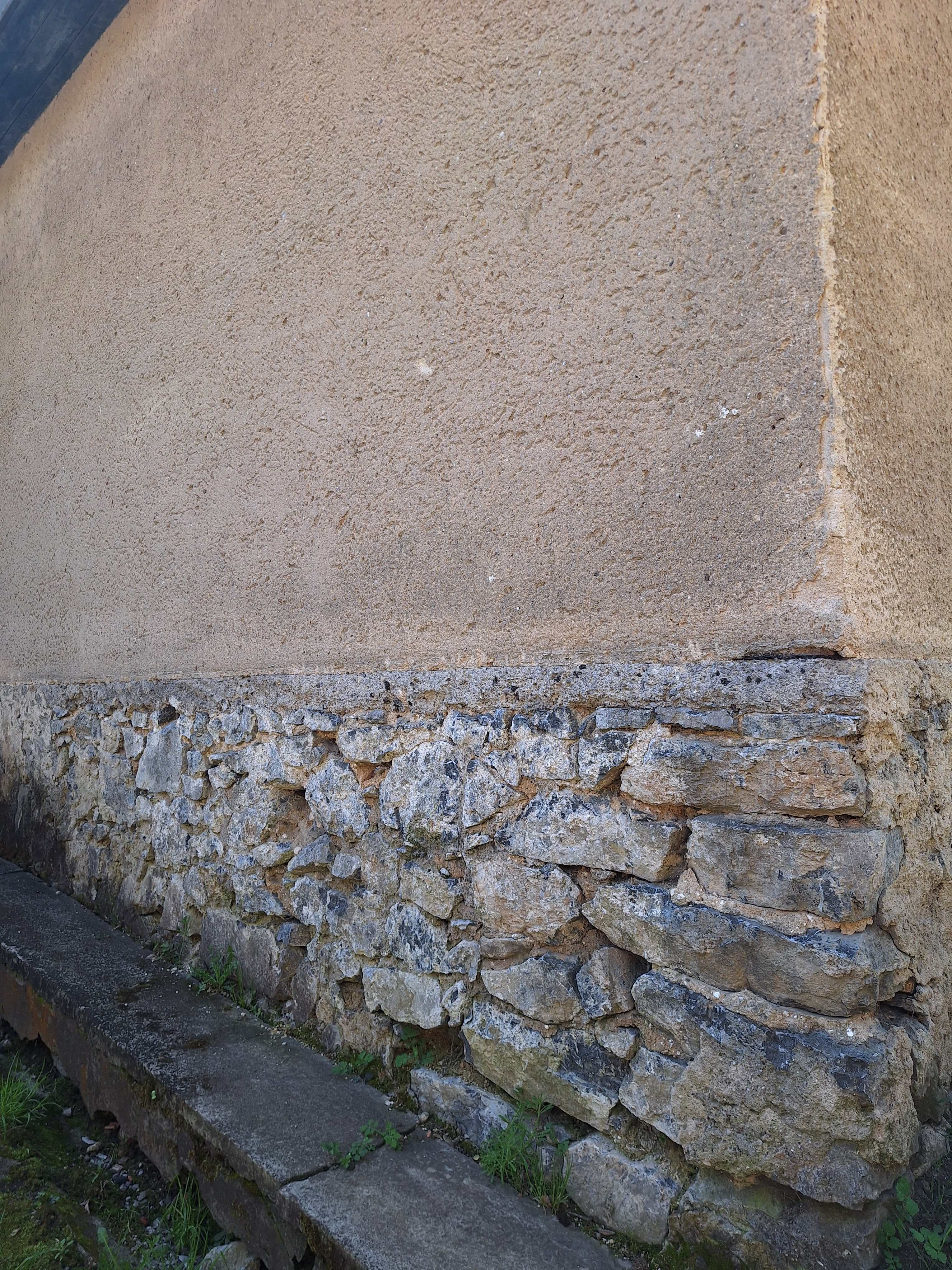

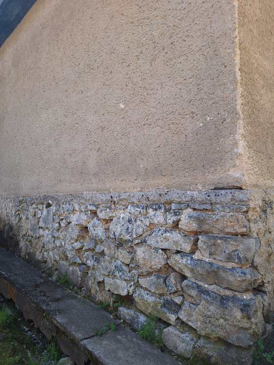

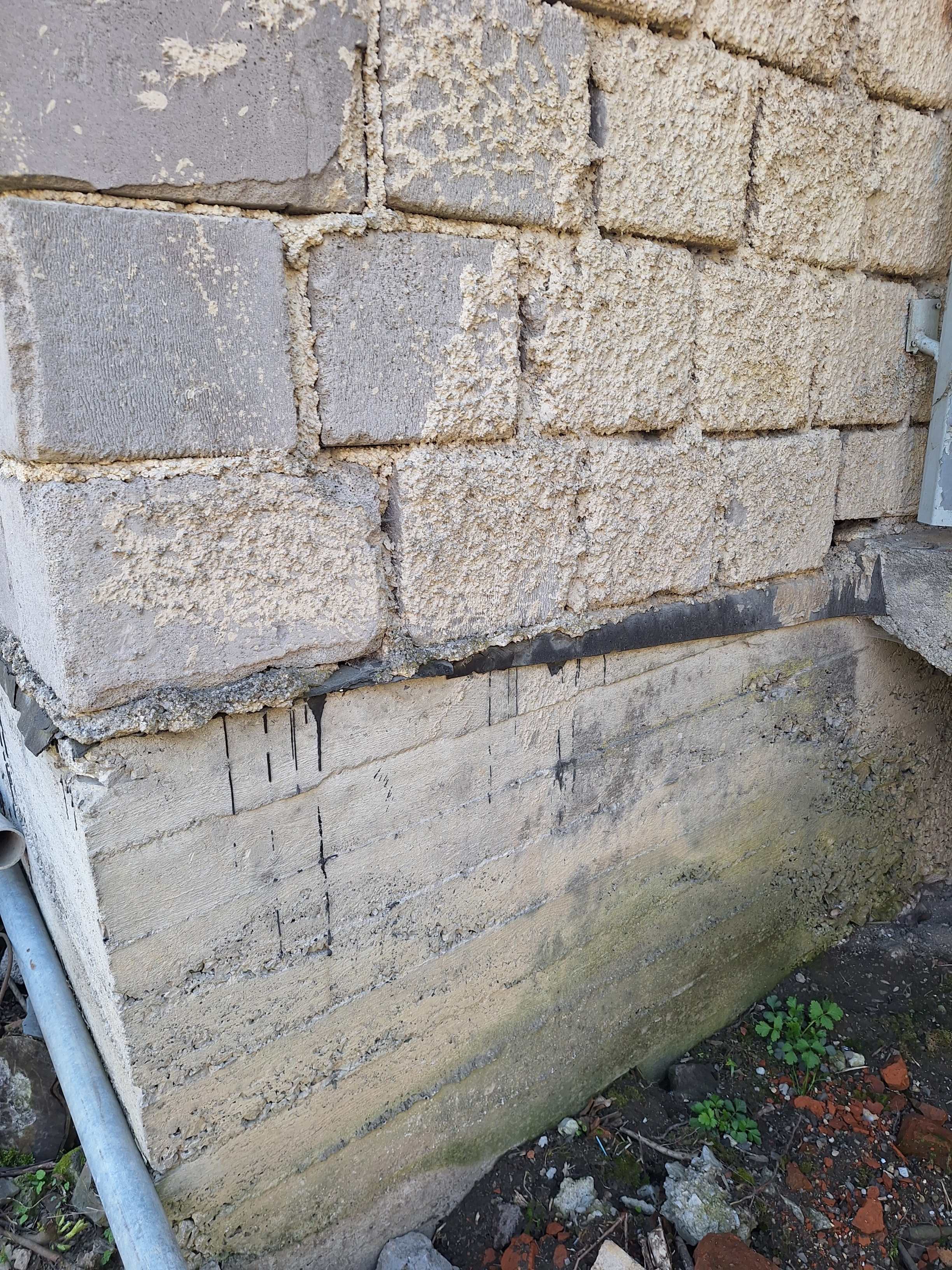

  20. Yeah for sure I could do that. I have just been looking again at the house with this in mind and took done photos. Hopefully it's clear in photos but from what I can tell the older part has approx 1m above ground (to nothing at the back of the house) of stone foundation then a 100mm slab followed by the dpc and walls. The newer part is also about a meter of concrete slab (to nothing at back again) exposed above ground followed by dpc and walls. So if I insulate these well (and dig down at the back to insulate below ground as you suggest) do you think it's feasible to do this one without huge running costs?

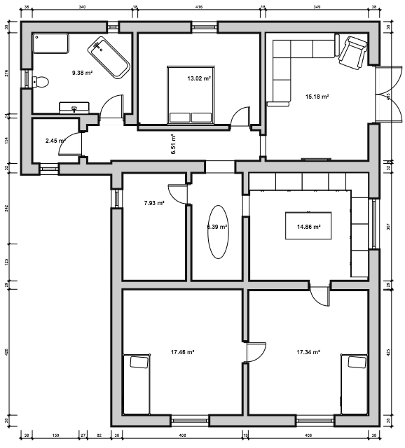

  24. Hello all Im about to embark on a full renovation of an old house were buying and im planning to do underfloor heating throughout alongside a heat pump. since budget is very tight I will do pretty much everything by myself( im a joiner/carpenter and have some basic experince in thing like plumbing, electrics, plastering, tiling etc.). I have been researching as much as I can and think I have come up with a plan for the underfloor heating but hoping I can get some feedback/critic/advise etc. from some of you who have more experience. The house: the house is an old house in Slovakia which has an original part constructed of thick solid block construction and a pitched roof. It then has a second half which was started as a newer extension but never finished, this is made of thick aerated block and a slab roof. Currently uninsulated but will be getting 200mm of wool exterior insulation and plaster all around as well as insulation in the ceilings. area: approx 120m2 Heat loss: I have done my heat loss calculations as best as I can but as its an old building I have had to make some assumptions. Im also basing it on a design temperature of -10 as those temperatures are not too uncommon, certainly through the night here. I have used heat punk and calculated a heat loss of approx 5600w at -10 after I complete insulation and window changes etc. underfloor heating: lifting the slab is not really possible and so to reduce height build up im planning 50mm of PIR board (i know more is recommended but I hope this will be sufficient, if my calculations are good then this should give me a u value of 0.23) followed by a membrane, 16mm underfloor heating pipe stapled to insulation, then a 50mm anhydrite screed. I want to run everything completely open loop. So using H2x I have designed the room with the most heat loss (lounge) with 2 circuits of 150mm centres. When I reduce the flow temperature to the minimum to meet the heat demand for that room (39 flow, 34 return) I can still meet the demand of all other rooms with 200mm centres. Am I right in thinking this is the best thing to do? other rooms: In the plan bellow there is no heating in the hallway, dining room and utility room but my plan is to weave the flow and returns to all the others room to fill these areas as they are only small interior areas so this will save on loops and complexity. Iv attached my plan below as well as a basic floor plan. I would love to get some feedback on this from the community and appreciate any help/advise.
