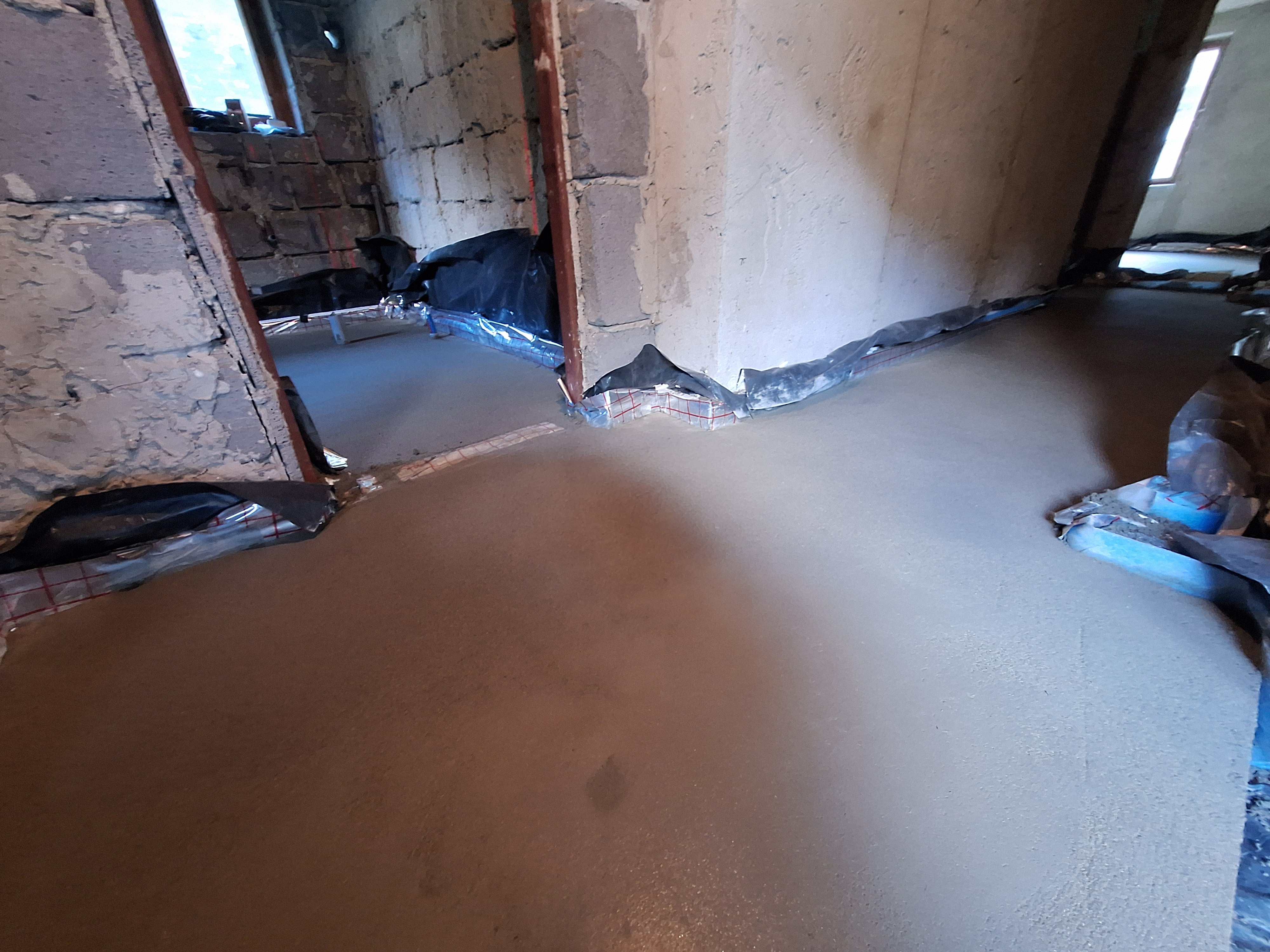

  1. It's done!! Just wanted to say a big thank you to everyone with the advice on this one. After the advice I changed plans and in the end got a sand cement screed laid by a professional company who did an amazing job and finish. Time to move on to the next stage (I'm sure I will gleaming you wisdom again) Thanks again, few pictures before

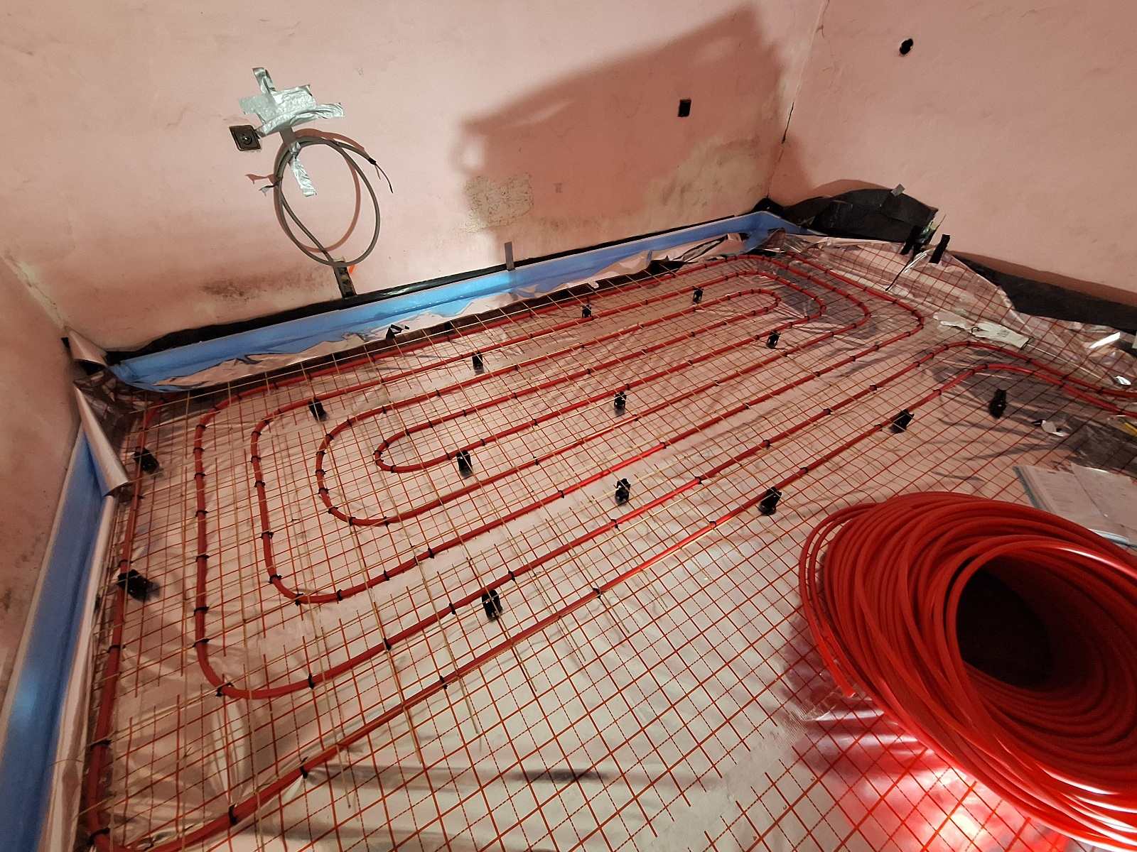

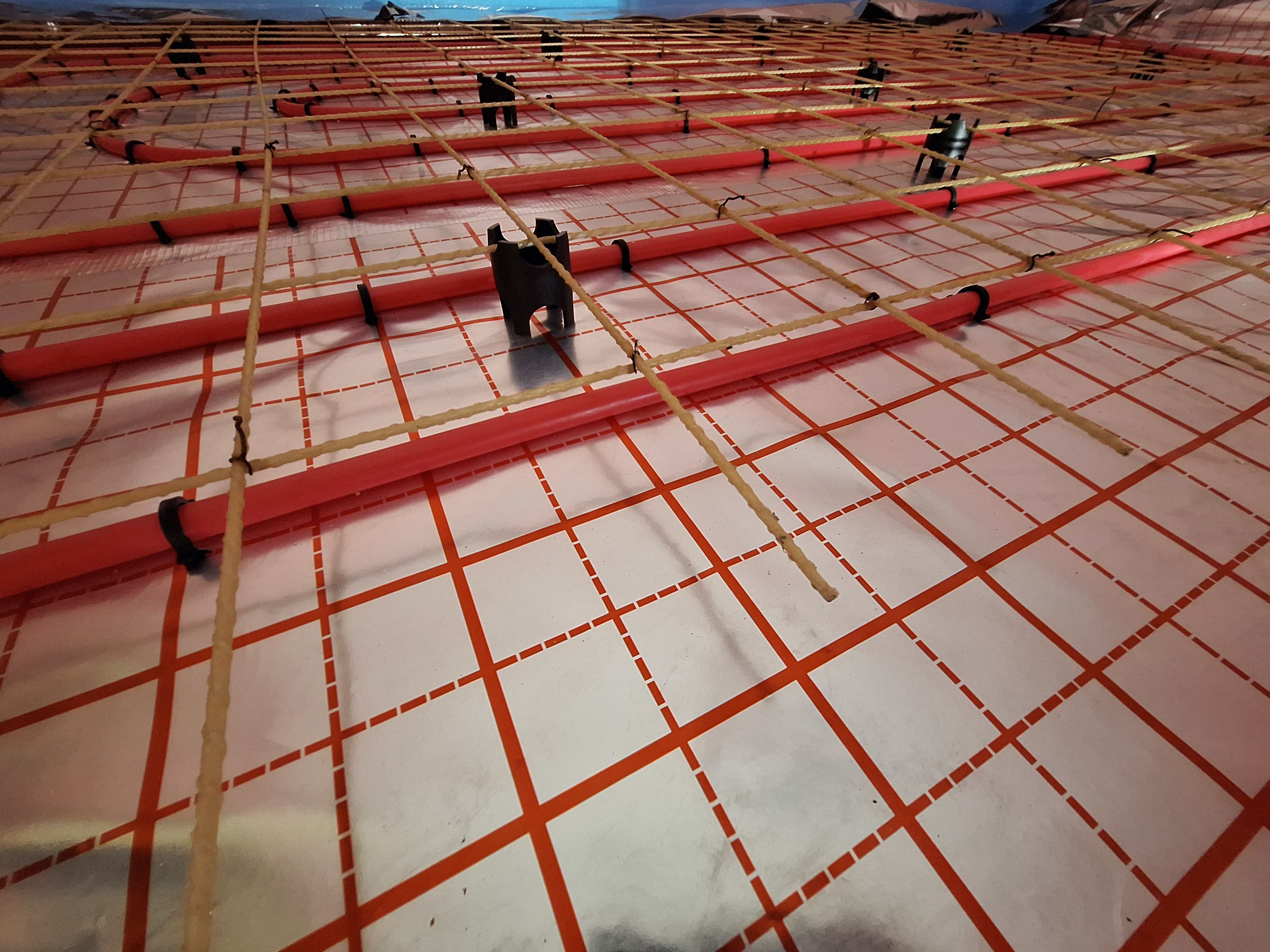

  3. Things are progressing and we have some professionals lined up for the concrete (professionals doing a side job for a friend with me and our mutual friend helping). Quick question on the rebar chairs. I have one room almost ready but found the rebar might be an issue. It's 4mm composite on 50mm chairs. However the chairs I got will just pierce the foil and insulation if you step on or close to them. Stepping between is fine as the composite rebar is very flexible so just bends but this might be an issue when they are laying the concrete. It's not easy stuff to walk on. Do you think the rebar chairs with the wide circular buttons would fix the issue or does someone have any tricks for this. Also my concrete guy is quite worried about the the rebar floating but I think tie wrapping it to the chairs and then to the underfloor heating pipes will be fine? Floor build up is: Sand blind 30mm EPS Dpm Insulation (200mm EPS in part of the house, 100mm PIR in the rest) Under floor heating foil 100mm concrete (And round the edges 30mm EPS and foam expansion skirt between Dpm and underfloor heating foil)

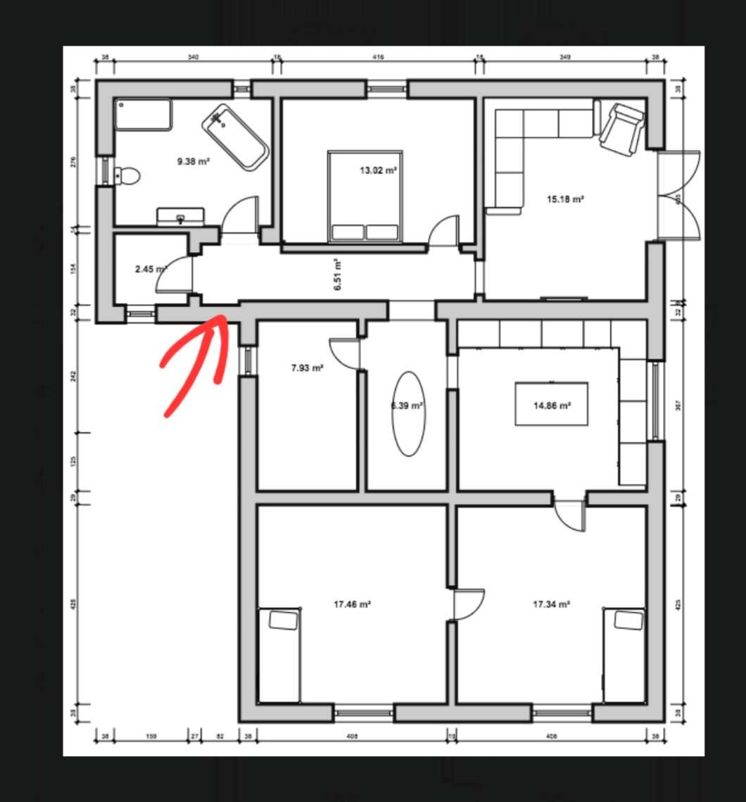

  5. After the advice of pretty much everyone, for once I am going to admit defeat and have some professionals in for this job. We have found a couple of options we are happy with and will readjust the budget a little to accommodate but its not something we can afford to go wrong. I will take some pictures and update you in a couple of weeks when it's done but thank you so for your advice and help and I now know what to watch for when it's poured and what to prepare

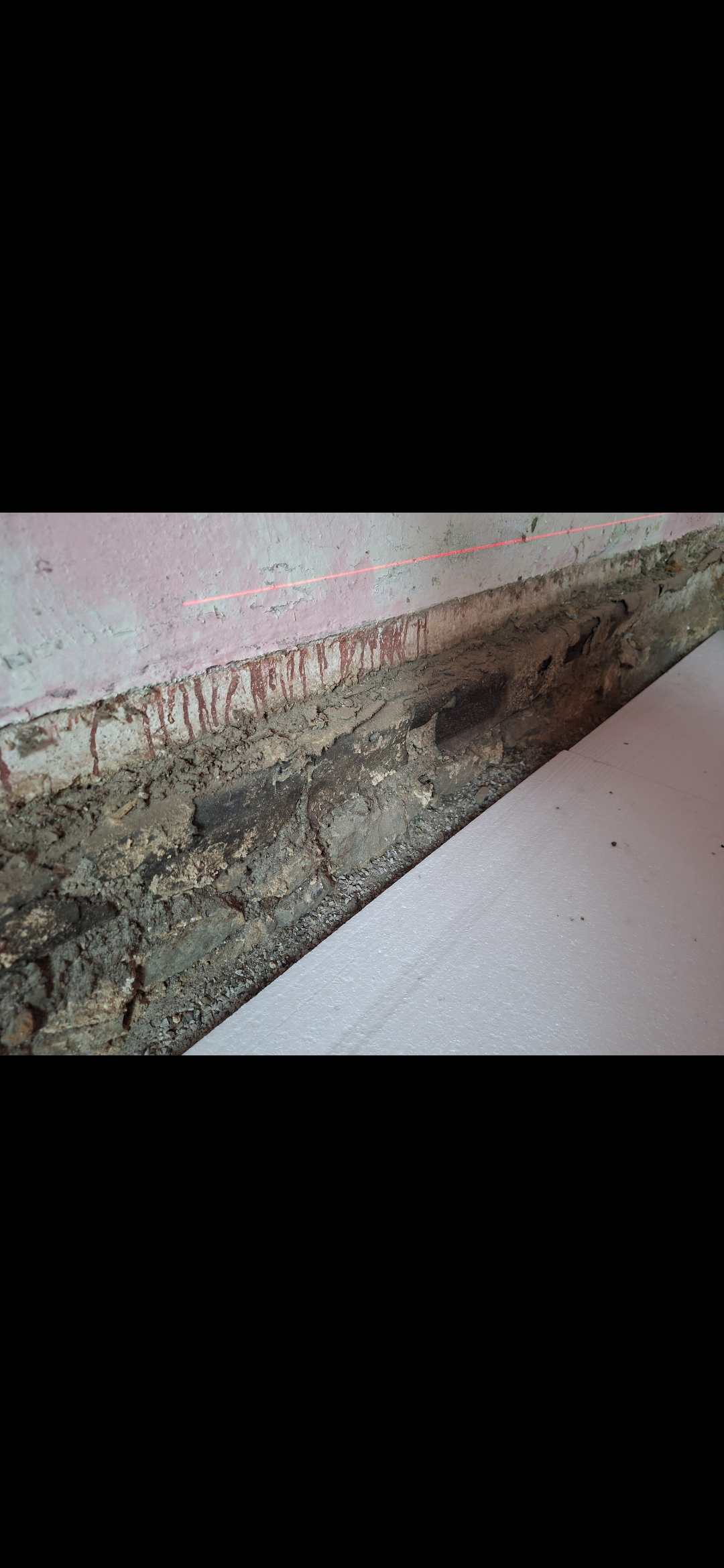

  13. Just to protect the DPM
  14. From what I understood the underfloor heating foil does this job? But I will look more into this thanks. And yeah the walls have an old dpc (the hard tar like one, forgot the name of it right now?) it's old but doesn't seem to be letting any damp up through the walls and it has been empty and in heated for quite a few years. You can just about make it out in the picture below
