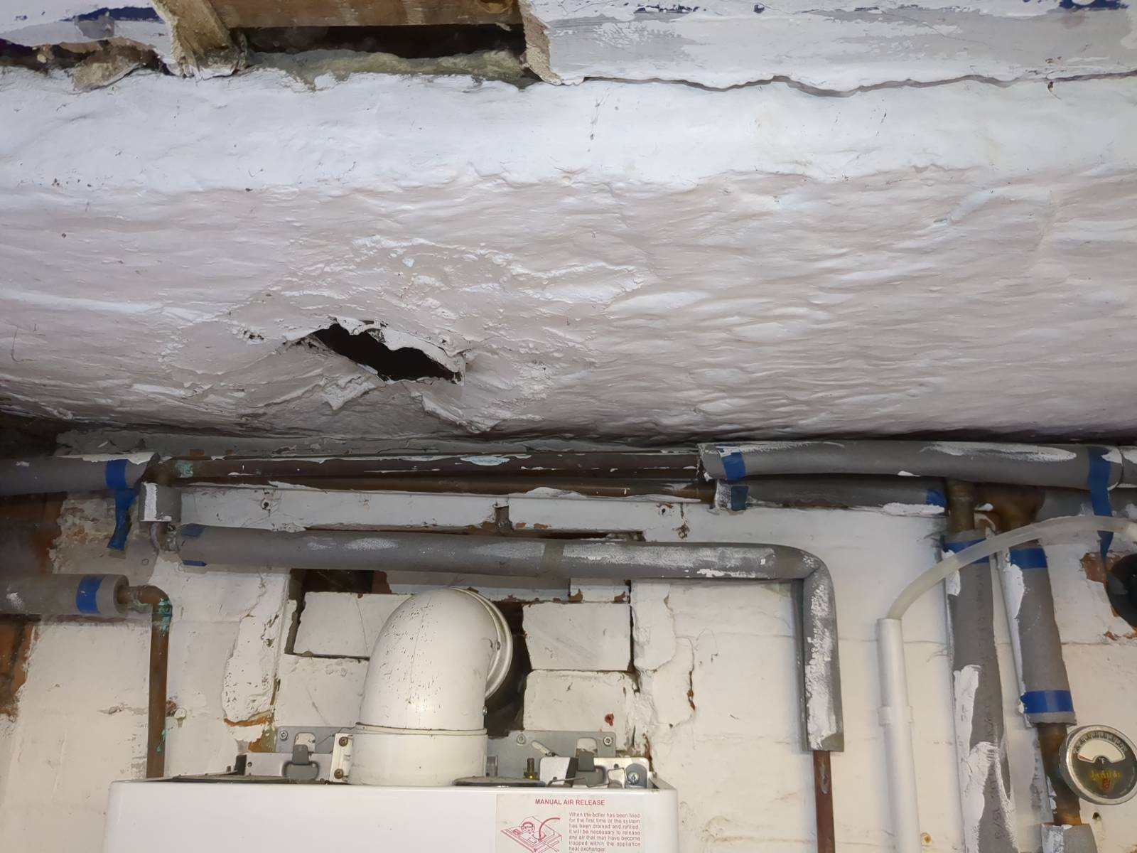

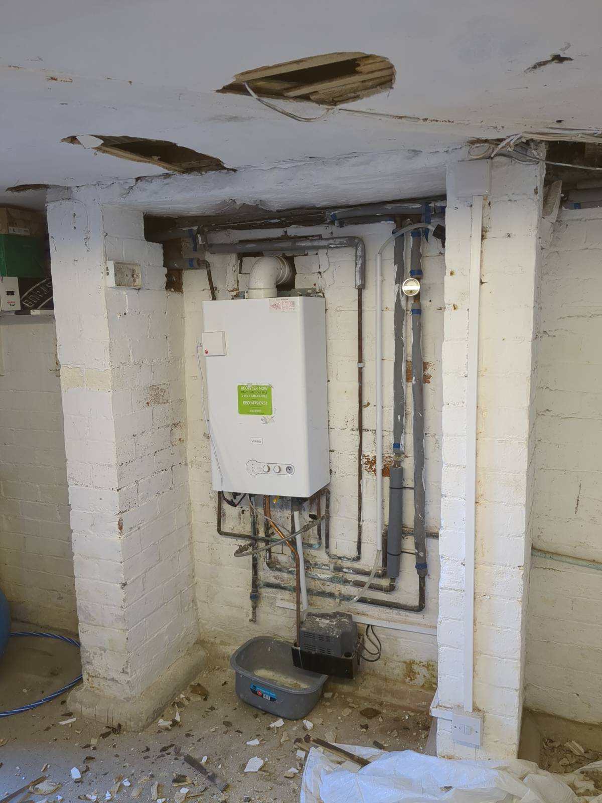

Recent Profile Visitors

  2. Thank you for the various welcomes and questions. To get back to them. So yes, I intend to improve the air tightness of my property. It being a retrofit (and to a 1930s house as well) clearly I won't be able to go full PassivHaus; but I'd like to aim towards for one of the retrofit standards (e.g. EnerPHit or AECB). I plan to hire a consultant to advise on some of this (e.g. someone like https://www.21degrees.com/). I must admit I was also quite taken by The Case for MVHR report by the PassivHaus Trust which suggested that MVHR is still useful even if you don't get all the way with air tightness.... As above, yes plan to look at more general insulation as well as air tightness. Ah ok, this is a good point. I must admit I wasn't thinking about the intake and exhaust terminals being via the chimneys. I have a large half submerged (i.e. it has windows and light, but half is below ground level) basement - that's where the boiler in photo above currently is. I plan to put the actual MVHR unit in the basement and my very initial thought was that the intake and exhaust would be at ground level - but I'd want to get professional advice on that. I have three chimney stacks - two on the East wall and one on the West. Two of the stacks have been completely covered over - i.e. you wouldn't know they were there apart from an air vent (and stack outline as part of the wall) - that's the situation of the stack directly above the boiler currently. One of the stacks (South-East) has one of the original fireplaces at ground level with a (non-working) gas fire - very long term I'm thinking maybe a wood burning stove - with fully independent air supply and completely sealed for MVHR purposes - but that's mostly as the fireplace is genuinely too lovely to scrap. Either that - or more likely when I run out of money - just put a nice bunch of flowers in there..... But anyway to get back to the point, I see the stacks as more for simply running ducting through as opposed to intake / exhaust. Just kind of makes sense seen as I have large void spaces running through the house to put some of the ducting through there as opposed to punching new holes places there weren't previously holes. But posting here in case just in case I'm being stupid about something. Very obviously better to think about where to place the boiler now as opposed to later.... NB - Seen as you might ask, currently the basement is outside of the thermal envelope (though honestly using the term thermal envelope on any part of this house currently is something of a joke) - but which I mean it was deliberately intended to have lots of ventilation holes etc. The plan would be to include the basement in the thermal envelope if I do go the MVHR route - though again will take advise when I get nearer that.
