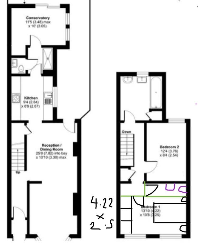

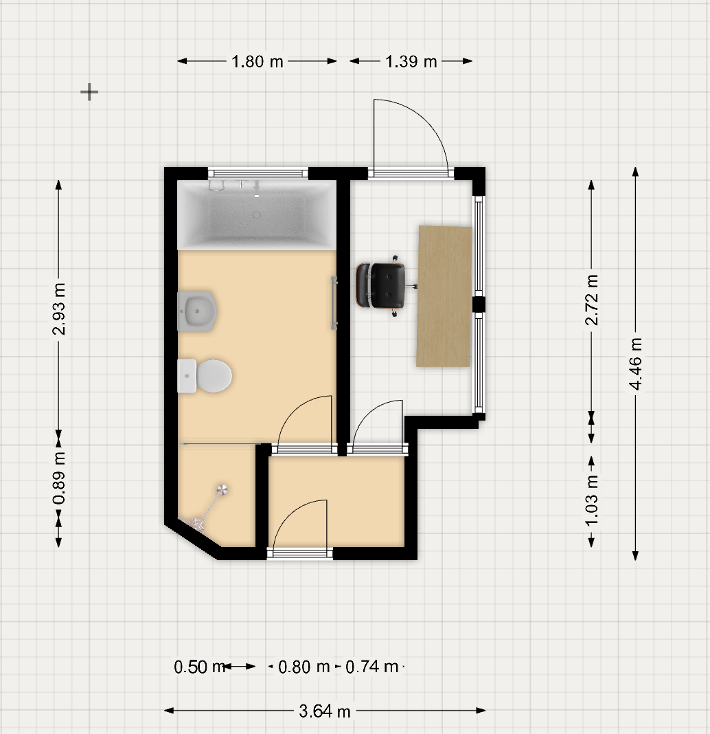

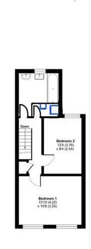

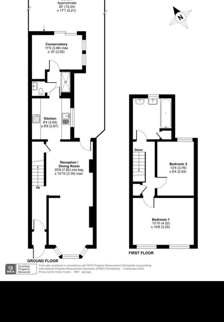

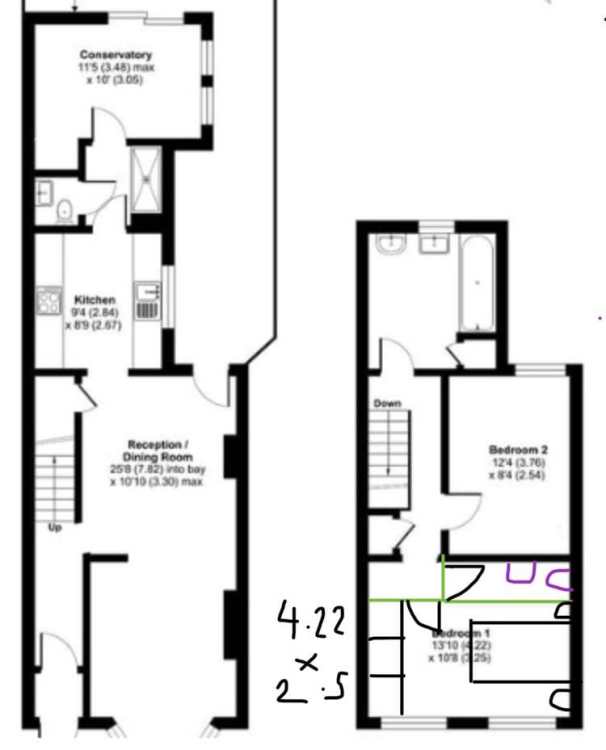

  1. We have a two bed Victorian terrace which has a large upstairs bathroom. We need to make this a three bed for our growing young family. We plan to move the main bathroom downstairs into the space there which is currently an extension room off the back of the kitchen. We think we should try to retain an upstairs toilet as has been advised helps protect the desirability of the house incase we sell in the future. Can you advise, is keeping an upstairs toilet really worth it? If we do, would you advise adding it into a cupboard area in the smallest bedroom with access off the landing OR add it into a space taken from the master bedroom? I’ve added floorplans for options. We are end of terrace so can have soil pipe around the building joining up to the old soil pipe. Many thanks current floorplan/ end of terrace on right hand side: option for toilet in smallest bedroom space: Plan for toilet in master bedroom space: plan for downstairs:
  2. We have a two bed Victorian terrace which has a large upstairs bathroom. We need to make this a three bed for our growing young family. We plan to move the main bathroom downstairs into the space there which is currently an extension room off the back of the kitchen. We think we should try to retain an upstairs toilet as has been advised helps protect the desirability of the house incase we sell in the future. Can you advise, is keeping an upstairs toilet really worth it? If we do, would you advise adding it into a cupboard area in the smallest bedroom with access off the landing OR add it into a space taken from the master bedroom? I’ve added floorplans for options. We are end of terrace so can have soil pipe around the building joining up to the old soil pipe. Many thanks current floorplan/ end of terrace on right hand side: option for toilet in smallest bedroom space: plan for downstairs: Plan for toilet in master bedroom space:
