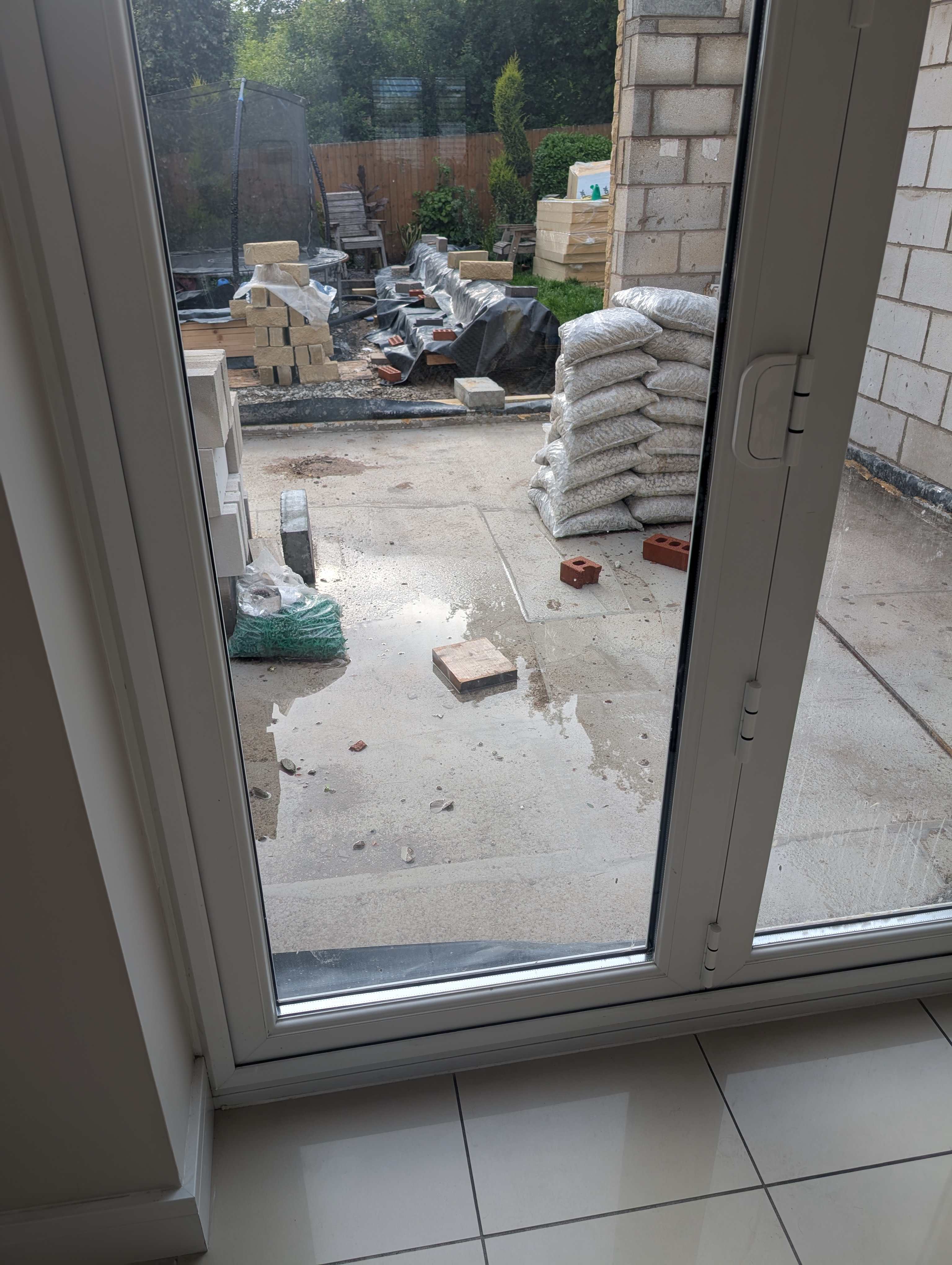

Latest update, it looks like I'm going to install a wet system laid directly onto the existing slab (and built up slab in the "new" floor space) by milling the channels for the pipe, then lay a wet screed over , and LVT on top. After careful consideration, this gives me the best option to maintain the current external door thresholds as the datum floor height. We will be installing some "flush finish" sliding doors which will run in grooved track across the back of the house. I need to establish the FFL. What's the recommended method to do this? Here's a pic of the current floor, and new floor with the sliding door opening at the very rear (the tiled floor will be pulled up obviously) -
