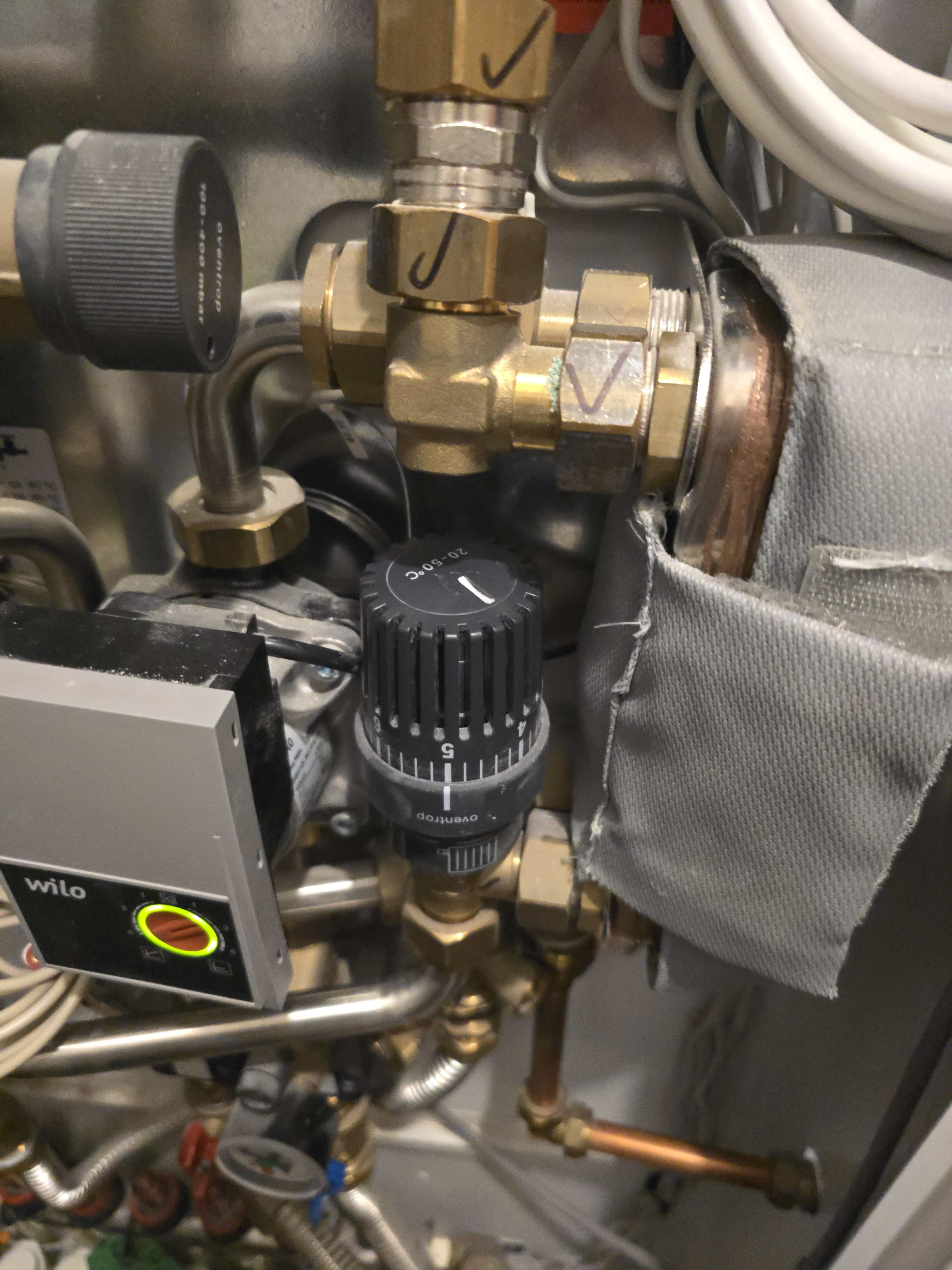

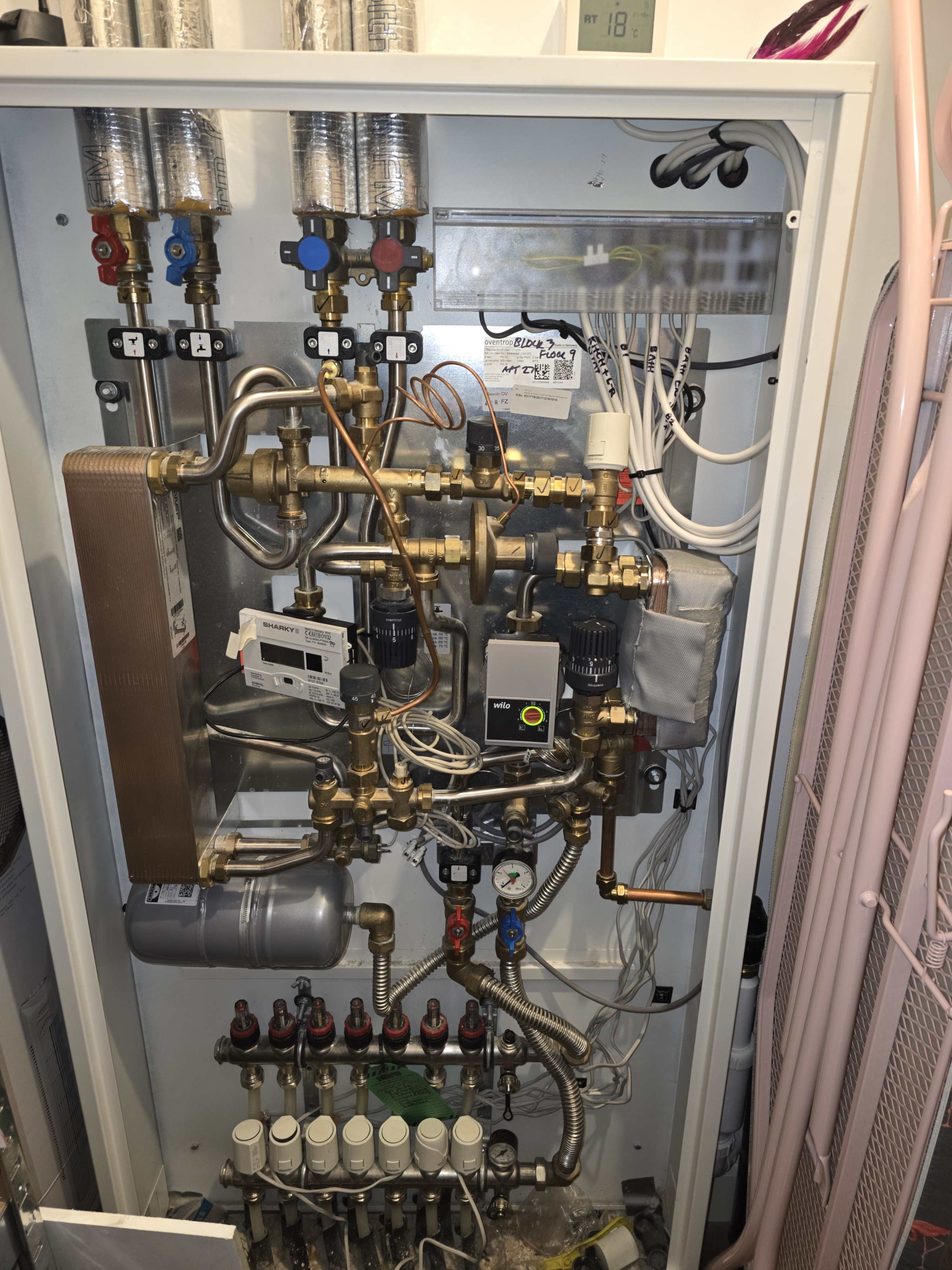

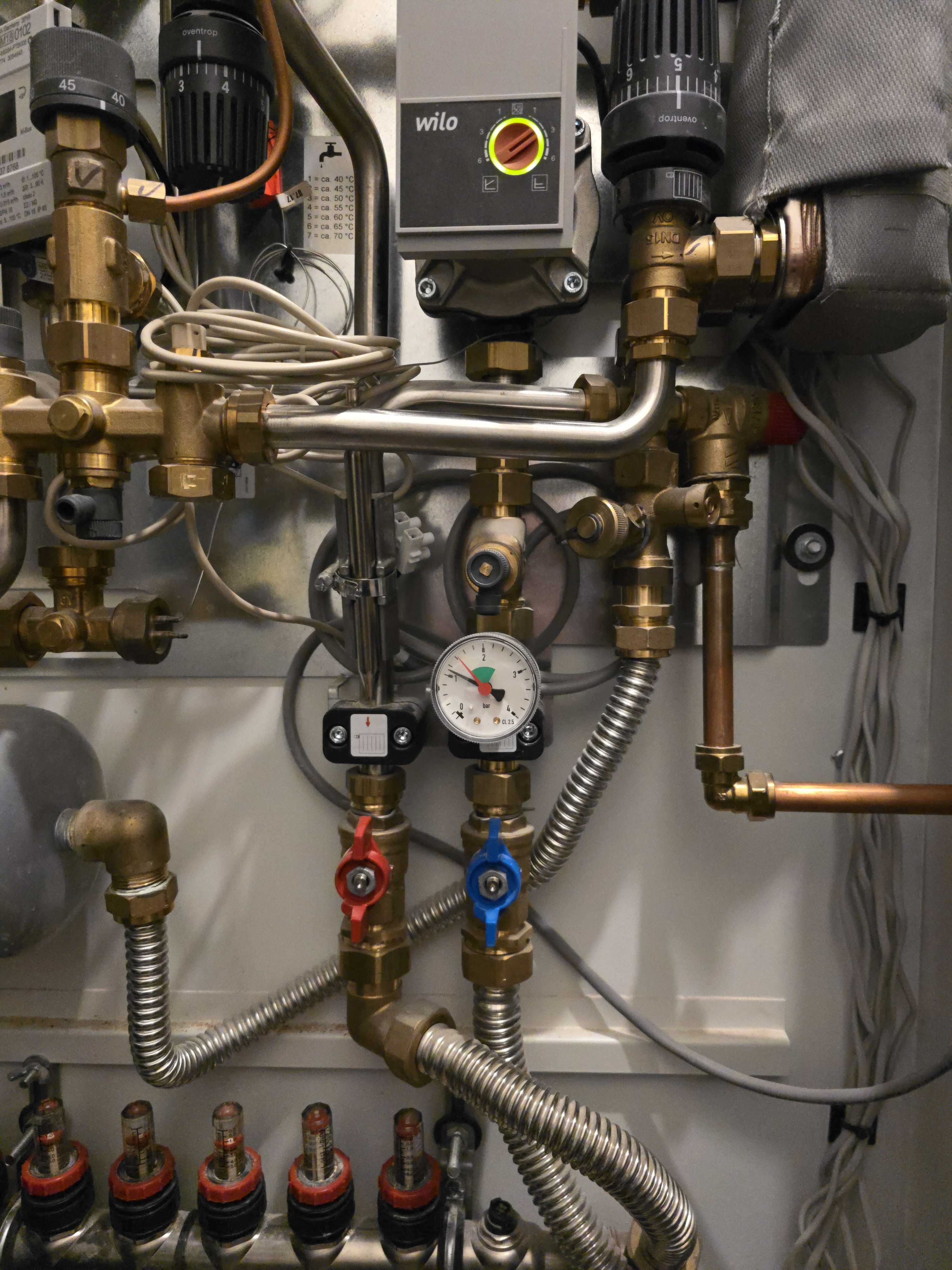

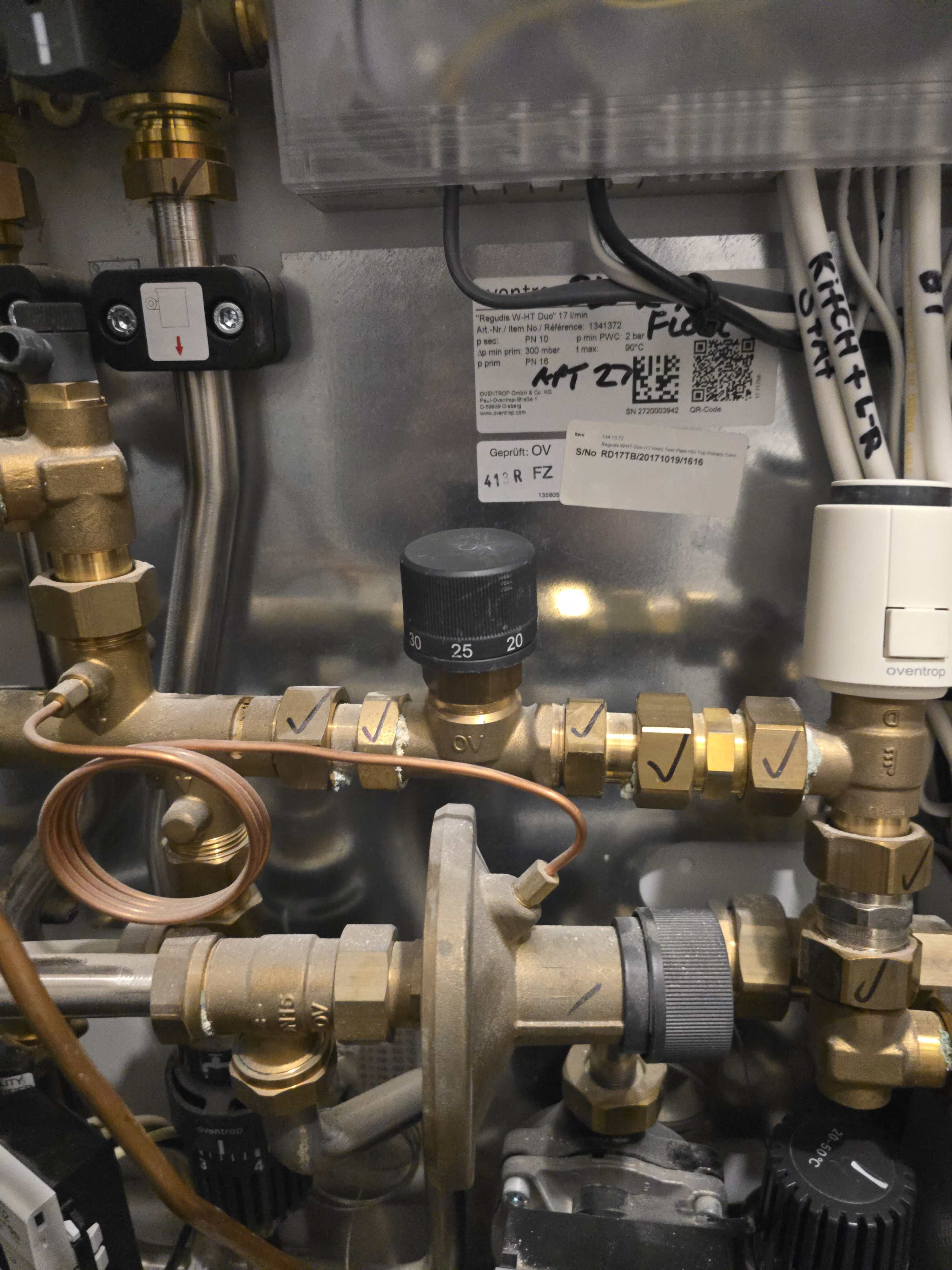

  1. I did some more investigation and I can find out that the only 2 knob doing something on the flow are the top black in the middle marked as 0/40 and the pump. The other 2 do actually nothing. Being district heating the temperature of the water is always coming in at 60 degrees. Any help?
  2. The building has a central boiler and I pay for the kw I pull from the system
  3. Thanks guys. Right now it shows 0.240m³ and 5.2kw Ht 62.7 Ct 43.2 Dt 19.5 I did some adjustments as the water knob was at the maximum and the wilo pump at 6. It was showing more than 10kw
  4. Hello, I moved in a flat with central boiler and water UFH. I had issues last winter so I couldn't check much, but it has been repaired and looking to use it properly. Every engineer who came had a different opinion on the settings, and it's really confusing as I see that it is super expensive to run it. The system is an Oventrop, I had different feedback about the water temperature, who said to set 35/40° and who said that need to be at 60°! After that there is another setting for the heating going from 1 to 7 (40 to 70°) Here as well different opinions. The pump has a 1 to 6 setting and at the moment is at 3. The rooms have analogic thermostats that I'm looking to replace anyway. I've learned to don't swith it off completely but I have no idea how to set all those values. Any advice would be very helpful
