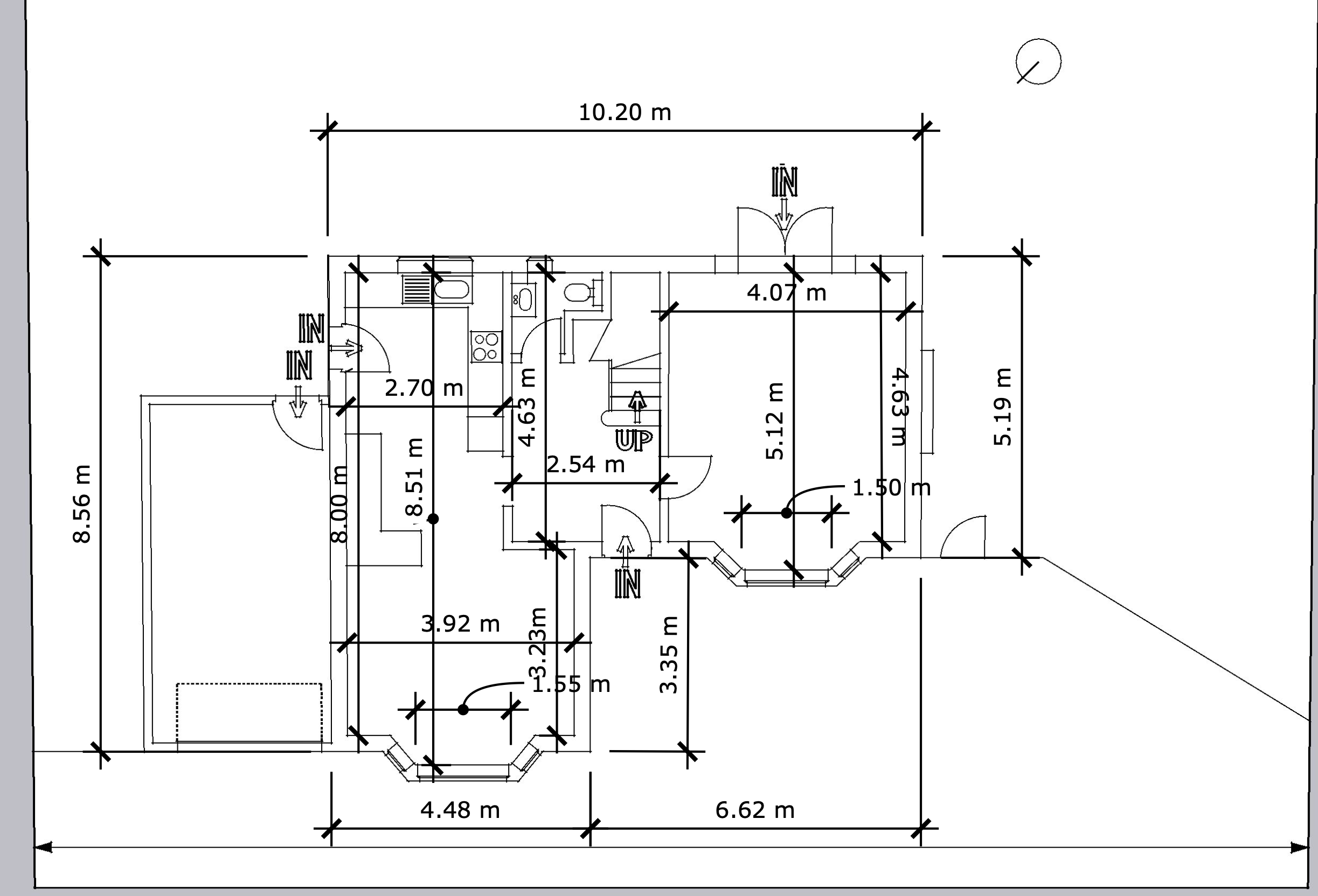

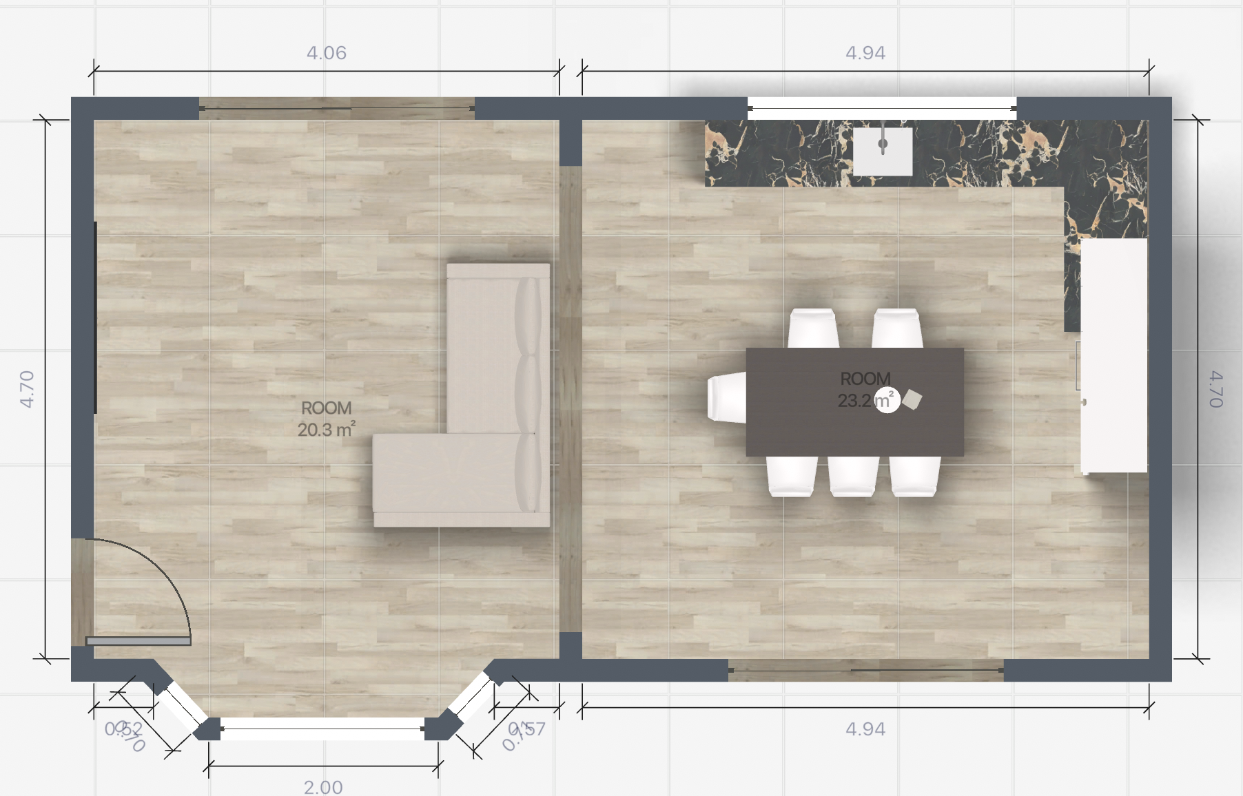

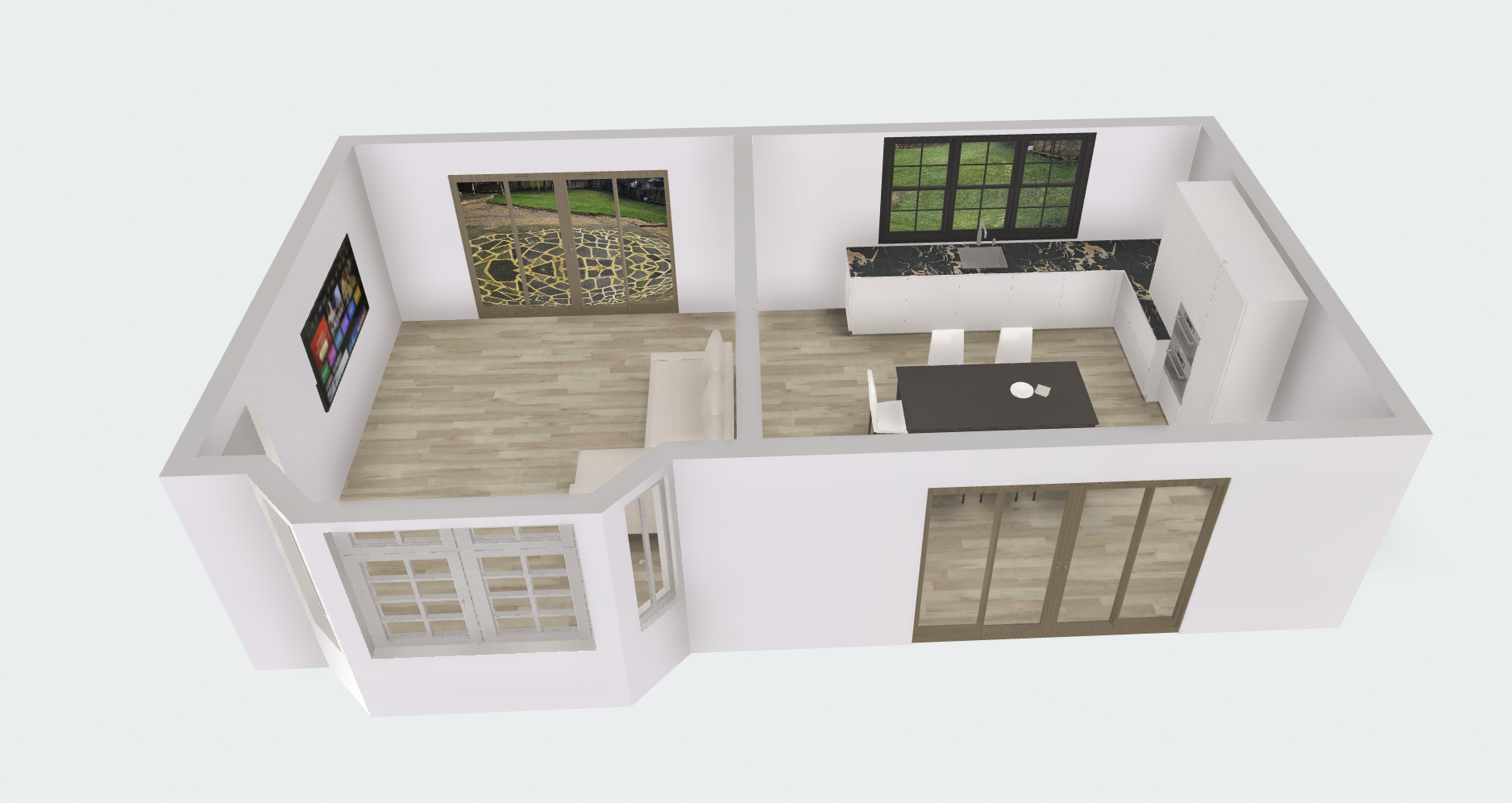

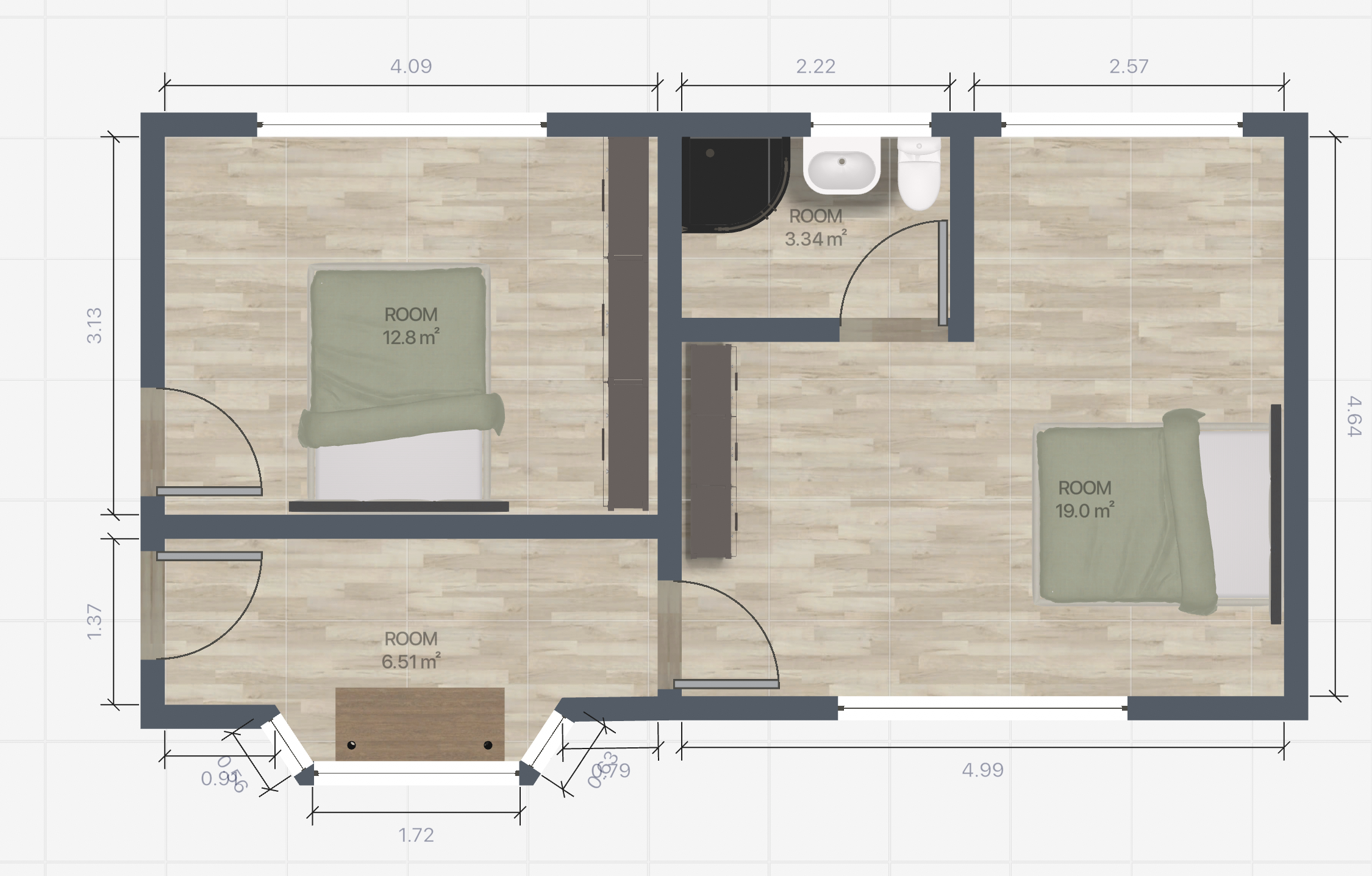

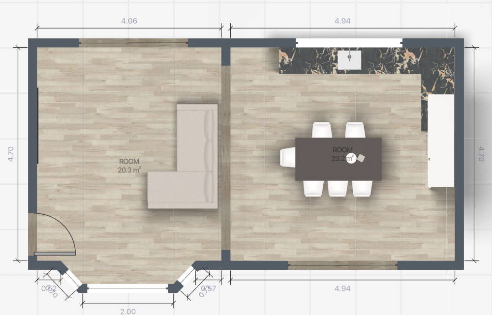

  5. I guess you must have been thinking about a detail like the below @garrymartin: In terms of the en suite @G and J I have actually made it even less intrusive with the above and also downstairs will have a relocated kitchen (new drainage through the front garden connecting to the existing as a new branch inside the existing chamber on the drive) so it should work all fine.
  6. Thanks for all the great ideas - I think this could work. Will now be checking other aspects of it including the lower floor as well.

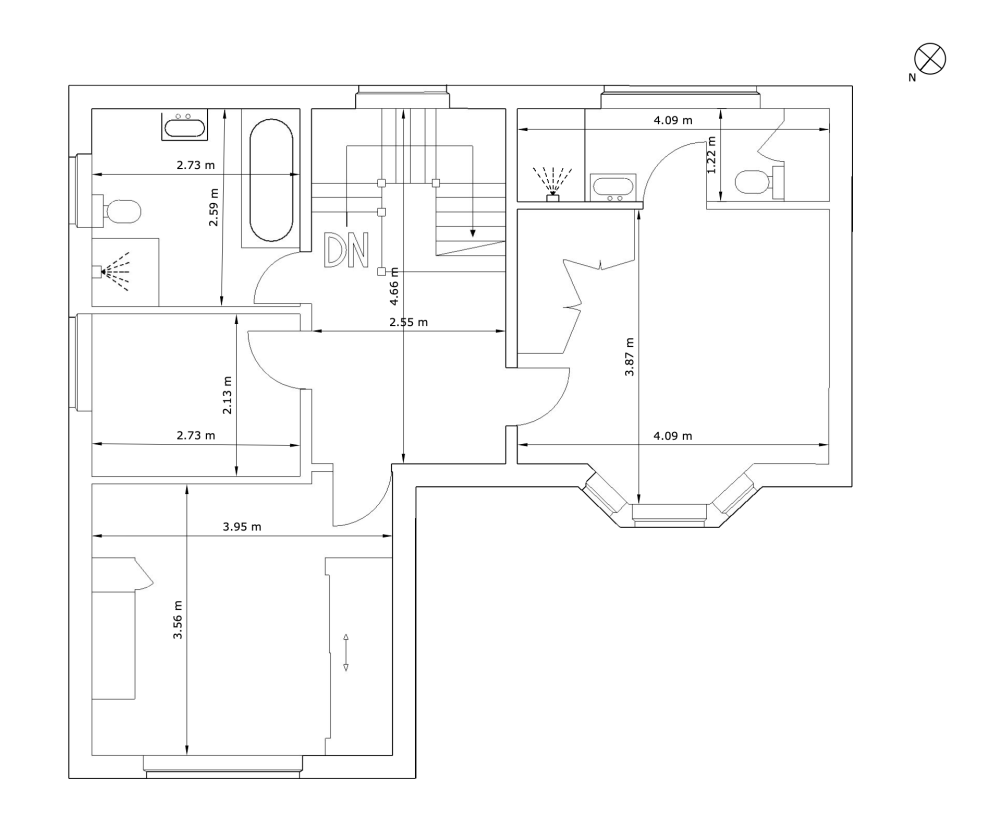

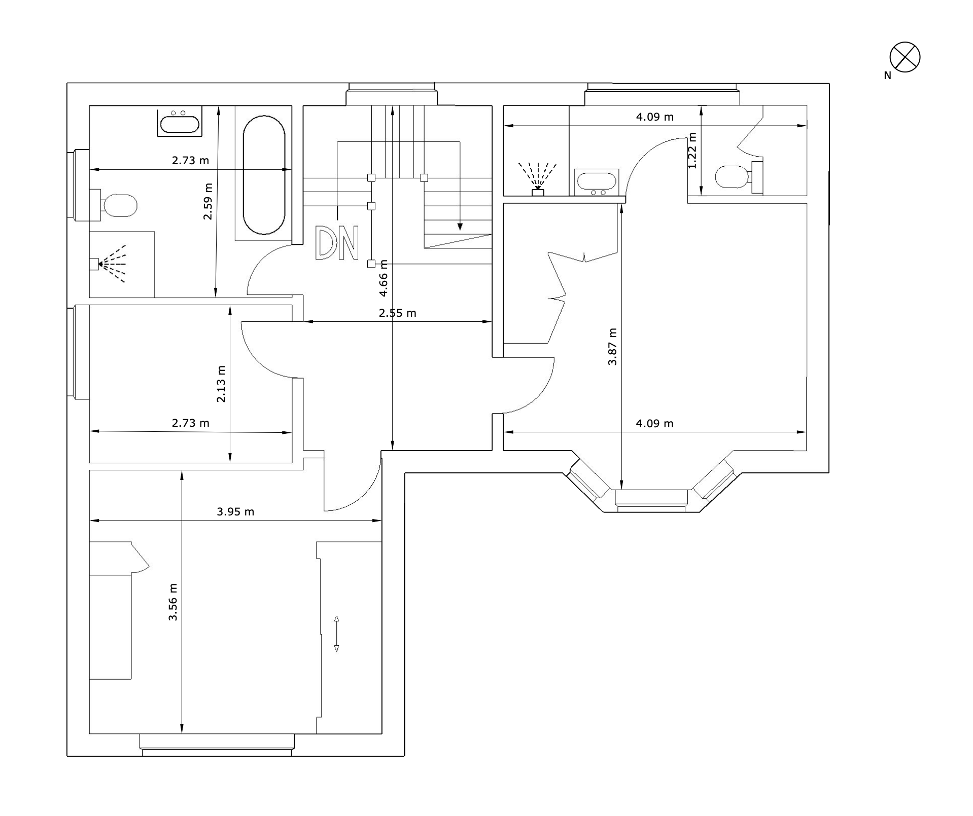

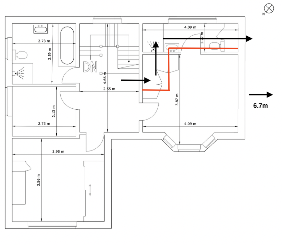

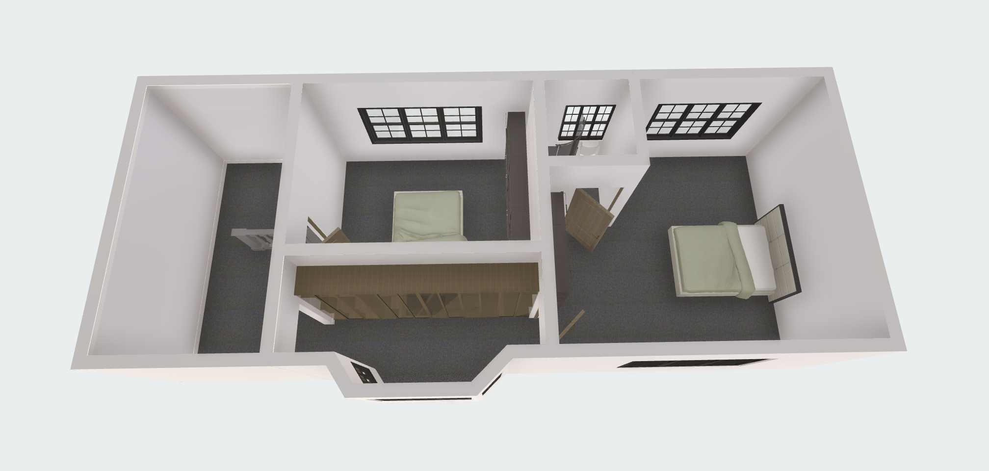

  7. @ConorSee the house floor plan as is currently. @G and J Good point with 'part of the main bedroom' suggestion. I like this approach a lot. All in all, if well executed, do you think it wouldn't kill the value? I know think that as long as the new wide bay hallway serve a purpose eg. drawers/ dressing table/window seat it could make the plan work. WDYT?

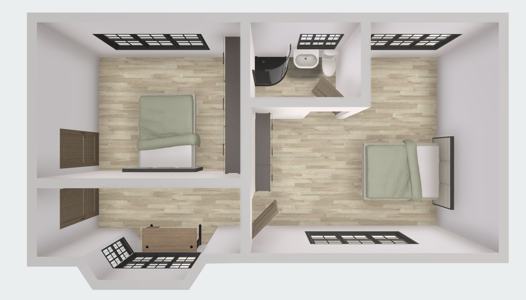

  8. This is what it would look like @G and J I would have to move the ensuite out of that bedroom and create a new one in a new master bedroom Would it be acceptable or look odd?
  9. It will be a secondary bedroom and the new room added to the right will become a master bedroom with ensuite. The window in the bathroom is a standard wide non-opaque window. Are you suggesting the bay window may be presented as a functional desk space or bench, desk, reading nook? That might be one option that I have not considered yes.
  10. Hi all, looking for opinions on a first-floor side extension layout (UK). I’m considering adding one additional room on the first floor to the side of the house (not rear). I’ve attached the existing first-floor plan with the new hallway marked in red and black. Because of the existing stair position and structure, one option involves forming a short internal corridor that is carved out of the current main bedroom (through existing wardrobe space and en suite), rather than walking directly through the bedroom itself. Important clarification: This would not be a walk-through bedroom The new room would be accessed via a dedicated corridor The corridor would have a full-height window for daylight The sleeping area would remain separated by a door So practically it would be closer to a small internal hallway arrangement, not circulation through the bed space. My questions: Is this type of solution generally considered acceptable in UK extensions if proportioned well? Are there any resale or usability red flags you’d immediately see? Would planners / Building Control typically object to this, assuming room sizes and light are compliant? Happy to hear both professional and homeowner perspectives - especially if you’ve seen similar layouts work (or fail). Thanks in advance.
