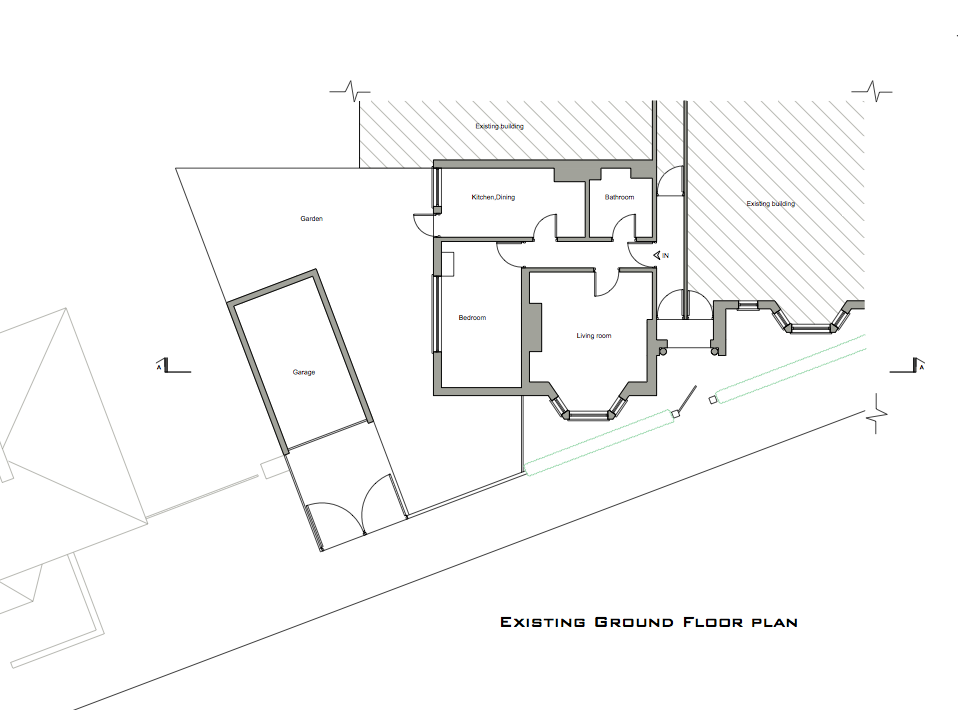

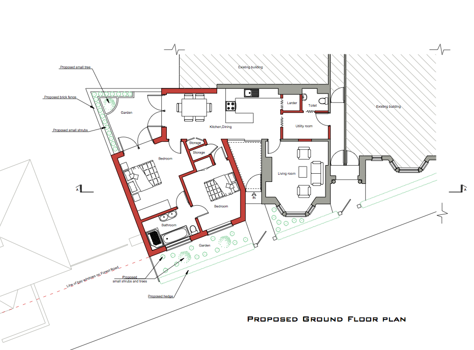

  3. Thank you for pointing me in the direction of @Stones blog - it makes a lot more sense to me now. It's not so reassuring knowing that the Nudura documentation isn't dependable - I'm using a range of contractors and the only one familiar with ICF is the chap building the walls (although it seems like he is going to have to oversee the pouring of the slab as the two jobs should be coordinated?) - so I was relying on those drawings to give everybody an idea of what they should be working towards. Do you have any recommendations of a more reliable source of info? I've attached the existing and proposed drawings from the planning application - I'm about to commision technical drawings for building control, but the engineer hasn't worked with ICF before either. The Nudura rep was very reassuring saying that they would provide all the relevant information. I want to use ICF because of the superior sound and thermal insulation properties, but also because I understood that it goes up much quicker than regular blockwork (we live in London and would prefer to move back into the untouched room of the flat as soon as possible). But to be honest, with all of the extra complication of finding people who are familiar with the methodology, I'm beginning to reconsider. Thanks again for all the help
