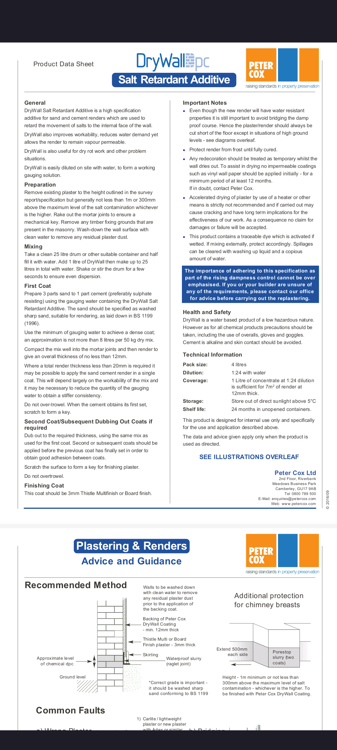

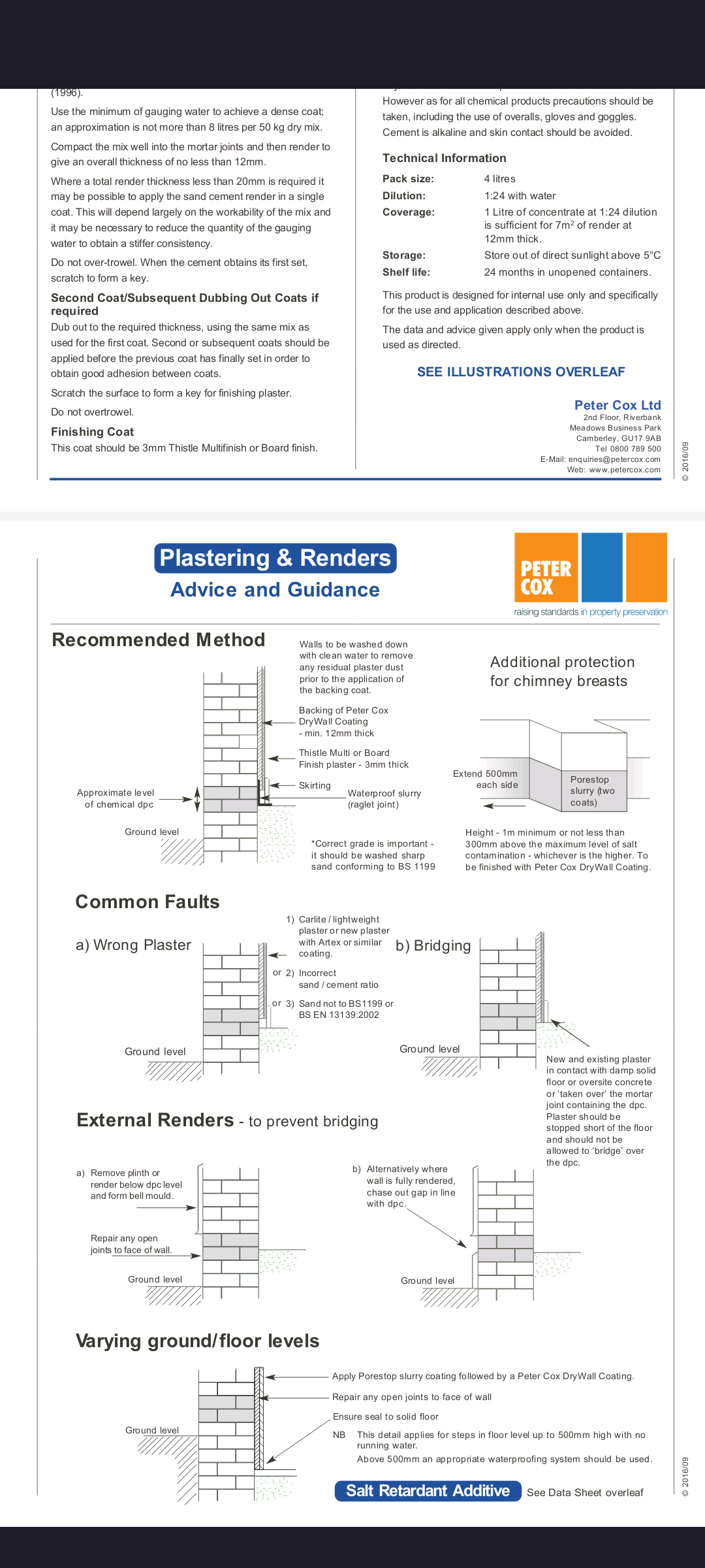

  2. I had a damp survey carried out by Rentokil, a well-reviewed and reputable company. They identified a rising damp issue that needs to be addressed and quoted me for a chemical DPC injection along with re-plastering. While I’m happy to proceed with the DPC injection, I’m wondering whether it’s worth having the re-plastering done by them, as it’s quite expensive and I could get it done cheaper elsewhere. Rentokil requires the plastering to be done to their specifications (please see attached ) for the 30-year guarantee to remain valid. Do you think it’s worth using my own plasterer and saving a significant amount of money, even if it means forfeiting the guarantee? Or would it be better to go with Rentokil for the plastering as well?
