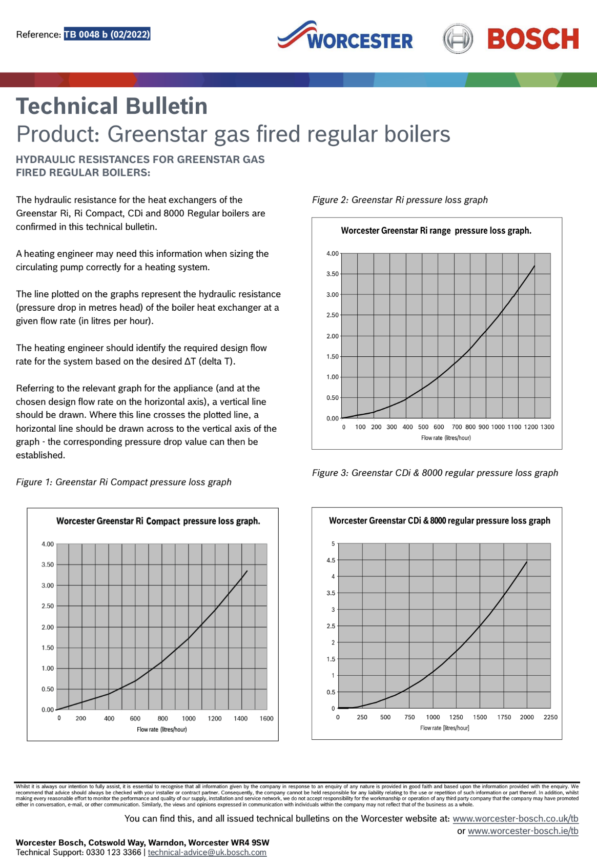

  9. Thanks John, I’m not the most technical so will need that simplified down a touch for me. How do I know what LPM will be enough for my system if I want it to heat up quick? If it’s 27kw of rads. And a mix of 28mm / 22mm / 15mm pipe (mostly 22mm)

  12. Oh interesting, so in simple terms its limiting to 400mbar because the boiler wont let it go higher? Knowing all this would the plan for adding the Wilo Yonos Pico as an extra external pump still be valid? as I was still planning to do that after the WB boiler guy takes another look. I dont want to over complicate the setup before they come back as in my experience that makes it easy for them to point to other things as a cause of the problem. Currently there's nothing external other than the mag filter and extra Expansion vessel.

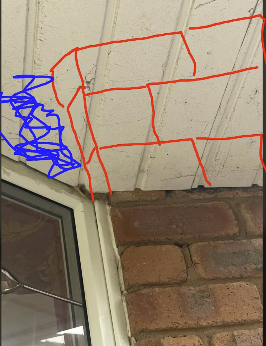

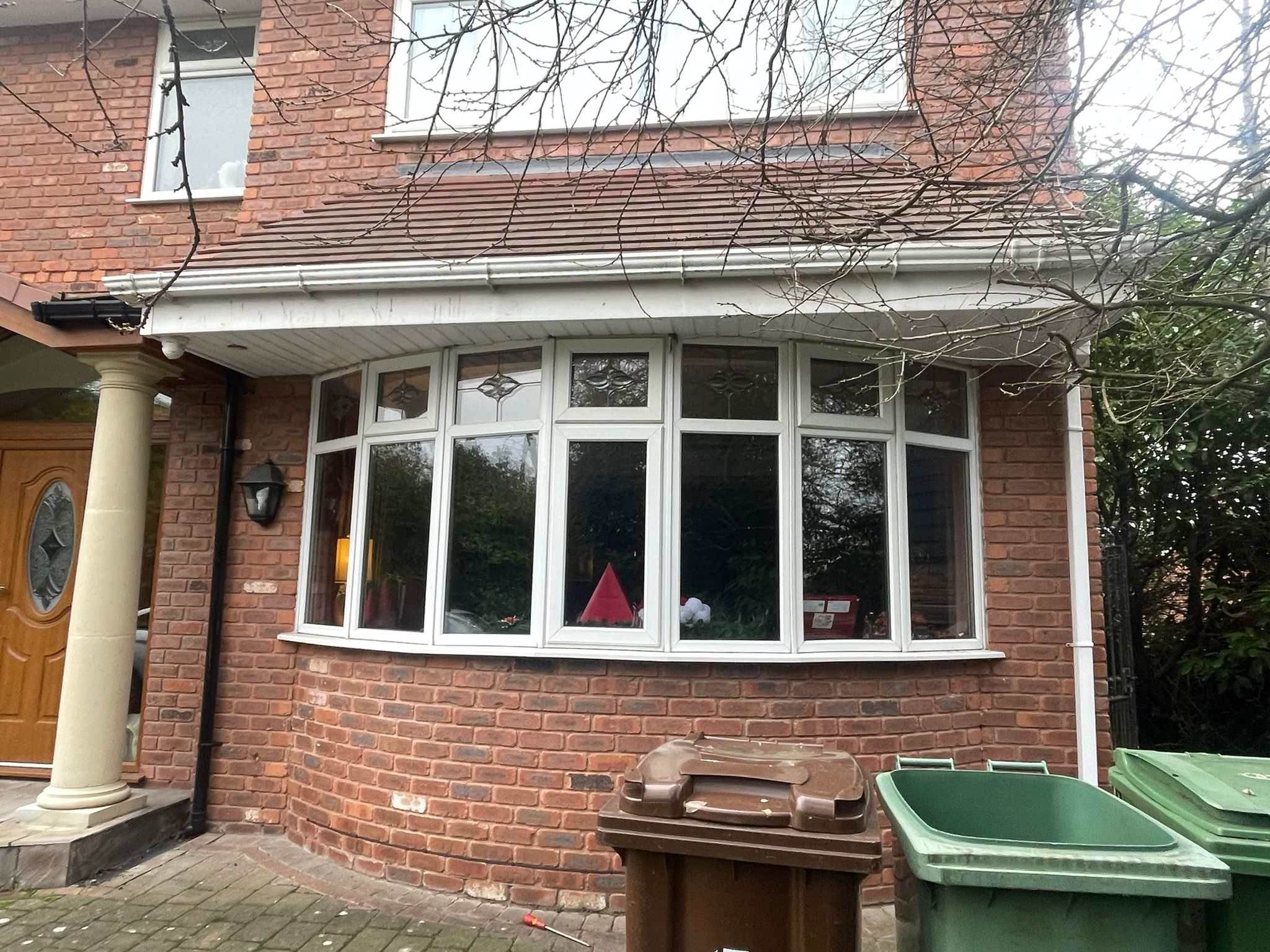

  20. The whole house does have an insulated 75mm cavity. When you say resting on the bay window do you mean ontop of the window frames? Or is it likely to have a flat roof built into the bay window? Trying to work out how invasive this will be to replace. Looking at the floor heights internally I doubt it’s cantilevered to them either. I know from when they converted it from a bungalow to what it is now they kept the original downstairs ceilings in place and built another cavity above that, so every bedroom in the upstairs has a step up by maybe 120mm to the “higher” floor height. That’d be way higher than where the bay roof would be cantilevered from though.
  21. I’d assume so yes. But from eyeballing it looks like where the masonry the frame would be bolted to would be. Is a void for some reason.
  22. It’s not no, renovated in the past 15 years but it’s originally a 1955 bungalow. So these bays would’ve originally run into the roof / eaves. When it’s been extended upward I wonder what they decided to do with the bays to convert them. I guess we will find out when the soffits and fascia’s are removed but I’m still a bit confused/concerned as to why I’m seeing a void above the bay. is it likely the bay window here won’t have its own flat roof built in? As in when we swap it out for a new window, it’ll be a straight forward swap of the vertical units?
  23. Thanks Nick, that's exactly what i'd expect to see, a continuous external brick surface with brick gaps where the timber framework for the roof is fixed to the floor joists. I guess more will be revealed when I remove the soffits and fascias but it definitely looks like a big void where i've marked on blue in the above image. Certainly more than a brick's worth. Though thats just from eye balling it through the gaps between the brick and soffits. Re: The bay forming some structural strength. Do the bay windows like this one come with a flat portion on top that's built into the window when it's fitted? I forgot to add an interior image in the original post but attached it below here. In our case will each of the panes be directly fixed to the circular section above it on that interior image? Or will the bay have a flat roof section built into it? And will that circular section above it have to be removed when we replace the bay window? It looks to my eye like each pane is just fixed directly to it, but i really am not familiar with the construction of the bay windows.
  24. Yep, I’m trying it on pump 5 for today’s tests and have rated the boiler down to 90% just to see if it helps the over shooting / taking ages to modulate down…. will do pump 0 “proportional” tomorrow. though looking at the manual again I wonder if there’s an error here. In the diagram it clearly shows that the “max” pump rate (A) is far higher than pump setting 6. Though when I ran it on 6 last time. The pump % output constantly read at 100%. So it’s just another thing I’m confused by honestly. 400mbar and 700mbar is a huuuge difference if we’re to believe this diagram.
  25. Hi all, Noticed something I thought was odd on our bay windows, and wanted to check for sanity. Wasn't sure if this was best in the roofing or Window sub category so will delete and re-post if this is in the wrong place, apologies if so. Anyway, Two of our ground floor bay windows are this sort of setup, where the brickwork beneath them projects out from the property with the window, but the brickwork above the bay window does not. I was looking at having the Windows,fascias and soffits replaced and on inspection earlier today I noticed the area directly above the window appears to be a recess, where the brickwork just stops. Its hard to see clearly without ripping off the soffits etc. But my question is, if I was to remove the soffits and fascias and all the little 'roof' section above the bay window here, if it was 'built' properly should I expect to see a lintel on the inner skin and the rest just solid brick work? Or is it correct to have a big recessed void between the brickwork above where the baywindow is? Tried to draw what I'm describing on my phone on the image below. Red is where the bricks carry on, blue void. Cheers Ged
