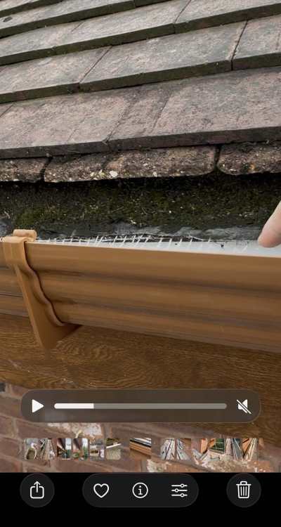

Fascia Vent Strips & Overhanging Membrane = Problem?
EinTopaz replied to EinTopaz's topic in Roofing, Tiling & Slating

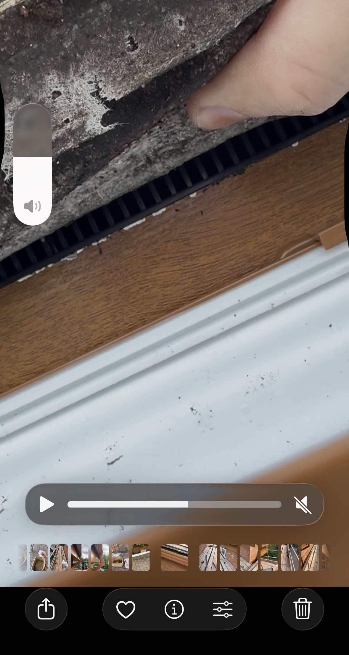

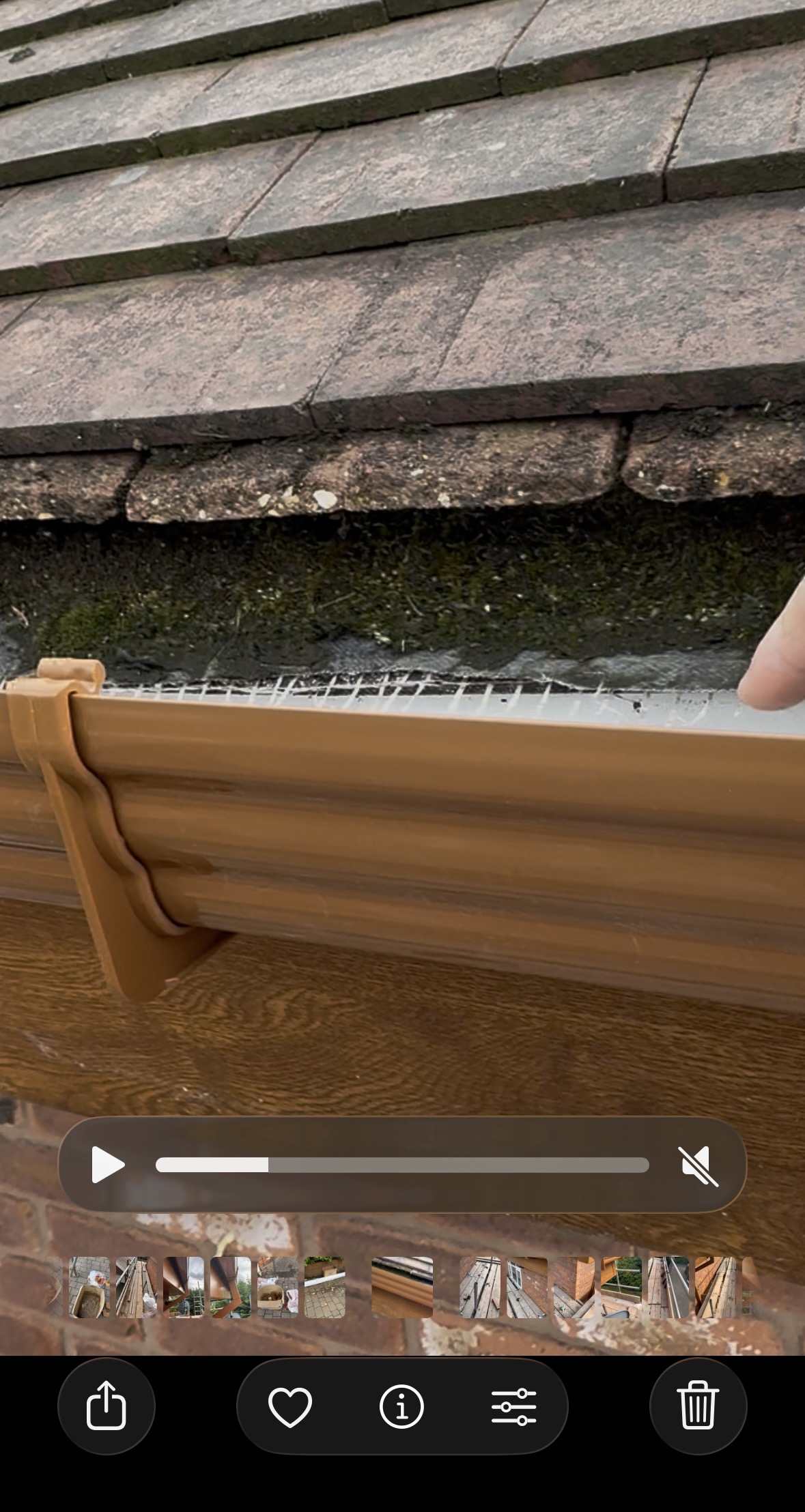

Interesting, lifting up the felt on ours the vents appear to be facing outward away from the brick work, rather than downward.... maybe they'ved used a different type on ours, or installed them back to front? Is that a problem? Photos below. -
I'll ask for the eaves guards to go in before the scafff comes down, good call. thanks. -
thanks @ProDave will take some snaps when i'm home, it has those over fascia vents on there, but the bitumen is drooped over them and hanging into the gutter. That's my concern that the bitumen is essentially obstructing the air going into those vents. -
Hi all, We've had our old white soffits and fascias replaced this week with UPVC Oak. Our old white soffits were 550mm and were vented (25mm continuous cut outs toward the outer edge). The roofer doing the work has told me they just don't make them that deep in UPVC Oak, so has told me we'll go with a Hollow board soffit instead. Visually I think it looks fine, but obviously not vented. I enquired with the roofer about sufficient ventilation, they said they'd add fascia vent strips as an equivalent ventilation method. However now installed I can see the membrane droops quite low and could be blocking those strips.... again i've enquired, roofer said not a problem. But figured better to get a second opinion on here before the scaffolding all comes down. what do you think? Cheers Ged

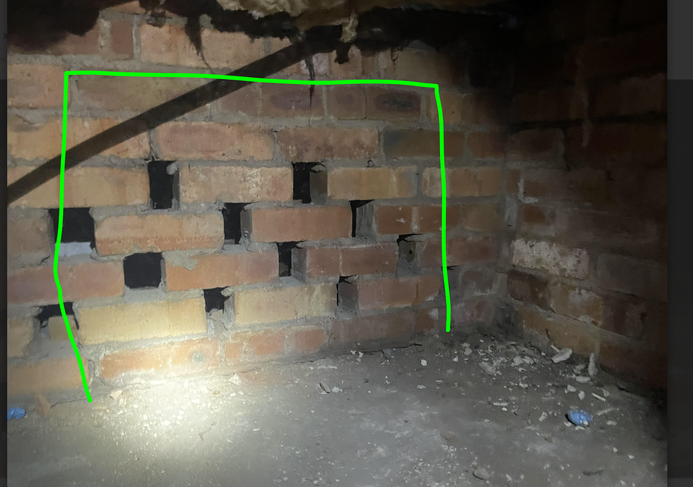

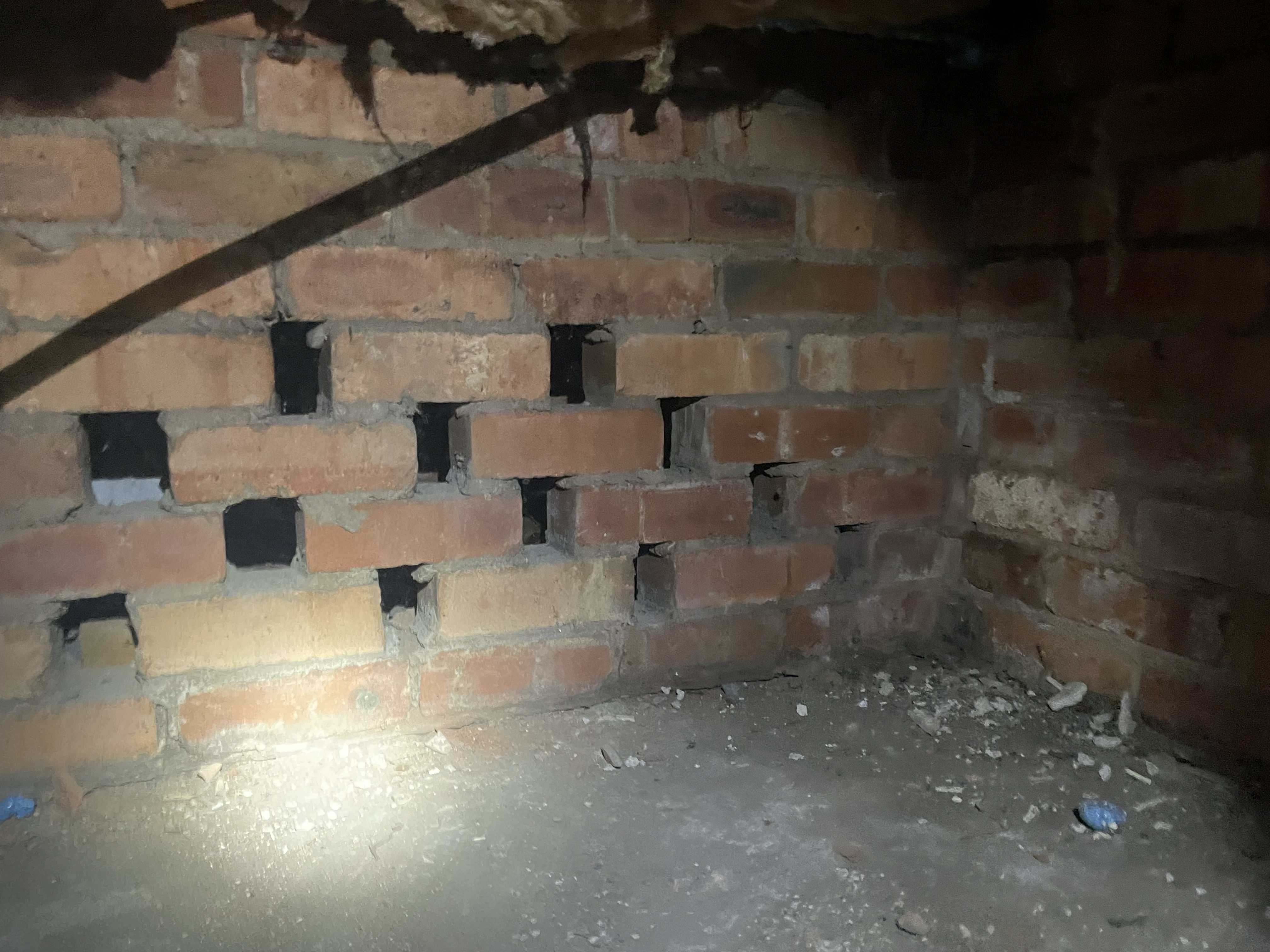

Hi all, Because a bunch of reasons, I need better access to a particular area of the sub floor. The easiest route would be to make some sort of opening in the wall pictured below. I've triple checked and this subfloor wall is supporting the floor only, there is no brick/block wall above it. in that case, what are the steps to open it up? and will it need a specific steel beam? i'd say for comfort sake, 600mm height/width would be fine for me to get through.

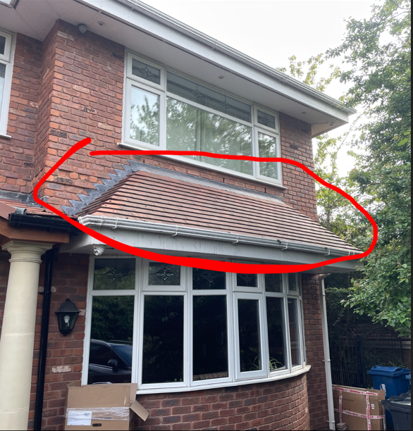

Void Behind Bay Window Roof - How bad of an issue is this?
EinTopaz replied to EinTopaz's topic in Heat Insulation
We are replacing the soffits and facias on the top floor this summer, so I guess i'll have a look at how exposed/unsealed the tops of the wall cavities are then. -
thanks, Perhaps only on the surface... been 5 years of finding horrendous workmanship. I feel we're finally at the end of it now (he says) -

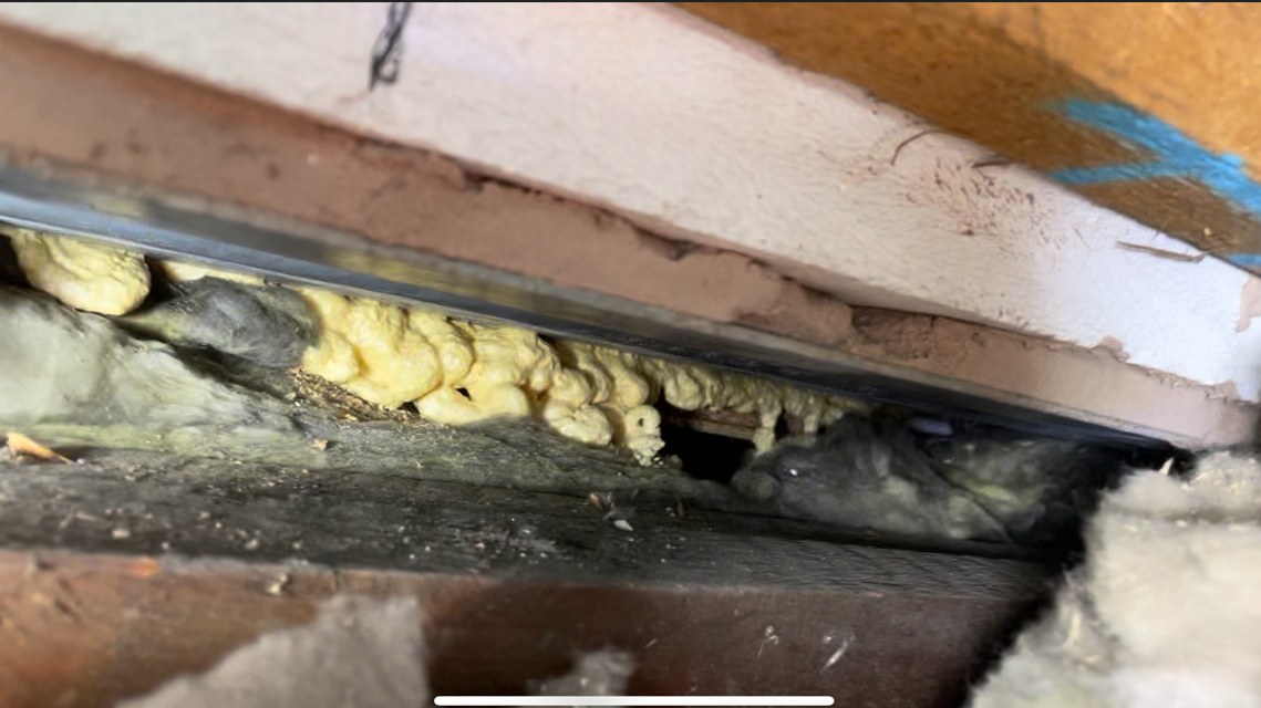

where else would the draughts be coming from? -

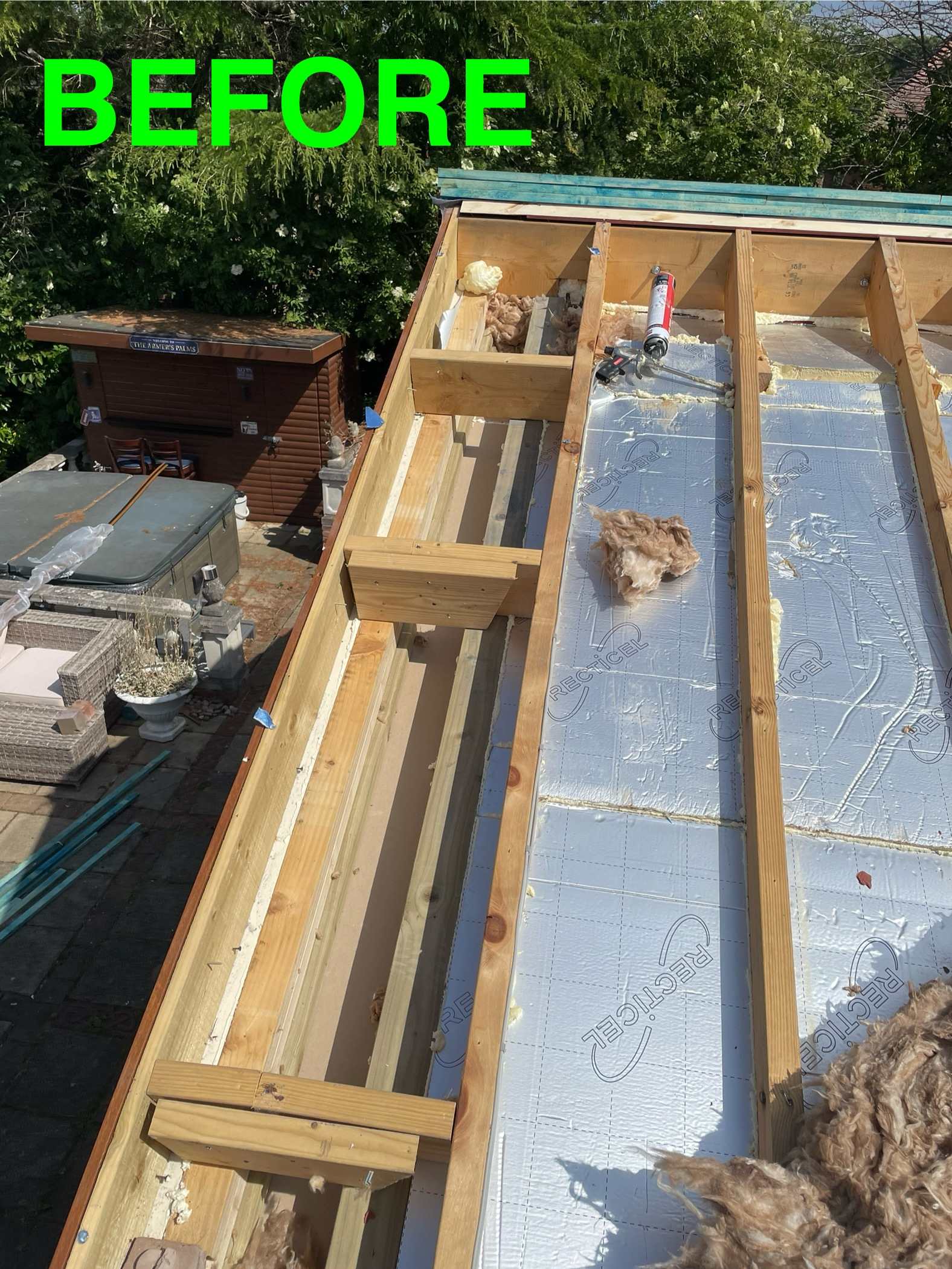

thanks guys, how much of a problem is it if i can only get the PIR closing the outer leaf rather than the inner? Im not sure how good the access will be without removing the entire roof. Which ofcourse i'd rather not. -
There likely is, but i think it may be even higher up than this, Every bedroom on the 1st floor of this property steps up 100mm towards the front of the house, so I reckon the lintel is in there. All the voids between floor and ceiling have double cavity voids too. Where I think they kept the original bungalow ceiling up, then essentially did another cavity above that. Its an odd one. But either way; is the fix to basically PIR board that huge gap and foam seal? -

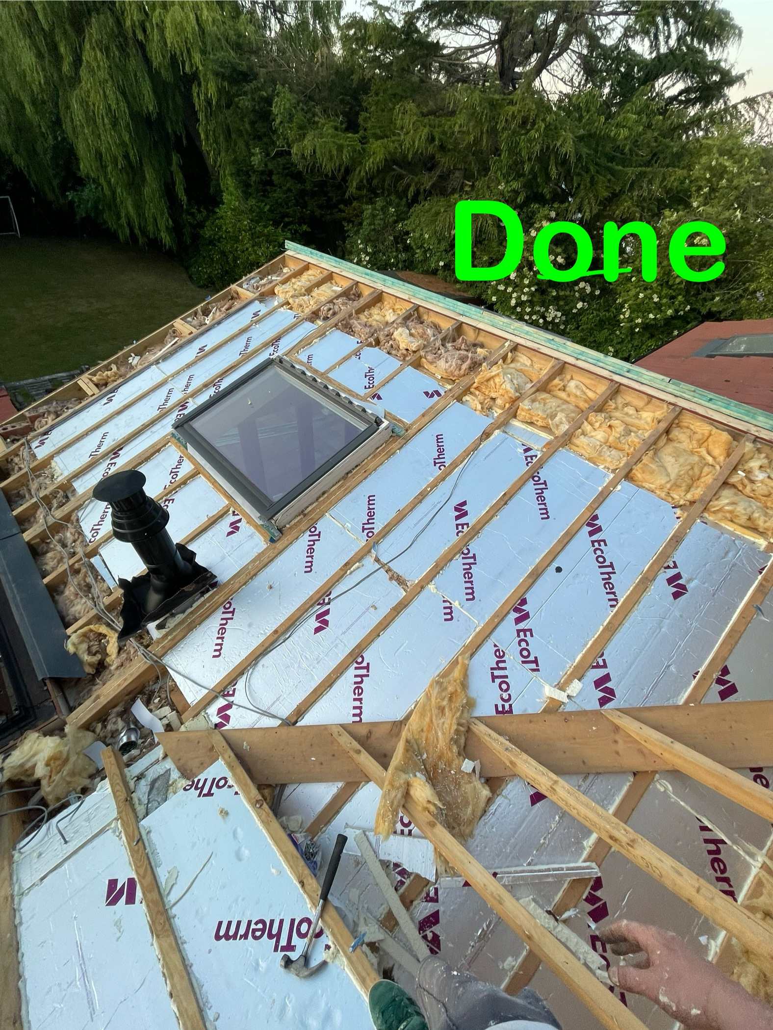

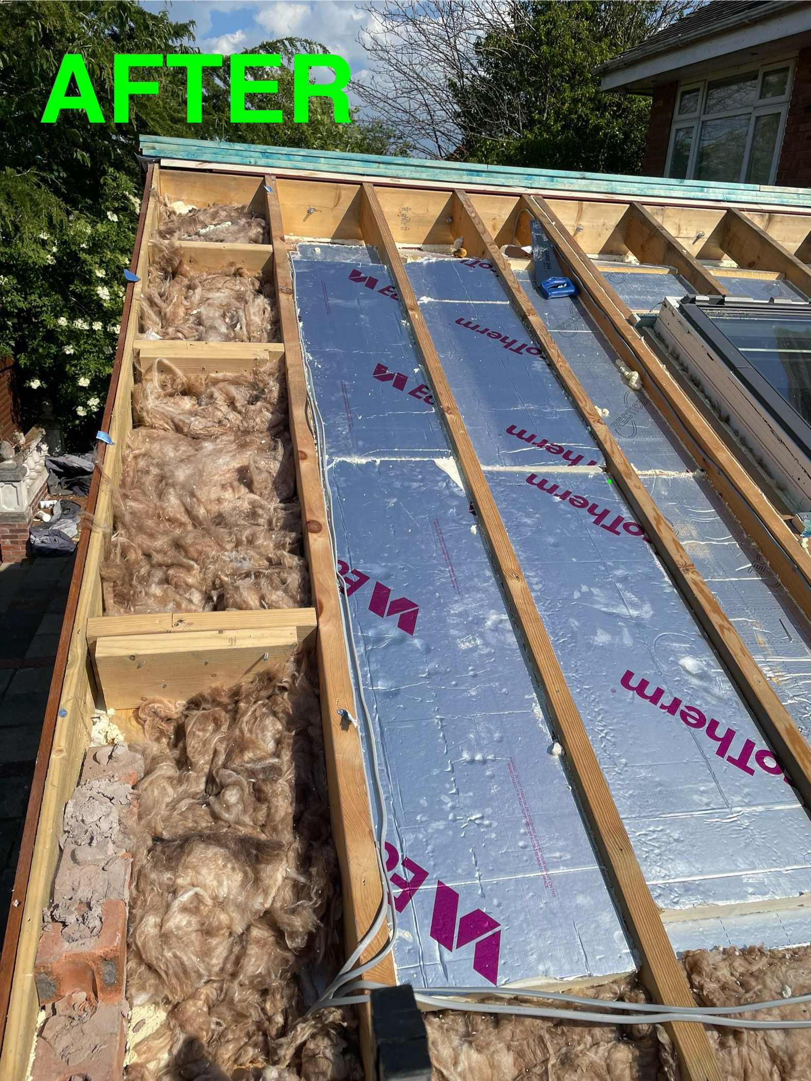

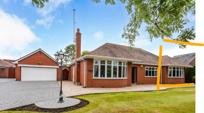

thanks guys. It looks to my eye that neither of the leafs are continuous based on that.... and looks like they'd foamed the outer once but either not all the way across or its failed. For a fix, tiles, battens, felt off.... PIR board wedged in as deep as I can get it, and foam sealed around the edge, will that suffice? For trivia....Worth noting the property used to be a bungalow so those bays will have originally just run into the old roof. It was converted in 2006 so had hoped i wouldn't be finding this but hey ho, it is it what it is. picture of it in its original bungalow form... -
Hi all, Was recently looking at replacing the soffits and facias over a front bay window, on closer inspection It looked like there was potentially a void in the outer skin of the wall that the soffits, facias and the roof of the bay window are covering. I decided to take some tiles off to have a better look and did indeed find a void in the outer skin of the wall, and to my eyes looks like the void continues through the inner skin too? (though it'd be good for someone to confirm that). Based on the image and video below, how bad of a problem is this? should I get the roof off and seal this void? Reason I ask is because this bay window is for the dining room, notably the coldest room in the house. So perhaps not a coincidence? Here's a video that shows the void well :- Hole Video Behind Bay And images too:- Bay window in question Void behind the tiled roof. What do you guys think? fine? or bad? or really bad? thanks Ged

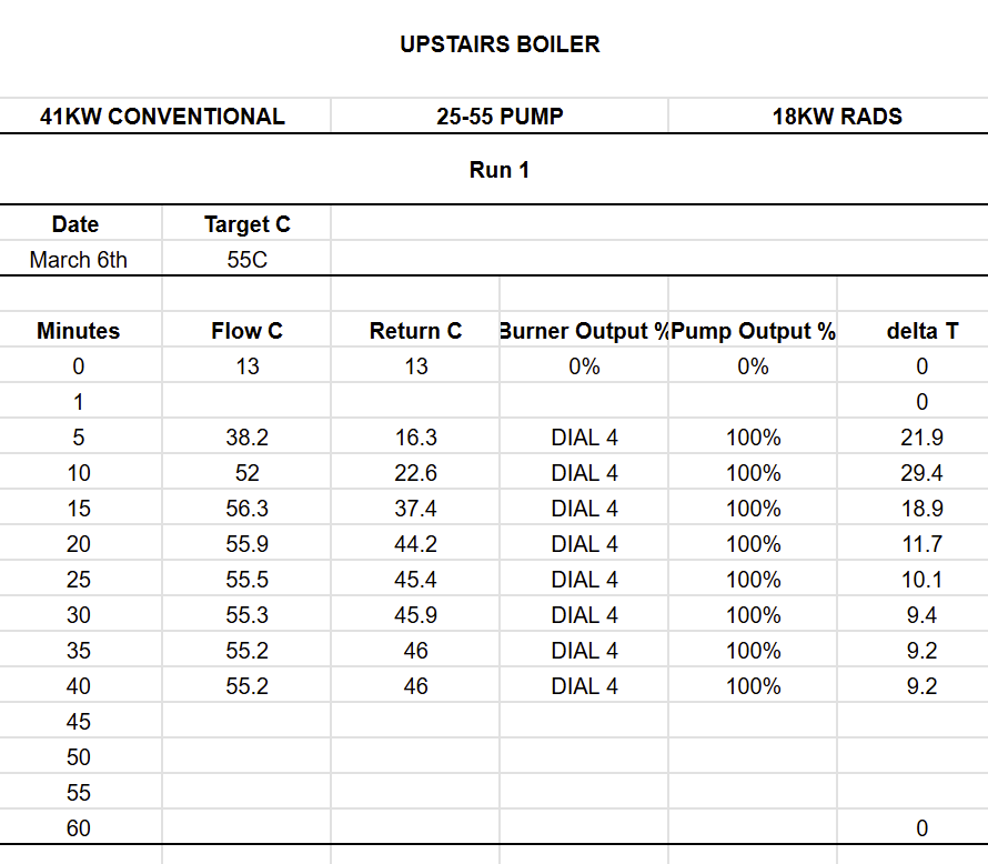

Worcester Bosch Greenstar 8000 System Boiler Issues
EinTopaz replied to EinTopaz's topic in Boilers & Hot Water Tanks
Yep, from monitoring i think this is just standard behaviour from modern boilers. Though as part of the test yesterday I did try setting the burner min output% to 45% (default is 14%). It did shave a few minutes off reaching 60c, but i think it also caused further problems with the boiler not being able to properly modulate down once it had hit/exceeded target temp. I need to confirm that today with another test, may've been a coincedence. Yes exactly, thats the behaviour i'd expect to see. If the system doesnt demand as much power as the boiler can give, ie if some of the TRV temps get hit and the radiators turn off, i'd expect the boiler to modulate down, not just carry on and overshoot the temp at 100% output. That just seems ignorant and primitive to me, I agree with you that this doesn't seem like its part of normal programming, this boiler doesnt have a return temp that i can monitor on the LCD, but it must have a sensor inside thats being checked to determine the modulation beyond the flow temp? From memory they have changed a couple sensors already but that was to try and fix the massive difference we had back when the HEX was screwed. Maybe theres more sensors on there that need to swap thats causing this? When i run it now with all the radiators fully on, ive got the target set at 68c, it will overshoot this by 4c, very occasionally it will overshoot it by more and turn the burner off. But that's more rare when all the radiators TRVS are on. When it doesn't trip off, as mentioned previously it will take as long as 30-45 mins to come back down to target. Modulating verrrry slowly as it goes. My own sensor is now 1C difference to the boiler LCD display. That's a good question, do you mean if i change it once the target temp has been reached and everything is stable? i'll give that a try. From memory i dont think it reacts at all to this. Before hex replacement i cant recall, I feel it was still overshooting back then.... it must've been as it was going quite high on the LCD display, why do you ask? do you suspect theres been a problem since they swapped the hex and thats causing the overshooting? -
I'll spend thousands for a thing to function correctly and me not have to fanny around with it, yes. In simple terms it takes too long to heat up my system and its not running cheaply enough to outweigh the time i have to wait for it to heat up. Id rather go for a commercial boiler at this point. it was on one system at one point but its been extended many times now. I cant be bothered linking it all back together now, rather have 2 boilers. I just need my downstairs one to be less shit. Incase I hadn't mentioned 🙂 -
That's fair re: boilers not being too reactive, but it does seem awful slow to react this one. Like it carries on way past the target at nearly full strength output. I'll do a longer test next time to show you but it really does take a while for it to come back down to target. That doesn't seem efficient to me and means it does sometimes turn the burner off if it exceeds the target too much. None of that seems like its doing what it should to me. Maybe 10minutes to react and load its self down would be fine, but in my case its way longer. My expectations and frustrations are two fold with this boiler, they were three until the hex got fixed, now just the two. They are - I want the rads to get hot sooner, and, I want the thing to run efficiently and modulate down correctly. (the overshooting stuff above bothers me regarding efficiency). If it fixes both the frustrations; I am prepared to put the boiler in the bin if I need to and go for a larger Vaillant conventional type. This one is 35kw and doing 28kw-ish of rads at T50 Perfomance wise, i want it run more like the other boiler I have at this property. I'll put the data log of that one below. Its 41kw CDI conventional (with grundfos 25-55 pump) and powers around 22kw of rads. i've no issues with that boiler. It warms up fast, Runs exactly as I want it to. im sure it is overpowered for that system but again, no issues with overshooting or anything like that. Just works (tm). I wish the greenstar 8000 life in question here ran more like that.
