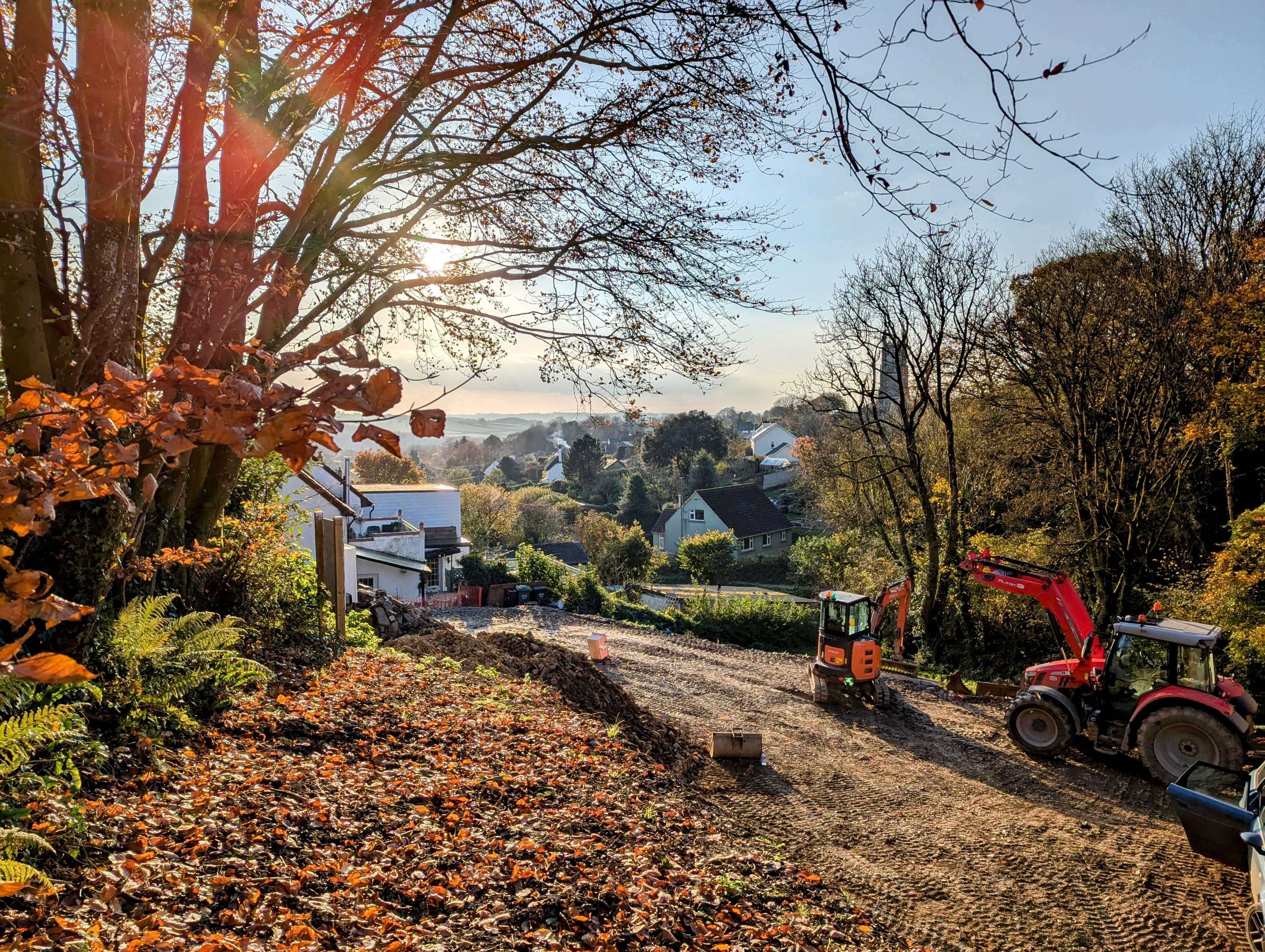

Hello all, Matt & Hayley here. Last year we bought a sloping plot in Devon (the slope has caused more issues than anticipated), with a barn on (infested with bats and birds, cue further issues... and cost, obviously), this year we are hoping to finally start building! We have planning for a 4 bed detached house, made of Oak, with an ICF outer - it seems this hasn't been done much before, so this will be interesting. We've done a few renovations before, but never built the actual walls, so this part is all new to us! Thanks
